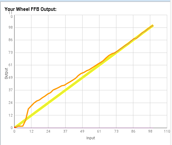

    Got some reworked ESP_WHEEL from:
    https://www.xsimulator.net/community/members/fernando-igor.26352/
    that I changed to fit my hardware (Pro micro + IBT-4) and did a wheelcheck. I have just mounted the encoder with a rubber band, so no real "drive" test yet, but it seems promising. Because of my low current power source, I was forced to limit the current to the motor with a 12/100w light bulb. Will do some test just to see if this firmware work with rfactor2. Should be nice to have a working firmware that you could change by yourself.

    Did some test in LFS. FFB setting in LFS = 50. When stronger forces comes, the power supply trips. I can say that this motor could have been perfect for the job, if it wasn't for the cogging.... If I calibrate so zero comes exactly between two "teeth", than at least it goes straight if I let go of the steering.

    Some update of my progress... Still haven't received the new board so I can test the wheel in a real drive environment (LFS works, but want to try it in rfactor2 before final conclusion), but have done some more tests.
    My IBT-2 cards have arrived, so I tested to use them in parallel, and it works flawless. The current splits 50/50 between them.
    I have 2 ATX power supply in parallel which gives me 55 A before they trip.
    Another interesting thing for those who want's more current, I found that the FET (LR7843) mounted on the IBT-4 cards actually have a max Current of 161 A!!!. The problem with that card is that the cooler is wrongly mounted, so they fry directly if you go above 40A.
    Put them correctly on a CPU cooler and you have real "Monster" h-bridge! I have ordered insulation pads for that, but I probably won't do that when the IBT-2 work so fine in parallel.
    I have measured the torque with a scale for luggage, and it was just what I expected. About 1Nm/10A which give me maximum of 5.5 Nm with my current supply. For now I have fitted the wheel from my old Logitech Momo Red that has a diameter of 25 cm. Have tried to do some "one hand" laps in LFS (No pedals connected yet), and I cannot see the need for more torque.

    When the simulated car stands still and there are no forces it's annoying, but when you reach some speed, the forces are so strong so than
    it isn't a problem. I calibrate it so zero is between 2 "coggs".

    It's the ESP_WHEEL_0.3 that Fernando have reworked a little that I have been using so far. It still have some errors and doesn't work with rfactor2. After some reading of Bernard Bergers OSW, I realized that rfactor2 is actually the easiest sim to make you own ffb solution to because the ffb output s available via an open API. So I removed the ffb part from the ESP_WHEEL source and added the ffb signal via comport communication from the API and now I have a great ffb wheel for rfactor2. I noticed another thing that I suppose is related to the IBT-2 card. It doesn't produce the same current in both direction with the same pwm output. For now I have just rescaled it linear, but have plan to do a full linearity function so I get the correct Nm proportional to the output from the API. Theoretical, this solution should be very close to the closed loop servo wheels. My solution will not compensate for difference in resistance because of temperature etc.
    Have not fully completed the hardware with pedals, but did som test driving in rfactor2 which is coming to a new world when it comes to ffb compared to LFS. I have turned down so I use about 4 Nm at peeks, and with the current wheel (25 cm Logitech Momo) that is more than enough. I can now set the filter to zero without the annoying "rattling" that the G27 gaved. I can feel every little detail on the road, and the car almost compensate oversteer by itself.
