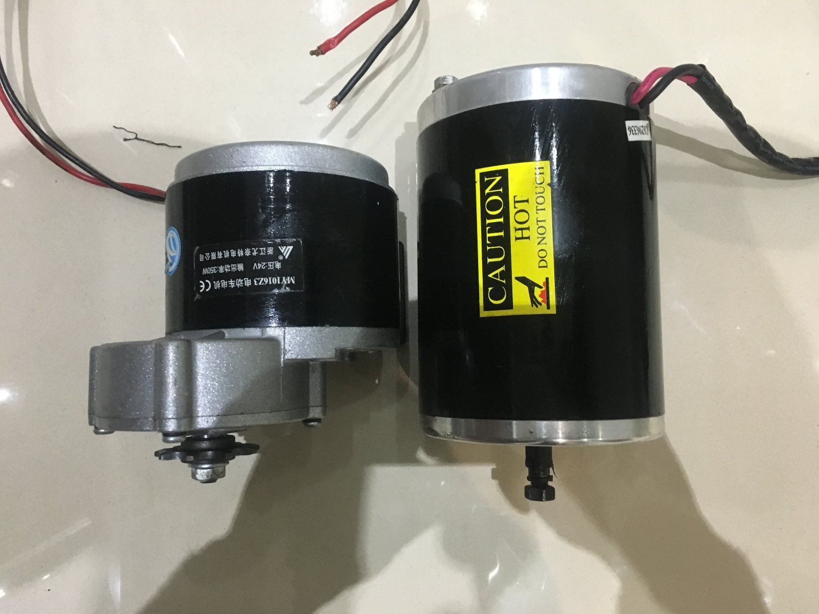

    a quick update - yesterday the STM32F4 discovery board finally arrived however it appears it will do nothing more than the Leoanado board - is this correct ?
    i found a 1kw electric motor and a geared version of my motor going for sensible money so i decided to buy them :)
    first impression the 1kw motor is quite notchy and jumps from one position to the next - i guess the magnets are quite powerful
    the geared motor seems to turn without any notching and has a bit more resistance than the non geared motor - however with a wheel attached it will be very easy to turn

    The 1000w motor seems to be exactly the same as mine (except voltage maybe) and I can after several hours of use say that the cogging is not an issue.

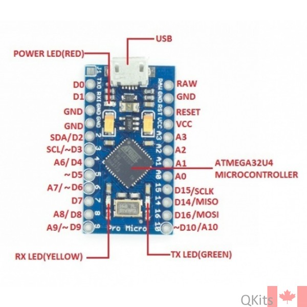

    I'm using the pro micro. That's the initial reason why i wrote my own code for it. The micro is missing the D11 pin that is hard-coded
    for PWM output in the working Aiwave firmware.

    DC motor, Arduino
    Hello guys! I see some nice arduino leonardo based builds and i have just finished builidng my test version. I have a couple of problems and I hope they can be solved. I have Ai-wave software on my computer, IBT-2 motor driver , 200W 24VDC motor 5m belt drive about 1:5 ratio and omron E6B2 encoder with transistor for Z. I got it to work in Assetto Corsa but it doesnt turn really smooth and sometimes the whole game stops and wheel starts spinning in one direction untill i turn the power off and disconect arduino from my computer. I run the motor on 12V.
