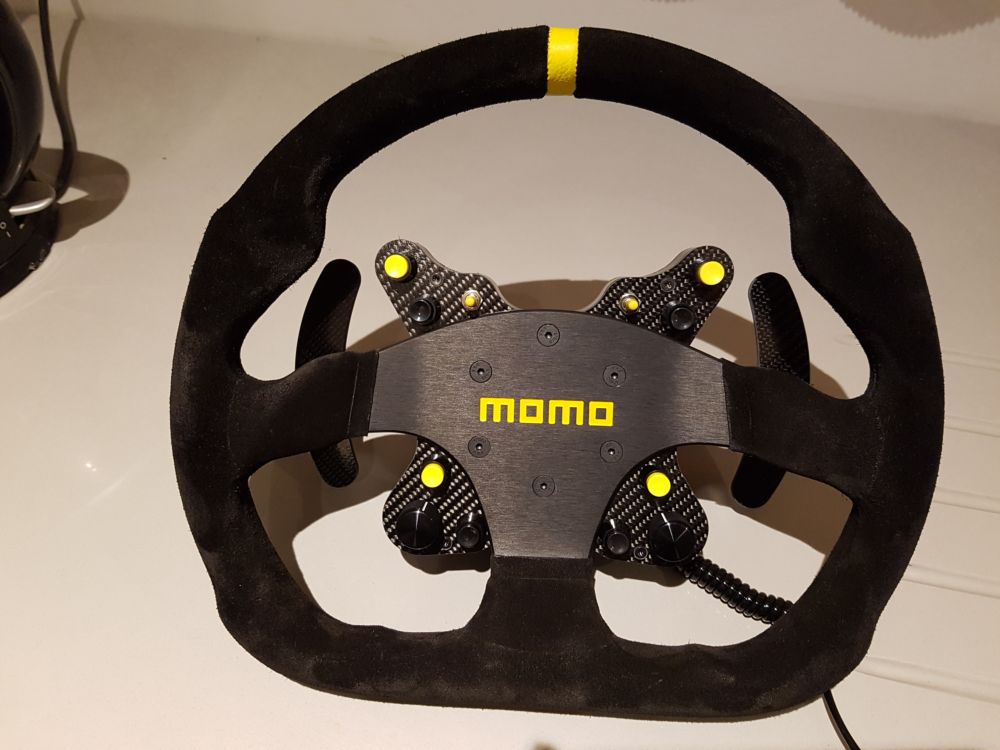

    got the paddles and QR mounted on the wheel. I really like the black and yellow combo.

    the paddles are not as close to the centre as they seem in the picture. they are in the perfect position.

    Beautiful wheel @crammy I love it!
    Is that a 30 cm. Alcantara one?

    Thanks @Blame73. its a suede momo mod 30, with a martin ascher C20m button plate its a 33cm wheel

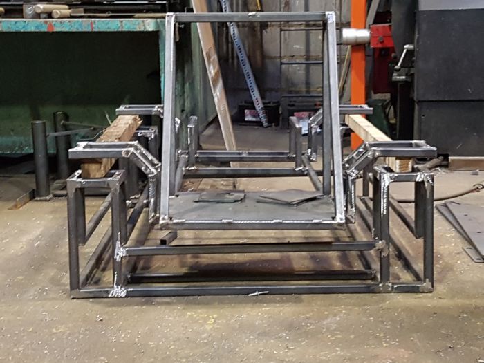

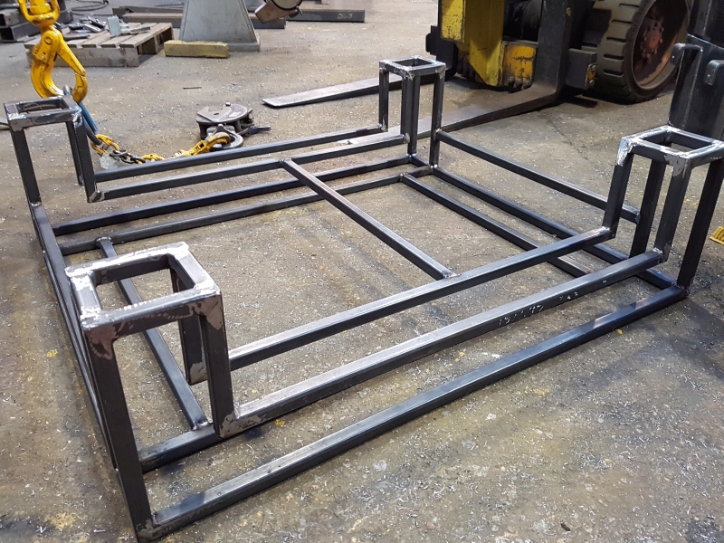

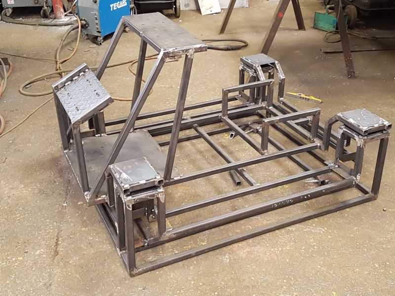

    ive managed to get most of the base done today. just got to put the wheel plates, and traction loss bar in, and also the for top plates to mount the actuators but need the plasma to cut those accuratly.
    I should be able to get it finished next weekend if nothing comes up, except for the pedal mount and the aluminium plate. the plates will go on after i have rewired it all neatly

  13. crammy
    Feb 23, 2016

    Thanks mate. I just re-looked at that picture and it does look big, but it must the the camera. it is 1200mm, long 1050mm wide and the 4 corners are 350mm high is only made from 25mm hollow section.

    and the weigh ?

    its only about 35-40kg mate so nothing drastic but is absolutely solid. its 2.5mm thick

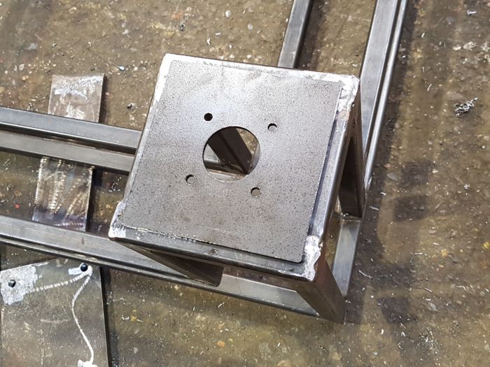

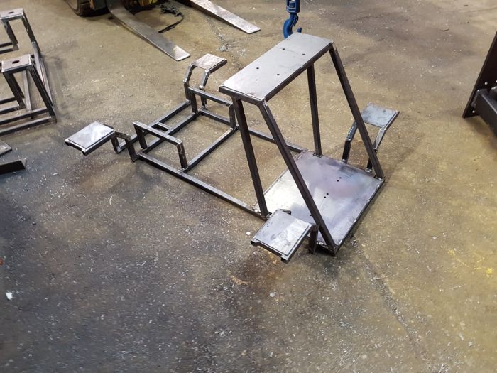

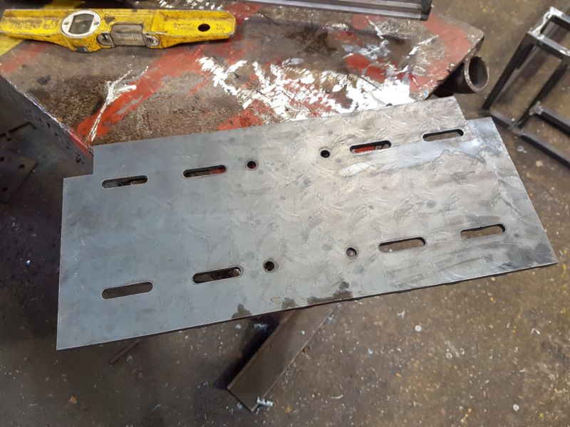

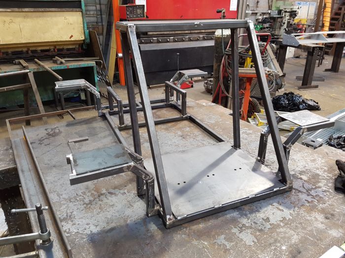

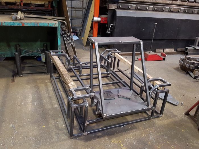

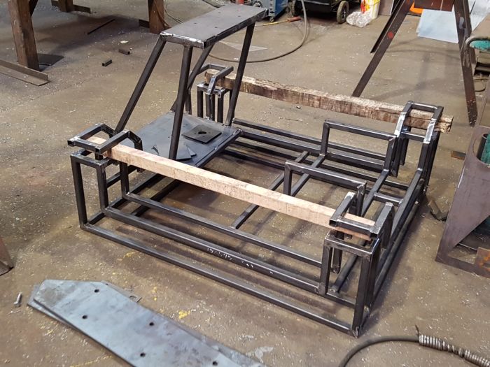

    Had a really good day today and got a fair bit done. I had a go on the cnc plasma too to cut the plates for the actuators, wheel mount plate, pedal mount plate and the plates for the top frame. What a fantastic bit of kit that is. It must of took 4-5 minutes to cut the lot.
    I may stay on at work in the week to get the traction loss brackets sorted and to weld the actuator plates, and top plates in.
    For now i opted for the pedal plate to be flat to take my t500 pedals. This was just an easy option to save time because when i sort the HE pro pedals these will be top mounted and hanging so will be removing the plate anyway, and modify to suit
    plate small.jpg floor small.jpg on bench small.jpg front small.jpg view 1 small.jpg view 2 small.jpg
    The wood was put there so i could get a rough idea of how it will sit.
    Overall i'm happy with the outcome

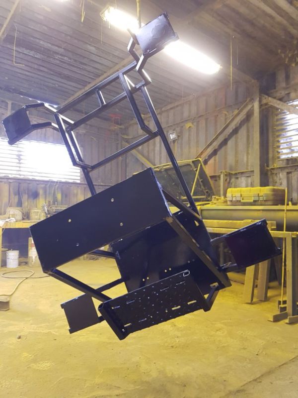

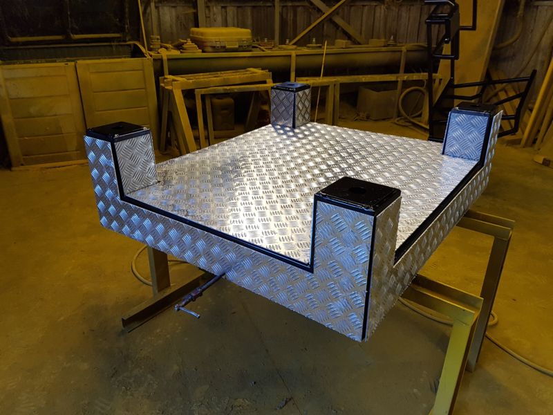

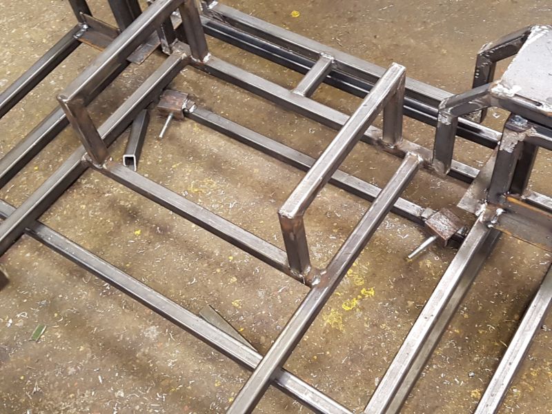

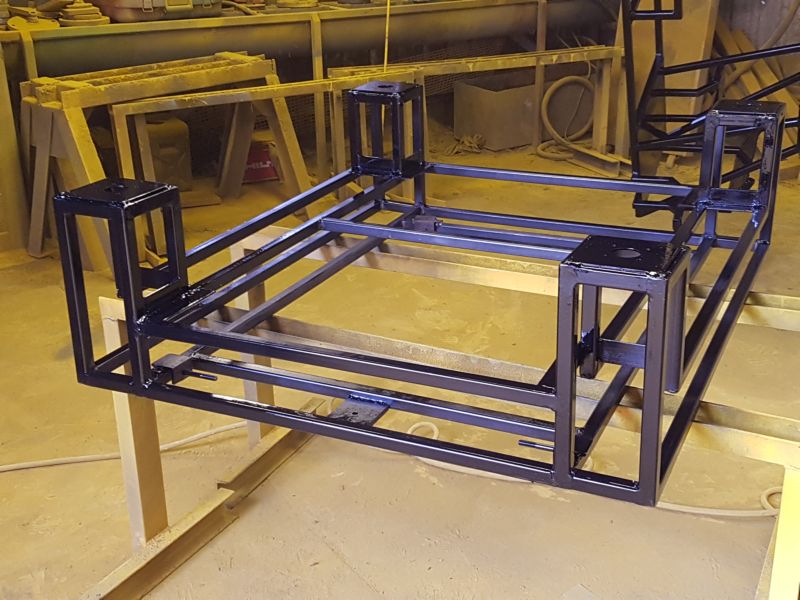

    Had another good day at work today. Its finished on the fabrication side. I will hopefully bring it home tomorrow to put the aluminum plates on and then i can start the tedious job of wiring it all up.
    I have got to machine some Nylon inserts to Go in the cups on the top frame so the actuators are not metal on metal, but no one had told me the lathe had packed up so i need to get that fixed.
    I have also put the new support frame in for the HE Pedals with the dimensions supplied by Svens at HE engineering, so when i get them in the next couple of weeks i can just bolt them on.
    I still have to make a mount for the handbrake but this will just bolt on as im not sure where i want it until that arrives.
    The first picture is the new pedal mount plate cut on the plasma today.
    I also haven't secured the aluminium in the pictures but i wanted to see how it looked and has turned out pretty well and looks like an arcade cabinet so i'm happy
    The close up just shows the rear brackets for the tractio loss wheels, but i will be playing without that for the time beeing, but can just bolt on my actuator and wheels when ready
