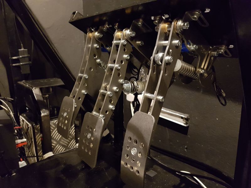

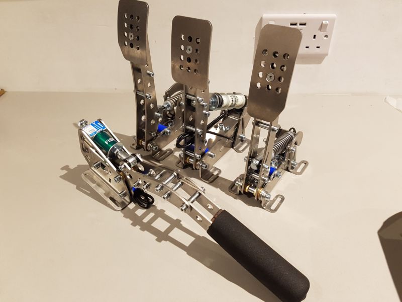

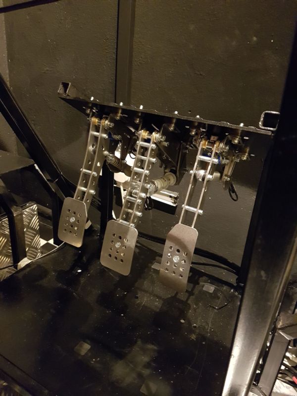

    quick couple of pics. got to say they are really good quality. ive got them mounted but will hopefully set up tomorrow

    well what can i say other than WOW. I had my first go last night after calibrating the pedals and they are awesome. especially coming from the thrustmaster ones. I first thought the brake was going to be too hard, but once set up they feel really good. i've got to strip it down tomorrow night though so i can get into work first thing saturday and alter the seat height and then i shall spend the rest of the day tweaking settings. it will finally be set up so i can just switch it on and play. I might make the bolt on handbrake mount too if i get a chance. I've also got the 30mm box section arriving today to make new monitor mount posts so i can bring them in closer.

    Had ago on a few sims now n the one thing that stands out for me was the pedals n how you feel in control of braking in game with them it really adds to the whole experience to make that extra step towards real simulation.
    One of the best things you can do tho is add a small transducer for abs or lock ups judder. Its mega.
