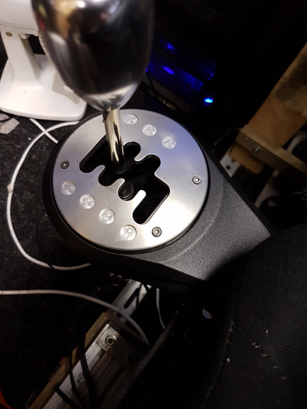

    Ive also got the TH8RS. i would be interested in seeing how you modded it. I think it's far to lose and just hasn't got a good feel to it. I would be happy with it if it was tighter as i do like using it at times over paddles. it was mounted before i made this rig and i used it when i got my OSW as i never had paddles until my ascher plate arrived.

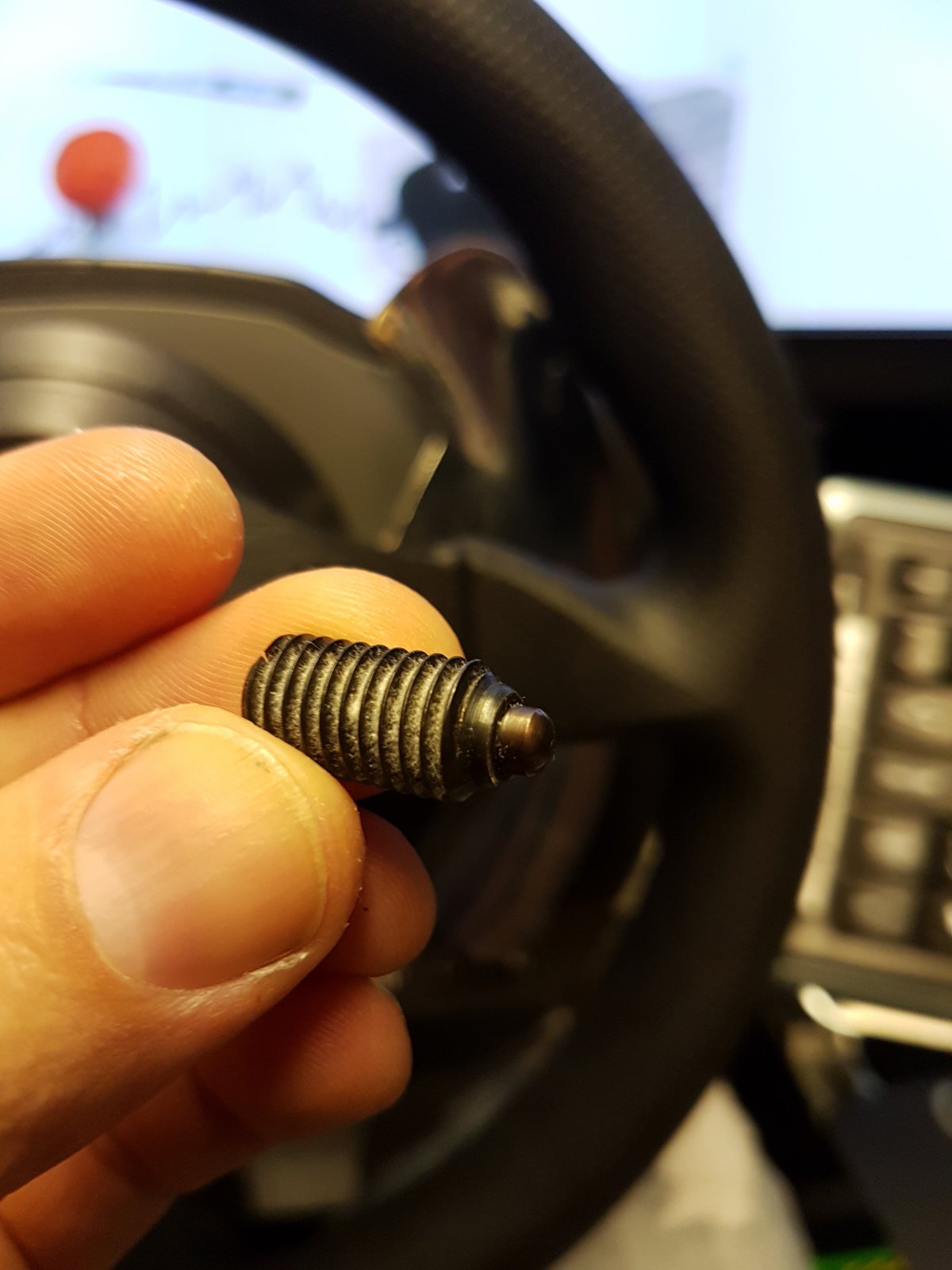

    Inside theres a spring bearing you tughten up to make it stiffer if you look on the opposite side of that theres a threaded hole to fit a second one so you get two spring balls fitted.
    Then you can use large o'ring or elastic bands to control the feel of neutral.

    its amod but can not remeber the name as it came with the package i bought it second hand with it on already.
    it make the world of difference tho big upgrade.
    i love the th8 rs tho.
    but its just abit weak so need sbeafing up abit.
    there just far too much travel on the stock on tho.
    i will try n find it out the info for the one i have ok mate.

    @f1iceman ill look online to see if i can just get one cheap first to save you making one unless you dont mind. definitely interested in that bearing screw though.

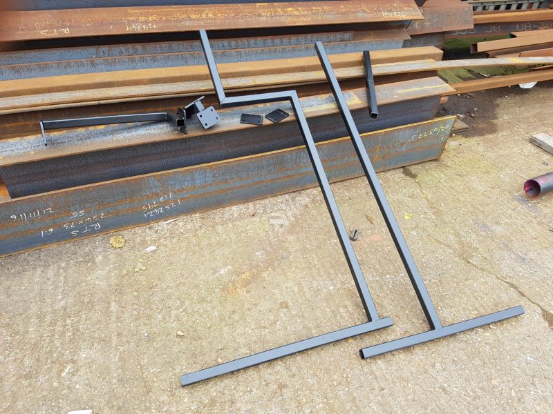

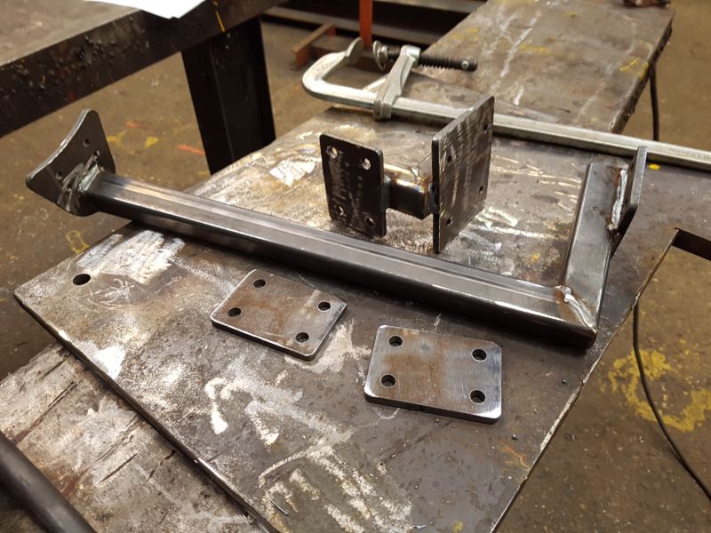

    I took my shifter apart tonight to get tightened up and have a look but then i forgot to bring the elastic bands home from work. I managed to get a bit more on the ball screw though. I won't be able to cut the disc on the plasma though as it definitely needs the curve in it, unless i can make some spacer rings too but for now i'll see how i go.
    I have just drawn up the brackets for bolting on the shifter and handbrake so will be going into work first thing to get them made, along with the monitor stands to get them closer.
    i think i will be ok with the th8rs shifter for now as i have drawn up a mount plate from the thrustmaster template to get rid of the crappy clamp and the mount will be solid, whereas i had side movement on my old setup.

    Ive done a th8rs mod for you all to look at ok.
    So you can see what i mean and have done.
    Dead easy mod n does work.

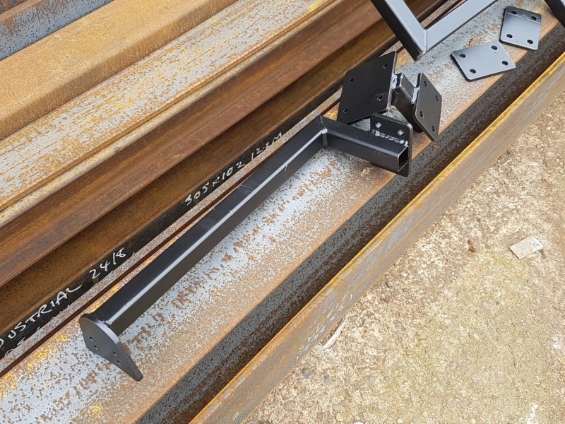

    i've seen the mod post mate, looks good. i forgot my elastic bands though and i had it wrote on my hand lol. i will have to grab a few of those screws, as i don't have them in mine.
    Ive have knocked up a couple of brackets this morning for the shifter and hand brake. the shifter now bolts direct to this bracket so should be strong, and the bracket bolts direct to the frame, as does the handbrake.
    Also knocked up the monitor stands. One is offset to allow the pc tower to sit in place closer to the front wall
