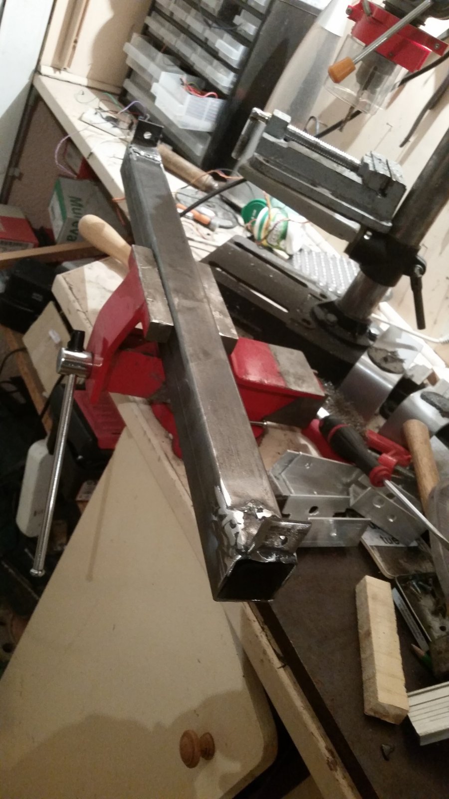

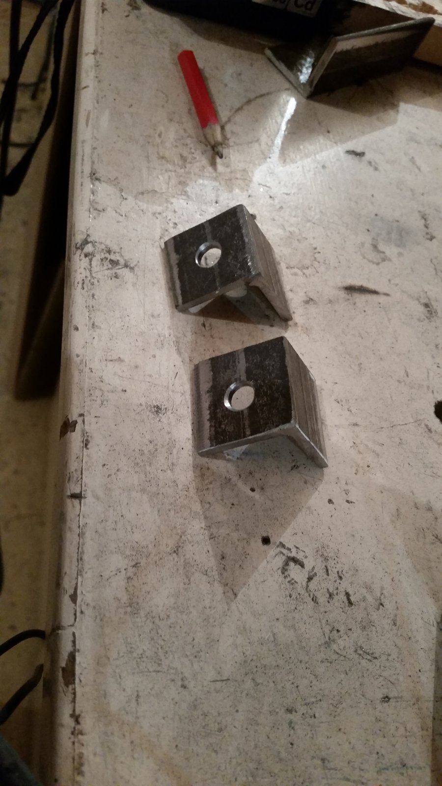

    Building of the new support for the arms of the motors.
    In my last configuration, the motors were not powerfull enough for the roll movement, so I calculate with simtool how to increase the force to roll axis: the solution is to enlarge the support. I will add some springs too to help the motors to come back at the origin position.
  2. creazyrider
    creazyrider Active Member
    Sep 12, 2017
    197
    france
    850Coins
    +56 / 1 / -0
    The new support finished

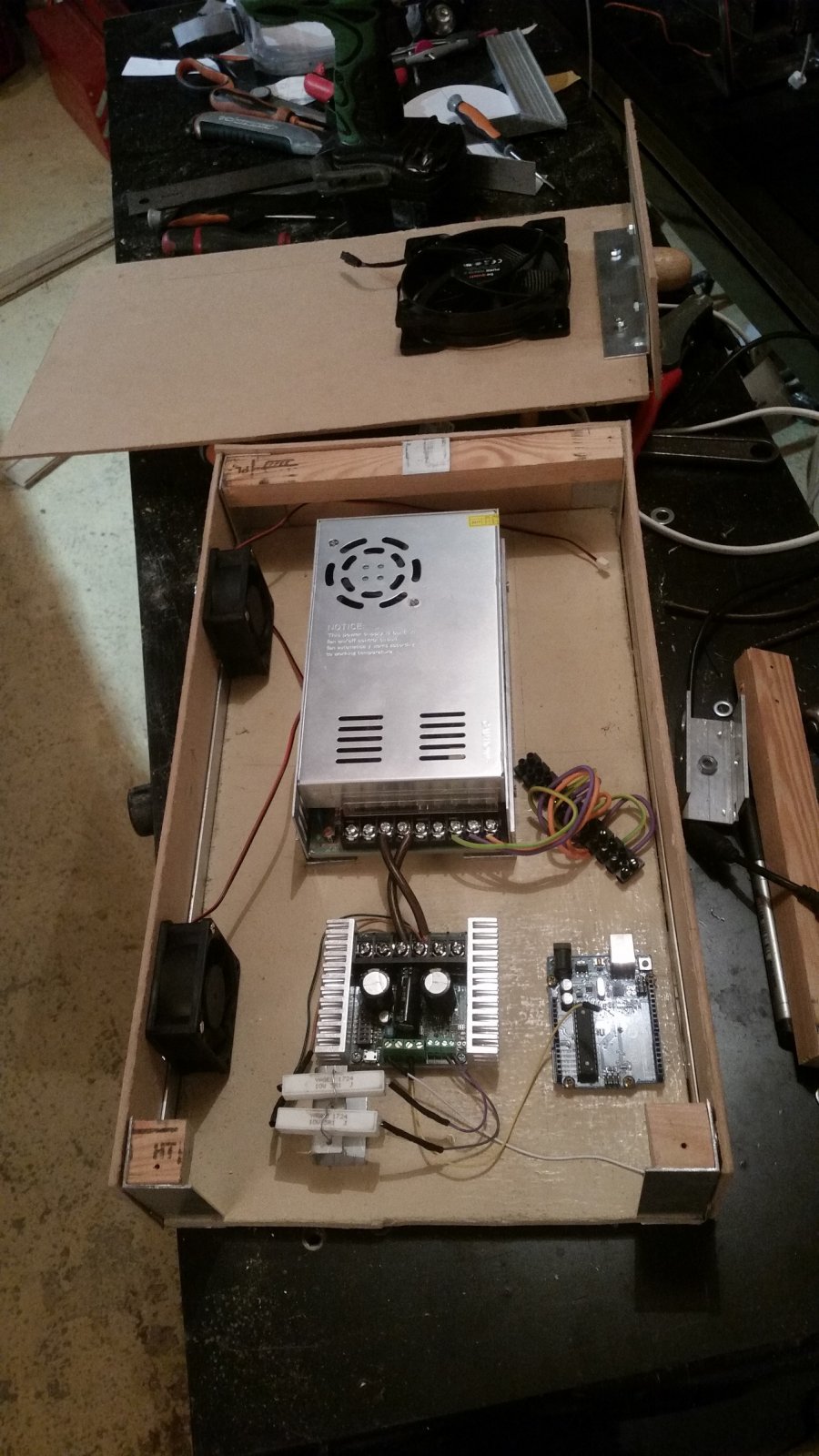

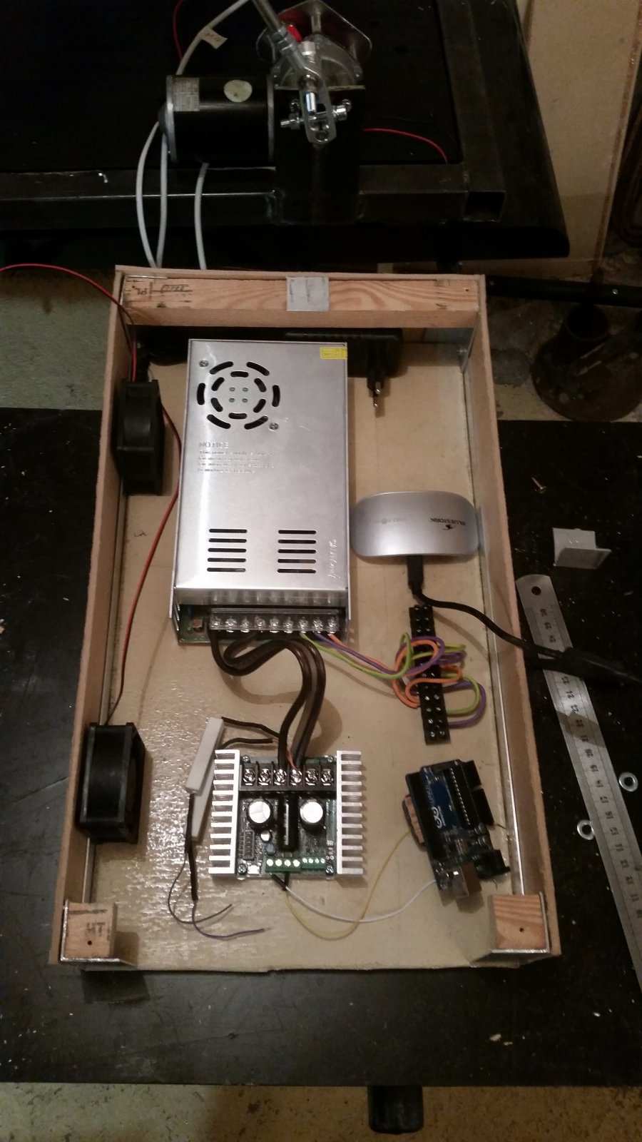

    The box for the electronics

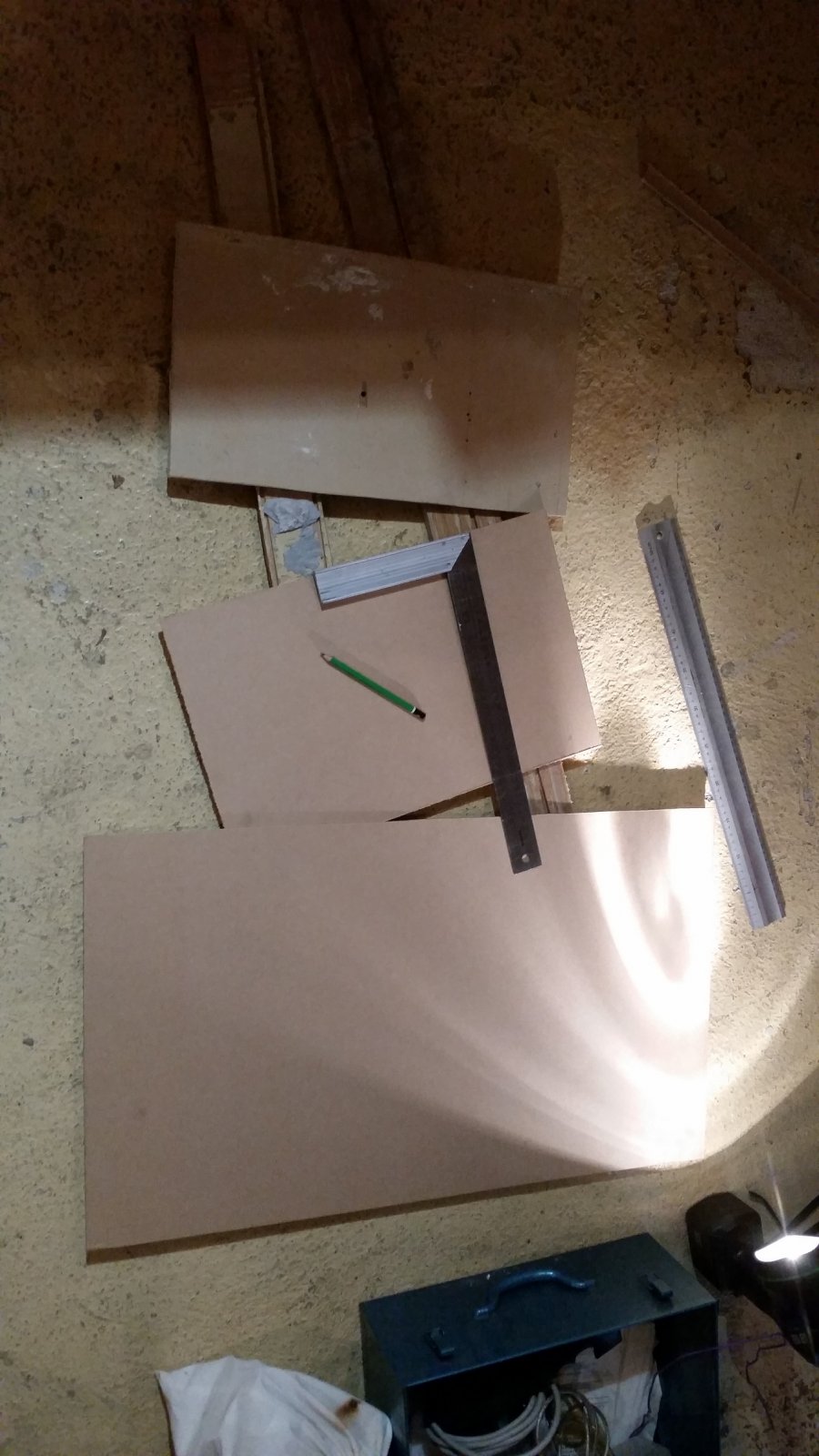

    Cutting the sides of the box

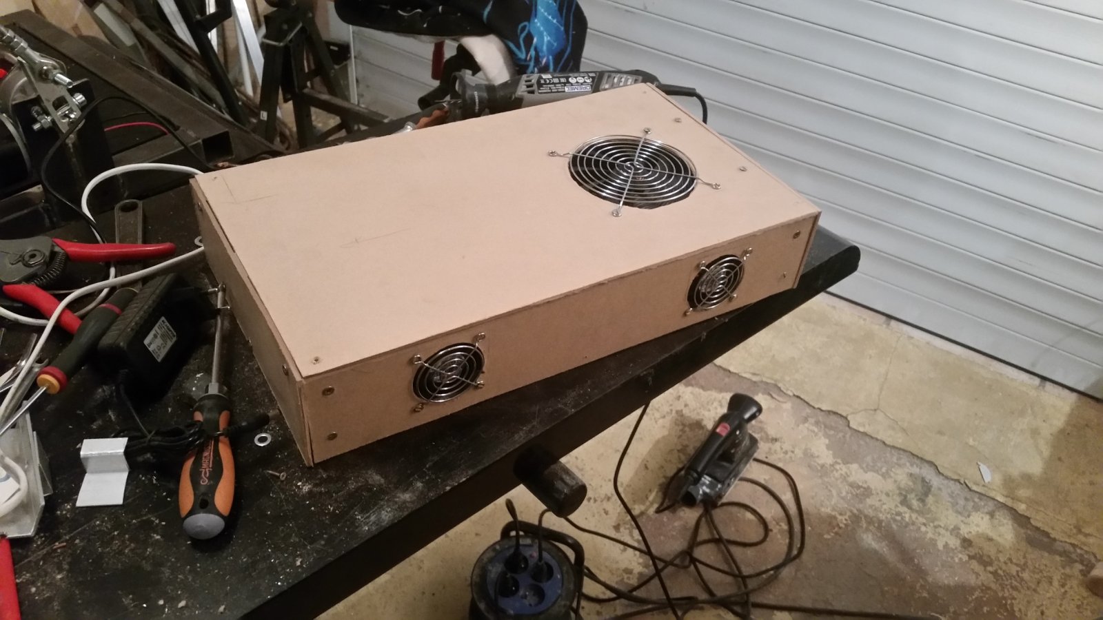

    The box with the fans

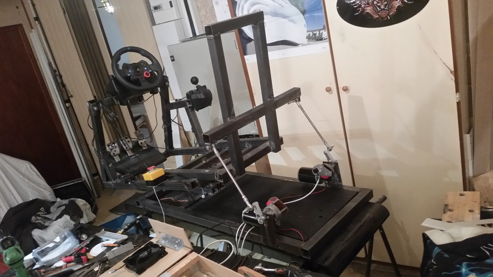

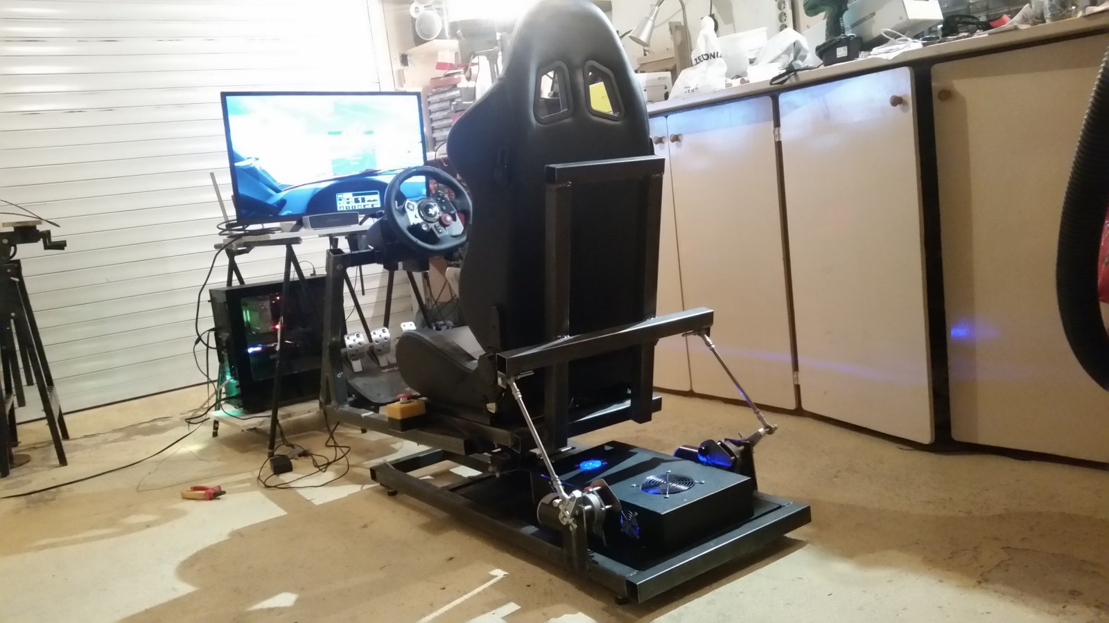

    The simu with the new position of the motors

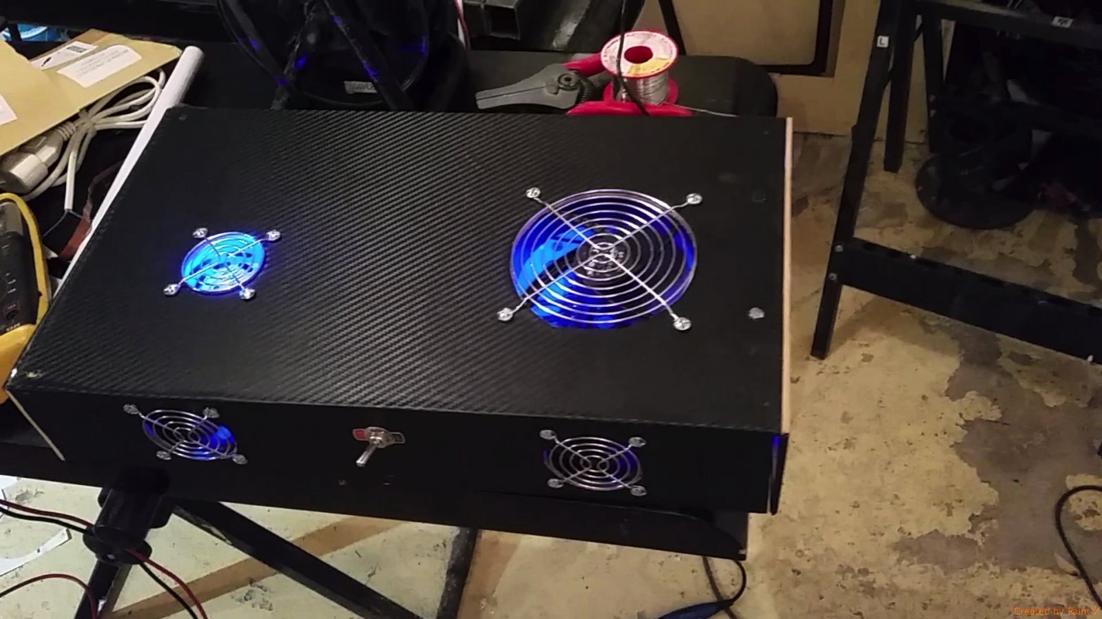

    850Coins
    +56 / 1 / -0

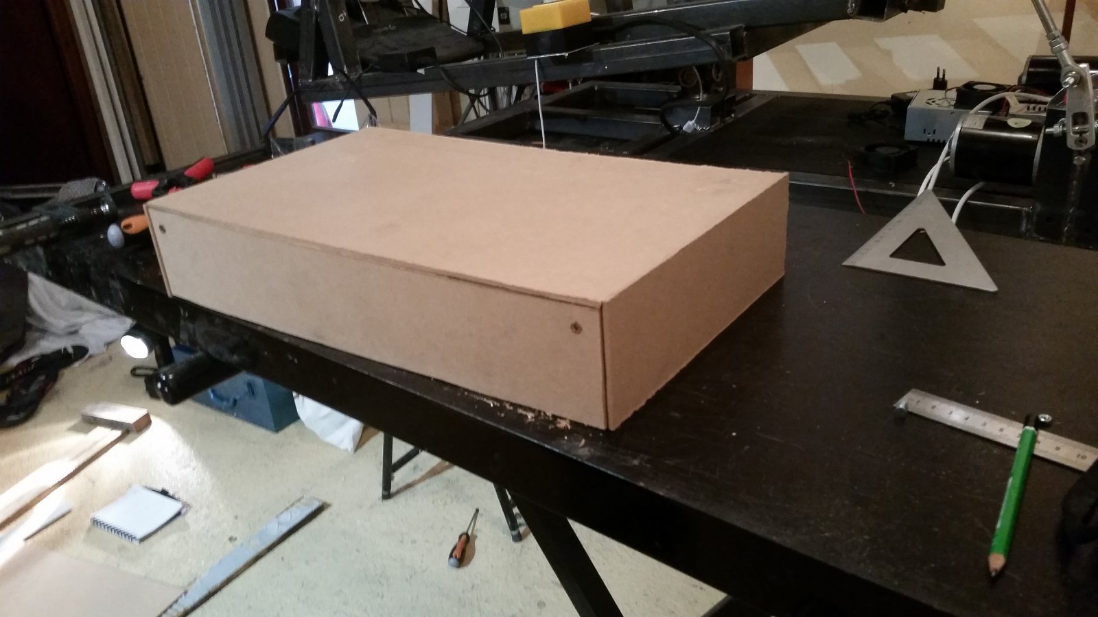

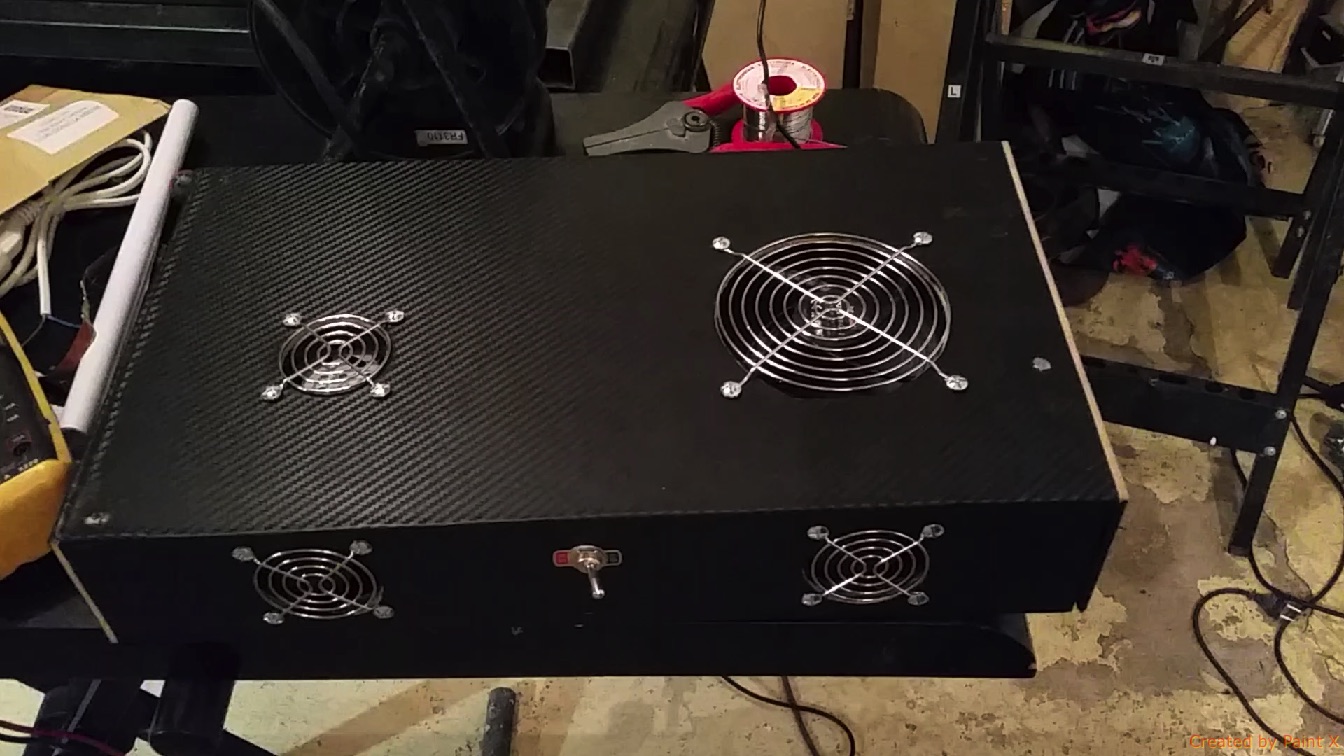

    Covering the box, wiring and test of the fans, OFF
  14. creazyrider
    Sep 12, 2017
    197
    france
    850Coins
    +56 / 1 / -0
    When the light is ON the fans are turning
    and a movie:

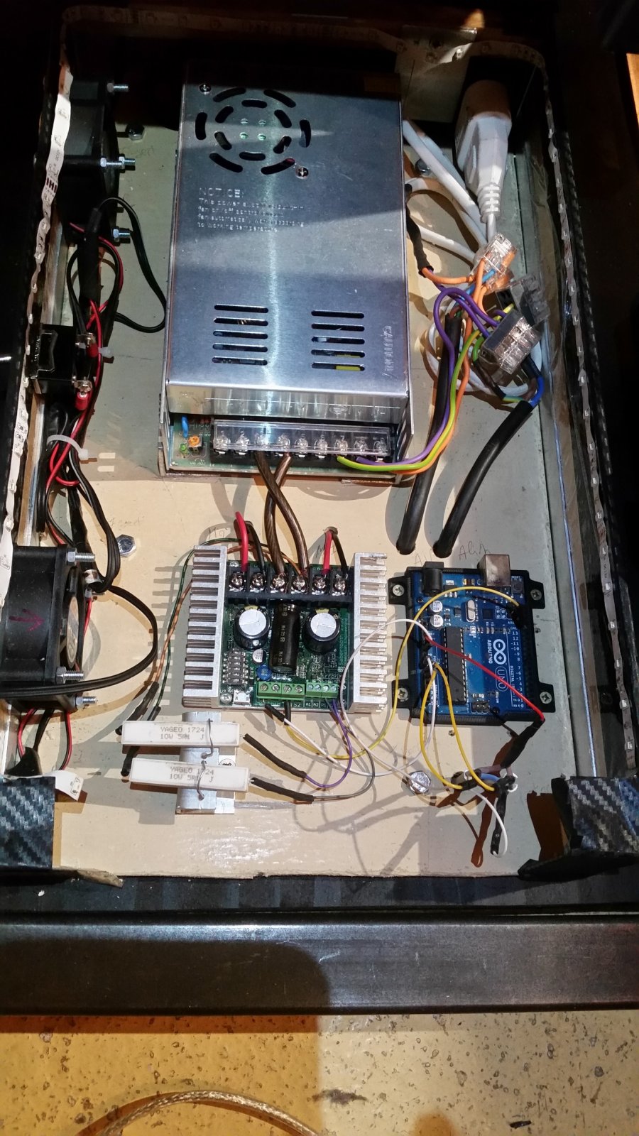

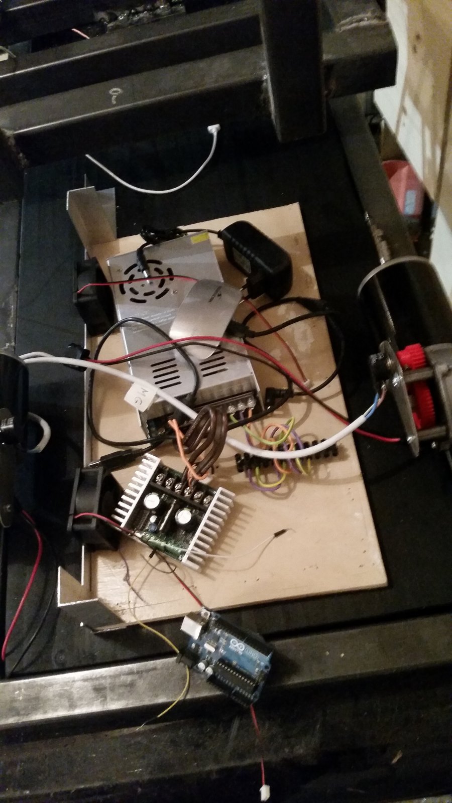

    All the electronic wired

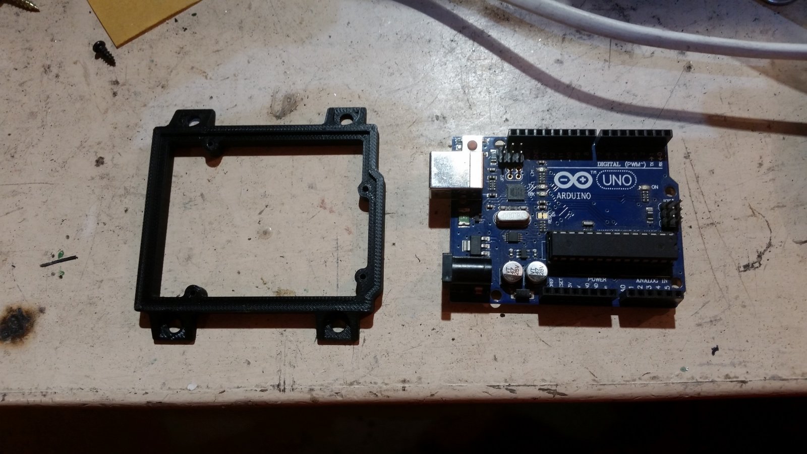

    Printed mount for arduino uno

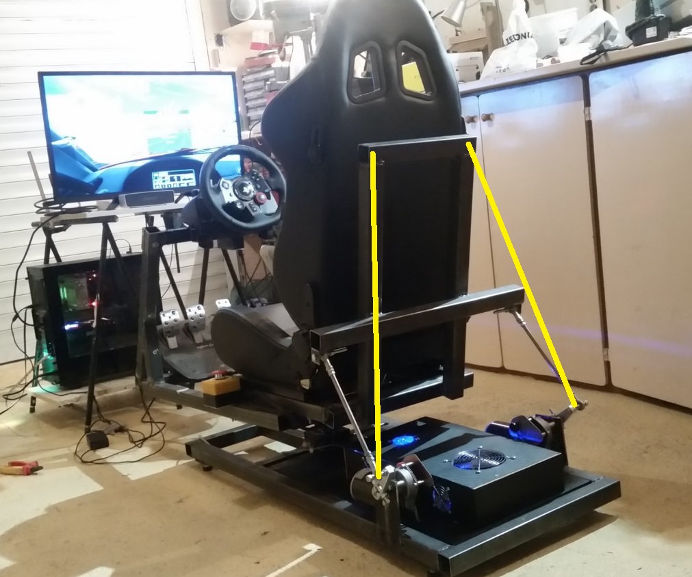

  19. prodigy
    prodigy Burning revs
    Oct 27, 2013
    459
    Croatia
    6,698Coins
    +399 / 4 / -0
    I am curious too see a video of the movements.
    I'm thinking that it would be less stressful and easier for motors if you maybe mounted the rods higher on the seat frame, like this maybe:
    I know that mounting high to shoulders works best for the seat movers, but I'm not 100% sure with full frames like yours. I guess when the motors are positioned behind the frame, it is better to mount higher to the shoulders.
    Maybe someone can back me up on this?
  20. creazyrider
    Sep 12, 2017
    197
    france
    850Coins
    +56 / 1 / -0
    That what I wanted to do at first but after using simcalc it seems that it's not the better configuration.
    Actually I had no problems with the pitch or surge, the problem was with the roll and sway but now with the new position of the rods it's working fine.
    I will add 4 springs to help a little bit the motors.
