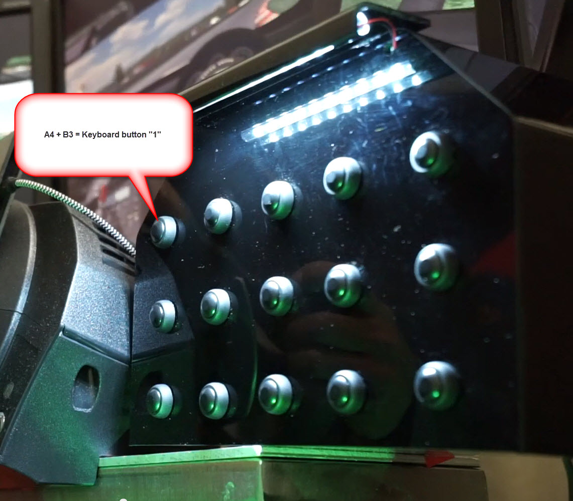

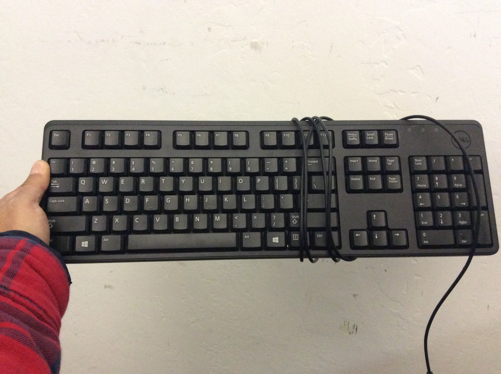

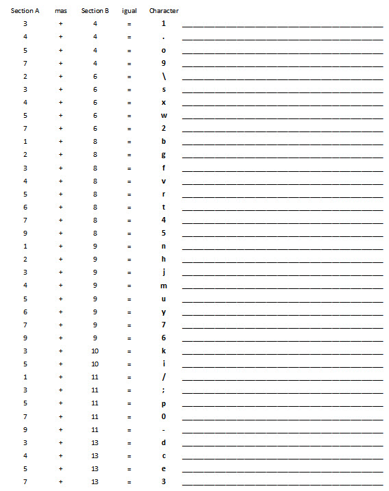

    Button box made from a keyboard

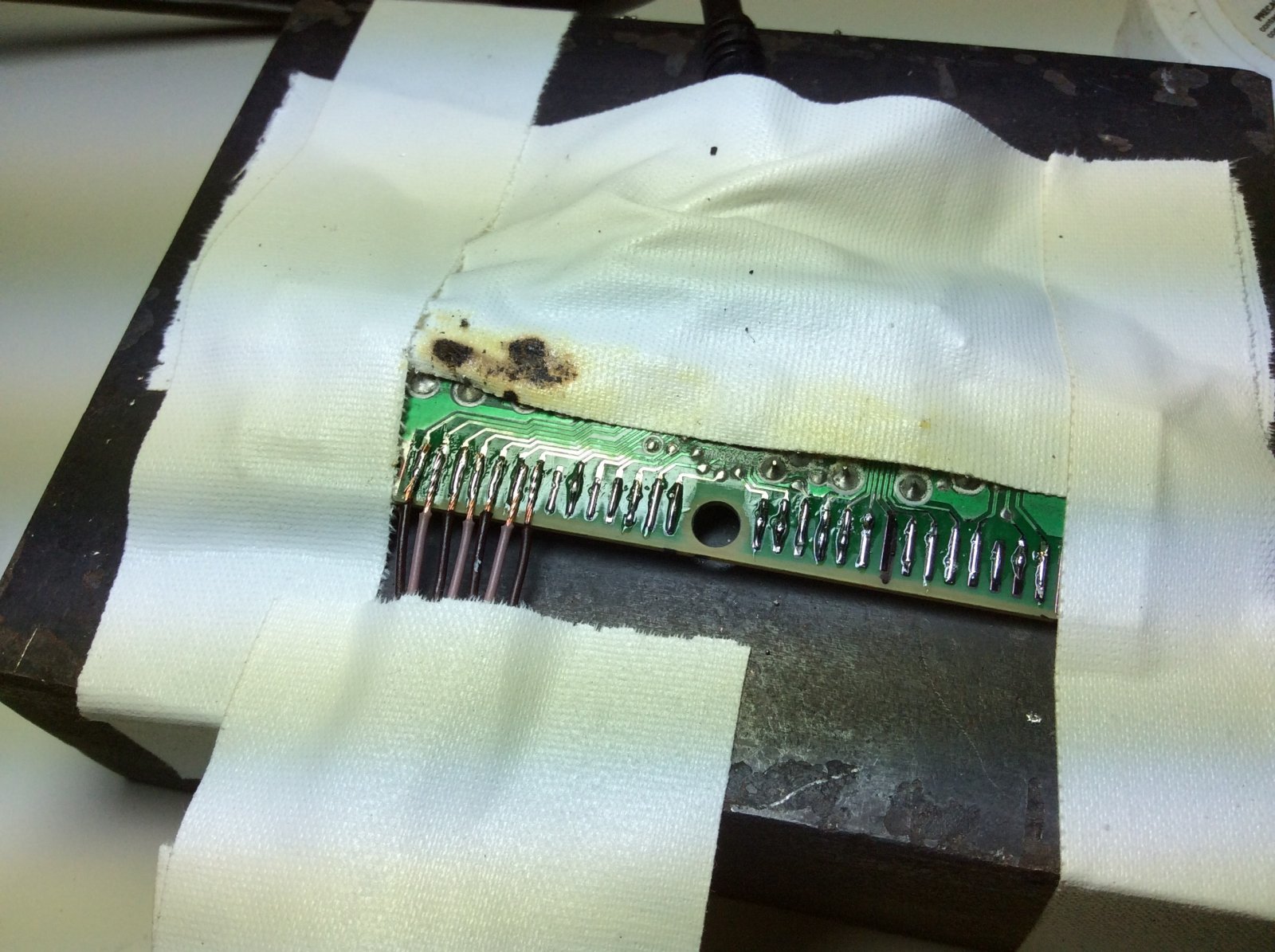

    I like to prepare the board by adding a little of solid to the area first.

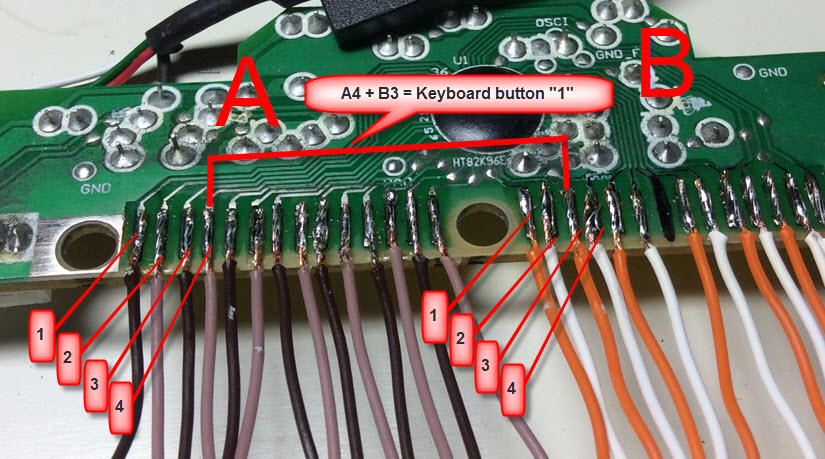

    This is the cross reference keys I get from this particular keyboard, Note not all the keyboards are the same.

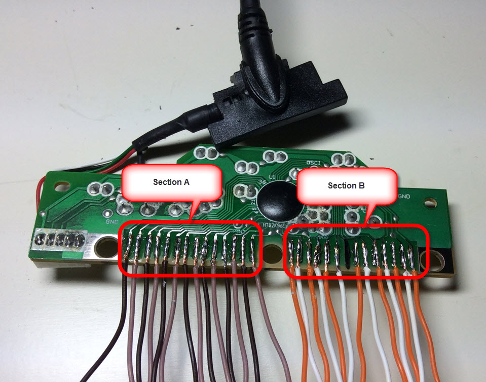

    I separated the wiring by Sections, all keyboards are a mix of wires per example to get a lower case letter "a" is just one wire from section A and one wire from section B if you at max you will get in between 35 to 40 buttons if you need more you can mix three wires and you will get Upper case etc...
    this is what I get from this keyboard, just remember that not all keyboards are the same!

    This is the button box I build for the keyboard.

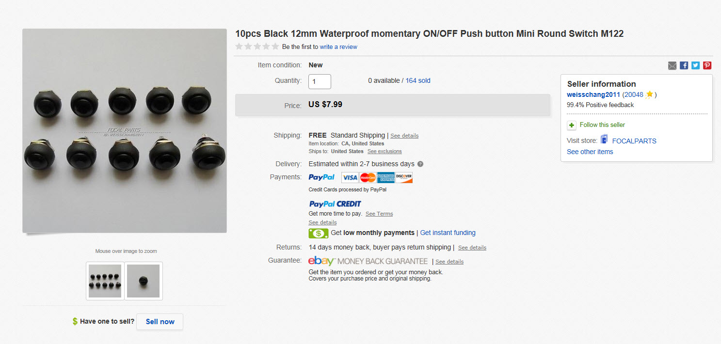

    Those are the buttons I purchase from ebay.

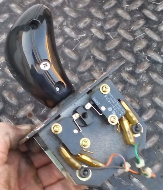

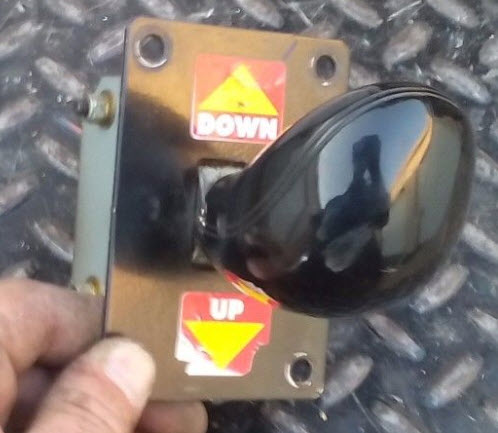

    I purchase a console game shifter that i am planing to adapt to the button box, i have map 35 inputs for the keyboard button box and i am taking two and connected to the limits switches.

    Can you share some price info on the gear stick?
    Also...
    A inside look of the shifters mechanism (the mechanical part not the microswitches) might help some diy copying if you would be willing to share some photos.

    All it is is a t shape on the shaft, when you pull back it twists and hits the flapper switch.

    Yes!, I paid $50 with free shipping, but they varied from $30 to $75 dollars, go to Ebay and search on Arcade Gaming for Shifters. you will find a lot of them.
    they are most of metal and they are heavy and build like a tank no spring construction all pressure driving and returns to center on the spot.
    I hope this helps!

    I was not referring to the electrical part as I stated in the post.

    I will take pictures when I get back home tonight.
