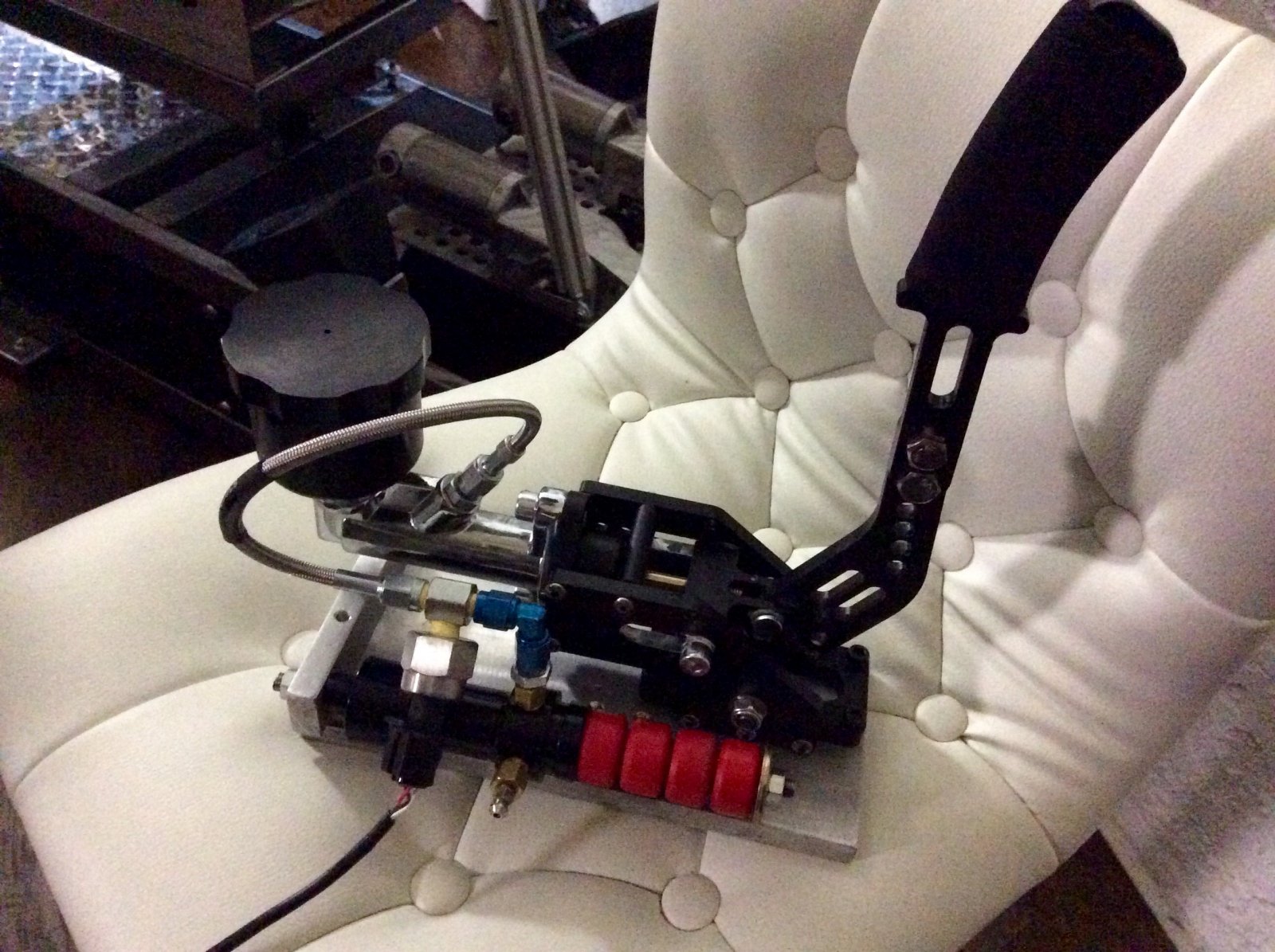

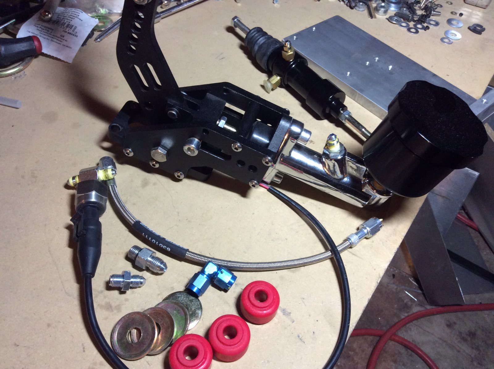

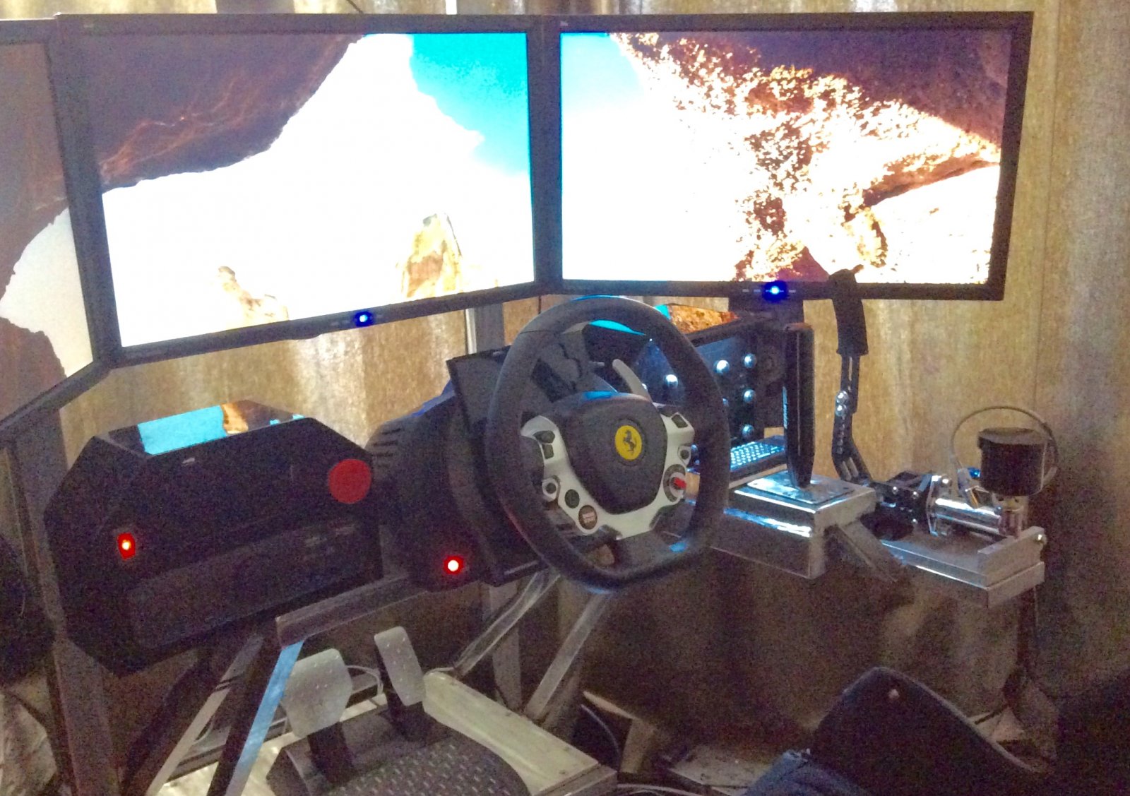

    Here is a video of the handbrake it seams to be very hard to pull, so i will try to add a soft skateboard bushing.

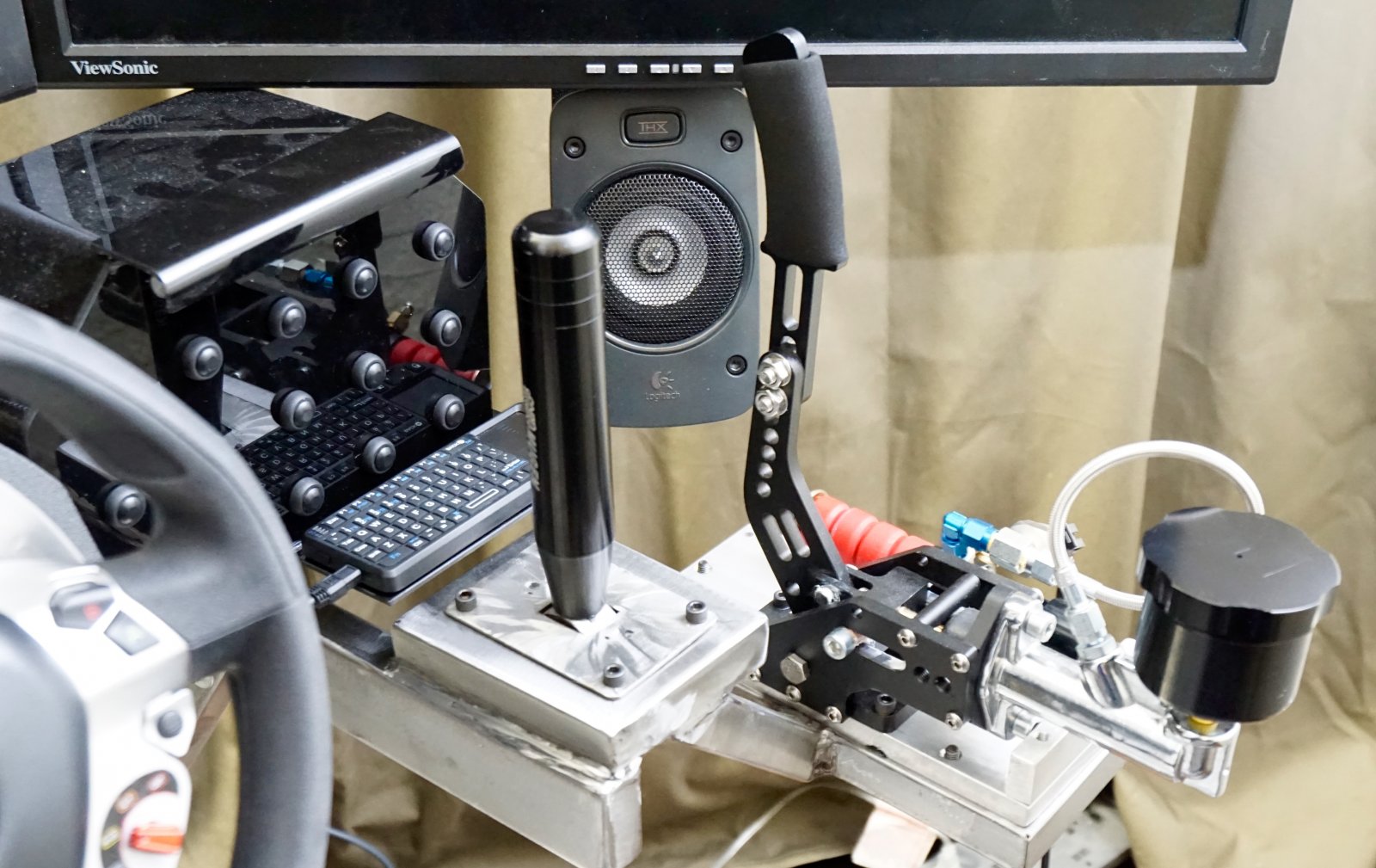

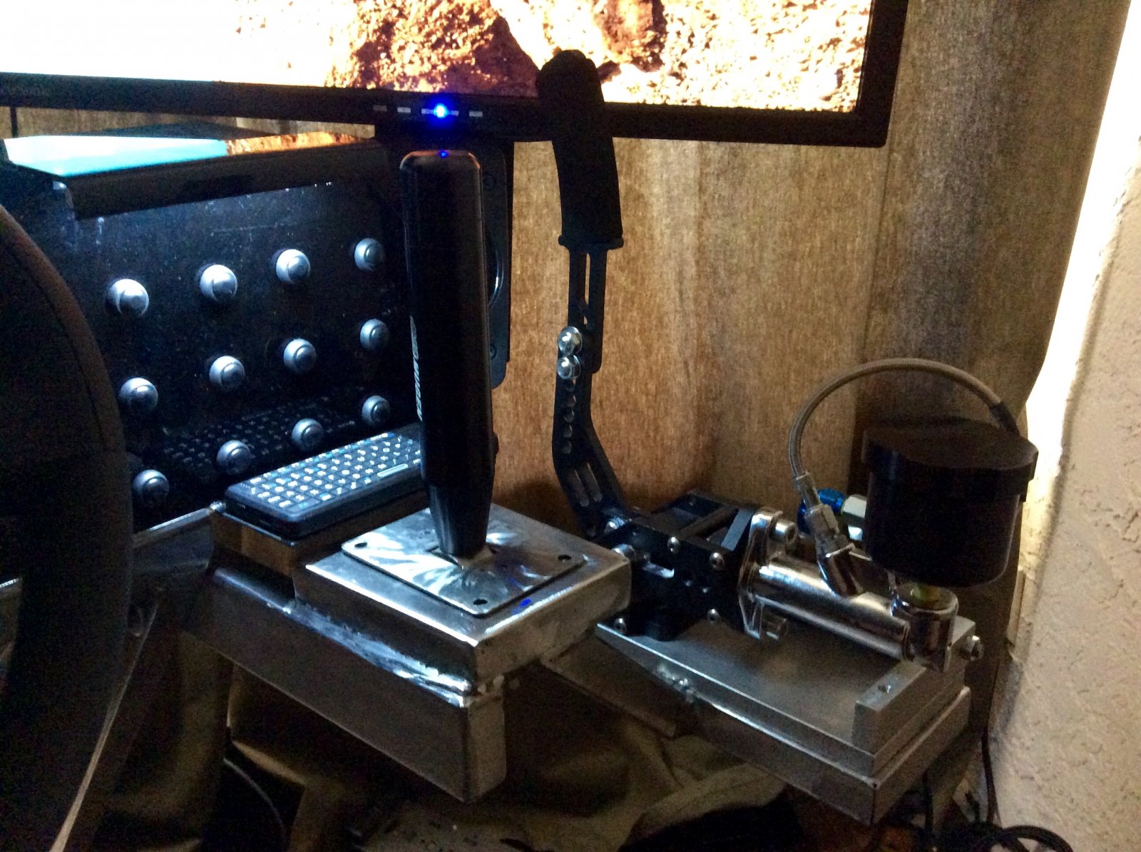

    Update on the handbrake, i build a bracket for the handbrake amd the sequential shifter, take a look:

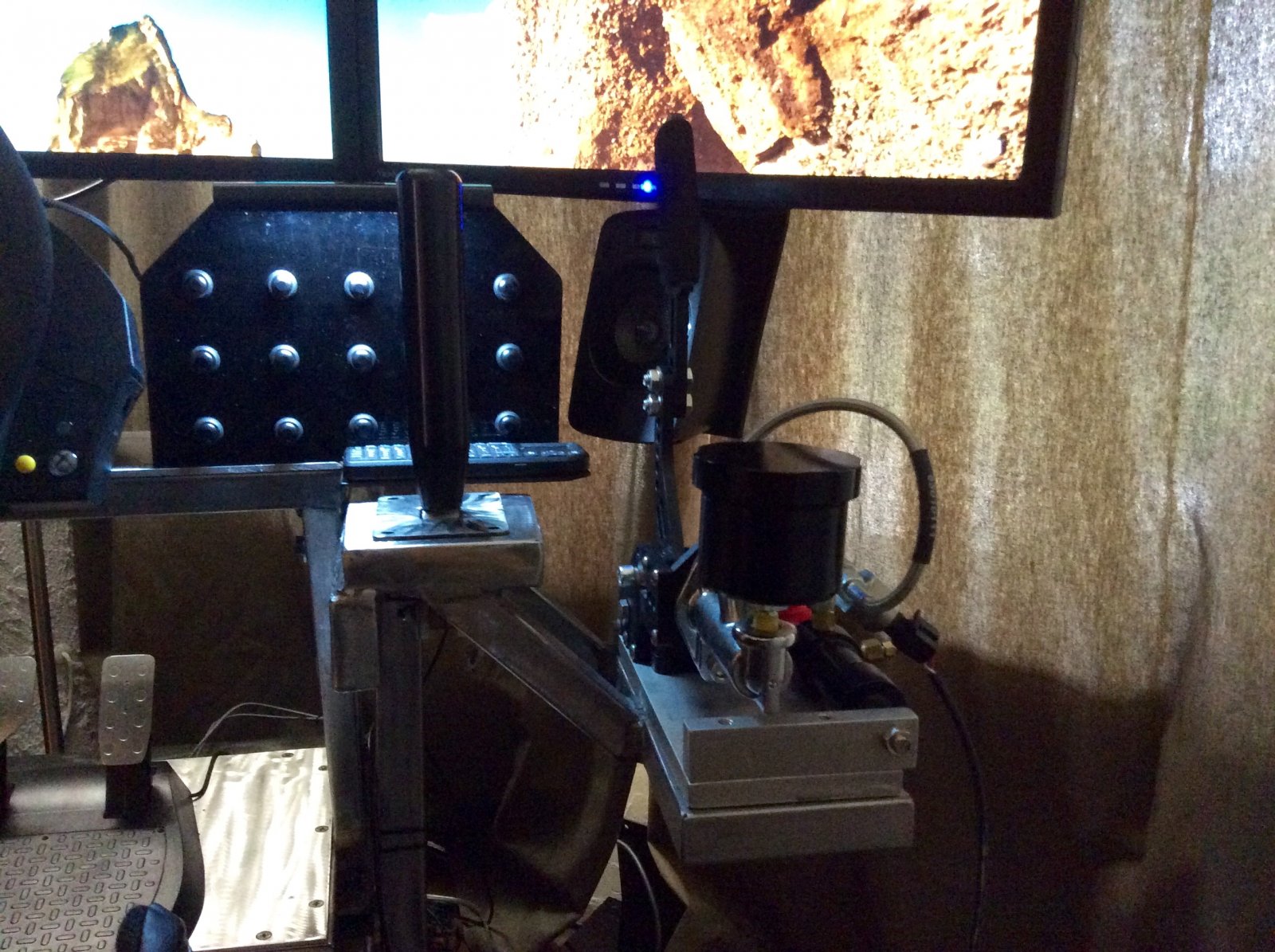

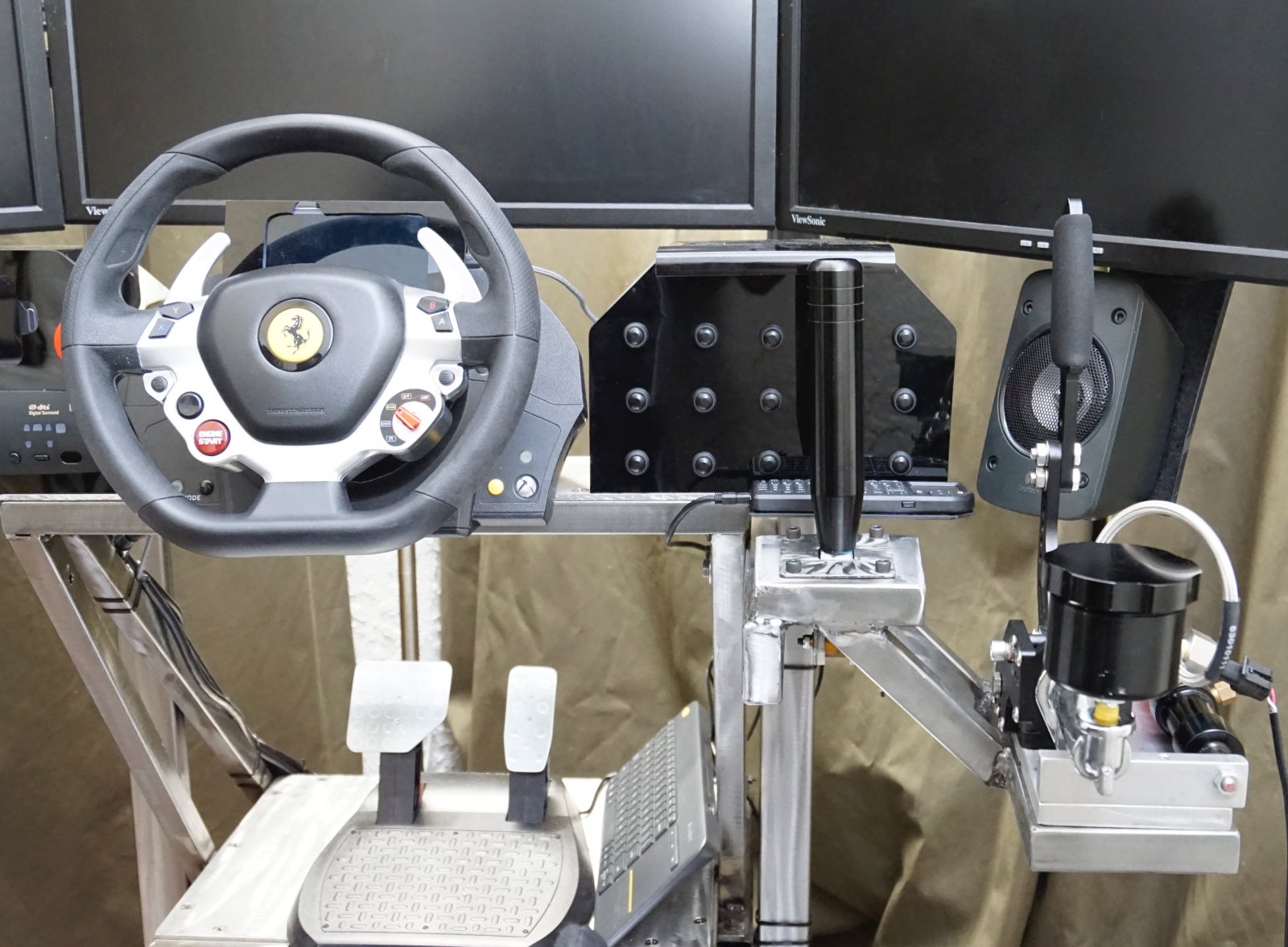

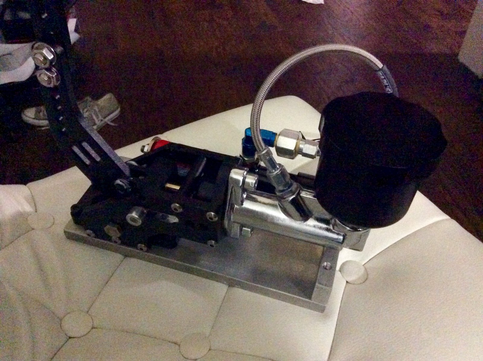

    Sorry for the bad picture, here better ones:

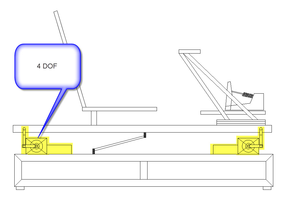

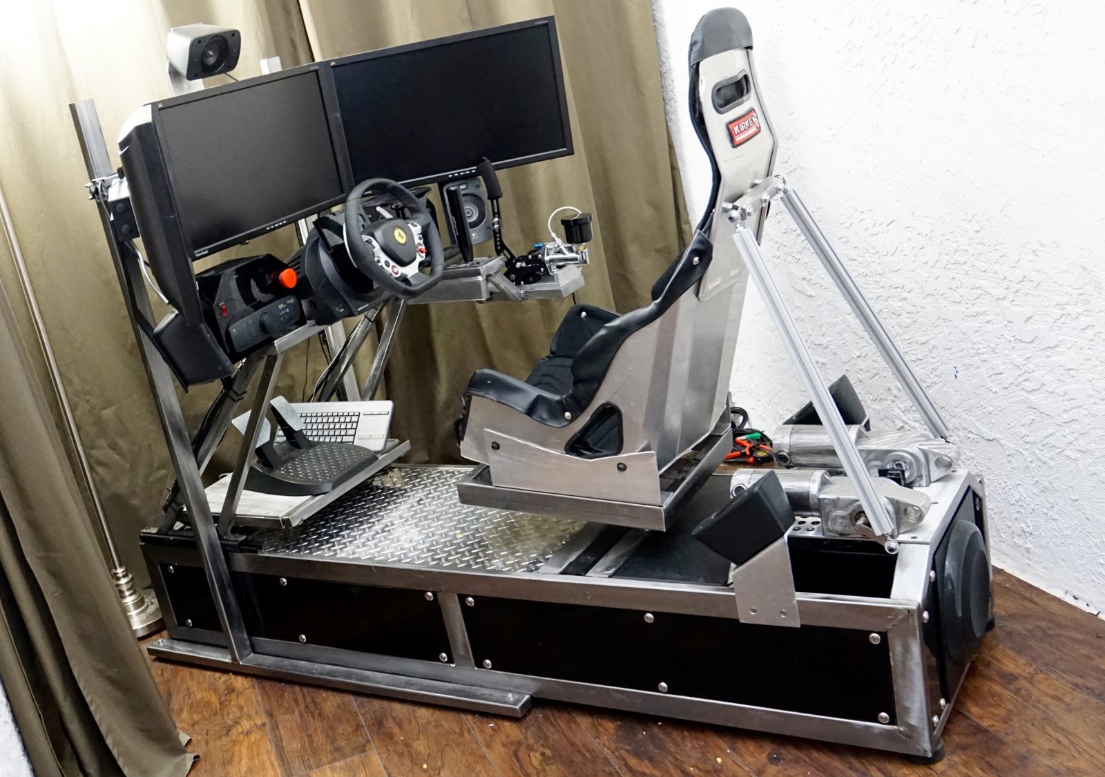

    the Flu got to me so I was down for few days but I am back, i have a question have any of you have build a 4 DOF ?
    i may build one and sell that one i have now see scratch drawing:
  12. pipis2015
    pipis2015 over-boost
    Feb 18, 2015
    221
    Athens, GREECE
    10,248Coins
    +272 / 1 / -0
    Is that a four motor design?
    At the four cornenrs?
    What dofs are you planing to implement?
    1.Pitch
    2.Roll
    3.Heave
    And(?)
    Edit:
    or is it a :
    Pitch,roll,sway,surge,heave design(3dofs emulating three movements and two forces3+2=5).
  13. Milton
    Nov 11, 2015
    345
    Dallas Texas
    1,989Coins
    +320 / 4 / -0
    3DOF, JRK
    Yes! 4 motors, Surge, pitch, Roll and Heave. Just like the VESARO but using Motors instead. Is that posoble?
  14. pipis2015
    Feb 18, 2015
    221
    Athens, GREECE
    10,248Coins
    +272 / 1 / -0
    It sure is possible.it can even be done with three motors(triangle position) instead of four.
    It's a 3 dof platform (pitch-roll-heave)... that can also trick the brain to perceive surge and sway effects.
    like a 2dof design (seat mover) like the one you built can "do" pitch and roll + trick the brain for sway,surge and heave.
    It may not be as responsive as a seat mover.
    I think if you wait for more answers lots of guys will elaborate on that.

    So seat movers are better because of the resolution on motion?
  17. SeatTime
    2,572
    +2,854 / 40 / -0
    All things being equal, yes that is normally the case, due to the extra inertia of a full motion rig, but with a bit of though in design, I can contest that you can build a full frame that actually has better resolution than most seat-movers (well my previous one anyway :think).

    Wow! I am glad i brought it here for discution, it looks like based on the leaner speed and force calculations the motor has to be very big and have lots of torque, i decited to stay with my seat mover.
    Thank you guys.
  20. Archie
    Archie Eternal tinkerer
    Dec 31, 2014
    1,081
    Wollongong, NSW, AU
    3,797Coins
    +1,382 / 4 / -0
    Good choice @Milton Amaya - Having built both versions, I much prefer the speed / resolution of a seat mover.
    I built a full frame for flight sims and if I was ONLY playing flight sims, I'd still have a foot mount.
    For racing sims, you simply can't go past a shoulder mount seat mover.
    It's violent compared to my old foot mount. I had to delete all my old profile are start again to tone it down!
