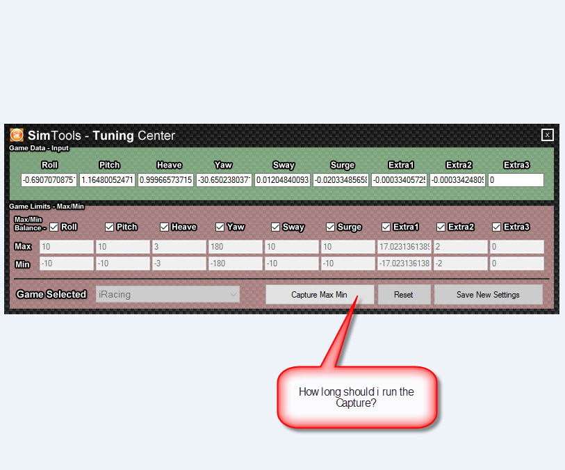

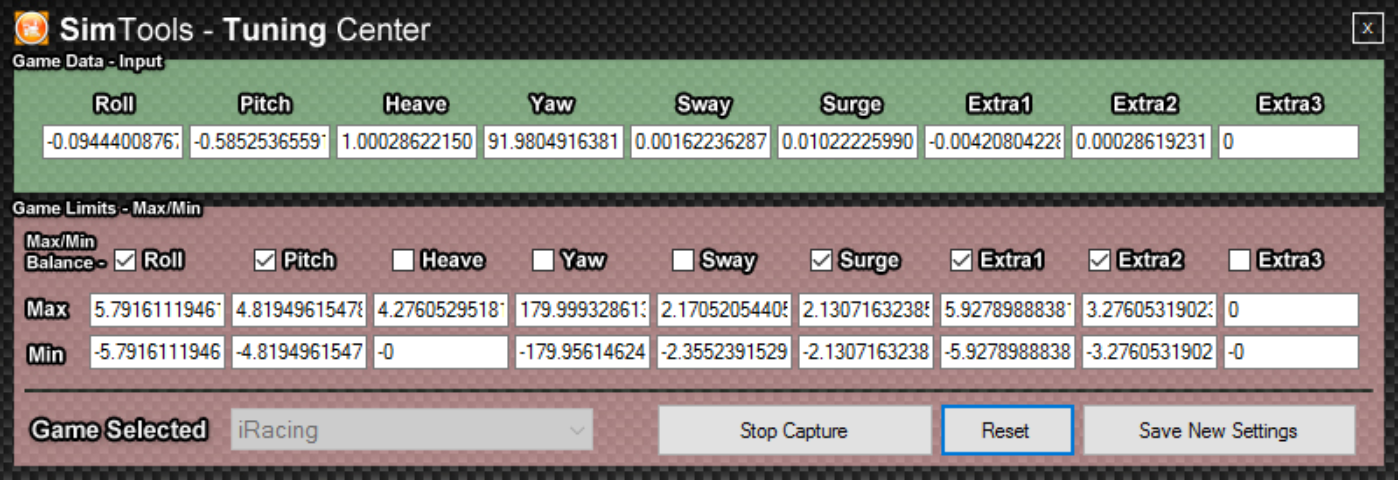

    Question: How long should I run the Capture in tuning center?
  4. Nick Moxley
    17,057Coins
    +2,507 / 30 / -2
    This is something we've sorely been needing for a while. A In depth tuning guide on how to maximize your motion. v2.0 will have something along these lines.
    Capturing needs to be done for Way longer than a few seconds. you ideally need to run a "CLEAN LAP" and monitor the #'s the tuning center is outputting, (UN CHECK THE LITTLE CHECK MARKS in Tuning ccenter) Remember tho Different style's of cars will output different min/max's. So be careful what you set your default #'s on. A Super Stiff F1 car isn't exactly ideal for setup, you want something with a little suspension movement, a little body roll.
    next you'll want to take those tuning #'s and somewhat round them off....so if roll gives you a 10.8908787899 make it 11.
    Do 1 force at a time, this will make it easier to pick up twitchy data/tuning center #'s and allow you to tweek those #'s to get the feeling your after, Also dont forget about Axis % for the particular force your working on.

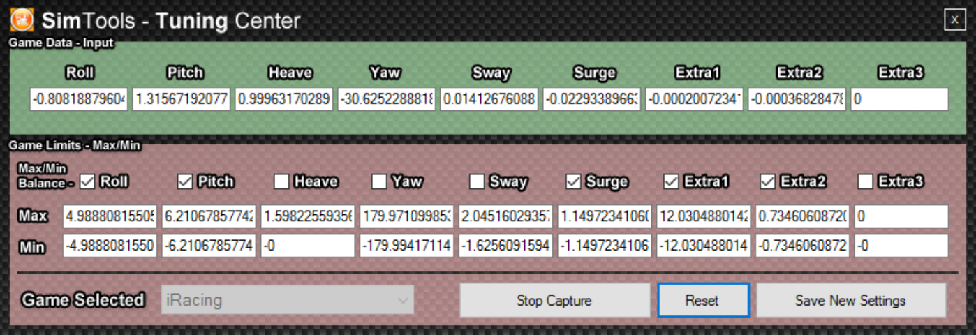

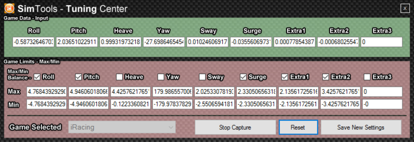

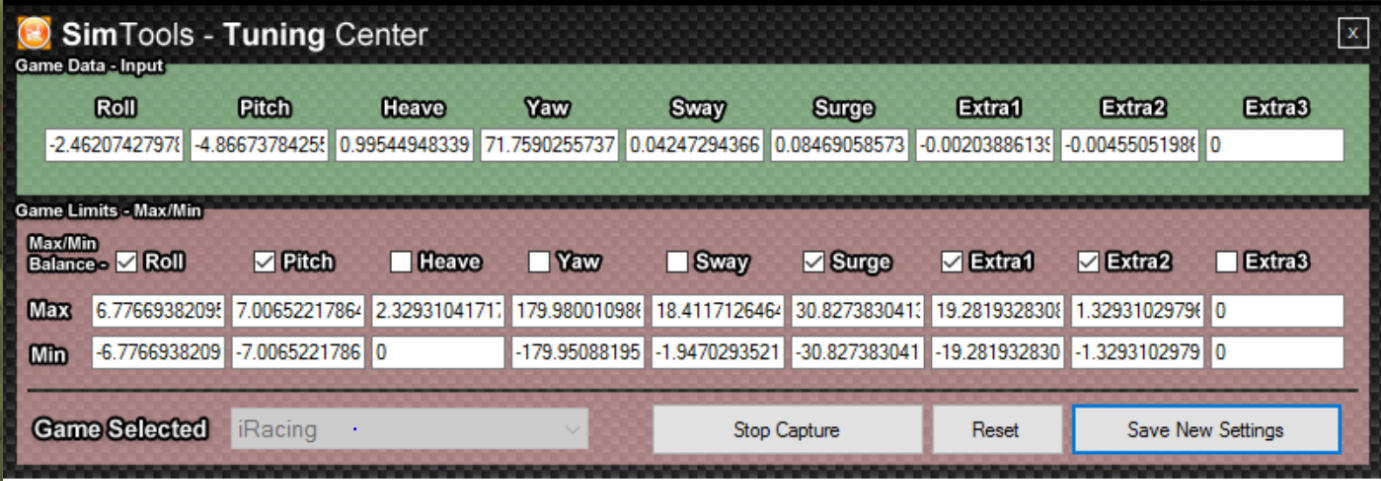

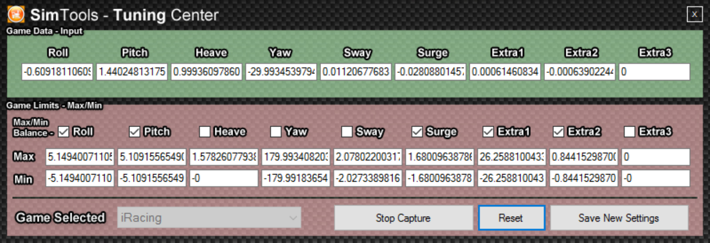

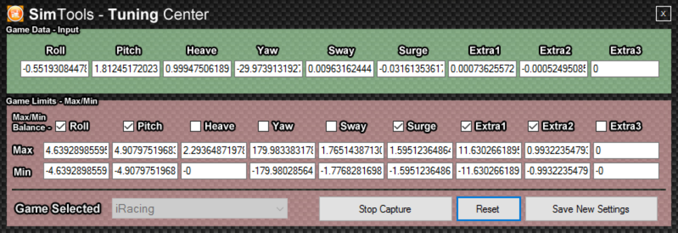

    I run Tuning Center and capture the Game Data for few cars I did a full lap in Suzaka Racing Course Grand Prix config on each car and got different results I am just wondering witch one should I used for my tuning parameters please take a look at each result:
    Capture Audi R8
    Capture Lotus 49
    Capture Mazda MX-5
    Capture Renault 2.0
    Capture Skip Barber
    Capture Mclaren MP4
  12. Nick Moxley
    17,057Coins
    +2,507 / 30 / -2
    I cant say Which to use per say, As i can see you did some different style driving on each car, How can i tell, well by your Extra 1 axis, the Fact you pulled a max of 26 on the lotus means you were wagging that tail around pretty good to access that big of Extra 1 value, The Renault value is next to nothing which meant you didn't drive the Renault Anywhere near the limit, which also poses another problem. if you Drive your Capture min/max lap at a Snails pace and dont actually replicate what you do while driving, your only hurting your profile in the end. The only thing you dont want to do while trying to monitor your min/max's is smash a wall or find yourself on the grass or sand trap. That will skew the #'s for that run and you'll have to start over.
    I also dont suggest using 1 set of #'s,....this is where you have to individually feel each force withe different axis %'s and with small and large Tuning center values. some cars/forces can be used in common between a F1 car and a Street Car, For example Roll and Pitch shouldn't really change with the style of car, So there's 2 forces you only have to tune once.
