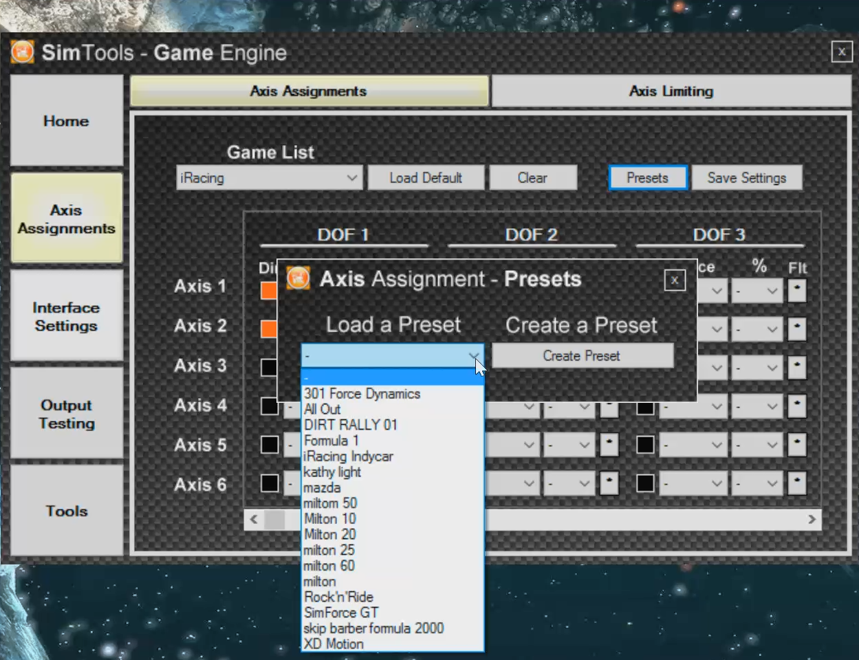

    Question: anyone knows how to delete the old presets? see picture for references I want to start fresh with new presets.

  9. insanegr
    insanegr !N$@n€
    Jan 14, 2014
    503
    Athens
    16,726Coins
    +499 / 1 / -0
    29640
    here is the folder C:\Users\YOUR USER\AppData\Local\SimTools\GameEngine\AxesPresets
  10. BlazinH
    BlazinH Well-Known Member
    Oct 19, 2013
    2,145
    Oklahoma City, USA
    16,703Coins
    +1,840 / 32 / -1
    Go to C:\Users\your_user_name\AppData\Local\SimTools and delete the files you don't want anymore from their folder.

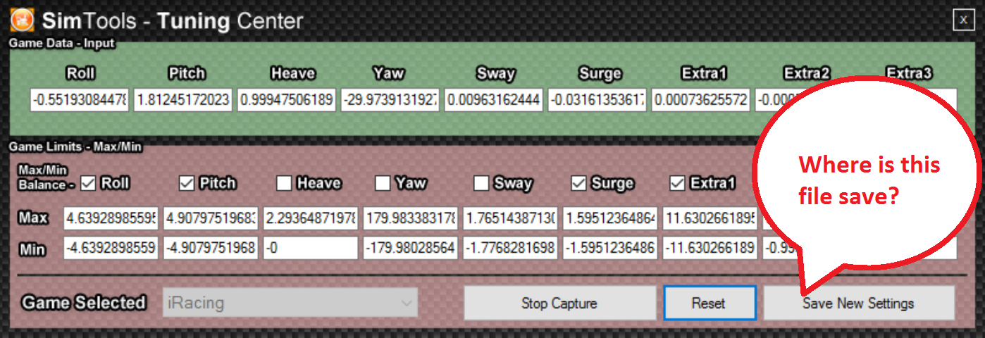

    Anyone knows where is the Tuning Center file located?
  14. value1
    Jan 9, 2011
    2,192
    Zug, Switzerland
    14,295Coins
    +3,363 / 13 / -1
    C:\Users\Milton\AppData\Local\SimTools\GameEngine\MaxMinProfiles
  15. Milton
    Nov 11, 2015
    345
    Dallas Texas
    1,989Coins
    +320 / 4 / -0
    3DOF, JRK
    Thanks, :)
