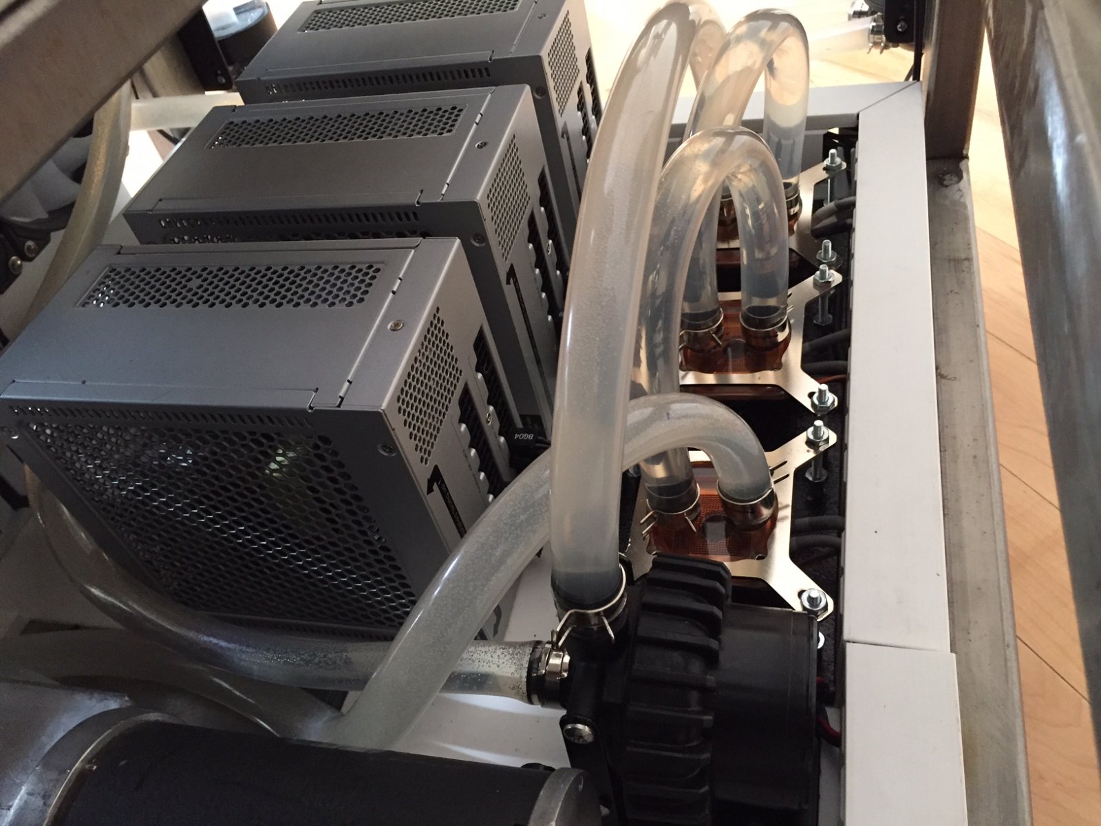

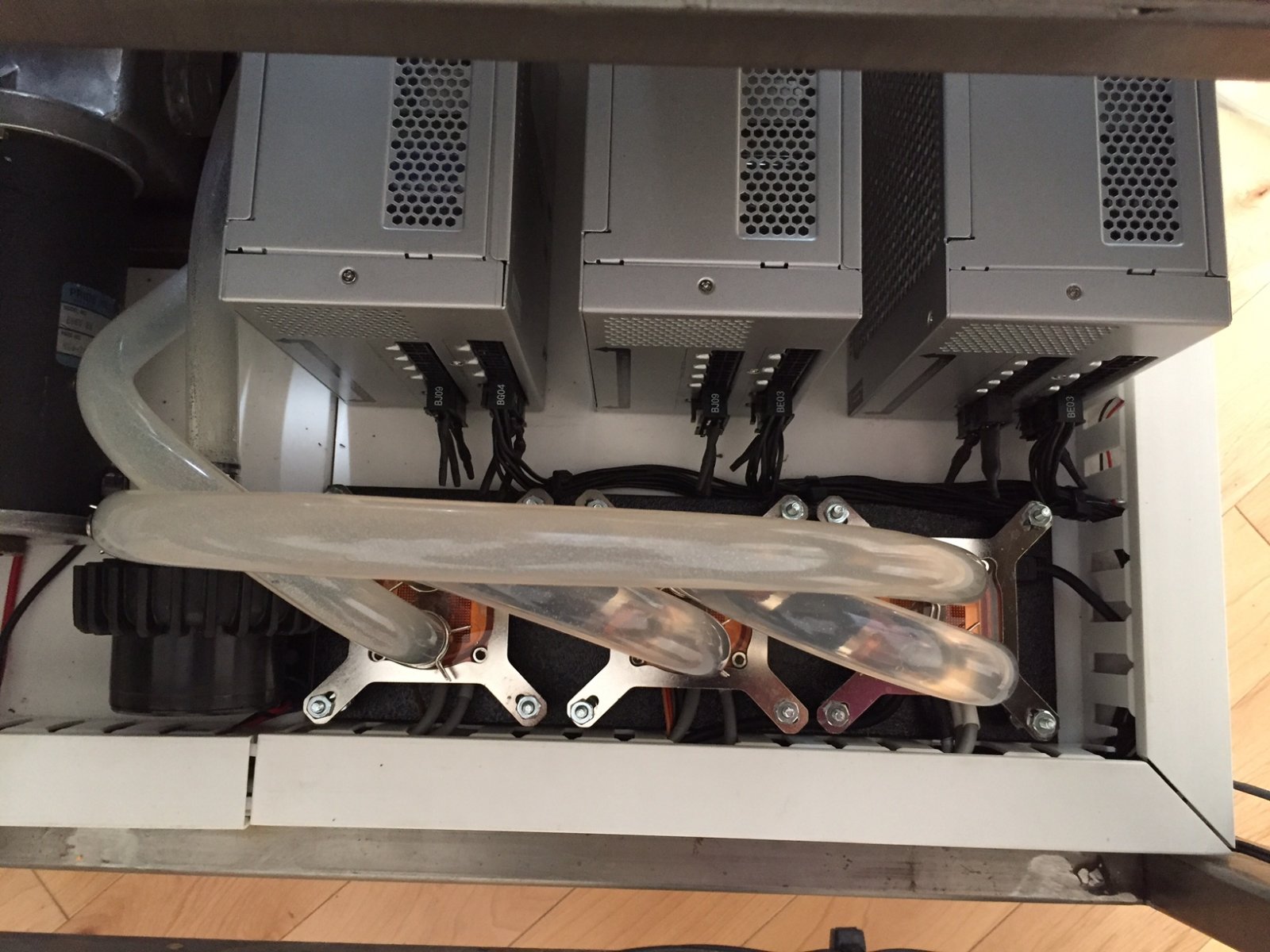

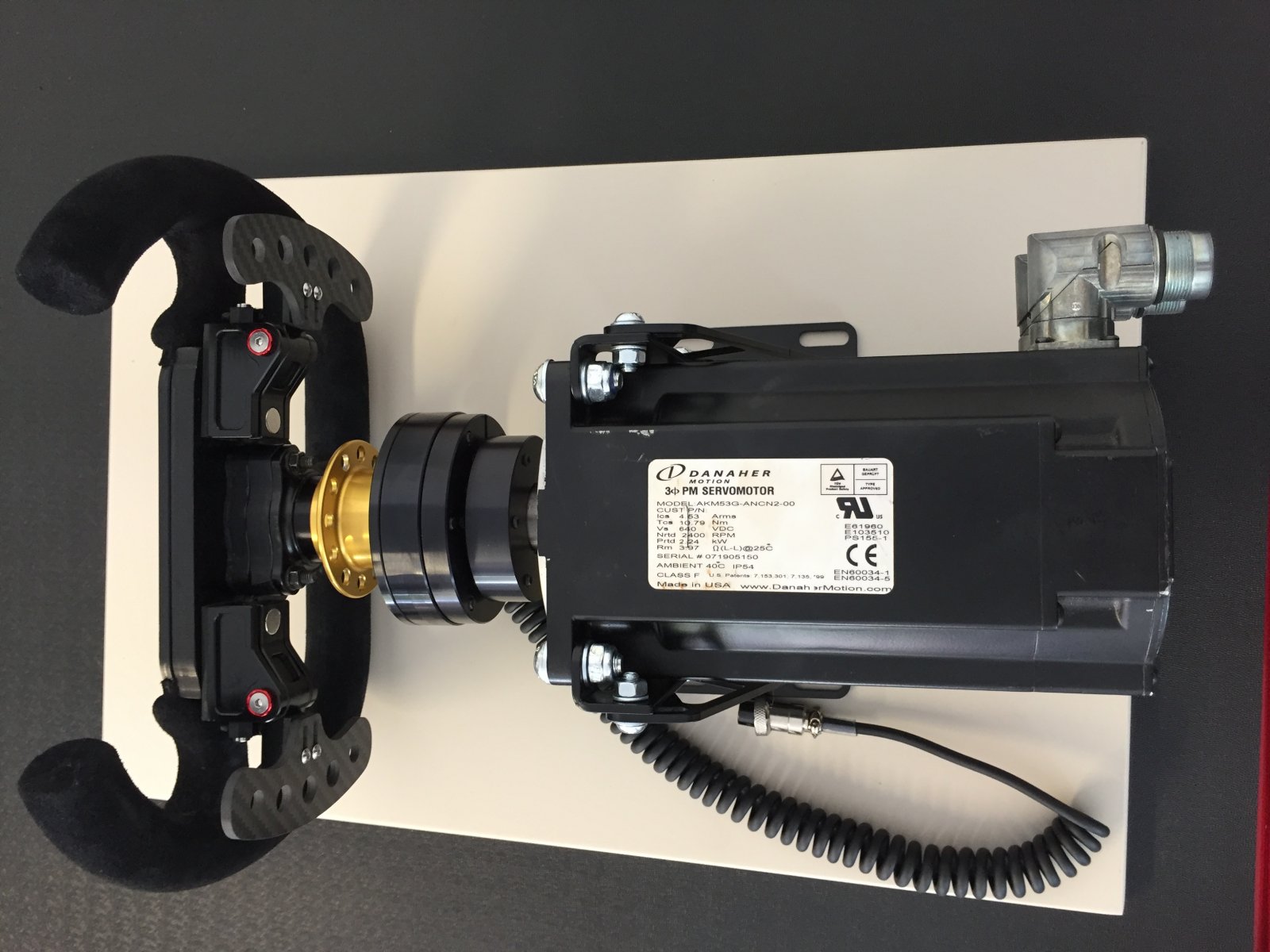

  5. Milton
    Nov 11, 2015
    345
    Dallas Texas
    1,989Coins
    +320 / 4 / -0
    3DOF, JRK

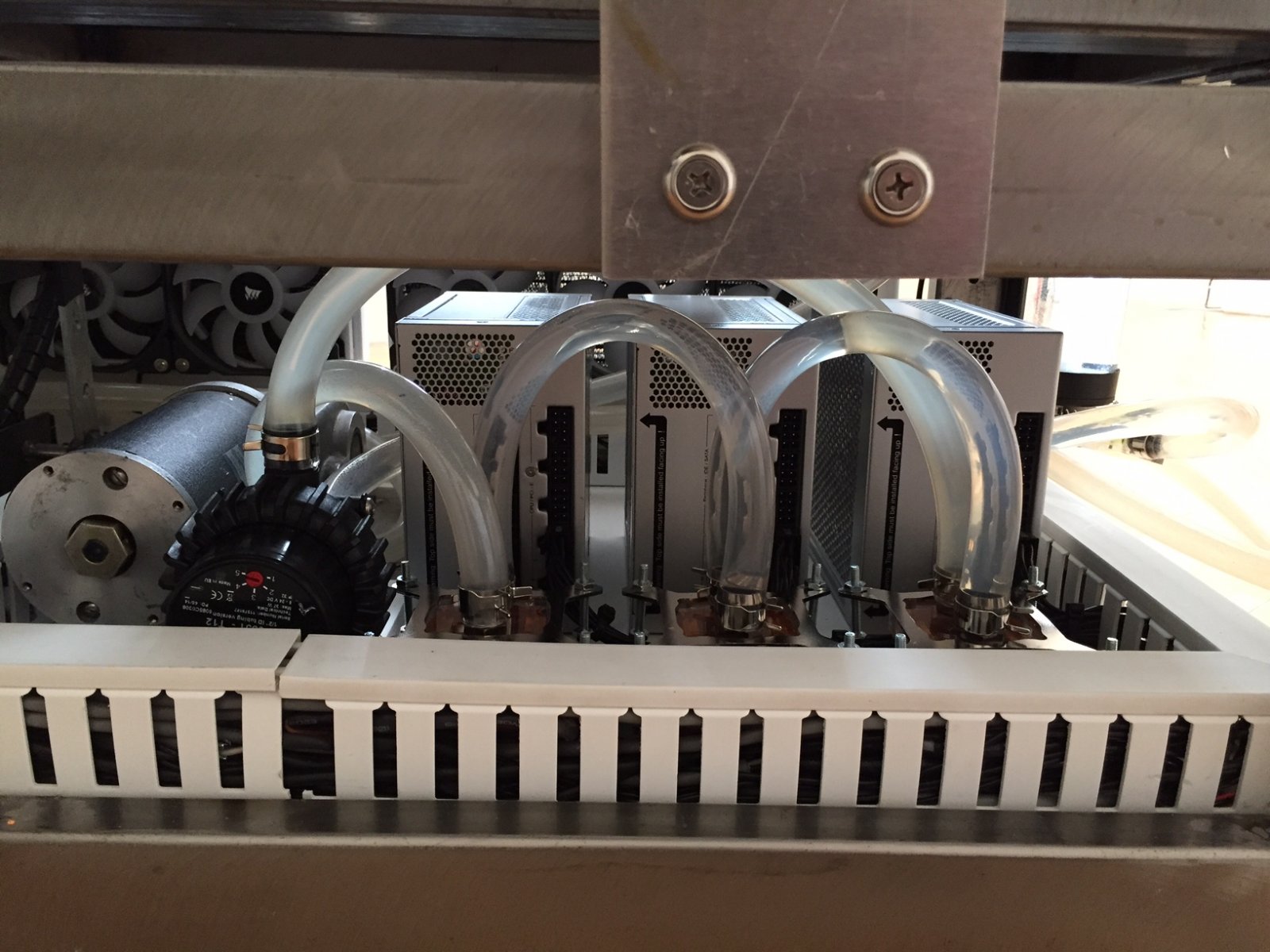

    Pololu Jrk 12v12 Water cool!
    22,208
    154,711Coins
    +11,211 / 57 / -2
    Now that water cooling is an interesting adaptation for the JRKs, nice job :thumbs
  7. Avenga76
    Avenga76 Well-Known Member
    Jun 29, 2014
    518
    Network Engineer
    Auckland, New Zealand
    3,262Coins
    +859 / 6 / -0
    That's awesome. I was actually thinking of doing that a while ago using northbridge waterblocks but I put it in the too hard basket.

    Hello gentlepeople, here is an update of my OSW project!

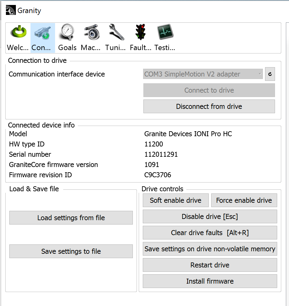

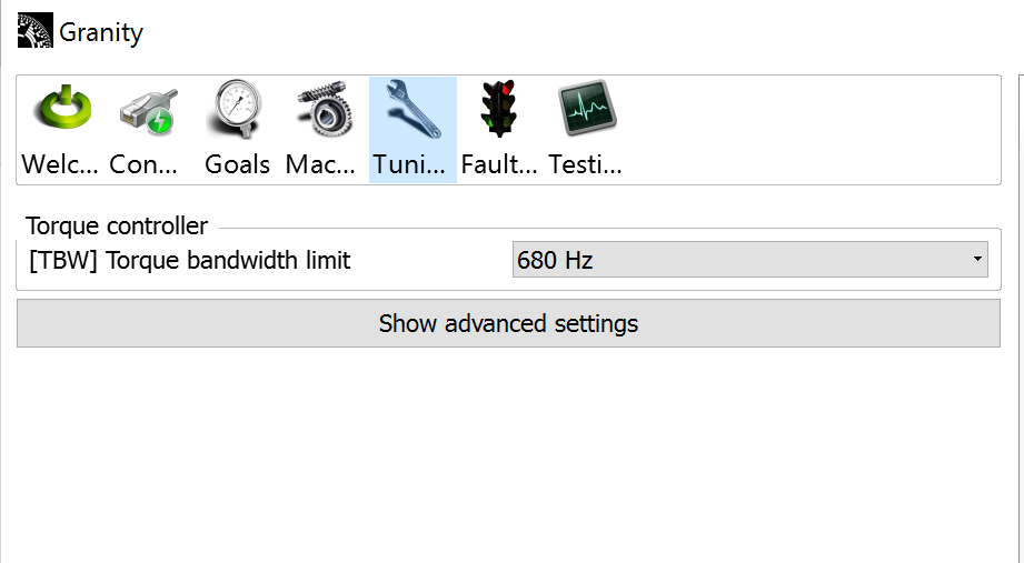

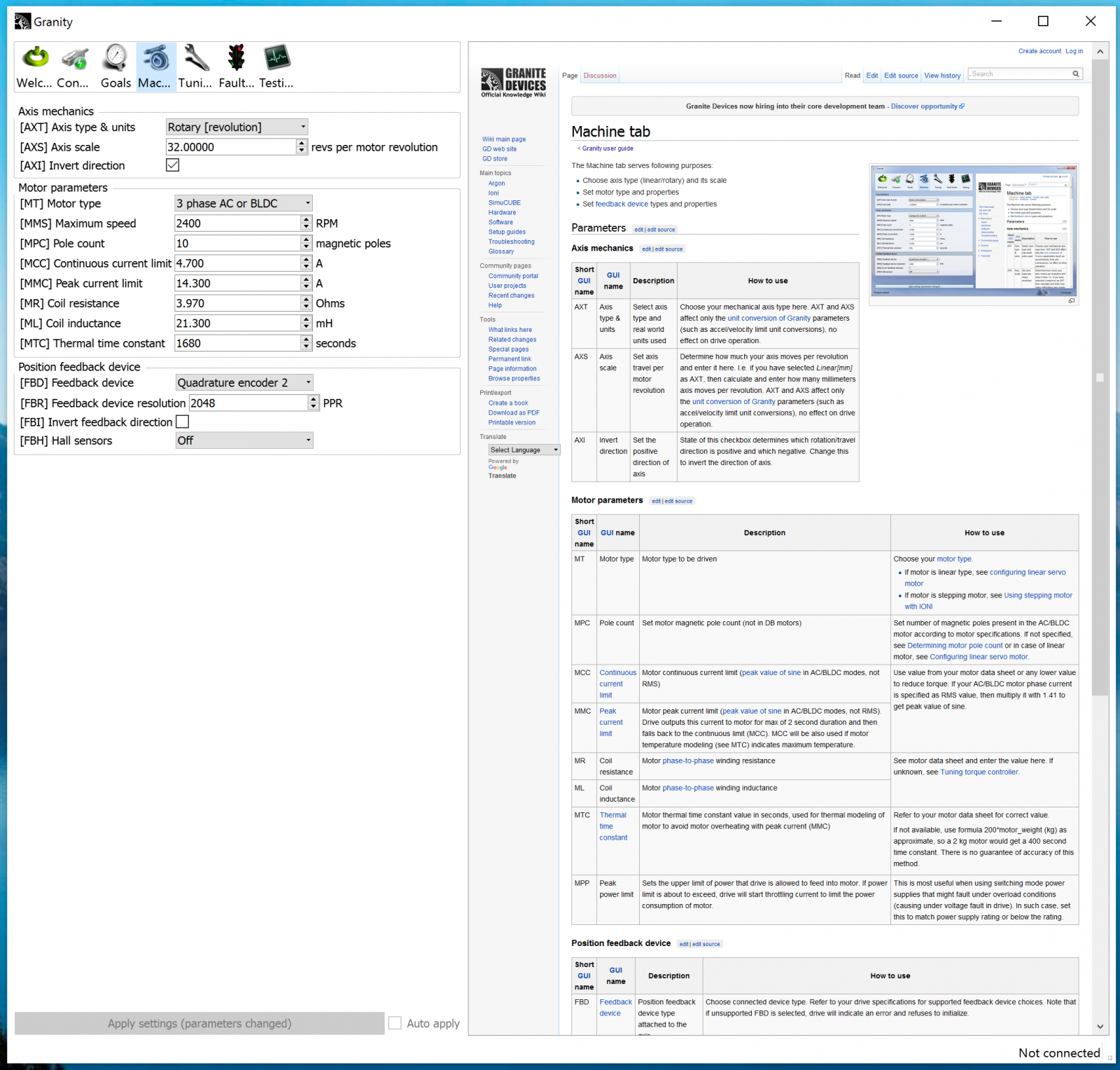

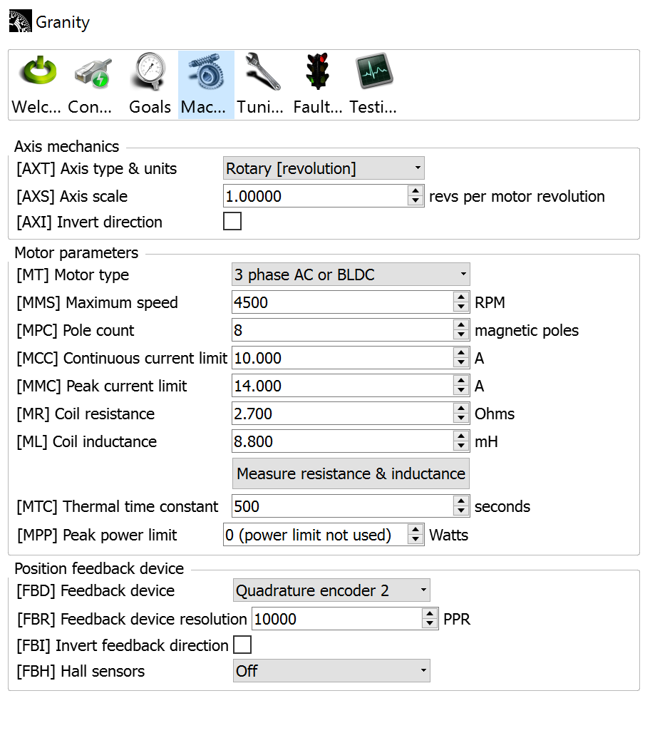

    Hello guys, I was wondering if anyone can help me! short story is I am now trying to set my OSW for the first time and I am getting some errors Granity software I will post some pictures:
    let me know?
    Connection.PNG Faults.PNG Goals.PNG Machine.PNG MMos.PNG Testing 1.PNG Testing 2.PNG Tune.PNG
  10. Nick Moxley
    17,057Coins
    +2,507 / 30 / -2
    My settings are located here, BUT i run a Small Mige, you have a lenze, not sure how relative the setups are, but i can see a few thing's right off the bat you need to adjust in some of the fault limits. FOV and FUV look odd.

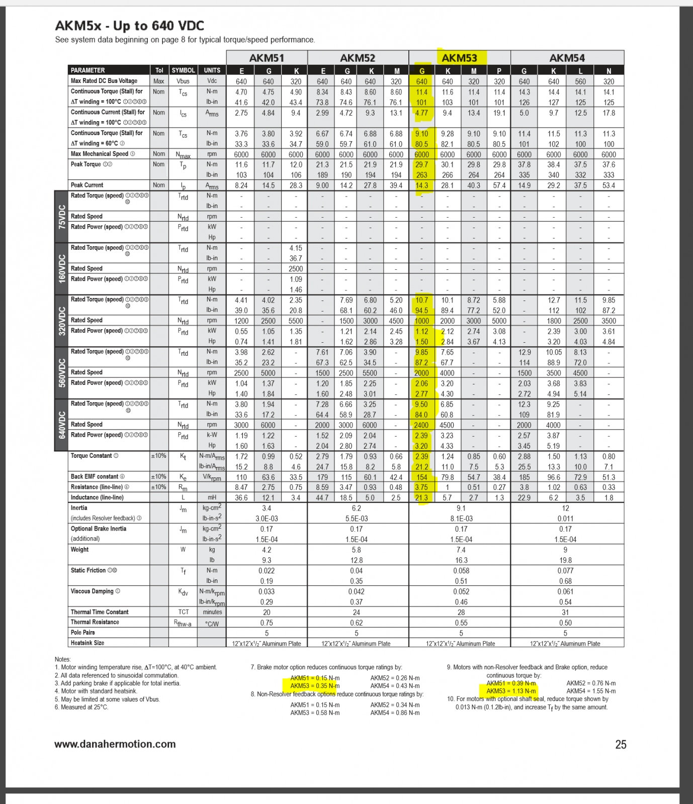

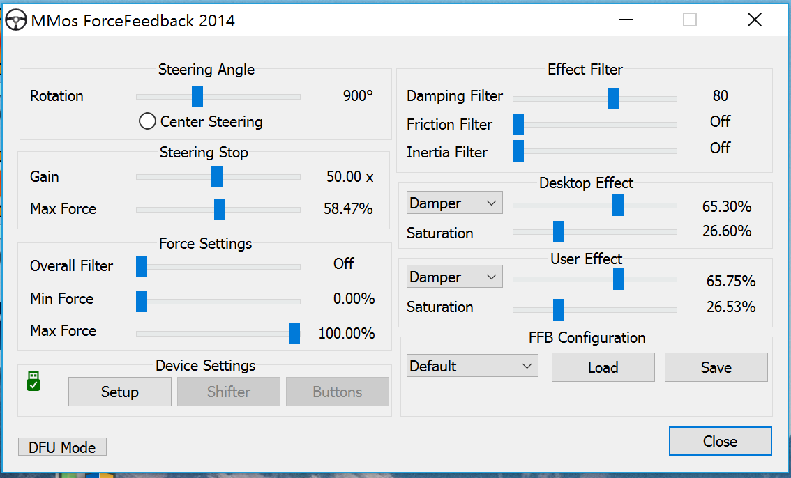

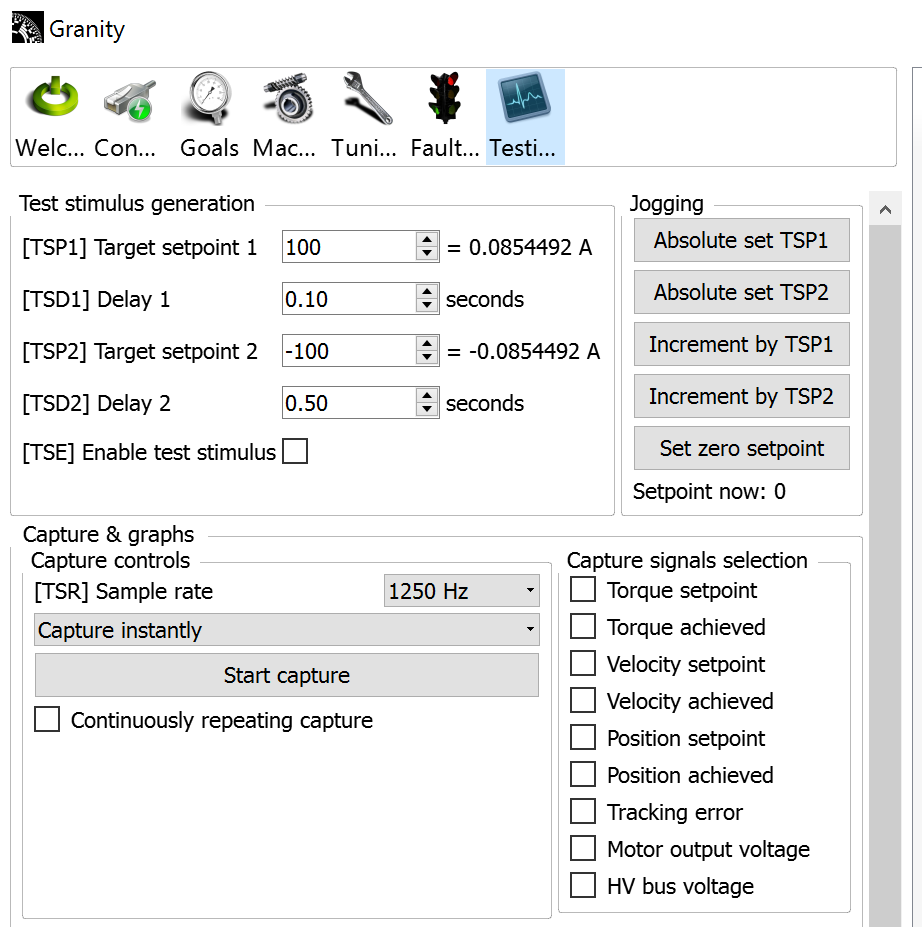

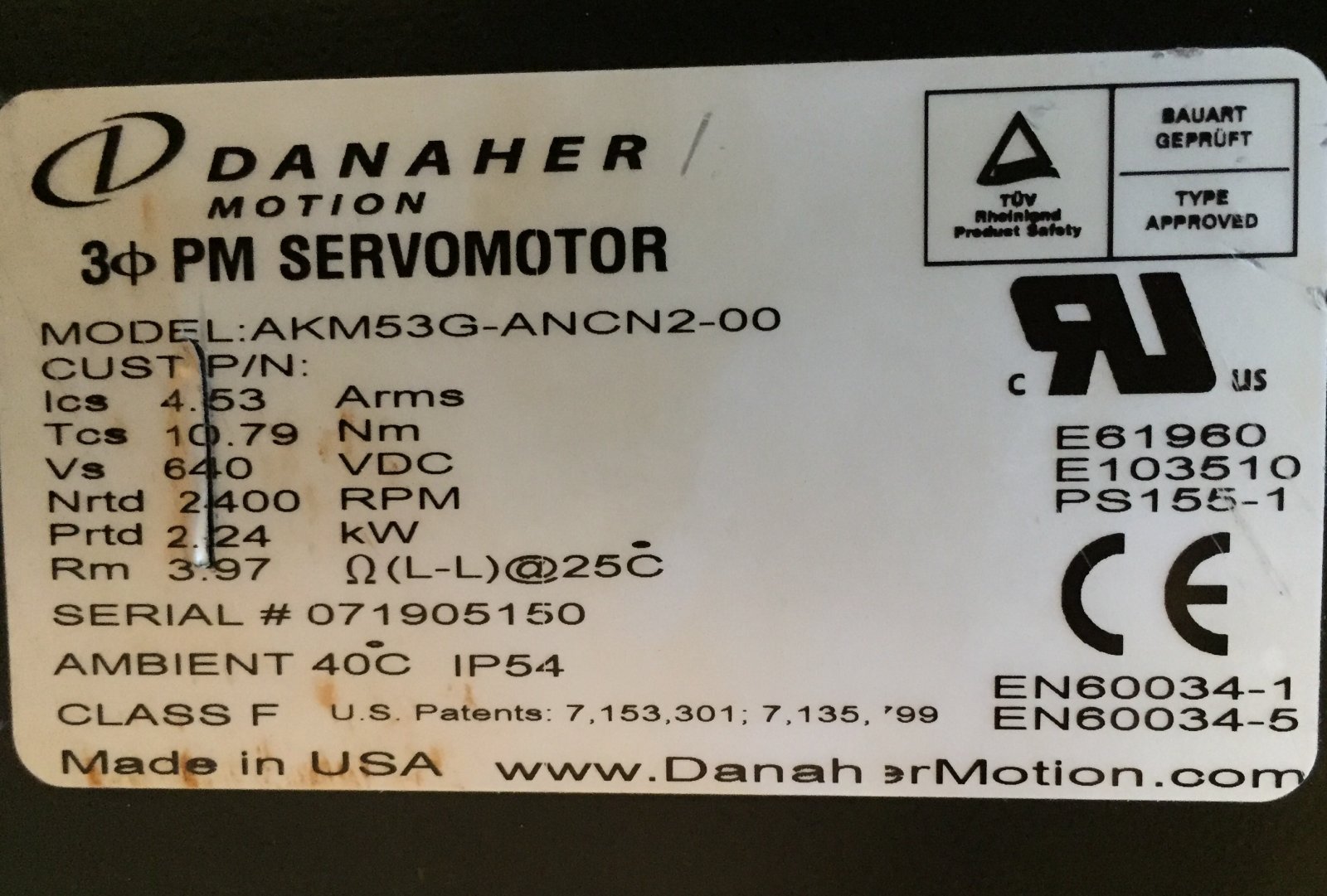

    Thanks Nick! I did tried some of your setting it did help a little but somehow the wheel is like it has weird steps I create a youtube video you can see:

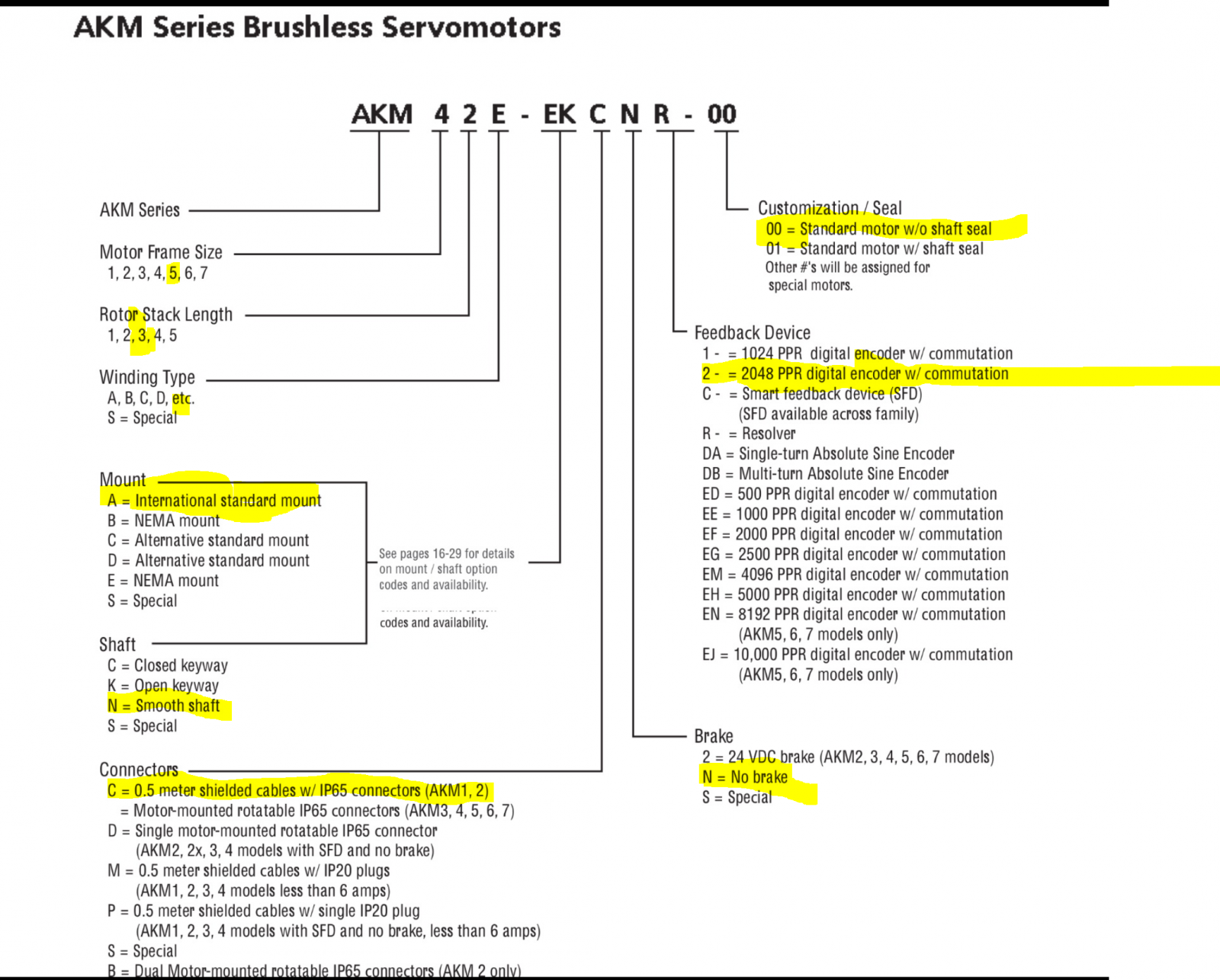

    also I am using the Danaher Motor
    This is the Specs of the Motor:
    This is Part number explanation:
  12. Nick Moxley
    17,057Coins
    +2,507 / 30 / -2
    as i said your FOV and FUV look very low for some reason, But again having ZERO experience with your motor, Im not sure what the exact problem is. the Stepping effect likely has to do with all the effects your running in MMO's, Turn off ALL the effects except for a little spring if you want to use my little centering trick.
    I Highly suggest getting on the Iracing forum or Contacting a Builder of DD's that might be able to provide a base setup for the AKM
    PS DO NOT use my setting's for your Machine tab setting's, Motor's are very specific to what they need.

  16. OZHEAT
    OZHEAT Active Member
    Oct 26, 2015
    208
    Australia
    2,459Coins
    +106 / 6 / -0
    3DOF, DC motor

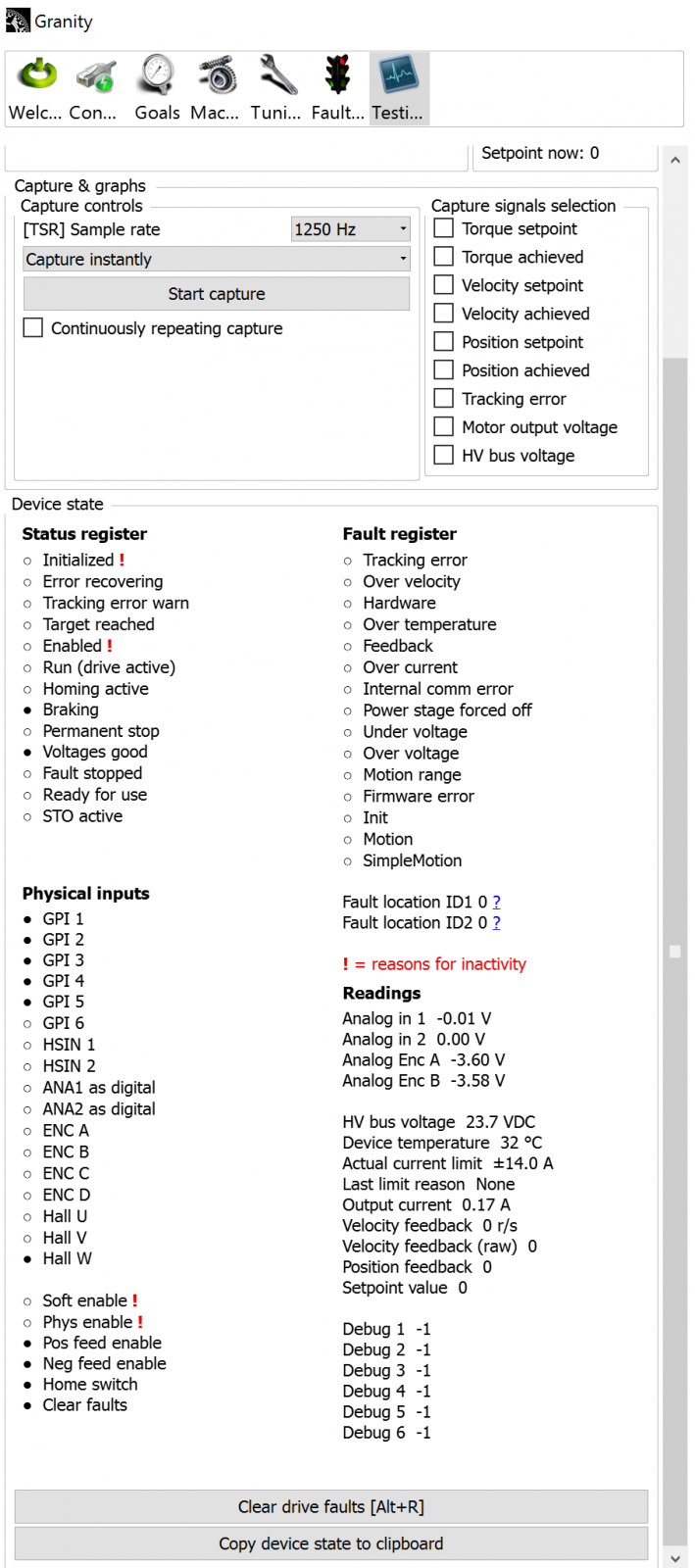

    @Milton
    I know you posted your settings and datasheet a few months ago and may have corrected settings.
    Have you correctly input your motor data in granity? The pics of your settings above don't agree with the motor datasheet.
    [MPC] should be 10 poles, datasheet says 5 pole pairs.
    [MCC] continuous current 4.77A from datasheet.
    [MCP] peak current 14.3A from ds
    [MR] coil resistance 3.75 ohm
    [ML] coil inductance 21 mh
    [MTC] 1680 sec, 28min from ds
    [FBR] 2048 ppr from your part number pic.
    [MMS] I don't know what to set this as. At only 24v bus voltage with a motor rated at 640vdc@2400rpm you are going to be around 100-150rpm max
    This is most likely why your motor stutters because 24v is only just enough to overcome motor friction. You may need to go to 48vdc or more to get fluid movement.
    The mige is rated at 220vac which is about 310vdc your danaher motor if rated for 440vac ~620vdc
    l gotta go, arriving at job site now.

    Almost everything is same here are my current settings:

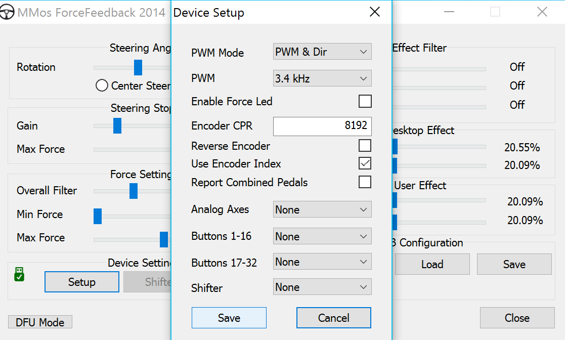

    I have no idea why my MMos Device Setting keeps disappearing but this is what i normally set at:
  19. Milton
    Nov 11, 2015
    345
    Dallas Texas
    1,989Coins
    +320 / 4 / -0
    3DOF, JRK
    Somehow i have steps in the wheel after i setup the Device Setup in MMos, see video for more reference.
