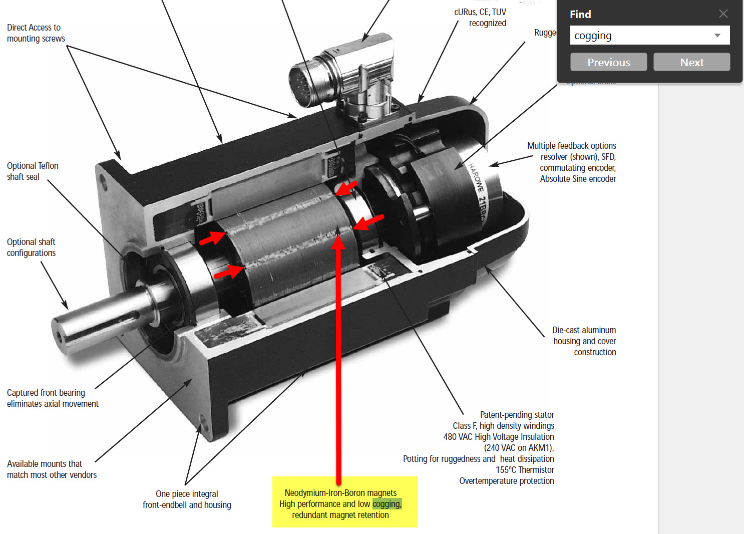

    3DOF, DC motor
    @Milton
    Looking at the last vid.
    You are suffering 'cogging' as you have 5 detents per rev, which corresponds to the 5 pole pairs.
    Granite ioni have an anti-cogging compensation feature in software. see http://granitedevices.com/wiki/Configuring_cogging_torque_compensation

    This sounds like the issue i am having i will tested tonight Thanks!
    found the Coggings for this motor is 10!

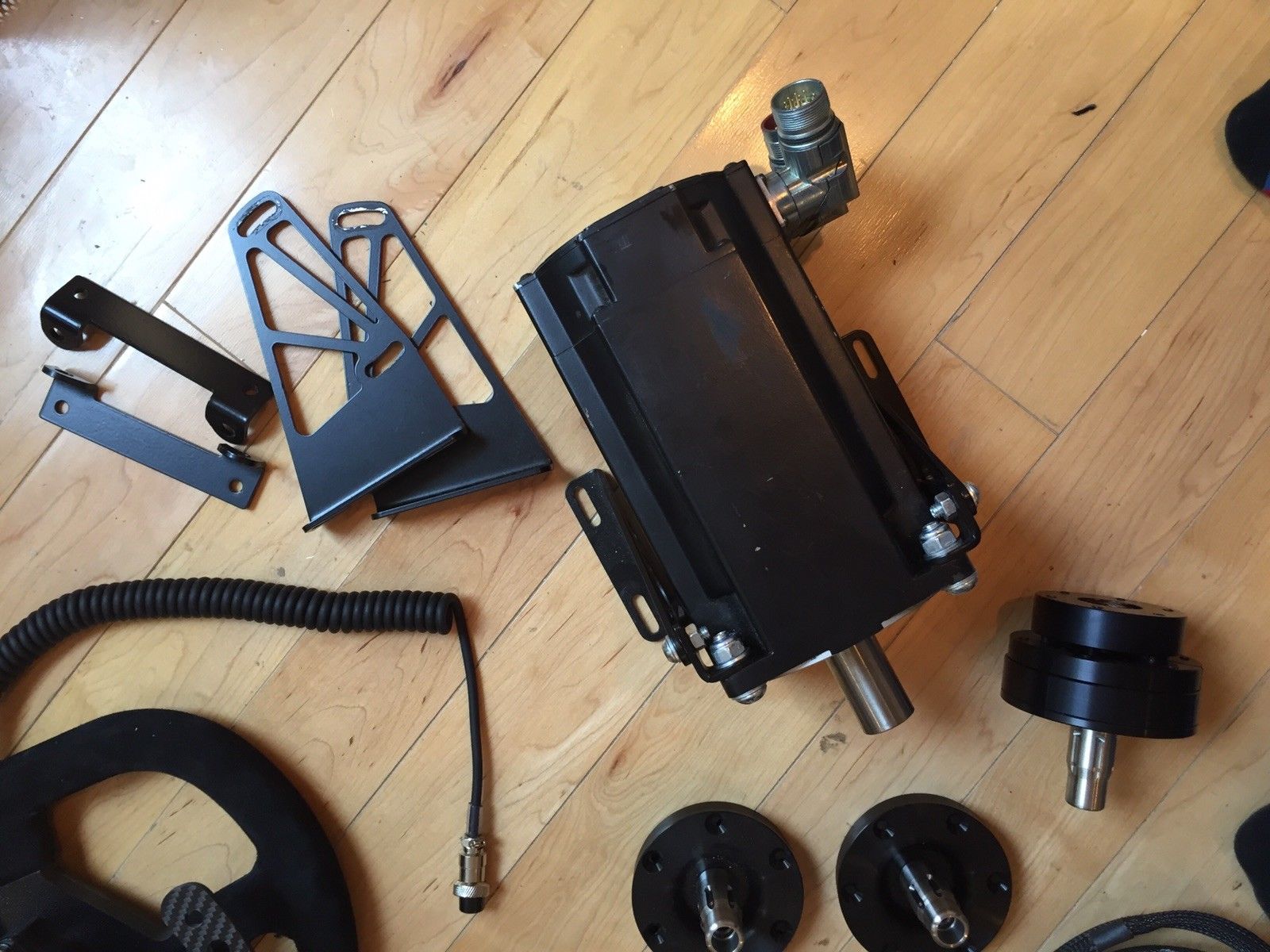

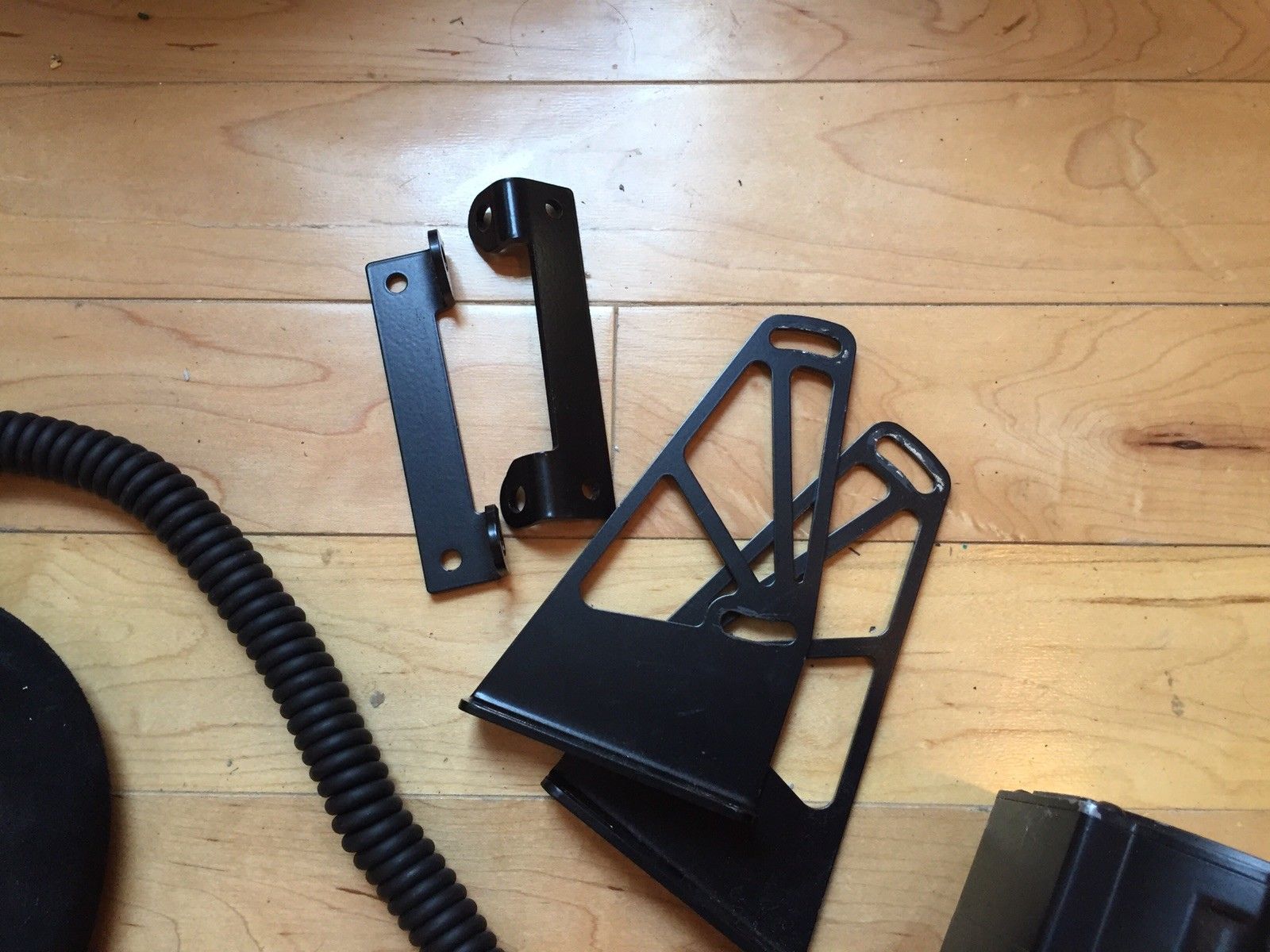

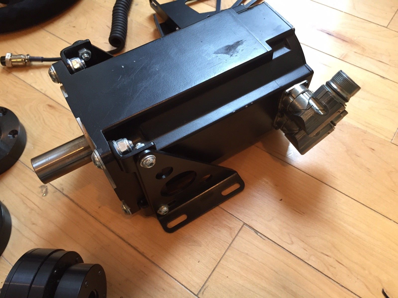

    @Milton
    I wrote a lengthy post last night but lost it when I accidentally hit the back button on the mouse, so here is an abbreviated post.
    I always thought cogging was the steps you feel when motor is in operation but industry call this torque ripple.
    Try the second part of ioni for setting TRF2 and TRA2.
    I think your biggest problem is going to be your 24v power to motor.
    Your motor is rated at 640vdc@2400rpm.
    Your supplying 24vdc which works out at 1/26.333 of 640vdc
    Voltage is kinda proportional to speed, so if you half the voltage and have 320vdc it should spin at ~1200rpm. 160vdc@600rpm 80vdc@300rpm 40vdc@150rpm 20vdc@75rpm.
    I think you are going to have to increase your DC bus to at least 48vdc or to whatever the ioni can handle.
    Im surprised that the motor even spins at 24v, I would of thought it would be in the undefined area of a power/torque curves as the power is below the motor friction, wire and heat losses.
    Have you tried running the ioni in speed mode? does it spin or does it give an over current error?
    Maybe add a 12v car battery in series with your power supply so you can test with a 36vdc bus to see if improves things.

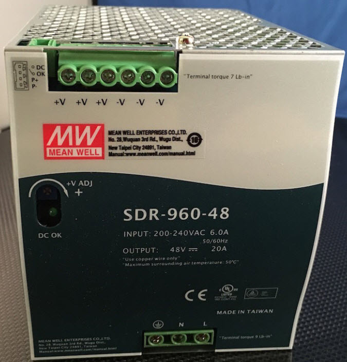

    Thanks @OZHEAT!
    I order the SDR-960-48 48V 20A 960W from Amazon

    @Milton
    I would have preferred to see you test higher voltages first to see if it improves before ordering an expensive power supply.
    You may still have problems @48v hate to see you buy something that doesn't improve your situation.

    Bad news I installed the 48 VDC power supply and the behavior got amplified the steps got stronger I am now thinking that I have a bad Motor.

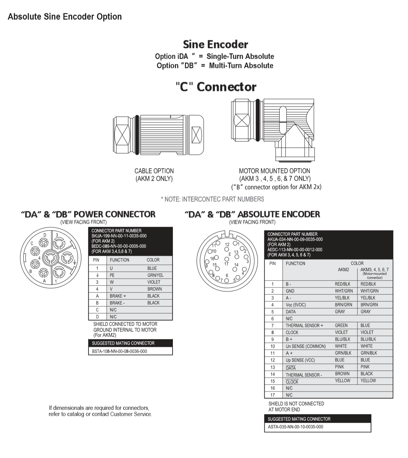

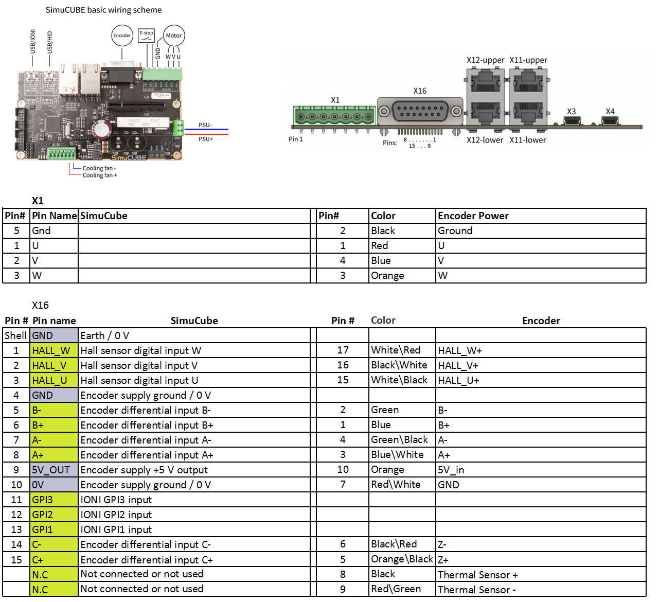

    Hello guys, i was very said last time when i wrote my previous post, today i see hope for this OSW, i was looking at the Kollmorgen Spec Sheet at the wiring pinout sheet and notice something that is different my wiring could be wrong!
    Long story short i saw this post on other website with all the diagrams and information of a build just like mine! so i decited to copy that and posted here few month ago, here is the link for reference:
    the original link: http://www.racingfr.com/forum/lofiversion/index.php/t51856.html
    so i compared the pin-out of the post with Kollmorgen Spec sheet and i see the pinout are wrong!
    guys i am going to need help on the pin out i still can not find what pins i need to connect for the HAll W, V, U. and C- , C+
    here are some pictures:
    Please help me to find the correct pin outs for my motor?
    thank you so much...
  17. OZHEAT
    OZHEAT Active Member
    Oct 26, 2015
    208
    Australia
    2,459Coins
    +106 / 6 / -0
    3DOF, DC motor
    @Milton
    Has the encoder been changed from factory?
    Your label on the motor says. .....ACN2 which corresponds to a 2048cpr incremental rotary encoder with commutation but now you are saying you have an absolute rotary encoder. Doubtful as you would have got many encoder errors in granity.
    If it is an incremental rotary encoder your X16 pinout is correct, commutatating refers to the u,v & w hall sensors.
    Pinout of this encoder is on p38 'commutating encoder'

    @OZHEAT yes it is a ACN2 yes the correct CPR is 2048 ok great i see it...
