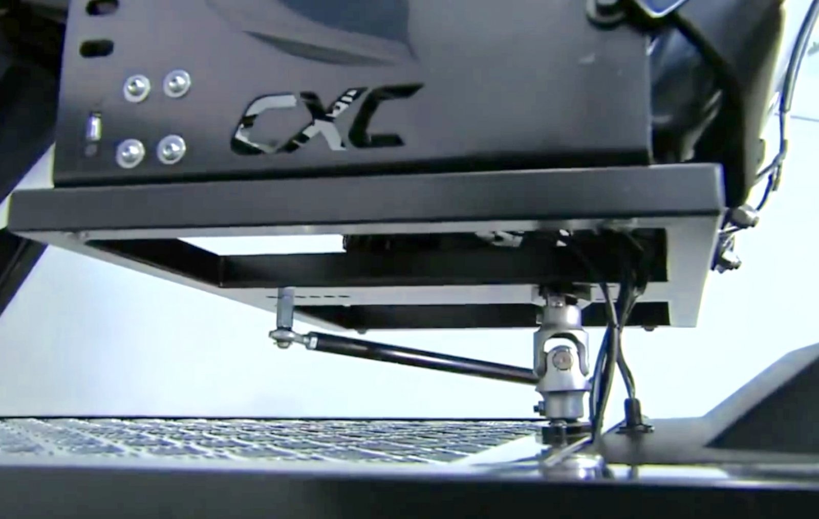

    You are correct! About the seat movement i notice that it moves side to side just with out motors, i thing that is the reason of CXC installing a guide bar in front of the seat, see picture attached.
    I will try my best to installed the motors on the side of the rig.

  5. bsft

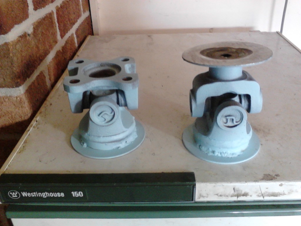

    Oh good stuff if there is a CXC you can have a go on. As for the uni joint, look for a rear wheel drive car and cut up a tailshaft.
    Then weld plates on the end. It is a lot bigger uni that the cheap steering knuckle CXC uses. I mean really, a sim with a 600% markup and they cannot use a decent uni joint. Pfffttt...
    As for angle, depending on what you weigh, its a bit snug, but would still do the job, maybe bring the top connections in a bit. Try to get minimum 15 deg angle out from the sides if you can.

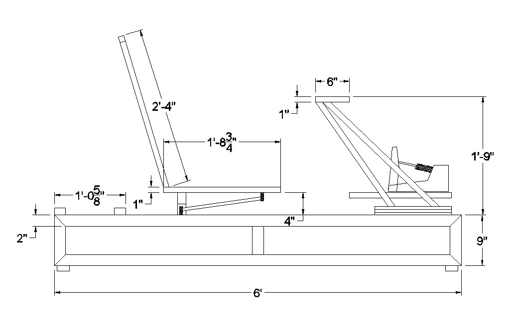

    Here are some drawing I created.

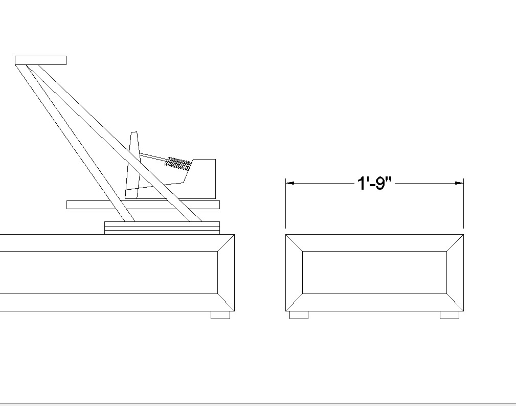

    Front view

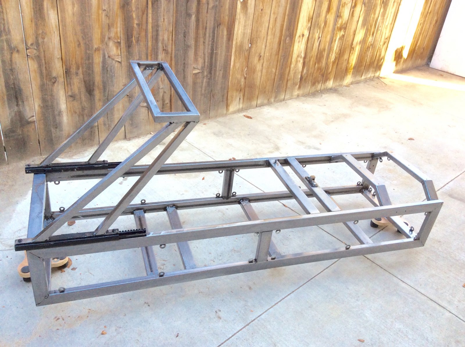

  10. Nick Moxley
    17,057Coins
    +2,507 / 30 / -2

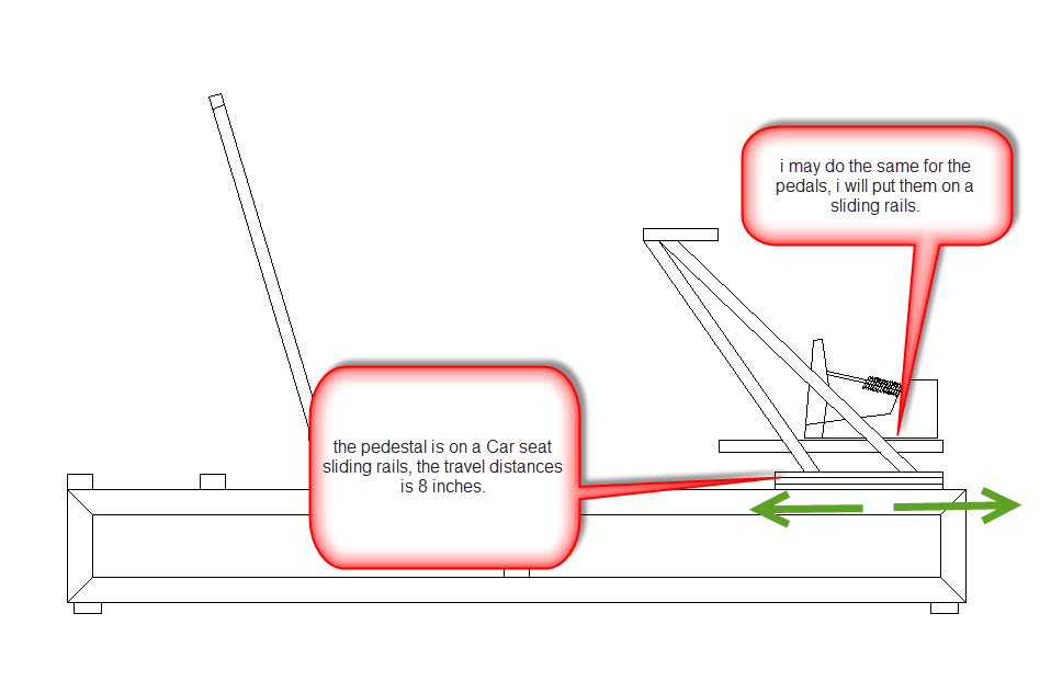

    What are you planning for adjust ability on the pedal plate angle ?
  11. Milton
    Nov 11, 2015
    345
    Dallas Texas
    1,989Coins
    +320 / 4 / -0
    3DOF, JRK
    Sliding rails.
  12. Nick Moxley
    17,057Coins
    +2,507 / 30 / -2
    What about the Rake or Angle of the pedals tho ?

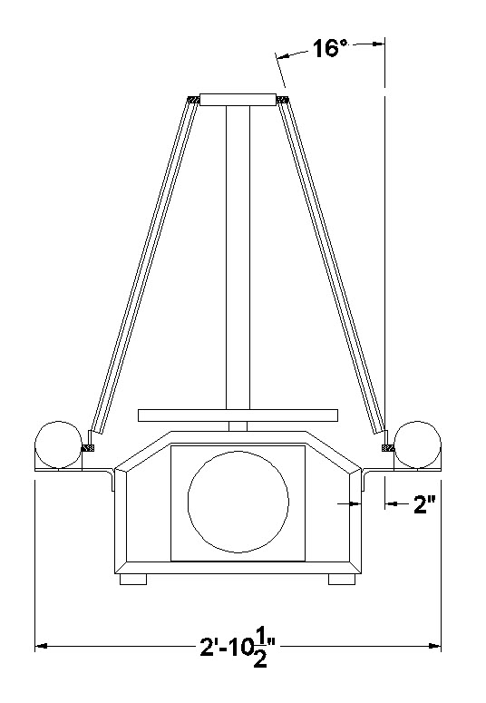

  14. Milton
    Nov 11, 2015
    345
    Dallas Texas
    1,989Coins
    +320 / 4 / -0
    3DOF, JRK

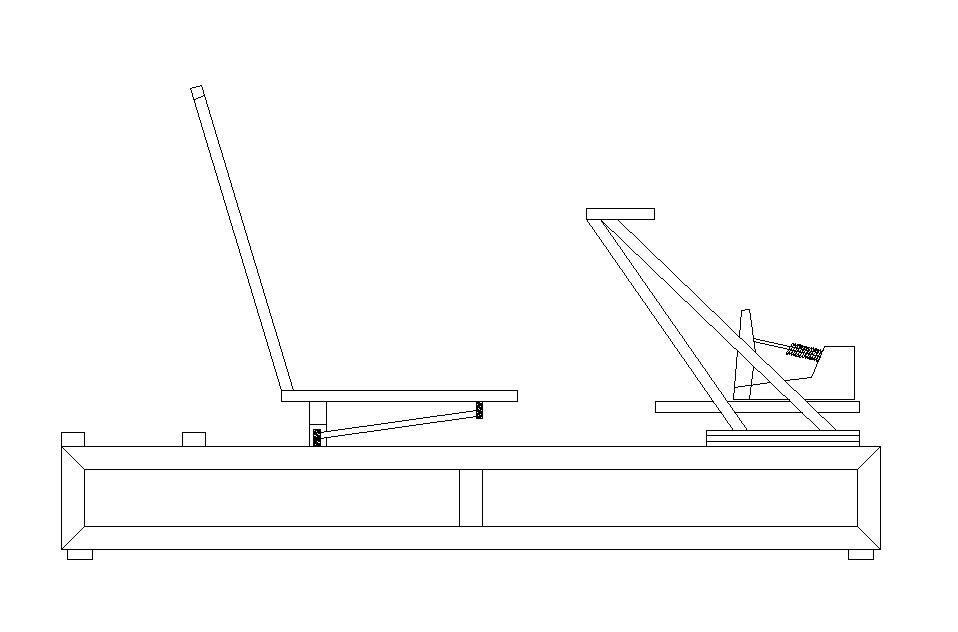

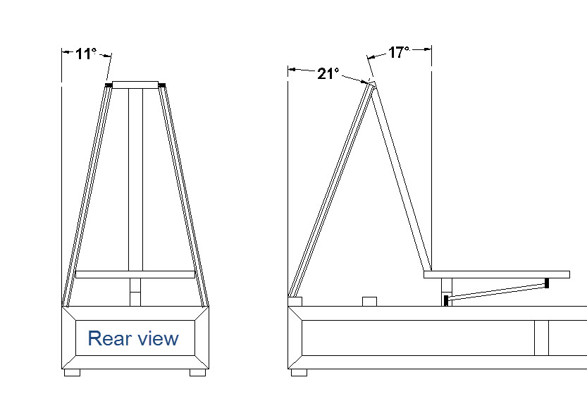

    this shows the angle of the seat bracket and angle of the motor connection bar to the seat see attached picture.
  15. Nick Moxley
    17,057Coins
    +2,507 / 30 / -2
    11 deg isn't ideal, I vote you make a small bracket to bring the motor's out another couple inches per side. That will be more in the range of what we want to see.
  16. Milton
    Nov 11, 2015
    345
    Dallas Texas
    1,989Coins
    +320 / 4 / -0
    3DOF, JRK
    I move the motors outside the frame and with a 2 inch distance from the frame and now the angle is 16 degrees, would this work?

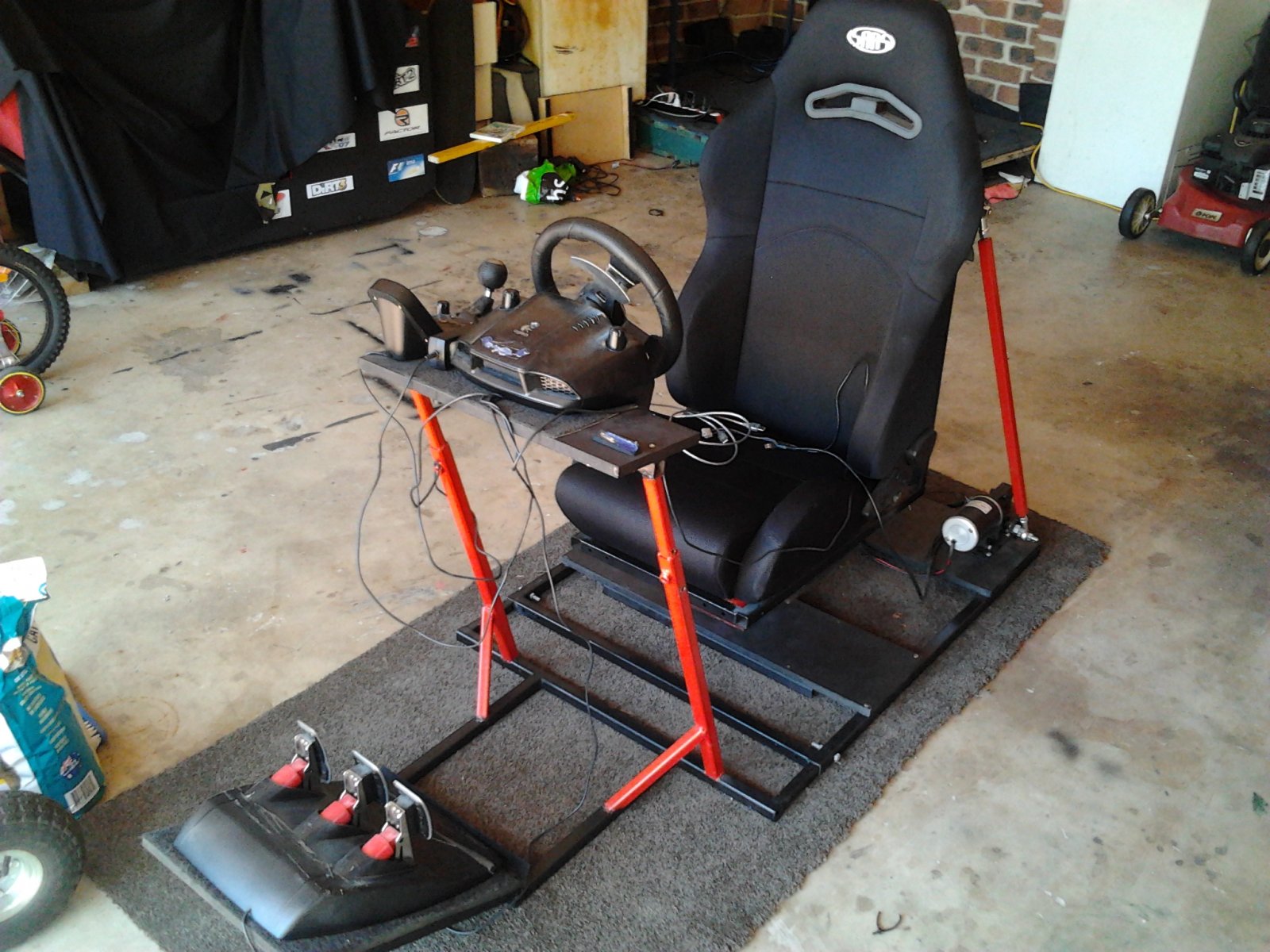

  17. shannonb1
    shannonb1 Well-Known Member
    Mar 12, 2008
    1,106
    Sales Intelligence
    Virginia
    8,909Coins
    +598 / 5 / -0
    Why not put the motor arms to the outside? Should have good enough clearance if you put the gearbox to the front
    • Agree Agree x 3
  18. shannonb1
    Mar 12, 2008
    1,106
    Sales Intelligence
    Virginia
    8,909Coins
    +598 / 5 / -0

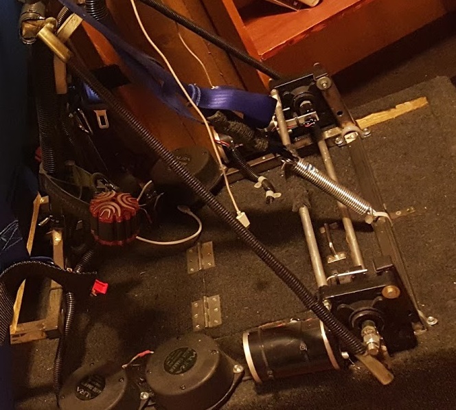

    Here is how I do mine...When my motors are off, I allow the arms to rest on the shaft.

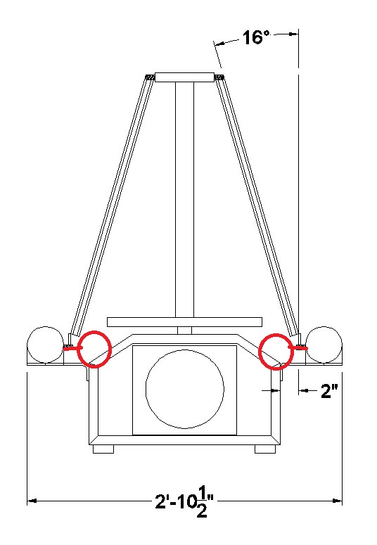

  19. bsft
    @Milton Amaya , what do you weigh? You can get away with slightly less angle, but it depends on your weight.
    How about this idea for motor mounting?
    Mount motors inside, but have the rods connecting outside? That way you keep the frame compact.
    Damn, @shannonb1 got in a few seconds before me. :D

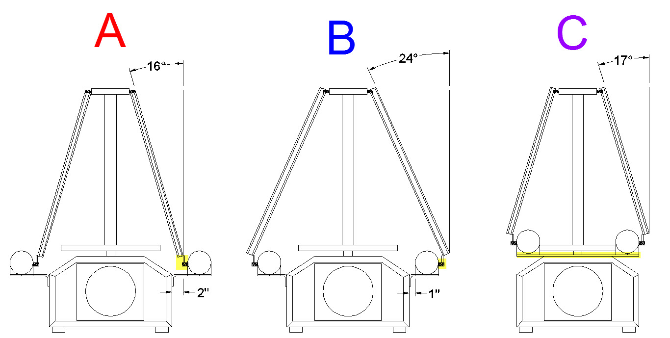

  20. Milton
    Nov 11, 2015
    345
    Dallas Texas
    1,989Coins
    +320 / 4 / -0
    3DOF, JRK
    I need some help! please see those 3 designs and vote please?
