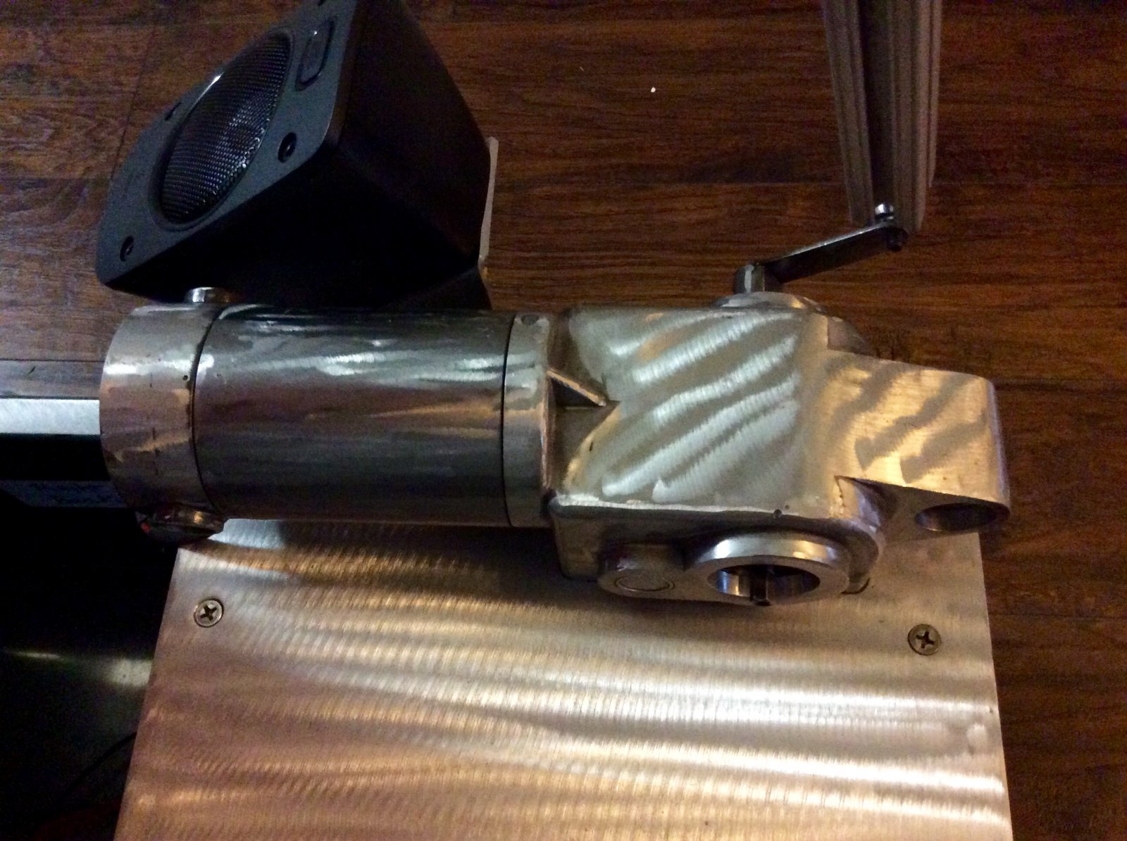

    Milton, I think you have great motors in your hands, why don't you try them before getting any new ones. heavy torque gives you the possibility to use longer levers, and longer levers help with speed...

    Probably stating the obvious here @Milton Amaya , but have to hooked up the Motors to a battery / Power Supply and reversed the polarity on the motors to see what the motors do? Torque is nothing if they can't reverse in an instant.

    Agreed. However, I've never seen a wheelchair go from forward to instant reverse. They have to stop before hand. Sure, it's because of the gearing etc, but I would be worried that these motors can not hit reverse in an instant at the speeds required by a Sim.
    Testing would have to be done making sure the switching of poles was very quick. In other words, not giving the motor time to go "off" before going into reverse.

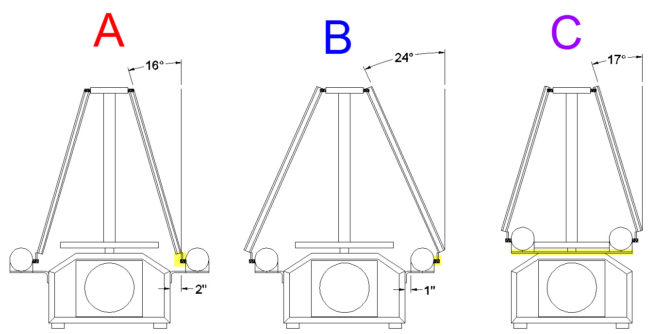

  7. insanegr
    insanegr !N$@n€
    Jan 14, 2014
    503
    Athens
    16,726Coins
    +499 / 1 / -0
  8. bsft

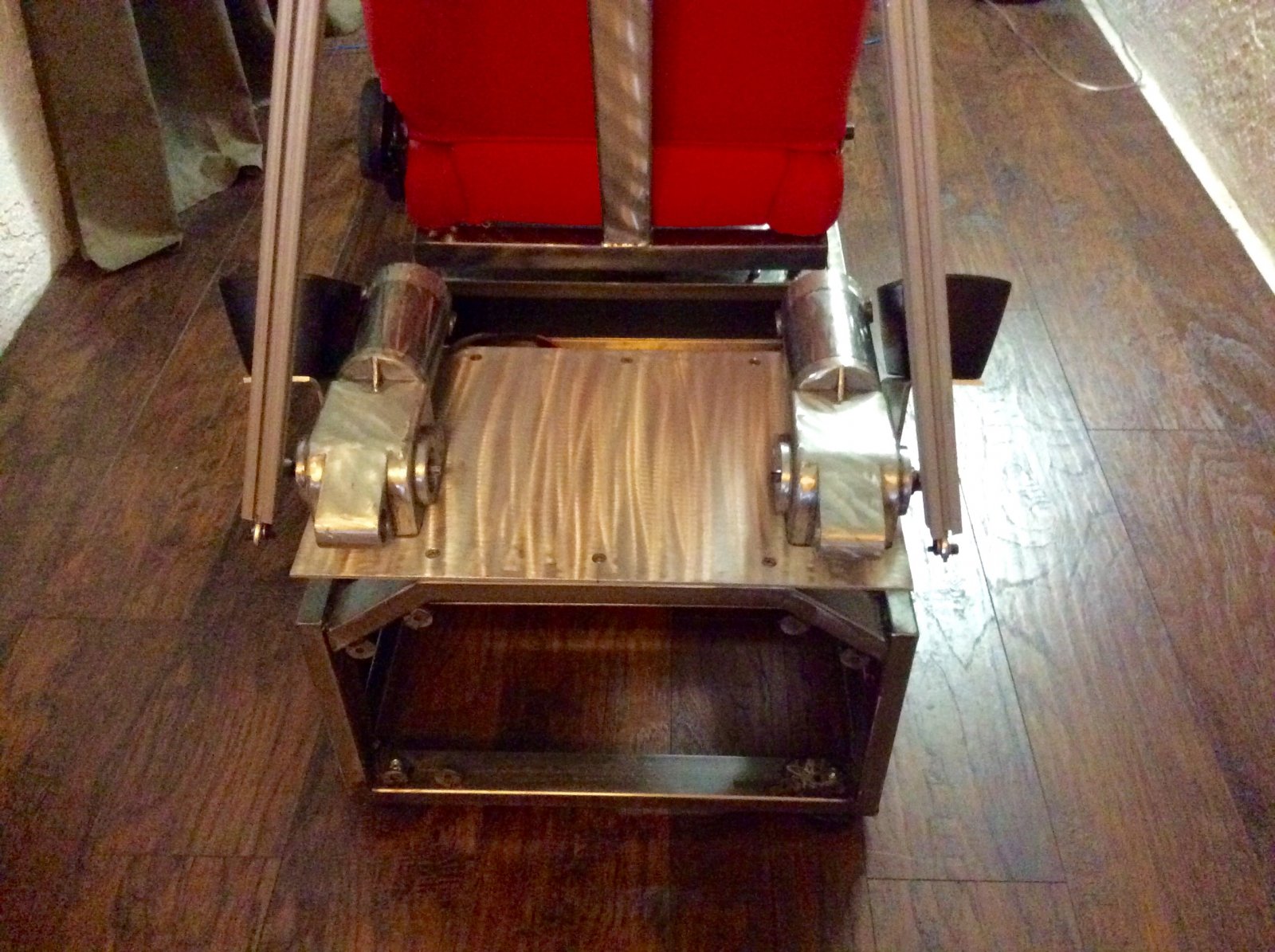

    well can he mount the motors a bit lower then on design C?
  9. bsft
    Something occured to me @insanegr , my shoulder mount DC motor seat mover I had , the motors centre bolt was in line with the centre of the uni. That and the rod arms were 15deg out and 13 deg to the side. It worked perfectly even moving 130kg player no problem. Im 85 kg and 6' tall. So option C would work just fine @Milton Amaya
    • Useful Useful x 2
  10. bsft
    Also. @insanegr The brickie actuator sim , the unis holding the actuators are well above the centre line of the pivot. Yes they are not a DC motor , however the suggestion about a "correct" position for motors just went out the window.

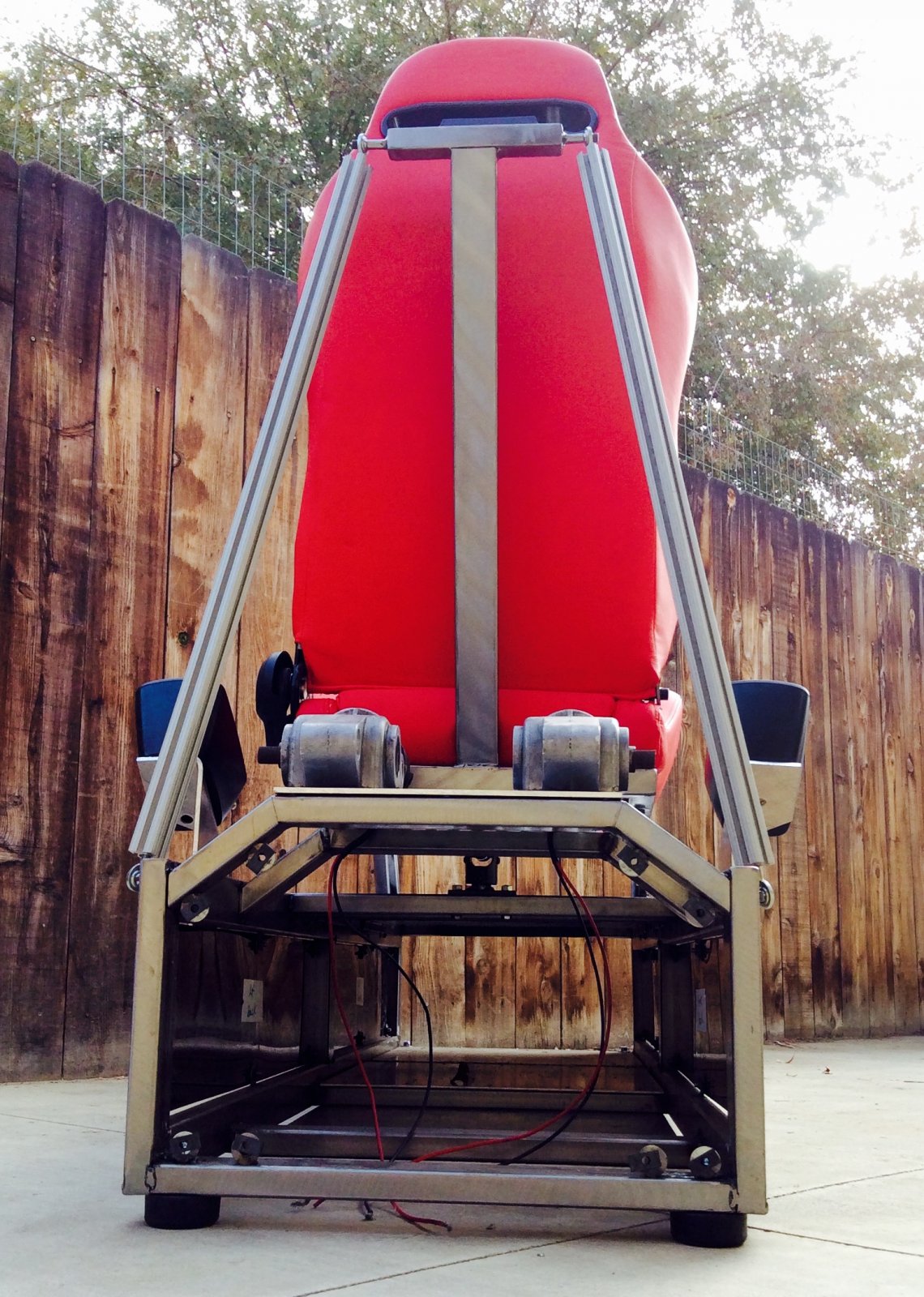

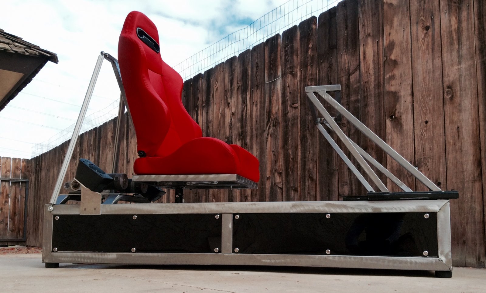

    Hello everyone, i am getting closer and closer, check out those picture, also for the motor placemence i think i will try "C" for a whille.

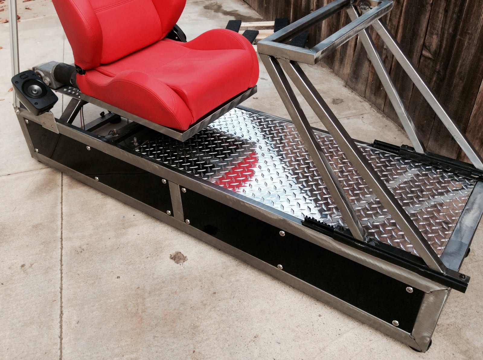

    Check this out!

    That steel plate looks bad ass. Have you mounted your wheel to see if its too far out? Ideally you want to be able to use seat belts to hold you tight to the seat and having to stretch at all to grab the wheel wont be a great experience.

    Is that 1" x 2" steel?

    Yes!

    Good point, i have drill 3 holes so i can move the chair forward each position is one inch distance.

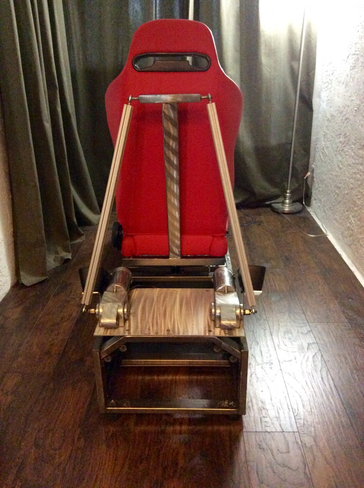

    image.jpeg An update on the motor placement, posion "C" is now done, i also clean the motors and sand and painted with clear paint, i will work on the triple monitor stand tomorrow.
    See pictures:
