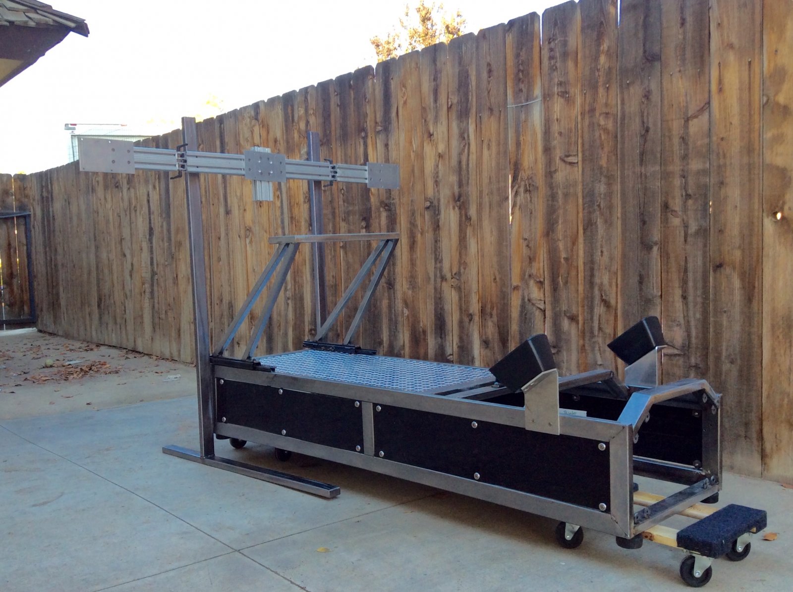

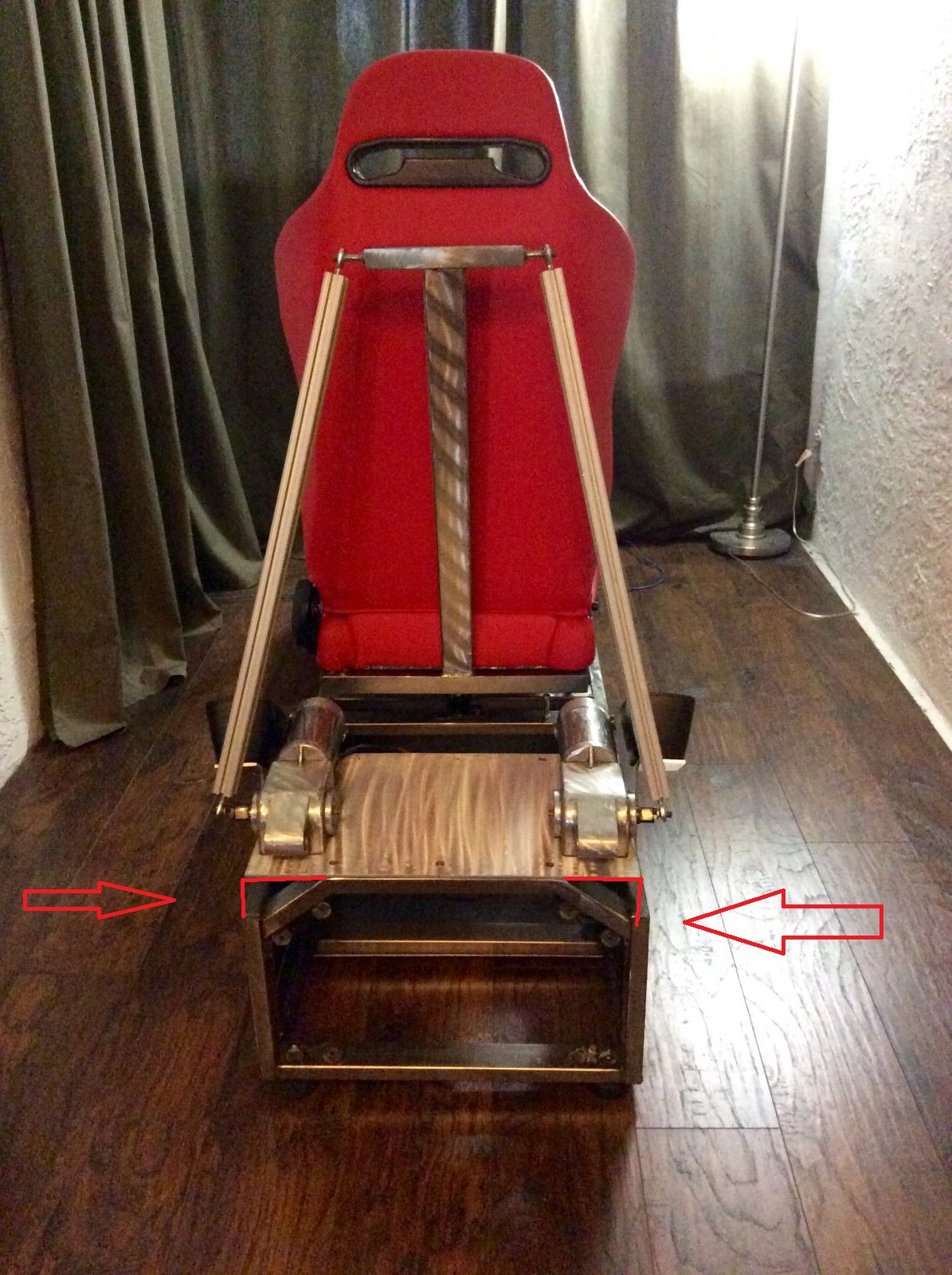

    Looks good man, the only thing id suggest is making a steel frame/supports under that motor plate. As it will flex like a muthaf...ker under motor power
    weld up something in the same size steel as you have now. Do not just the back, but under the entire area under those motors at the front and sides as well

    In addition to @bsft's suggestion you could run a bar between the motors, which helps make them part of the structural design and adds a lot of rigidity.

    Im assuming those lever's on the motor's are temporary ?

    Yes! They are temp i just do not know if those motor are good for sim racing, if they work i i will change it for a better Bars.

    Yes! The levers are temp.

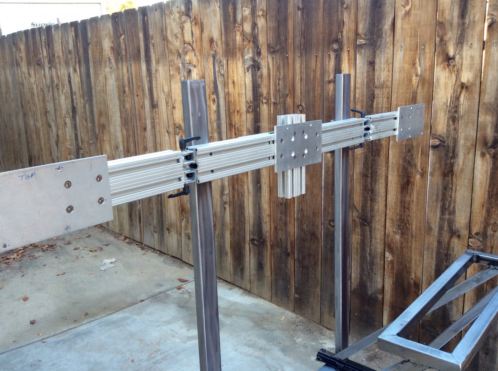

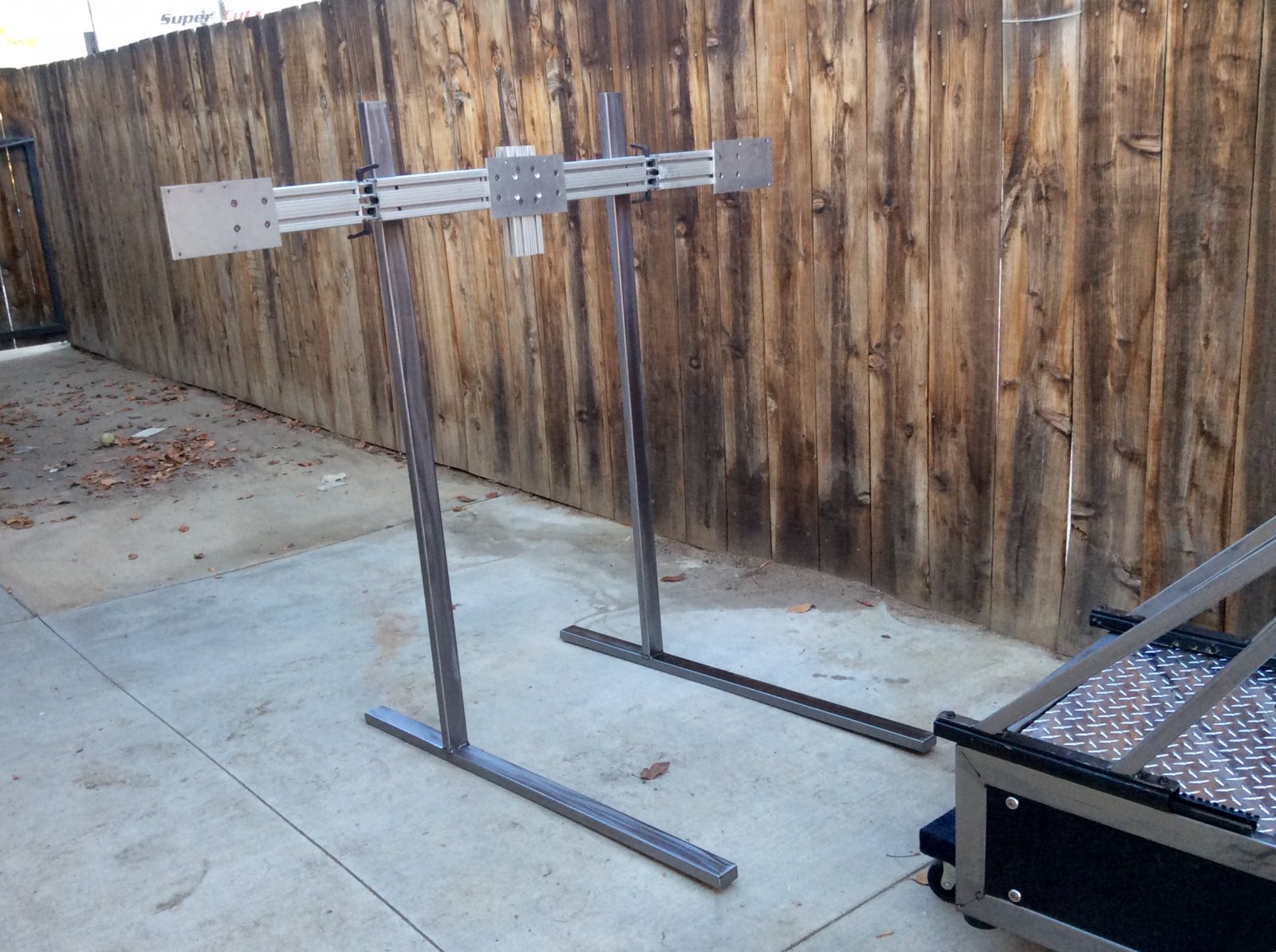

    image.jpeg Hello everyone i have an update on the monitor stand. See pictures:

    size are your monitors? I have 27" and want to build a 8020 monitor arm.

    My monitors are 24" and old so i am planning on buying new monitors maybe 35" 144Hz.
    I am using 1-1/2" by 3" t-slotted alluminum with 1" locking pivot.

    Whats the length though of each arm including the middle?

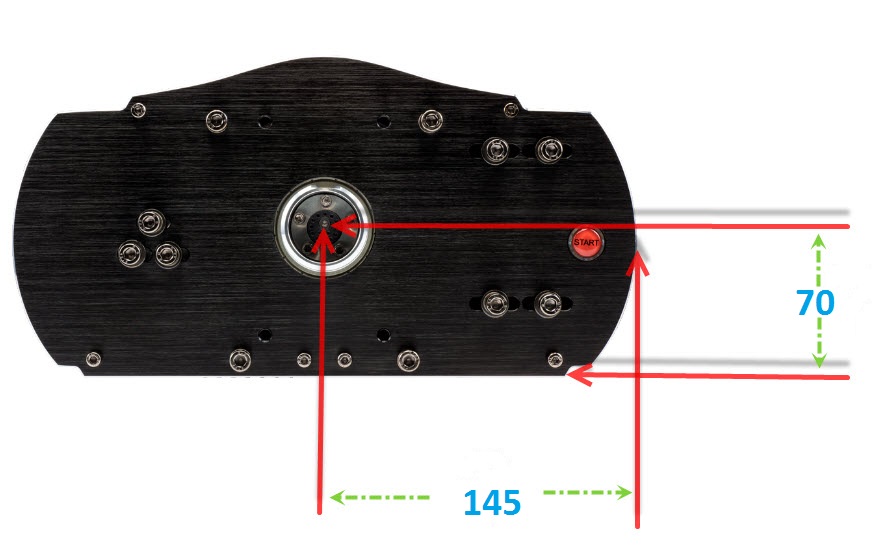

    Hello everyone, I am creating a drawing for a Dashboard for the control panels with buttons etc, and I was wondering if any of you have a Fanatec Wheel base? I need the center dimensions of the Steering column? to allocate space in my design see picture for reference?
    in advance thanks!

    I would rather someone else also verify this, the 145mm is close but with the wheels shaft and my bad eyes could be out a little.

    The total length of the arms are 61 inches, left and right arms are 15 inches, Center is 27 3/4 inches, keep in mind that the left and right arms monitor bracket it extend to the center of the monitor, i also can adjust the location of the bracket.

    I agree with @noorbeast I get the same 145mm x 70mm probably not mm perfect as my eyes are probably older and dimmer than his HeHe

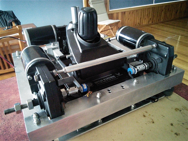

    image.jpeg Hello everyone, i have few updates, the peddles plate is done, the Dashboard slider is done, i am now working on the potentioameters for the motor, see pictures!
