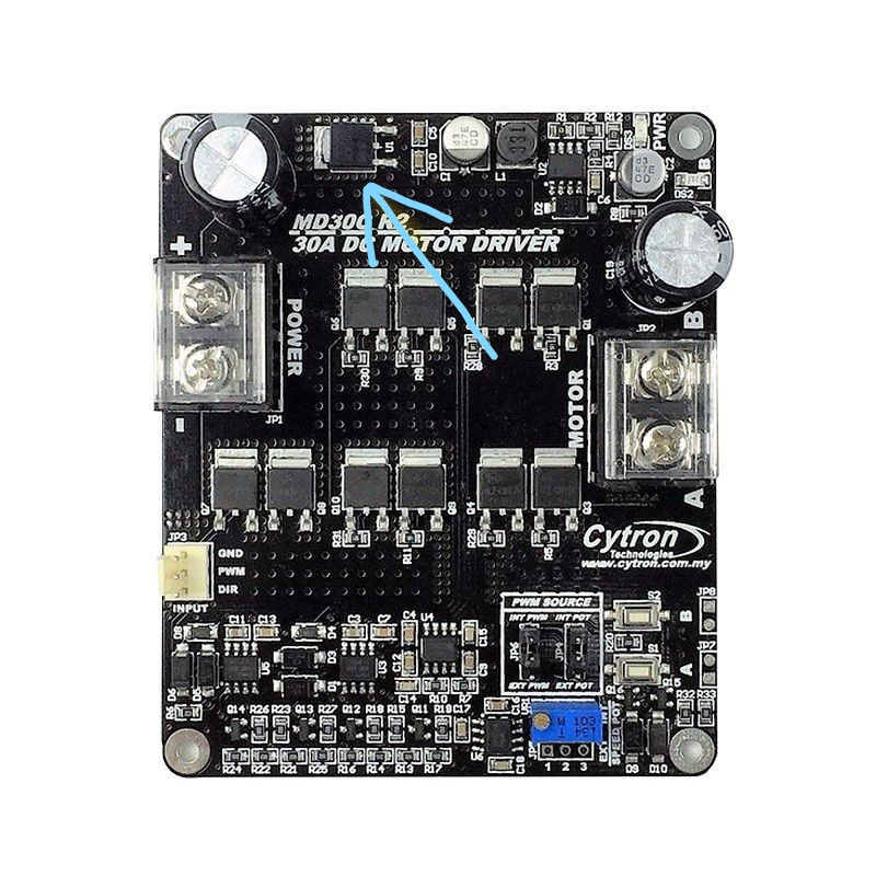

    Hi guys.
    I would like to ask a question, got the Cytron 30A motor controller and it is wired on an arduino as described here,
    shortly after switching on, one of the chips heats up and stops working
    in the picture i marked which chip is that
    7812CG RDL34
    I hope someone can tell me something what I doing wrong Inkedletöltés_LI.jpg

    This is a voltage regulator for 12 V. Check your connections for a short.
    You can also measure the resistance between +12V and gnd while powered off.
    Everything lower than 30 Ohms is critical, but it depend on your input voltage. This is just a quick test to check for obvious errors and shorts. If an IC is damaged, it is likely that you will not find the issue with this method.
    Btw, 50°C is fine for that chip. Even 80°C is still ok

    Im on 24 V not 12 V but thank for the Idea

    the chip heats up even if only the power source is connected, without Motors and arduino etc..
    The onboard power led
    is only dimly lit, as if it were a short circuit somewhere

    Here is a reply from Cytron Support:
    It's perfectly normal for the 7812 regulator to get hot under 24V as it's just a linear regulator.
    I suspect that the problem is due to regenerative current as he is using switching power supply to power up the motor driver.
    For your information, this motor driver is a regenerative motor driver.
    During motor deceleration, the power generated by the motor will be channeled back to the power source.
    Usually when a rechargeable battery is used to power the motor, this regenerative current flows back and charges the battery.
    However, when a switching power supply is used instead, the power supply cannot absorb this regenerative current and will cause the voltage to rise.
    In some cases, the voltage spike will trip the power supply over voltage protection. If this voltage is more than the maximum limit, it will damage the motor driver and the power supply.
    Please refer to this article for more information about regenerative braking.
    To overcome this problem, we suggest to connect a rechargeable battery or shunt regulator in parallel with the power supply.
    During motor deceleration, the regenerative current will be absorbed by the battery or dissipated by the shunt regulator via its onboard high power resistors.
    Please make sure the voltage rating for the shunt regulator is slightly higher than the power supply voltage.
    The shunt regulator will be smoked instantaneously if the power supply voltage is more than the shunt regulator voltage rating.
