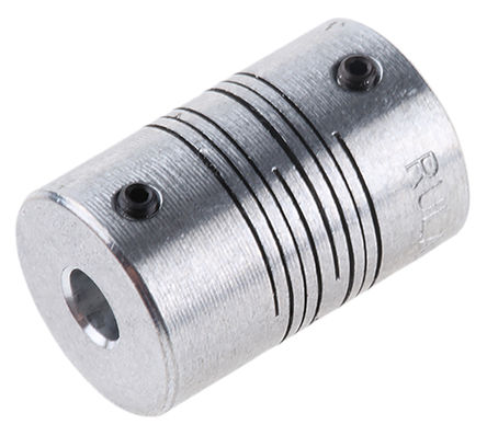

    Ilbiga:I already have 4mm shaft on motors,so i need 4x4mm shaft coupler
    Nick:I could be maybe best solution,but i want to try it with these pots(easier way),because new pots means make new shafts for wiper motors and for middle motor too.
    I found this coupler from neighbor my country Slovakia,good shipping and price,but they are little bit different in build.They haven't got that cut in the middle,i don't know how much effective there are with closing the pot.Do you know something about them?This is momentaly best solution for me.

    Personally I prefer the type of flexible coupling you have linked, these tend to be more robust than the other type available as shown below...
    The type pictured above have failed many times in the past before changing to the style you have found (they were fitted to a 100T press to monitor position). The clamping onto the potentiometer and motor shaft is not a problem. Some have a split and just clamp onto the shaft, Others use a grub screw to grip the shaft and some can even come with key ways.

    Cant say we have Ever had A Flex coupler fail around these parts. At least not that ive seen.....care to share a picture of a broken unit ?....and in reality if your flex coupler fails, its due to VERY wrong forces being applied to it. And i HIGHLY suggest you check thing's before proceeding.

    @Nick Moxley I agree with your sentiment, both type of coupling are rated at 3 degrees of misalignment but in my experience the type that @Danny255 linked perform better than the ones I pictured. I'm not able to show I photo of a failed coupler as we no longer use them having replace for the more reliable style. But they always tended to fail dead center of the coupling.
    We use to monitor ram positions on our presses, an encoder shaft is driven by a rack and pinion connected to the rams. Obviously there must have been too much misalignment for the units to fail, but with no other adjustment the coil style couplers have survived.

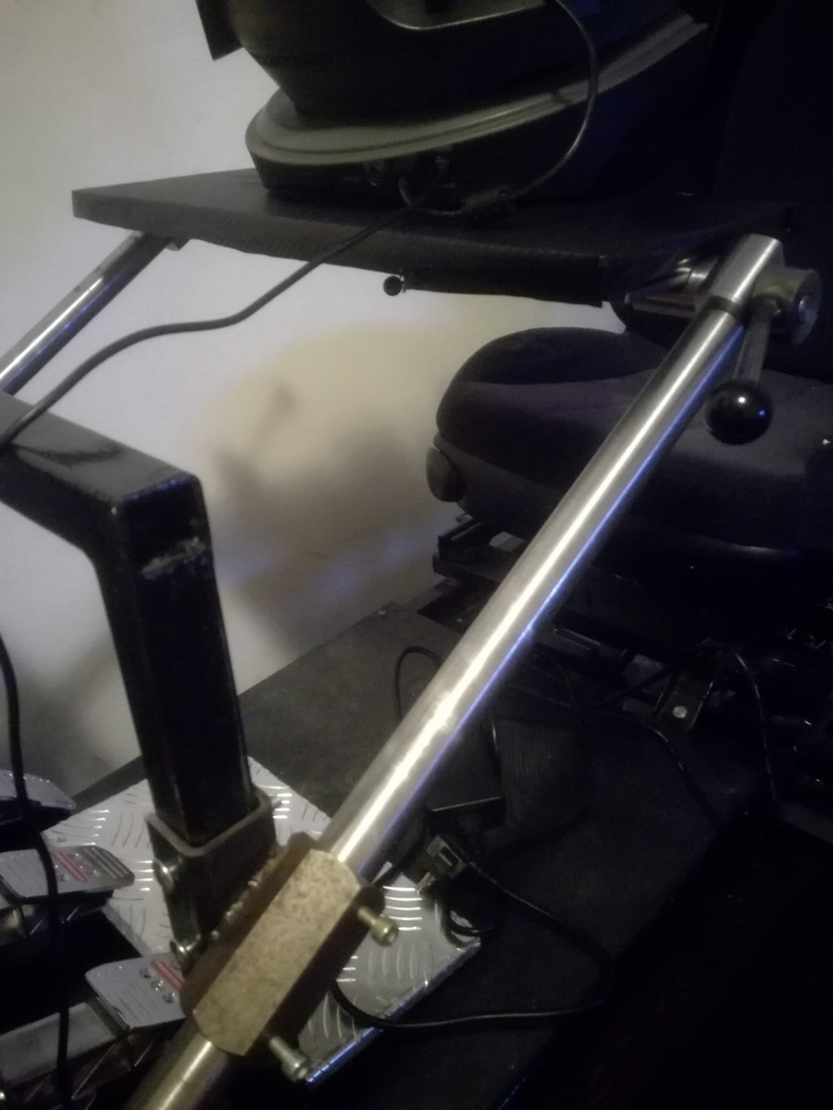

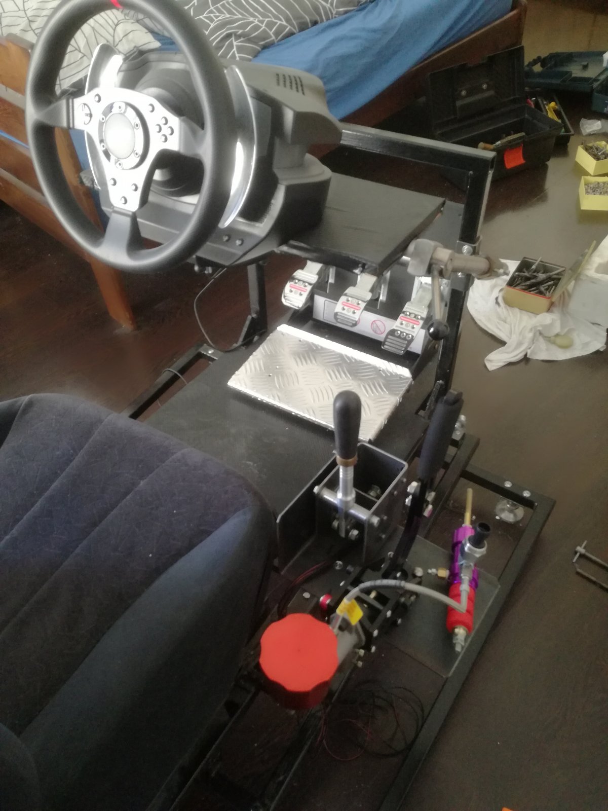

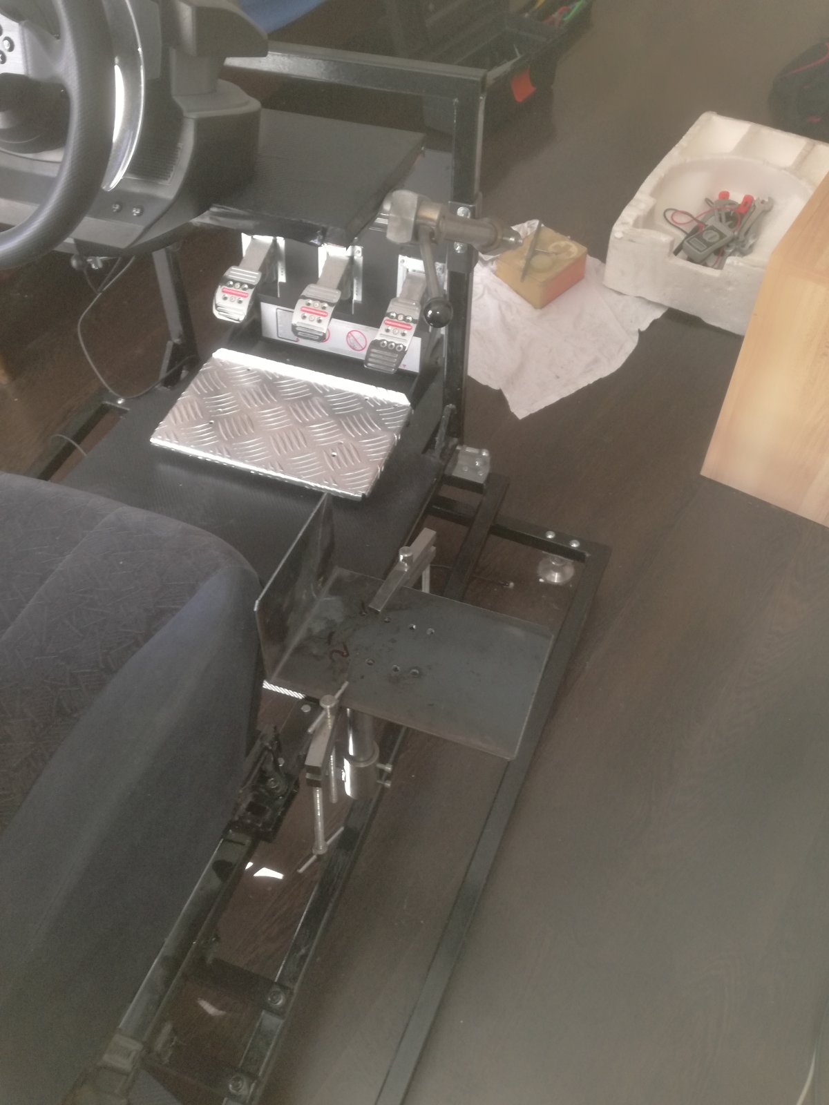

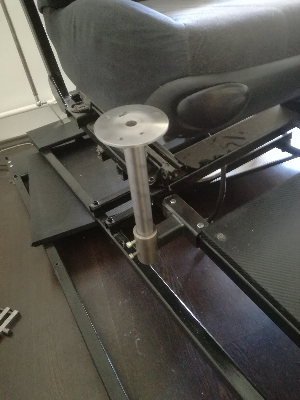

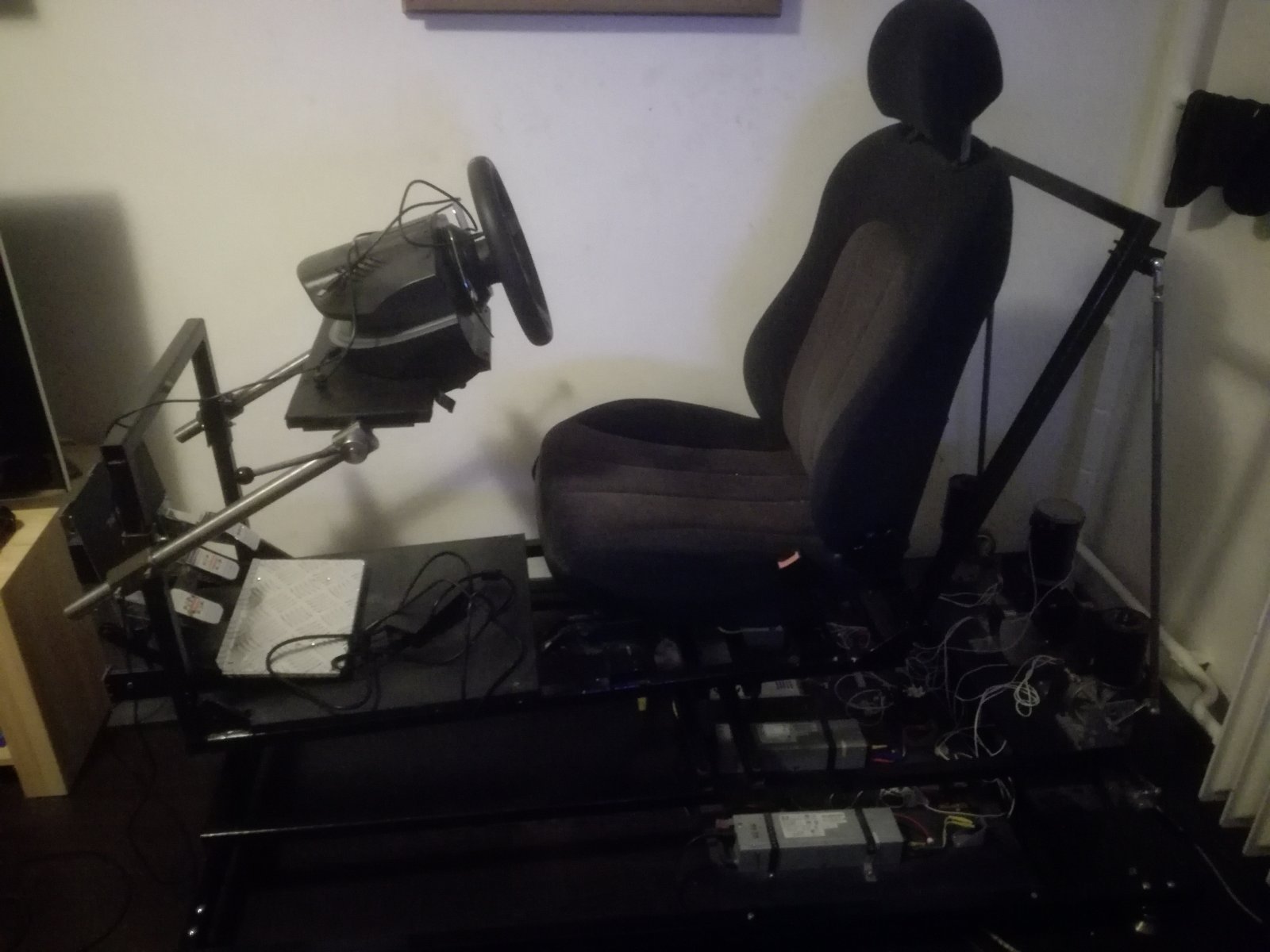

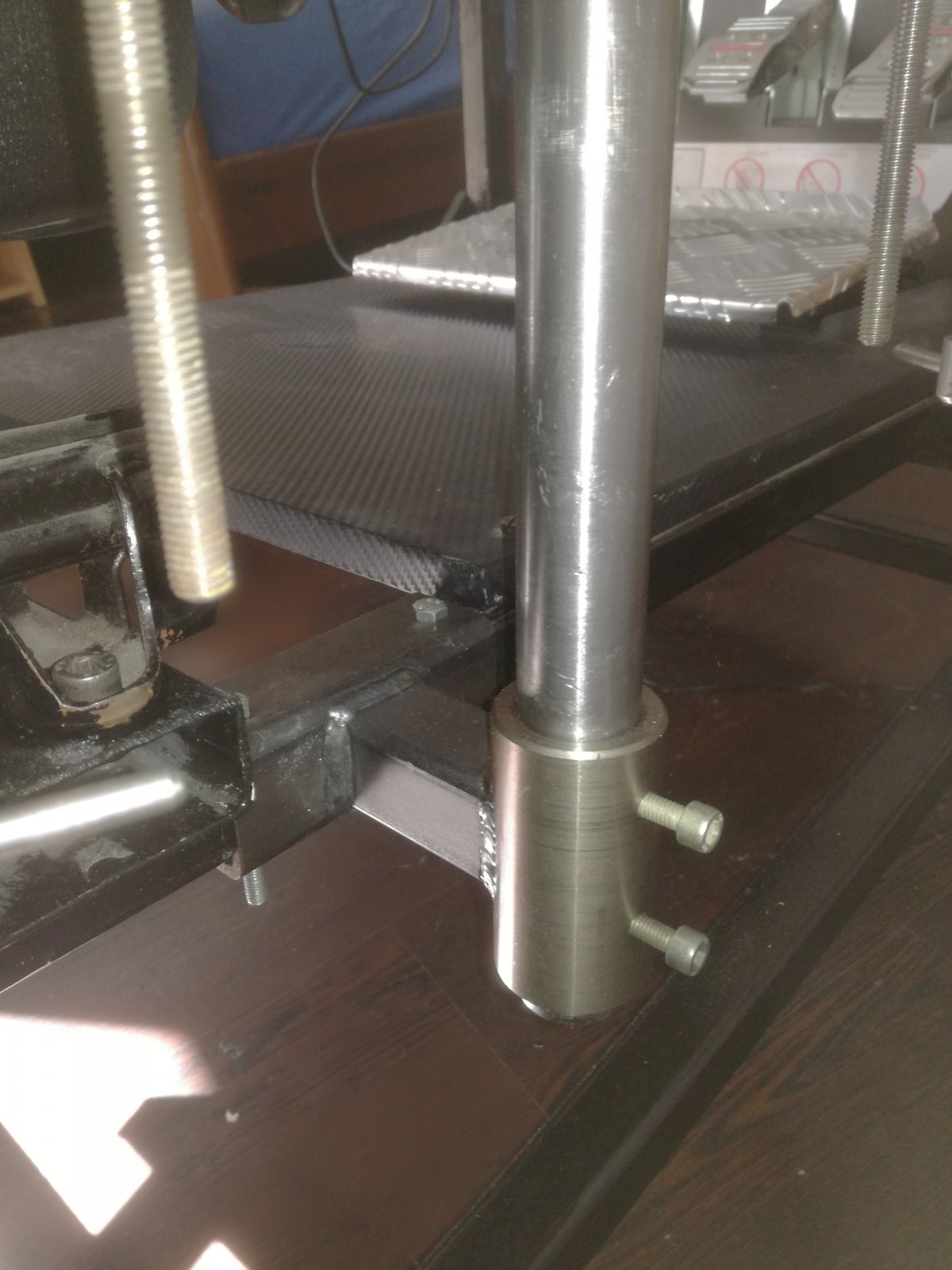

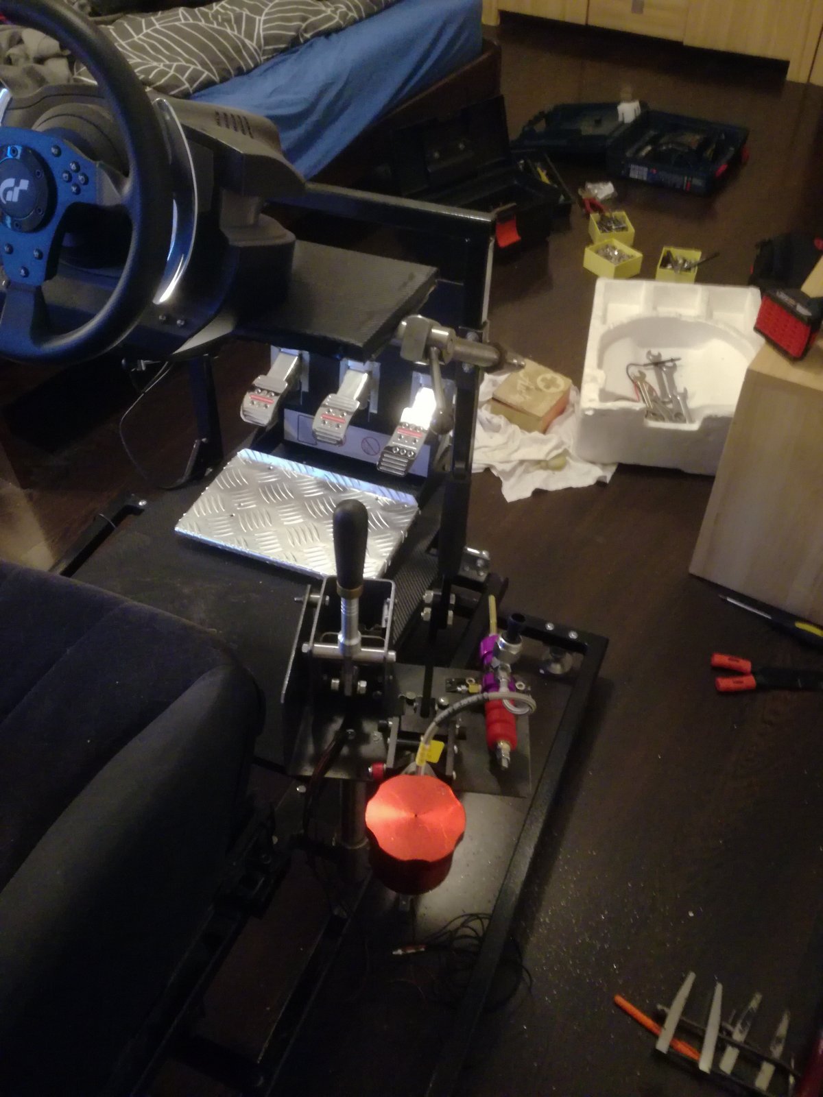

    From last project update,i did just one thing.Make fitting for wheel..which is a little bit height adjustable under angle..tightened by screws from side.Not so good option,but better than nothing :D
    Photo of wheel fitting and complete rig.
    Next will be fitting for sequential shifter with hydraulic handbrake.

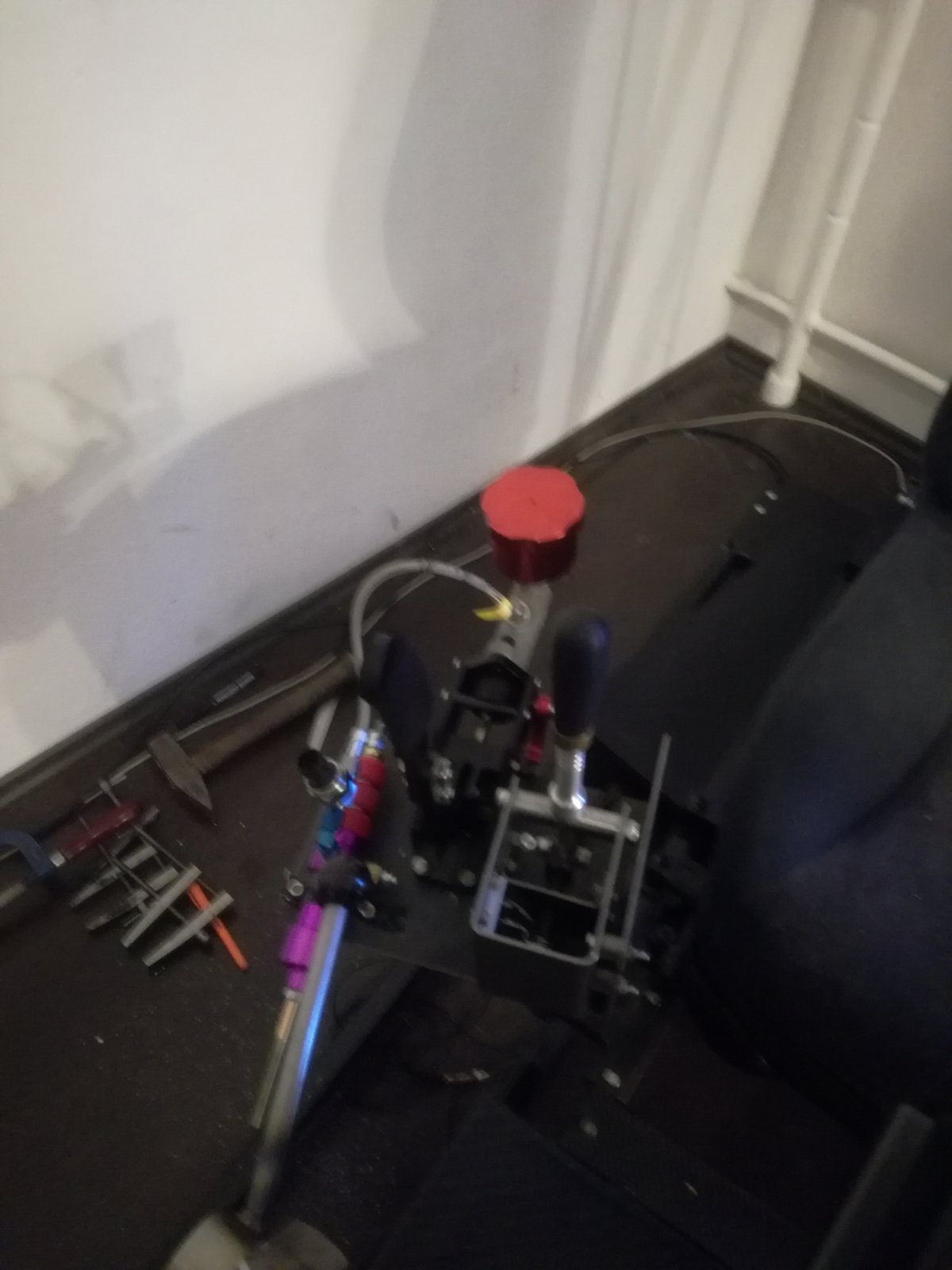

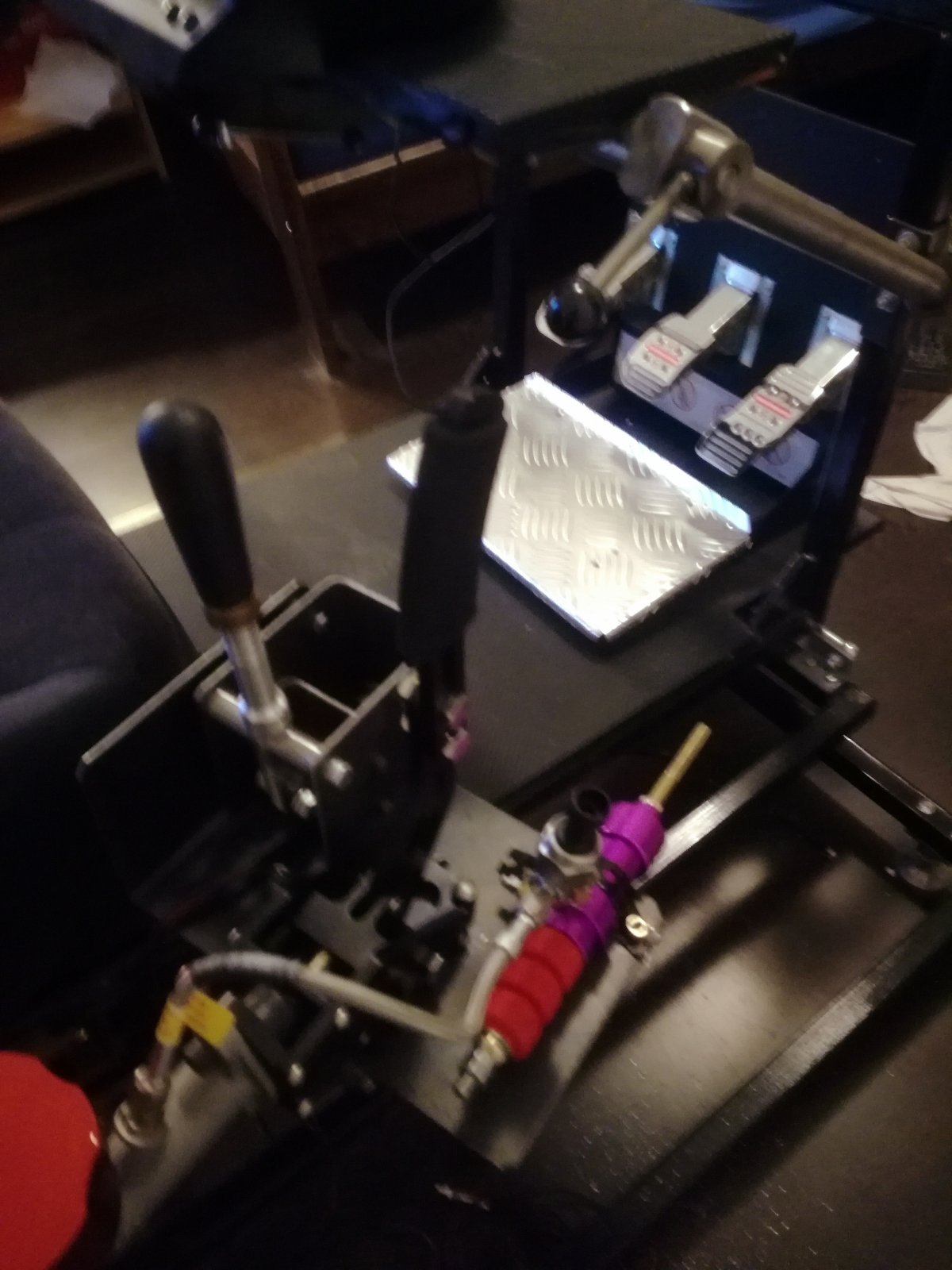

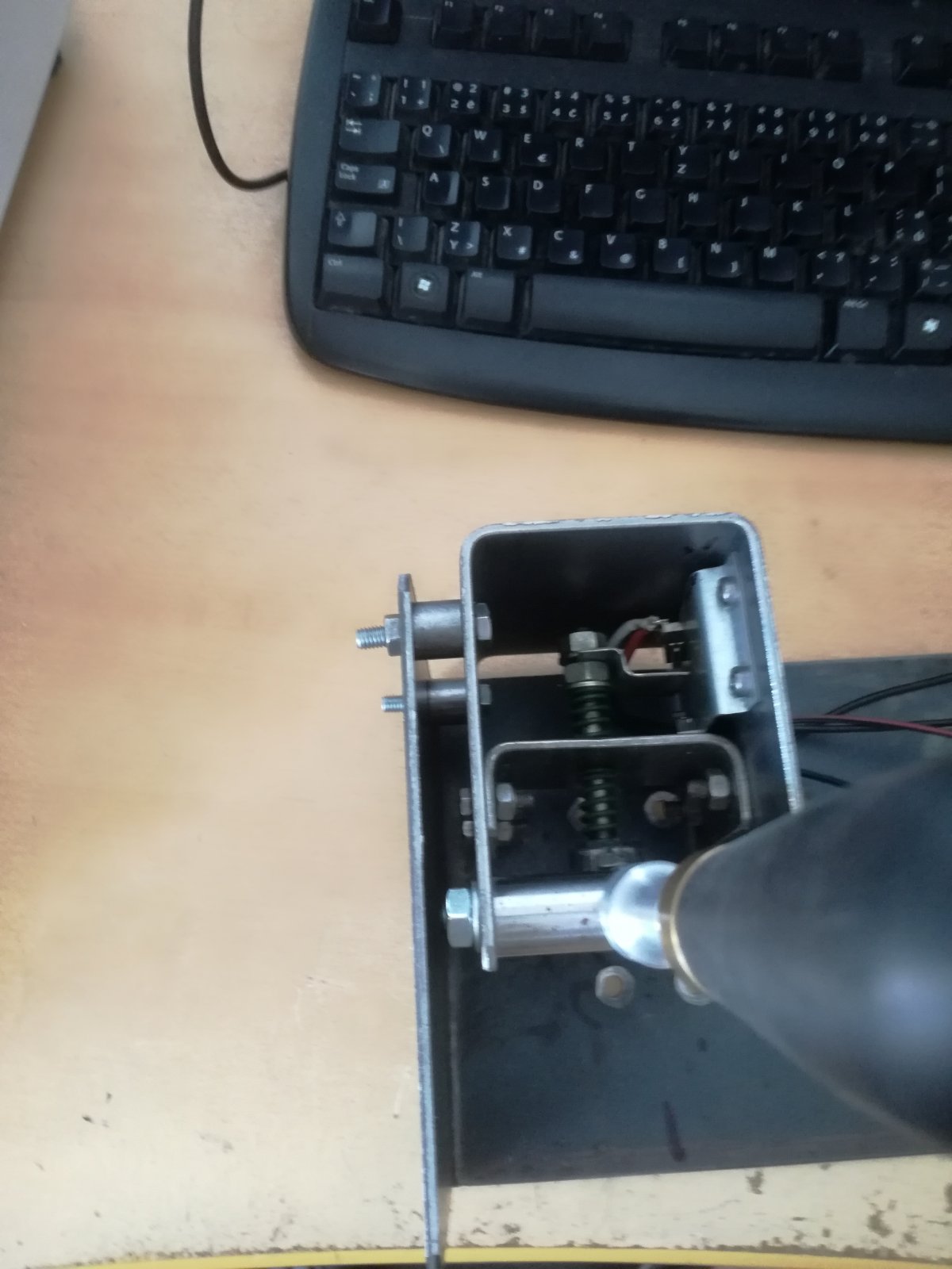

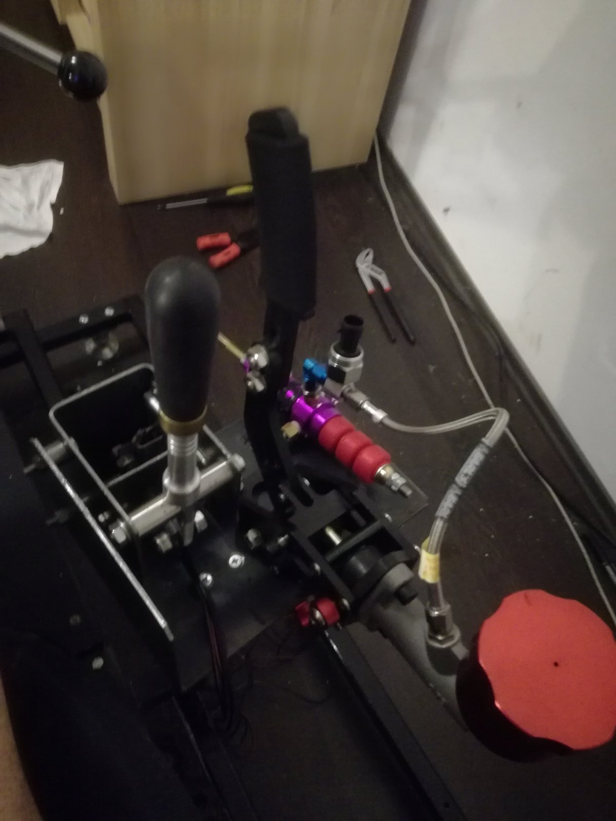

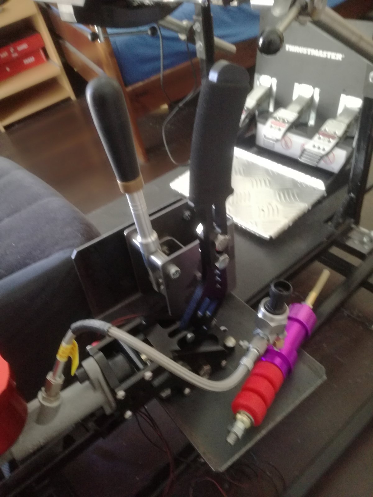

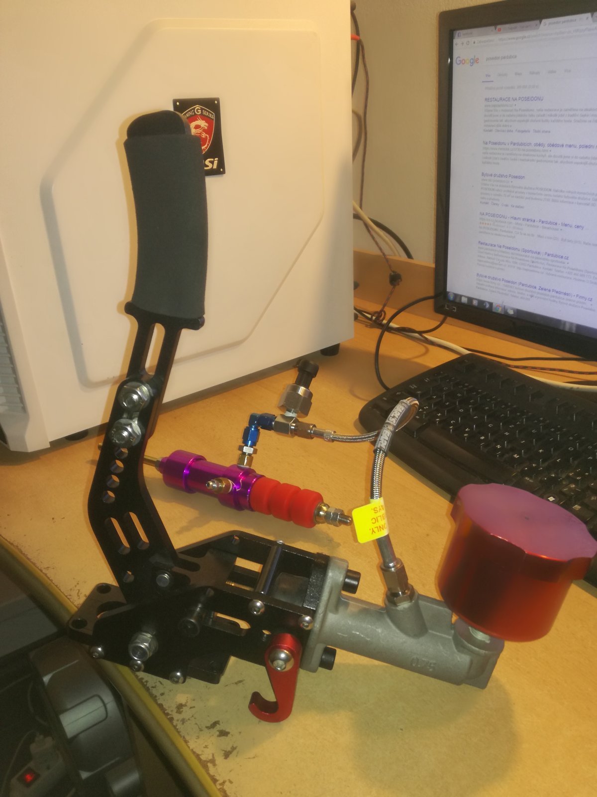

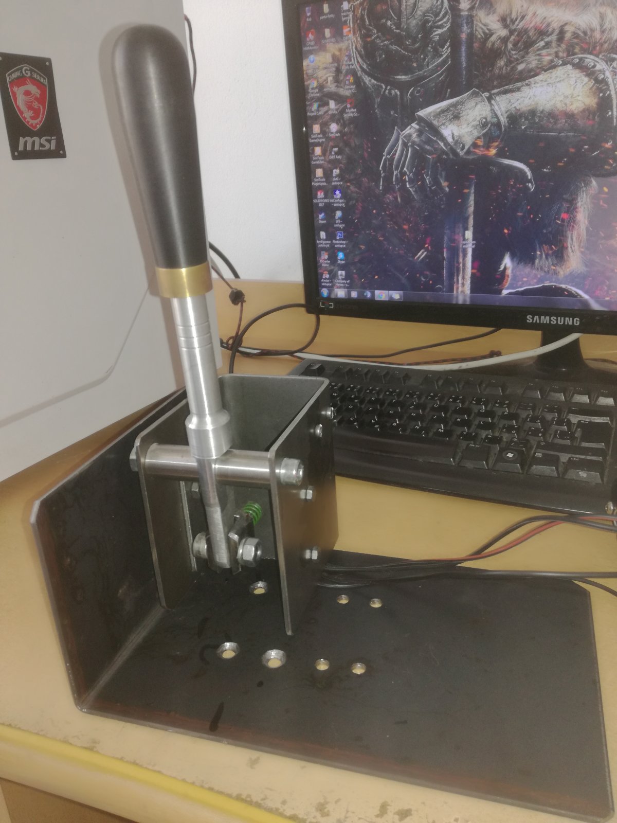

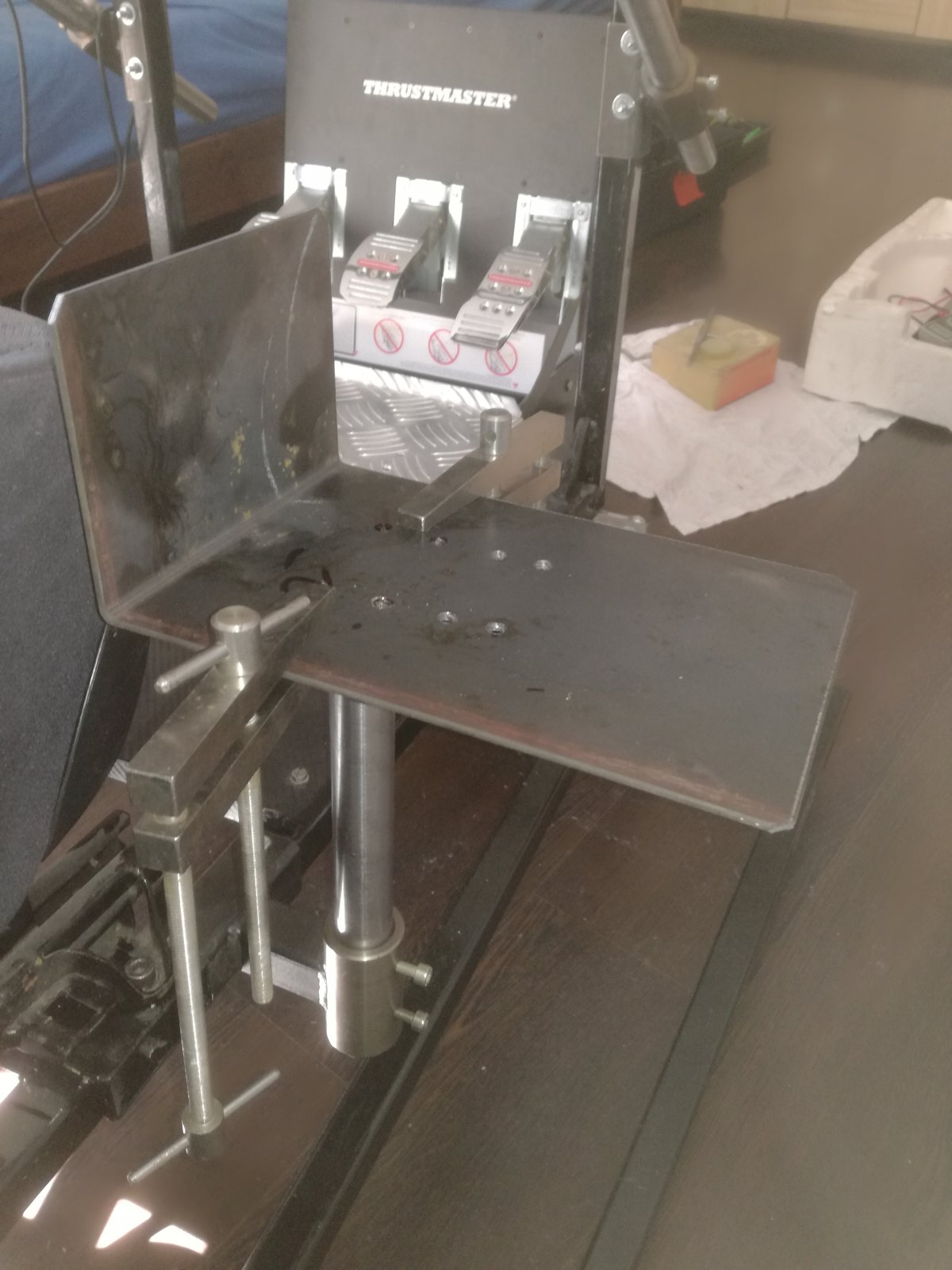

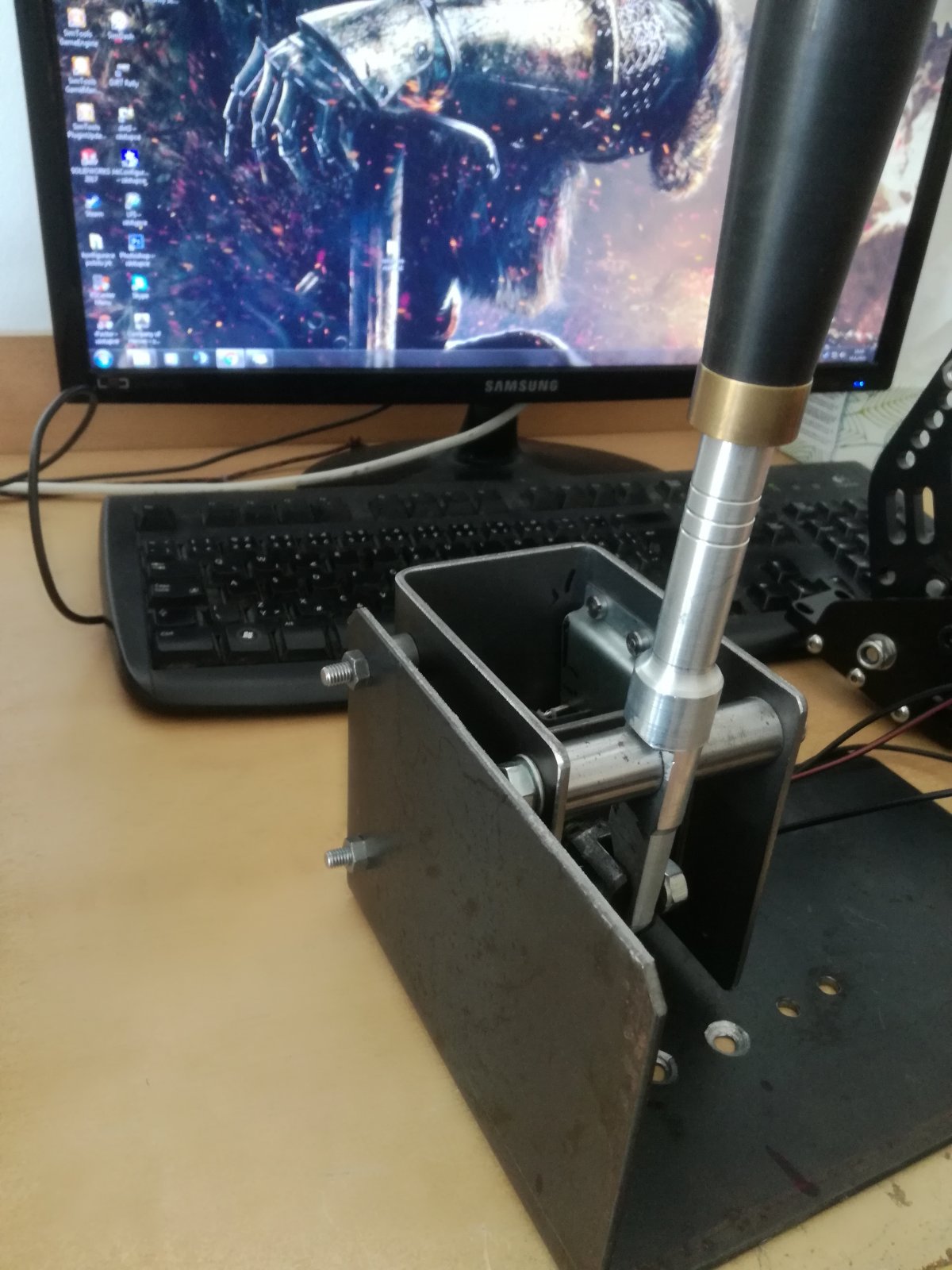

    Some update after long time :)
    I have made holder for sequential shifter and hydraulic handbrake.It's little bit height adjustable by screws.
    Also I've got motors from pgsaw (50:1),inverted gearbox for left and right.Next thing i have to do is make new shafts for motors.
    Some photos from my last work :)
