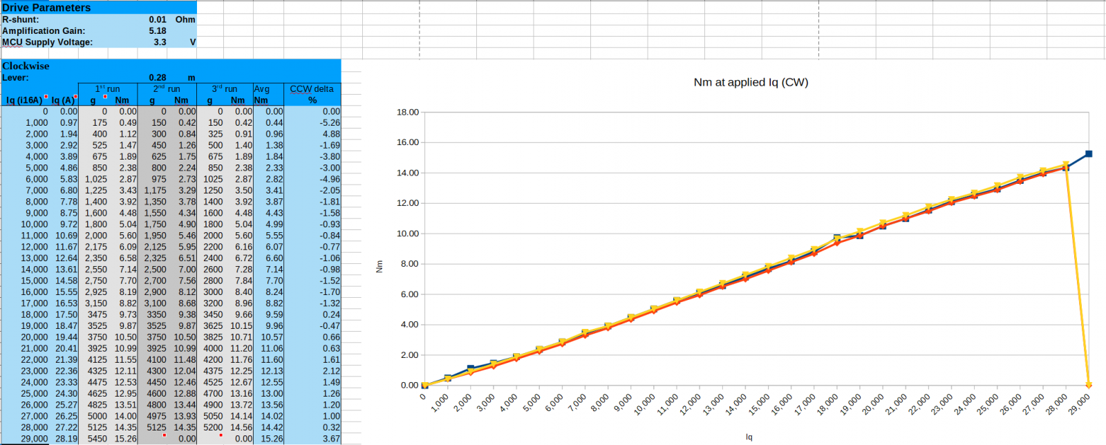

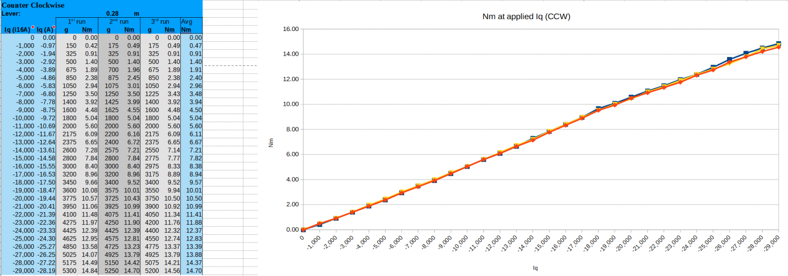

    Torque vs motor current diagram is linear? I'm wondering about measuring torque, if it's possible to translate motor current with simple method, without calculation etc.
  6. Benu
    Benu Member
    Mar 19, 2018
    128
    1,295Coins
    +42 / 2 / -0
    Yes, input current and output torque are linear. Clockwise and counter clockwise directions seem to be reasonably equal too.
    Accuracy:
    The data was aquired with an analog kitchen scale. 0g - 5000g and min scale interval of 50g.
    Current Torque ratio clockwise.PNG Current Torque ratio counter clockwise.PNG

    Seems like differences are caused only by scale measurement reading :) So now there's only problem with finding proper current sensor. 30 A are common, but I think that's too close to the limit of the engine... IMO 35 A sensor is reasonable minimum.

    Yeah, that will be the major part of (in)accuracy.
