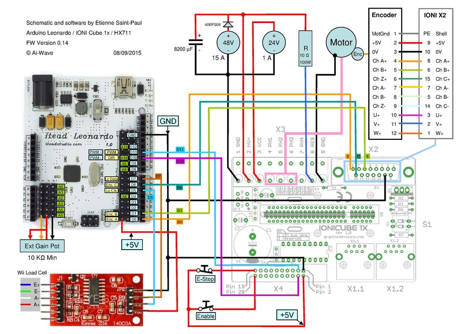

    The OVP diode should be in serial with the PS, not in parallel, as on this schematics :
    I haven't been working on a BLDC solution yet. I've tested VESC and could make it work with a MIGE 130ST-M10010, but there was a bit of torque ripple (I wanted to try to change the current sensing shunts to gain precision, but didn't find the time). I've also tried ODrive but could not make it work with this motor (but it seems possible). Both drives are overkill and not designed to do precise torque control, but I think that with minor adjustments they could be good choices (except ODrive is awful to configure, no GUI, and is for 2 motors which is useless for wheels).
    I wanted to try with the X-NUCLEO-IHM08M1 some time ago, but it was not produced anymore, since then I've seen that it's produced again, but not in large quantities, and the next batch is in 2 month :mad:
    Other boards have appeard since then, like the shield based on infineon IFX007T which seems to be a very interesting alternative (limited to 40V, but that should not be a problem if choosing the correct motor).
    I'm focusing on the software, as designing a BLDC controller would be a bit time consuming and I'm quite sure that there is a cheap (<100 €) drive that will do the job, and because the software is the weakest aspect of commercial products at the moment.
