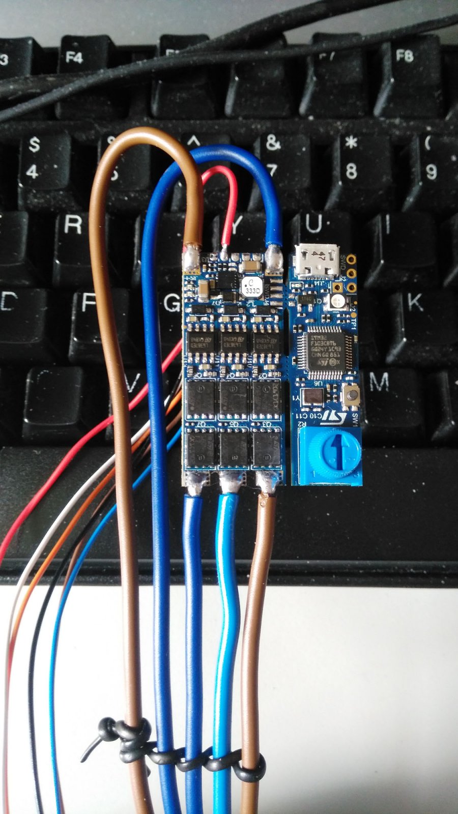

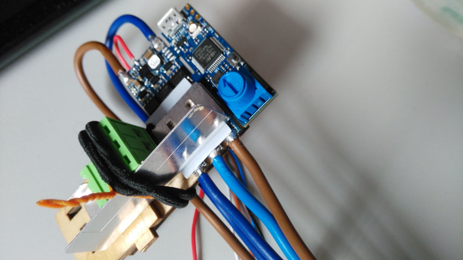

    pcb is too small! After some practice, finally welding is completed :)
    Simple heat dissipation

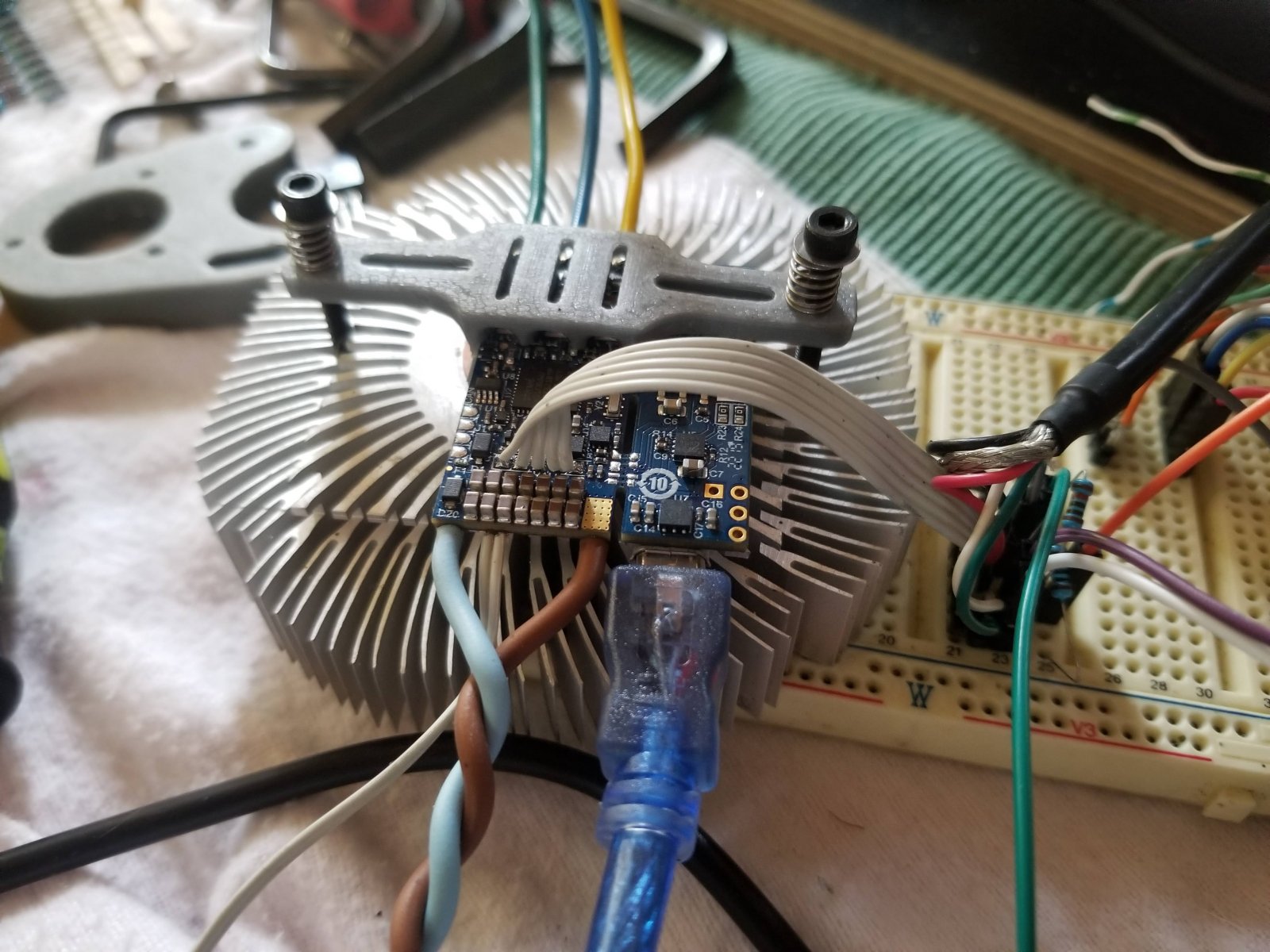

    @fzxj250 I think you may needmore heat sinking than that, this is what I did
    You can get away with a lot less but in my book over kill is better than under kill
    Dont look too hard at the wiring, thats all going to change when I make a housing for it

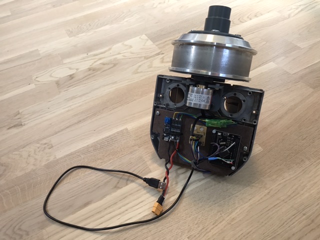

    Just got a pair of b-g431b-esc1’s delivered this week and got one soldered up and connected to my hoverboard motor. @danove_b and @Benu helped me out getting it all to this point. Thanks guys! I’m not quite there, but close!
    I’m using a MMOS unit and flashed the esc with Benu’s FW. When I connect everything and run it, the motor starts humming. If I turn on a simple spring effect the motor gets very notchy, like I just connected the windings directly to a power source, worse the further from center I go.
    What could this be? Got the windings mixed up maybe? I have no idea which one is which..

    Now I do! After some shuffling around I ended up with a working wiring! (It is tough being color blind ;) )

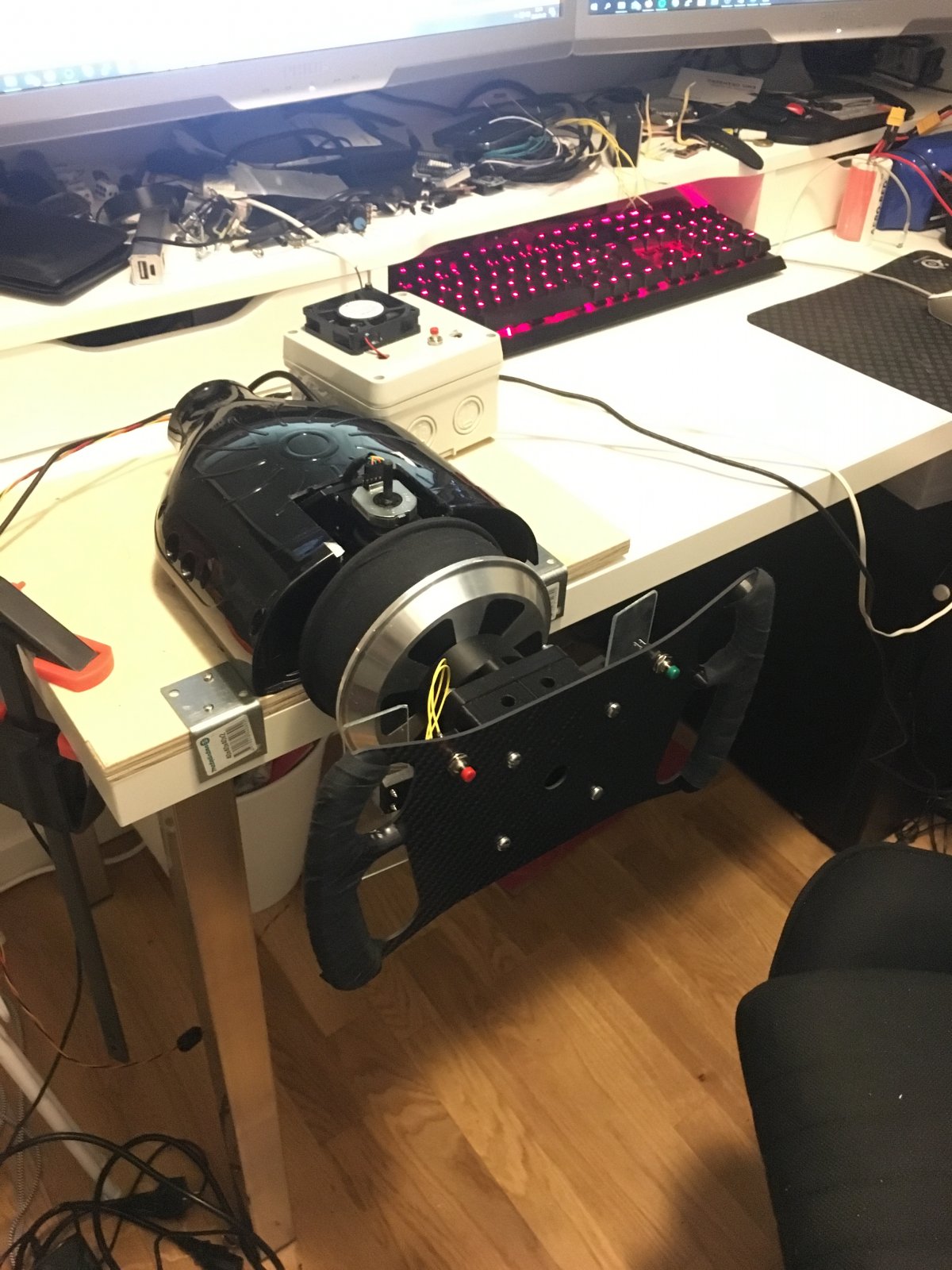

    Got my unit up and running today!
    Big improvement from the old one.
