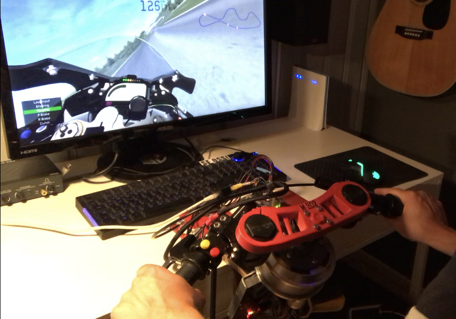

    Is that a motor bike handle bar attached to the hoverboard motor?
  2. Chris_Beeves
    May 31, 2019
    378
    2,184Coins
    +259 / 4 / -0
    Yes it is.
    3D printed most parts except for the aluminum clip ons. I think I will have to beef it up a bit. The power of this motor is way more than my old DC rig.

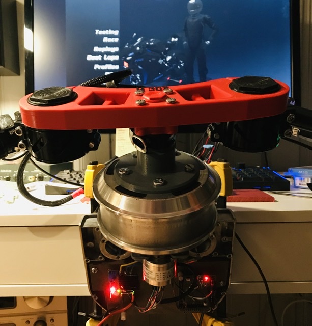

    Thought I should share my version of encoder mounting to the hoverboard wheel, hopefully this can help someone!
    It's an AMT103 rotary encoder, a really cheap encoder with 2048ppr and 8 index-pulses per revolution.
    I 3d-printed a mount that fits on the original hoverboard base, to which i mounted a 5mm carbon fibre rod with bearings. On the rod there's a rubber wheel that rolls against the hoverboard wheel.
    There's also 4 small springs, to help the rubber wheel to press firmly against the hoverboard wheel.
    Took a few iterations to get it working, but now I have an encoder with 0 backlash.

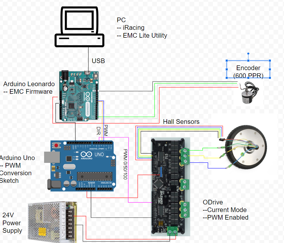

    Successfully drove a race using the 6.5" hoverboard wheel as a steering wheel. This was my first experience with an FFB wheel, so can't compare to anything, but driving experience was so much better then the old thrustmaster wheel I was using. Had to add in a second arduino as a PWM Converter because I couldn't get the EMC output to work with the Odrive. See diagram.
    Next Steps:
    -- Tune Feedback. (Upgrade EMC utility? Vibration effect is too high, turning force too low)
    -- Install Hardstop (Don't want the wheel spinning out of control as i crank up the power)
    ---- Is 350 degrees of rotation enough? How are others dealing with this?
    -- Eliminate, (or improve performance of ) Arduino based PWM converter. Looking for a way for oDrive to accept signal direct from EMC firmware. More research to do here
    -- Mount encoder. No more c-clamps and vice grips.

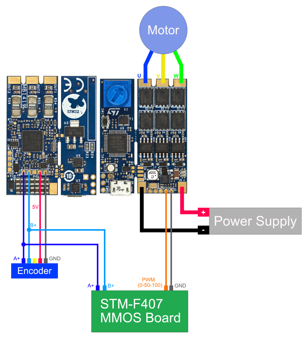

    With the B-G431B-ESC1 the setup would look like this:
    Any force feedback board able to deliver PWM 0-50-100 output should work.

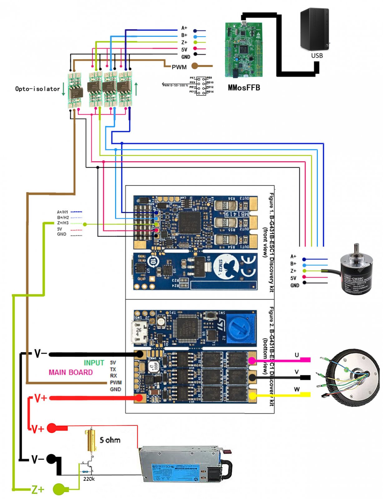

    hi Benu
    Based on your security recommendations, I eventually re-established the connection using optical isolation.
    After testing, it runs perfectly.
    The Z phase function of mmos can also be used.
    I made a detailed picture

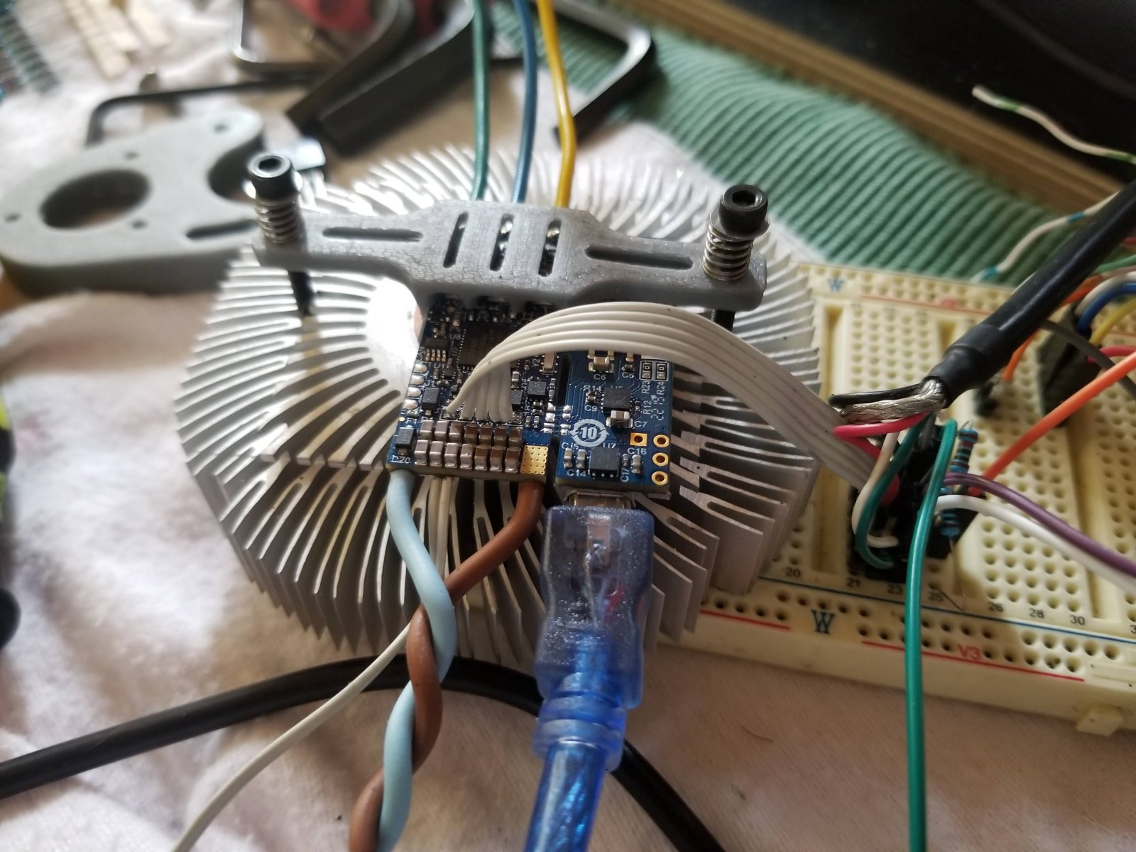

    Thank you very much for your suggestions. At the beginning I used the minimum force feedback test (and the time is very short), the temperature is acceptable.
    Because the size of the ESC is too small, it is difficult to install a larger heat sink, so when I tested higher force feedback, I temporarily used a fan to actively cool the ESC.

    Can the z toggle be omitted? And what to do then with mosfet gate connection on brake resistor?) Thanks.
