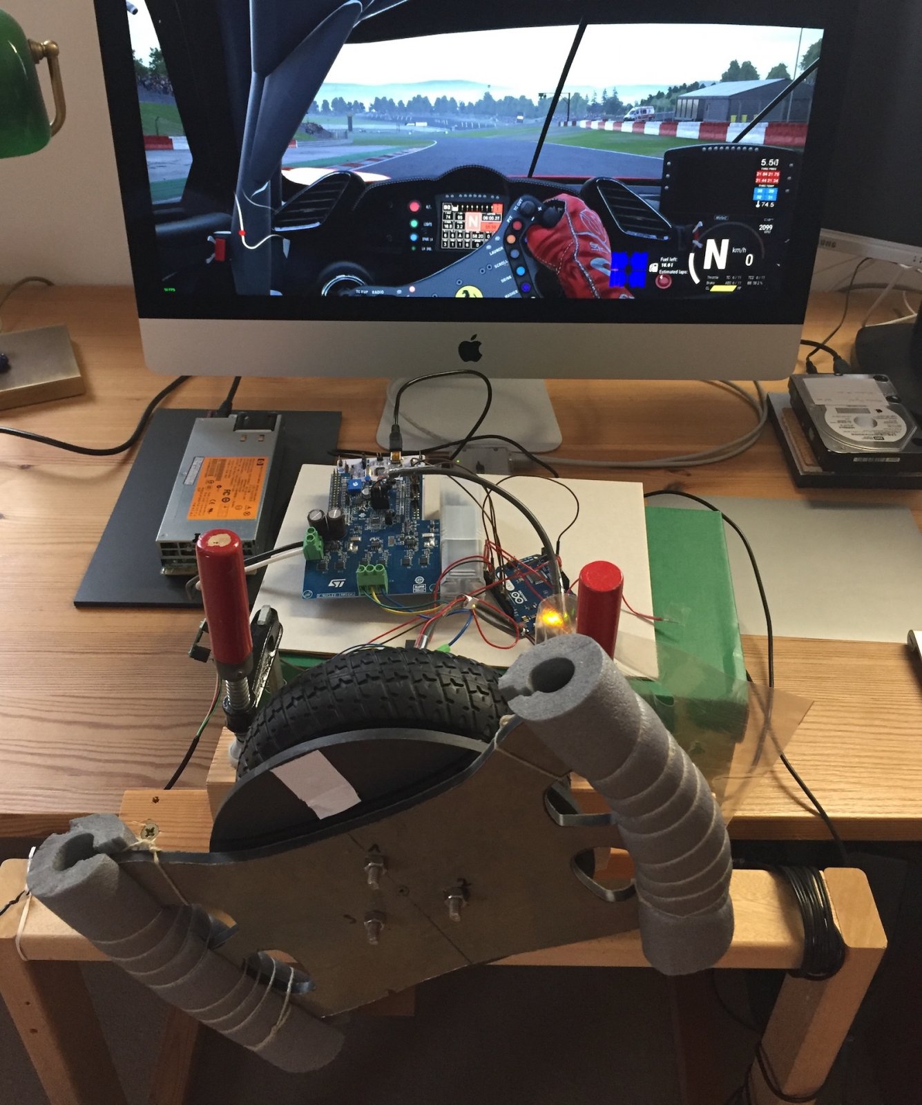

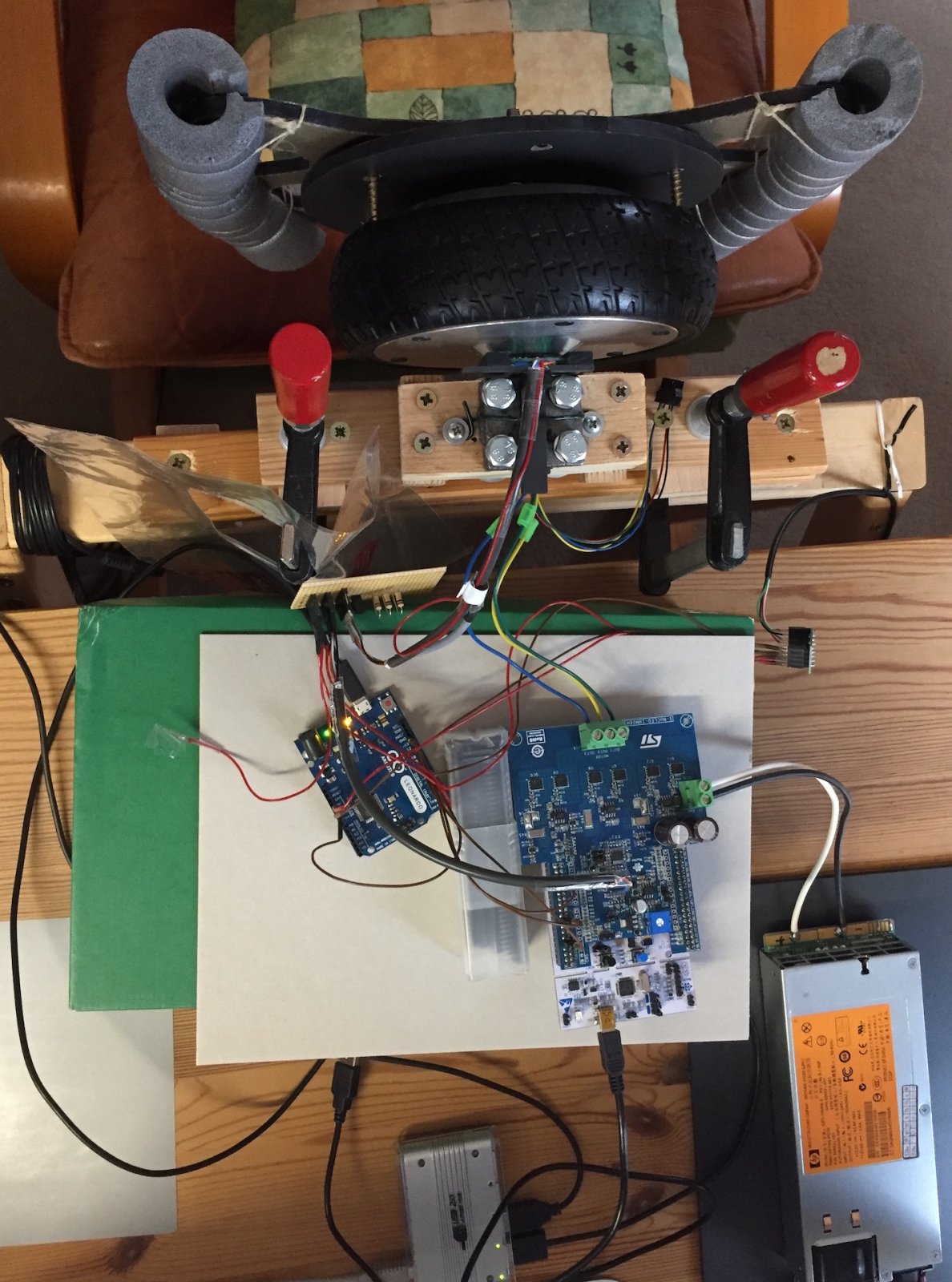

    The DD-Wheel powered by a Hoverboard motor works! The wheel did its first laps. No broken thumbs or blue smoke so far.
    I used throttle and shifter from my DFGT. A load cell connected to the Arduino is the brake. Although there are still things to tune the wheel feels good. The motor is not even warm. After a couple of laps its still room temperature. The FETs on the driver board are at 35 Celsius.
    Next things to do:
    • Currently I only use 100 different force values from the Arduino as input to the motor. That has to be improved. Does anyone know how many different values the AIWave Arduino is able to deliver?
    • Increase torque. As precaution I limited it to 3 Nm. According to the Hoverboard manufacturer the motor should be able to deliver 12 Nm.

    Yes, 12V from a second hand server power supply. To get the 3 Nm I feed 6 A from the driver board. The overcurrent protection of the driver board will jump in at 30 A, so there is some headroom. But as I said in an earlier post, I am limiting the current feed from the driver at 6 A right now. I need to check if the motor parameters are correct, before increasing current output to the motor.
    AMS, the manufacturer of the AS5306, was so kind to send me samples of the encoder chip and magnetic rings.
    'will do that.
    In the mean time I increased the output resolution of the FFB force values to my wheel to at least double the resolution of the AIWave PWM signal.
    From my observation of the AIWave Arduino PWM signal I guess at 4 kHz the Arduino sends 1024 different values and at 8 kHz 1535 different values. Can anyone confirm that?
    That gives a really smooth ride now.

    The hoverboard motor torque is now increased to 6.3 Nm.
    I also found out that my earlier statement of needing 6 A to get 3 Nm is likely wrong. It seems to be far less is needed. The statement was based on values delivered by the STM development environment. But these values are in an internal unit not pure Amps. So I put a multimeter in series with V+ line from the 12V supply.
    • without load the meter reads 0.15 A.
    • at 3 Nm the meter reads 0.96 A
    • at 6.3 Nm the meter reads 4.6 A
    When racing with 3 Nm max the motor is not even warm. The FETs are at 35 Celsius.
    Racing with 6.3 Nm max (15 minutes test) the motor is mildly warm and the FETs are at 46 Celsius.
    That looks promising.

    I agree, 8 Nm should be plenty. My selfmade rim is 29 cm and racing with 6.3 Nm is almost a workout.
