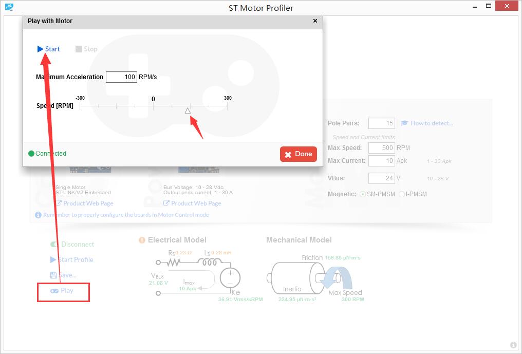

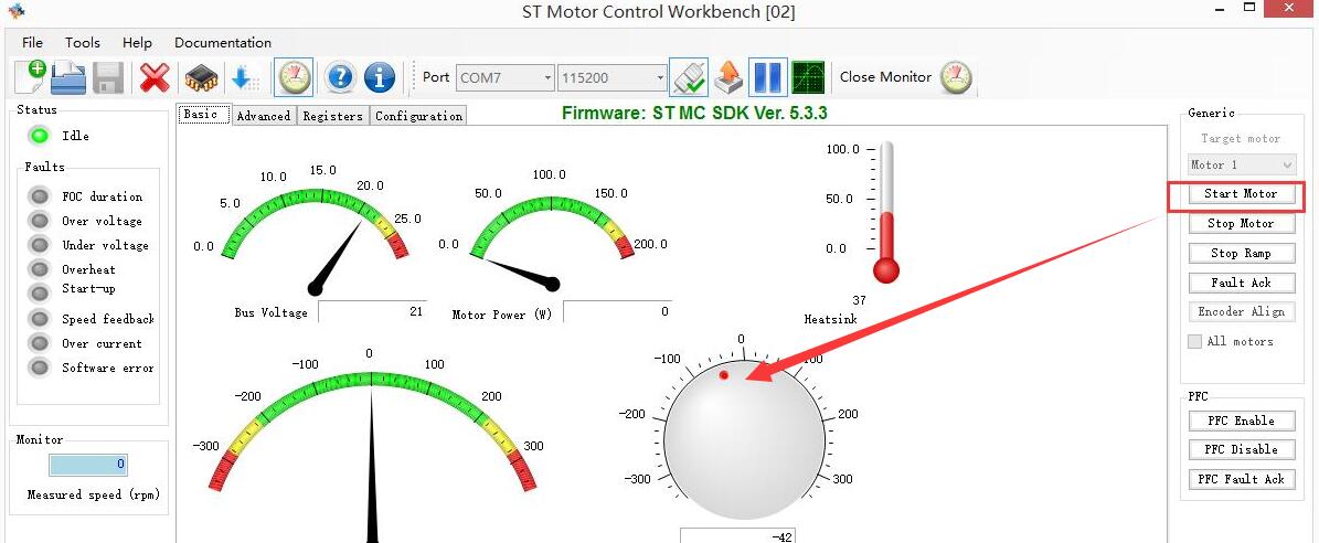

    +90 / 1 / -0
    I don’t have professional equipment. Can I use the Motor Profiler to judge whether the UVW output is normal?
    Now I run the Motor Profiler and the motor rotates normally.
  16. danove_b
    danove_b Active Member
    Nov 11, 2017
    209
    Sweden
    1,782Coins
    +80 / 3 / -0
    That was strange. I had problem with one of the encoder inputs needed more pullup, but if it works in the profiler it should be ok. Have you tried to operate it in torque mode from the profiler?
  17. fzxj520
    fzxj520 Active Member
    May 14, 2015
    176
    1,341Coins
    +90 / 1 / -0
    Sorry, I only saw the content on the picture. It can work normally with different speeds.

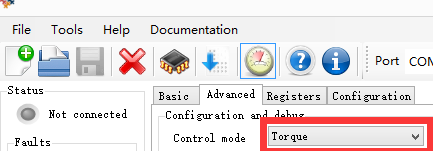

  18. fzxj520
    May 14, 2015
    176
    1,341Coins
    +90 / 1 / -0
    I found this setting and it works

    @fzxj520
    As far as I can tell, the motor profiler does not use the encoder. So it still might be an issue with the encoder.
    There seems to be no cogging (within the angle limits) when Desktop Effekt Feder is zero or the wheel is not pushed beyond angle limits. In those cases no force feedback is applied to the wheel.
    Only when force feedback is applied, Desktop Effekt Feder turned on or pushing beyond angle limit, the cogging starts.
    Maybe there is interference from power supply or motor phase wires to the encoder wires.
