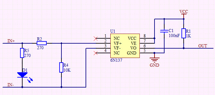

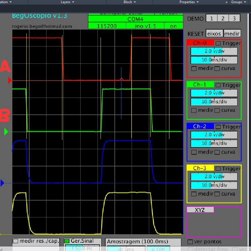

    What optocoupler are you using as it looks like there is ~7ms of turn on lag on trace A and ~3ms for trace B.
    If you look at the vertical lines I drew on you pic it is far from 180deg out of phase.
    This can be caused by not a constant speed and diferent turn on speeds for the optos.
    Switch your scilloscope to the xy function, if your A & B channels are 180deg out of phase you should get a perfect square above 0v, if you see a trapezoidal trace it is not alligned or your optos are too different.
    You can do a trace before and after the optos to find the culprit.
    Slow optos could result in missing pulses at high rpm as they don't have enough time to turn on.
    Best if you could get a constant speed to the encoder when viewing on the scope even if you take the encoder off the wheel and use a small motor to drive the encoder.
    Try get atleast 3 complete cycles on the trace, 1 cycle isn't enough to be reliable.

    Why do you have opto couplers? I don't need them, and I'm pretty sure you don't need them either...

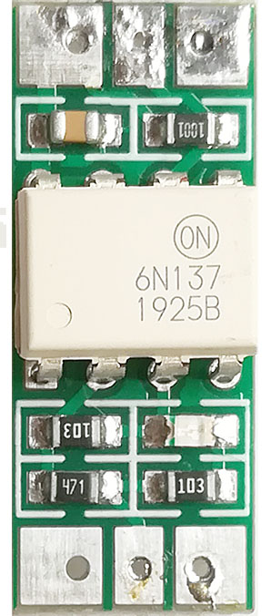

    A. The encoder is directly connected to the ESC. The optocoupler is only between the mmos and the encoder, so should the optocoupler affect the ESC?
    Benjamin suggested the safety recommendations of using USB isolation to ensure the absolute safety of the USB interface, and I chose to use optocoupler isolation.
    I have done it without using optocoupler connection, and still have this problem.
    B, this is a simple Arduino oscilloscope, no external circuit is connected, and the measurement should have errors.
    This is the optocoupler module I use.

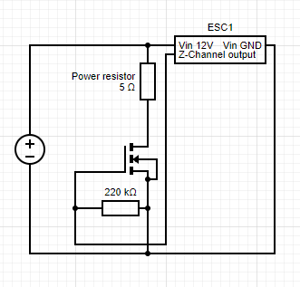

  11. Chris_Beeves
    May 31, 2019
    356
    2,051Coins
    +250 / 4 / -0

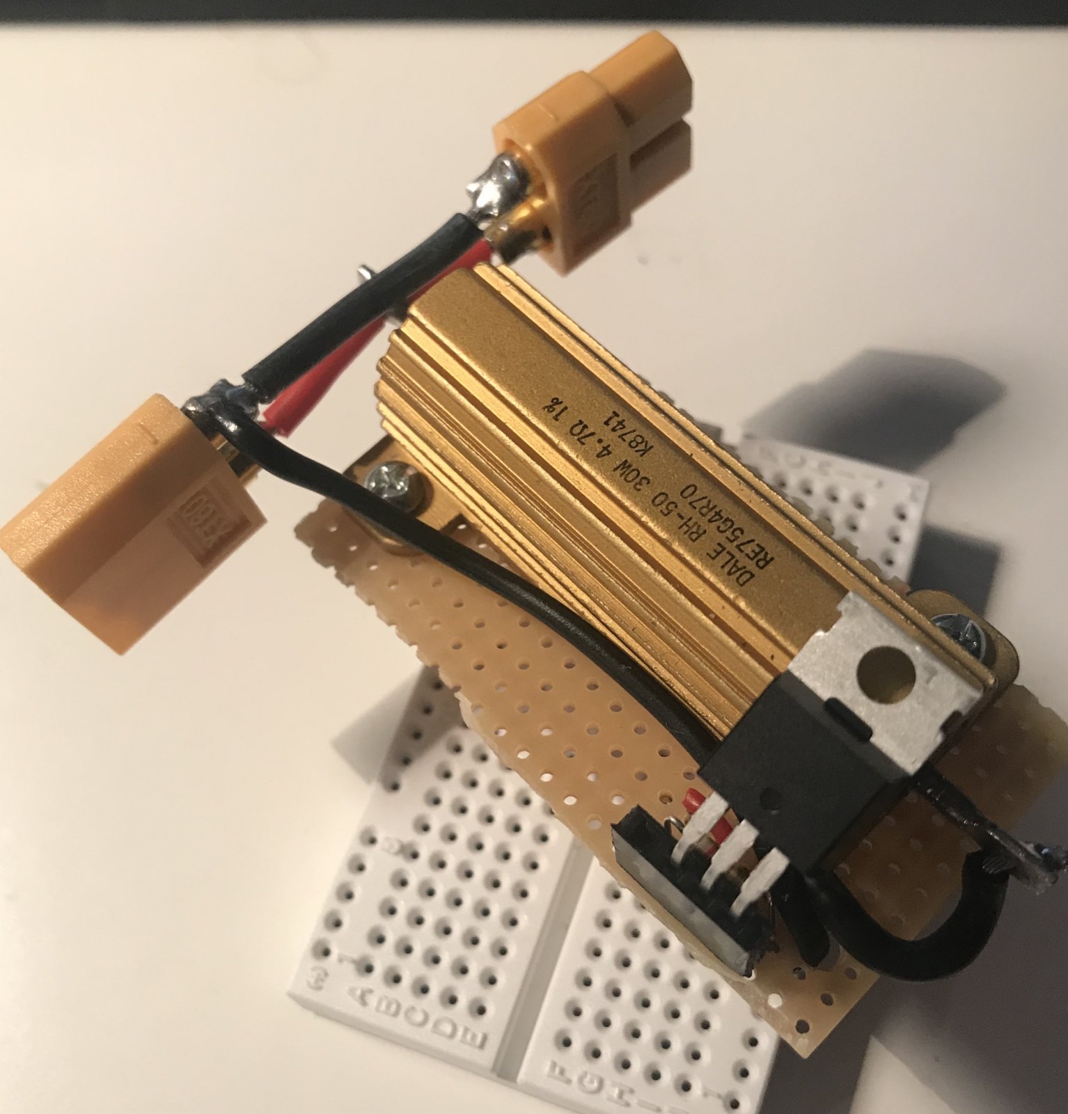

    I now have my wheel pretty much up and running.
    It works great, but the brake circuit isn't doing its job. The PSU keeps tripping.
    This is how I connected it. The mosfet is a IRF520 and the PSU is a Fractal Tesla 550 connected with 12V. My multimeter is too slow to measure the output signal of the b-g431b-esc1, so I can't tell if its trying or just being lazy.
    Can somebody spot an error?

    I am not an expert, but I suggest that you test the mos tube separately, you can connect a small power bulb or a DC brush motor to test whether it can work normally. (G level uses 4V-5V voltage)
    In addition, whether the Z trigger voltage is less than the power protection voltage?

    Yeah, I thought I’d connect some 12V led to see when/if the mosfet opens up.. What does G level mean?
    Power protection should be up over 20V. I think z-trig is 14V or so.

    Your problem may be, that the IRF520 is not a logic level MOSFET.
    The ESC I/O output pins are 3.3V max.
    The IRF520 datasheet shows, that Vgs (max) threshold is 4V and Vgs (min) threshold is 2V. So to be on the save side the IRF520 needs at least 4V to start opening up. But even then source-drain is not completely open. Higher gate voltage gives lower drain-source resistance which gives higher current capabilities.
    Better use an IRLZ44 or IRL540n.

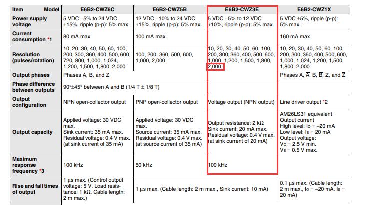

    1. I use the new 1024ppr encoder and upload the corresponding newly compiled code. I exchange the connection between the AB phase line of the encoder and the ESC to obtain a normal FFB.
    2 Then I reconnected the encoder of 2000ppr, uploaded the corresponding old code, and also exchanged the connection between the AB phase line of the encoder and the ESC, and actually got the normal FFB (I did not exchange the connection of the AB phase line before, I can also get the normal FFB), I was very pleasantly surprised.
    I have also changed the connection between the AB phase line of the encoder and the ESC many times before, but I have not been able to get the normal FFB until I uploaded the firmware of the 1024ppr encoder. I think that the unreliable connection between the motor and the encoder caused the ESC to retain the wrong memory until I uploaded the new firmware to eliminate the error. Perhaps it was my negligence.
