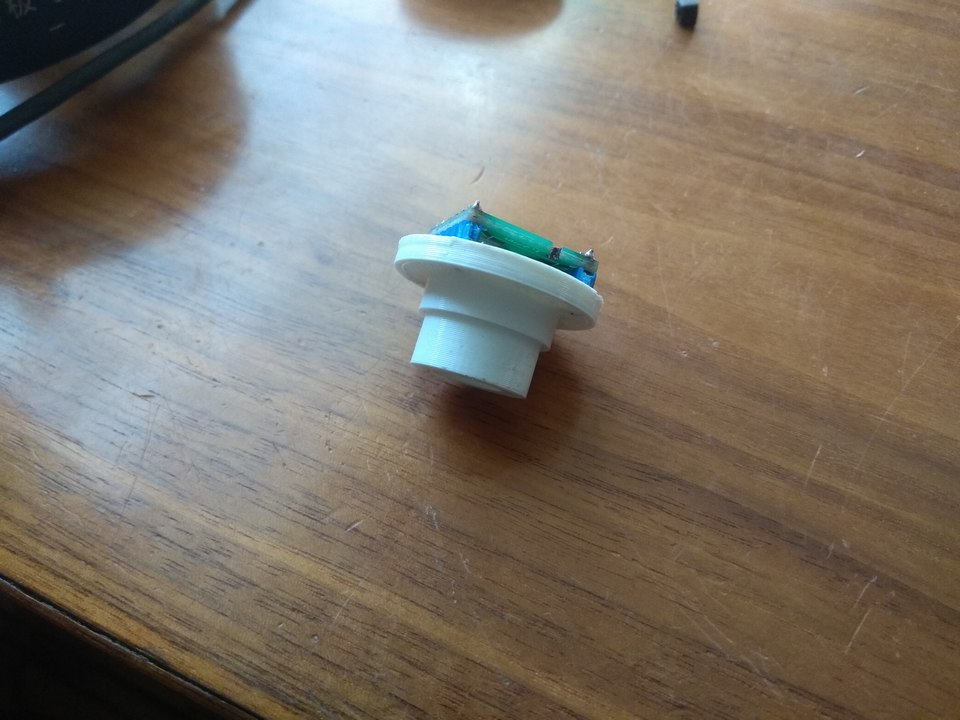

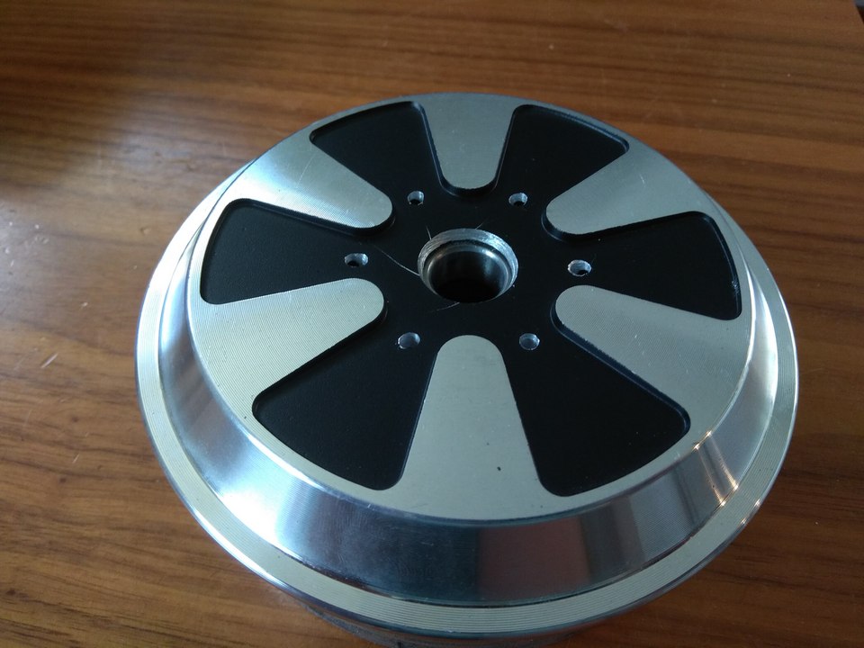

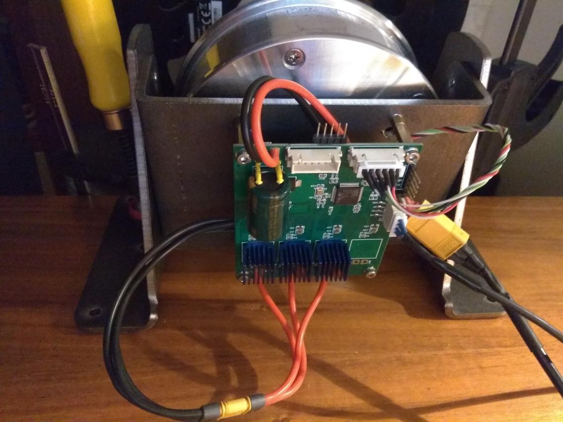

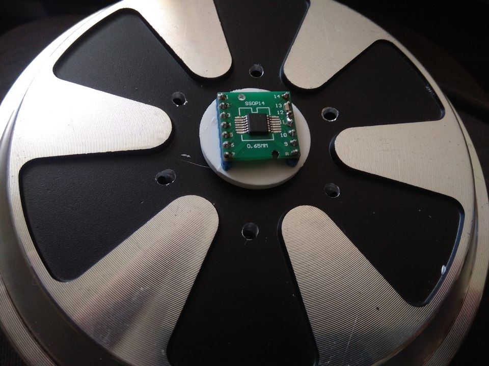

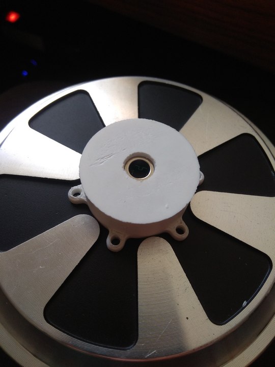

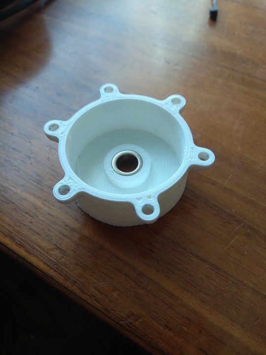

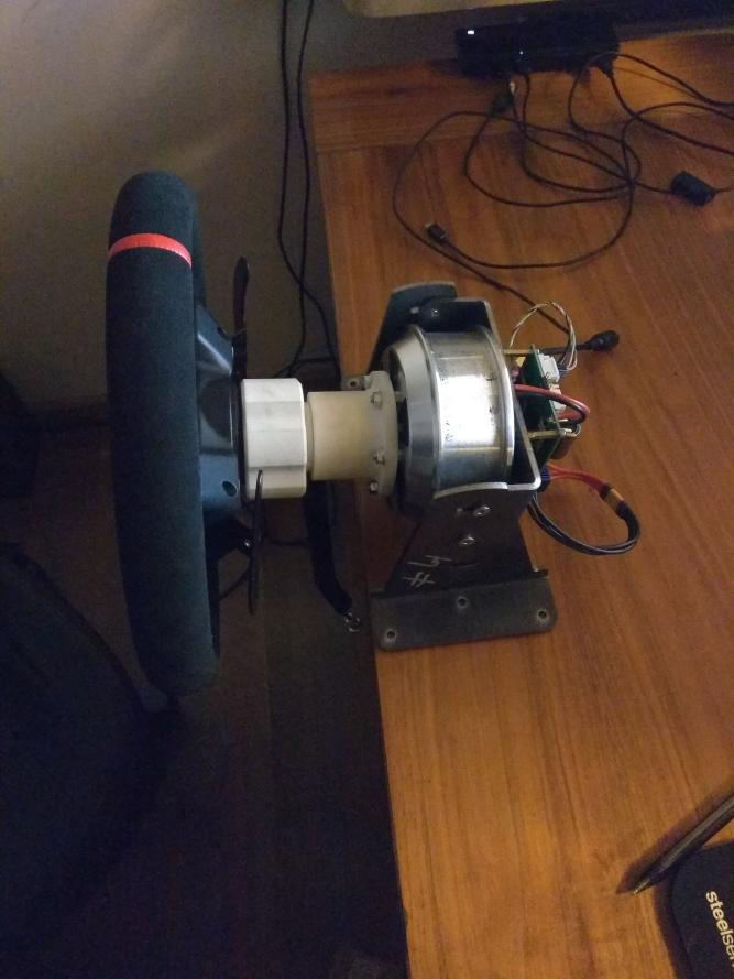

    Would like to share my experience. I use AS5047 encoder and custom made controller based on stm32 and BTN8982. Here it is.
  3. Feisty
    Feisty New Member
    Mar 29, 2020
    21
    169Coins
    +11 / 0 / -0
    AC motor
    Wow very nice work! Can we have some more info/ photos? I'd like to know about how the encoder is set up and about your controller
  4. Roman Smoliakov
    Roman Smoliakov New Member
    Oct 31, 2020
    20
    161Coins
    +30 / 0 / -0
    HI all. Here are more details.
    Starting from controller. It is custom controller based on BTN8982. I developed it from scratch. The goal was to create the cheepest BLDC controller with FOC pocibilities. So controller has three phase controll with inline current sensing and optional forth BTN8982 for braking resistor pocibilities. Here is open project at easyeda
    Firmware. I use software which I build from scratch. It does not have all I would like to implement in it? but already works as FFB device and controlls motor using space vector modulation with physical feedback from encoder. Now I work on true FOC control with both position and current feedback. Now wheel works in Automobilista2, rFactor, Project Cars 2, Racerom and AC. ACC stucks at loading track when wheel is connected. Investigating it.
    What about motor - there were minimum modifications done. Hole in wheel body, shaft was cut alittle bit to free cpace for 3d printed mount. It is secured to stand using standard 16mm linear shaft support.
