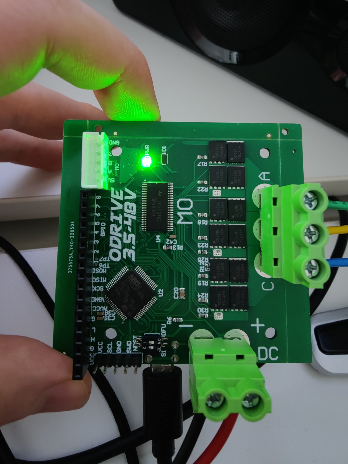

    Now I have another question. I got an Odrive 3.5 48V clone from aliexpress and want to get it into DFU mode.
    So far I've had no success and all I got was it beeing recognized by windows and showing up as "ODRIVE 3.5 Native Interface" in the device manager but no DFU.
    There are 2 switches near the usb port as you can see in the following picture but no combination of "on" and "off" does put it into DFU mode.
  10. Roman Smoliakov
    Roman Smoliakov New Member
    Oct 31, 2020
    20
    161Coins
    +30 / 0 / -0
    Turn switch 1 in position opposite to what it is on picture, then reboot ODrive. Disconnect main power then connect it back. Switch takes effect on reboot time. After that it should be visible in CubeProgramer

  12. Linus009
    Linus009 New Member
    May 4, 2022
    6
    52Coins
    But what I just noticed is that the following entry in the device manager disapears if i reboot the odrive with the switch flipped.
    I dont know if thats a positiv sign but at least something is happening.
  13. Roman Smoliakov
    Oct 31, 2020
    20
    161Coins
    +30 / 0 / -0
  14. Linus009
    Linus009 New Member
    May 4, 2022
    6
    52Coins
    The solutions in the threads you sent did not help but because of your hint with the wrong driver I decided to try it on my laptop which is running Linux and it immediately worked.
    Thank you very much!

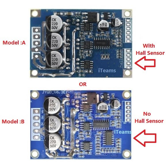

    First of all I apologize for my bad English Let's start with this Right now i'm using arduino FFB wheel with Wheelconfig (the one that made by AI wave) And from reading a lot of forum about making DIY wheel using hover board motor i see a lot of people using Odrive as a driver But it's kinda hard to get one here in south east asia so i just search for brushless motor driver that support hall effect sensor and i found this (picture below) It's can be controlled by PWM + DIR and in the software i use (wheelconfig by aiwave) It's seem to be supported But i'm not sure if it gonna work so i'm here just to ask you guy What do you guy think do you think it's gonna work or not?
  16. Erdem
    Erdem New Member
    Mar 22, 2022
    29Coins
    You can get odrive clon on aliexpress

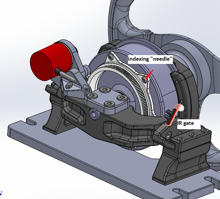

    Now its time to chose encoder. Is there something special about indexing signal from encoder?
    Do I really need encoder with indexing signal build in?
    My idea is to just add IR gate somewhere on frame and "needle" on rotor. If it end up to thicc next step would be printing indexing mark on translusent foil. Capture4.png [​IMG]
  18. Roman Smoliakov
    Oct 31, 2020
    20
    161Coins
    +30 / 0 / -0
    No. It works perfectly without index. I use one without index. You just set the wheel in center position( where center need to be), power it up and that's all. You can use any kind of switch to recenter, but I never used this functionality, because centering wheel befor powering works perfectly for me.
