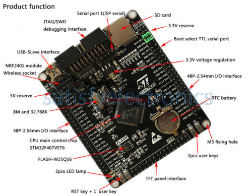

    I have all the bits to build a hoverboard based Ffb steering wheel, what I need help with is a wiring diagram for connecting the hoverboard main board to the Stm32L4VE.
    I have managed to flash the FOC firmware to the hoverboard main board and VNM firmware to Stm32L4VE. I have a 600ppr incremental encoder and will be using the hoverboard battery to supply power.
    I have been reading the posts and no one has uploaded a diagram of how to connect the Stm32L4VE and the hoverboard main board , please help me,thanks

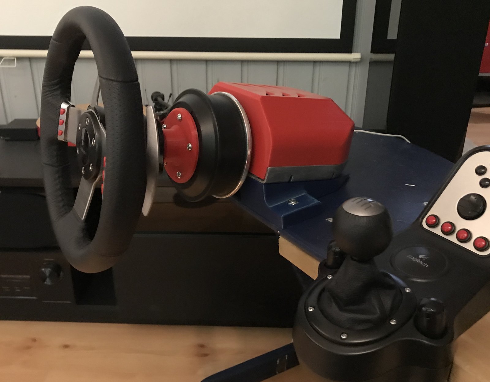

  9. Chris_Beeves
    May 31, 2019
    378
    2,184Coins
    +259 / 4 / -0
    I'm not sure it fits all kinds of hoverboards, but here is:
  10. Dinsyu1976
    Dinsyu1976 New Member
    Apr 3, 2022
    - 7Coins
    AC motor
    Ah I guess that's the case. I measured the screw holes and they're about 3mm off. However the dimensions will still help regardless. I do like this case you made and I thank you for sharing it. Thank you!

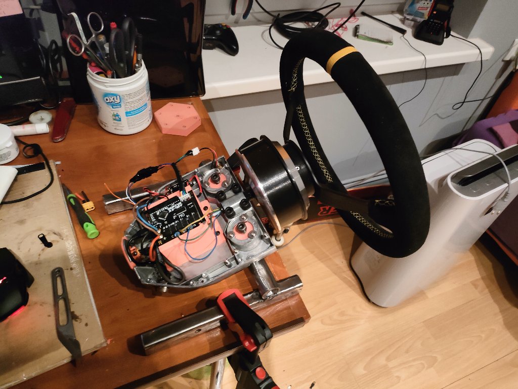

  20. ZaQ_1
    ZaQ_1 New Member
    Jan 22, 2021
    6
    51Coins
    So I have semi-finished wheel. I uploaded Roman's firmware to odrive. Wheel seems to work, its showing up in game controllers and position changes when Im turning rim. I used 2500ppr encoder and I drive it directly instead of belt and gears.
    I assume that now I should apply for a key to the full version to make the final settings?
    Also how big heatsink should I mount on Odrive transistors?
