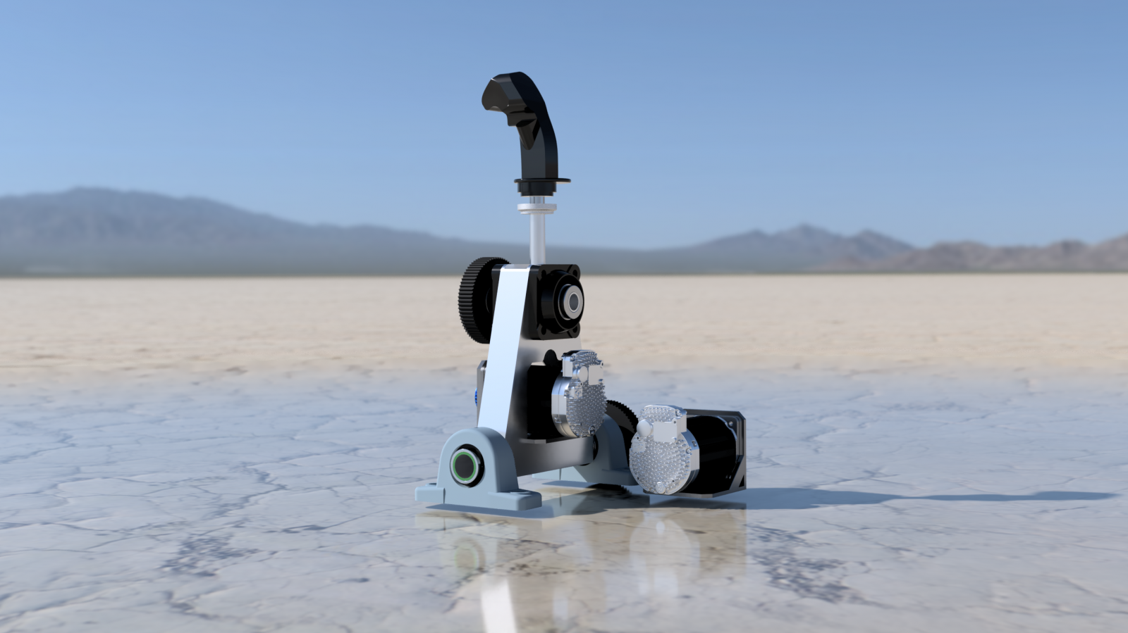

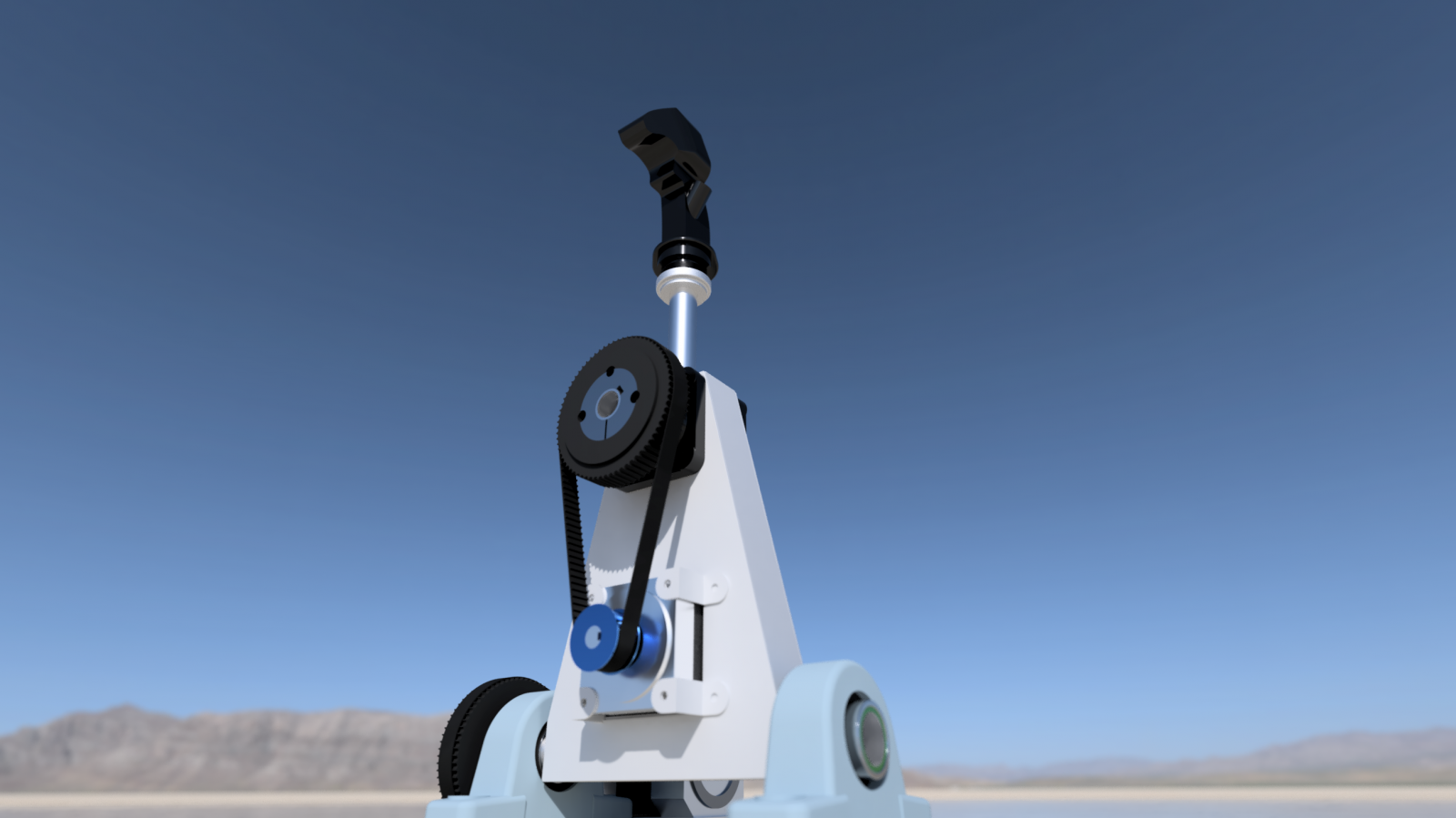

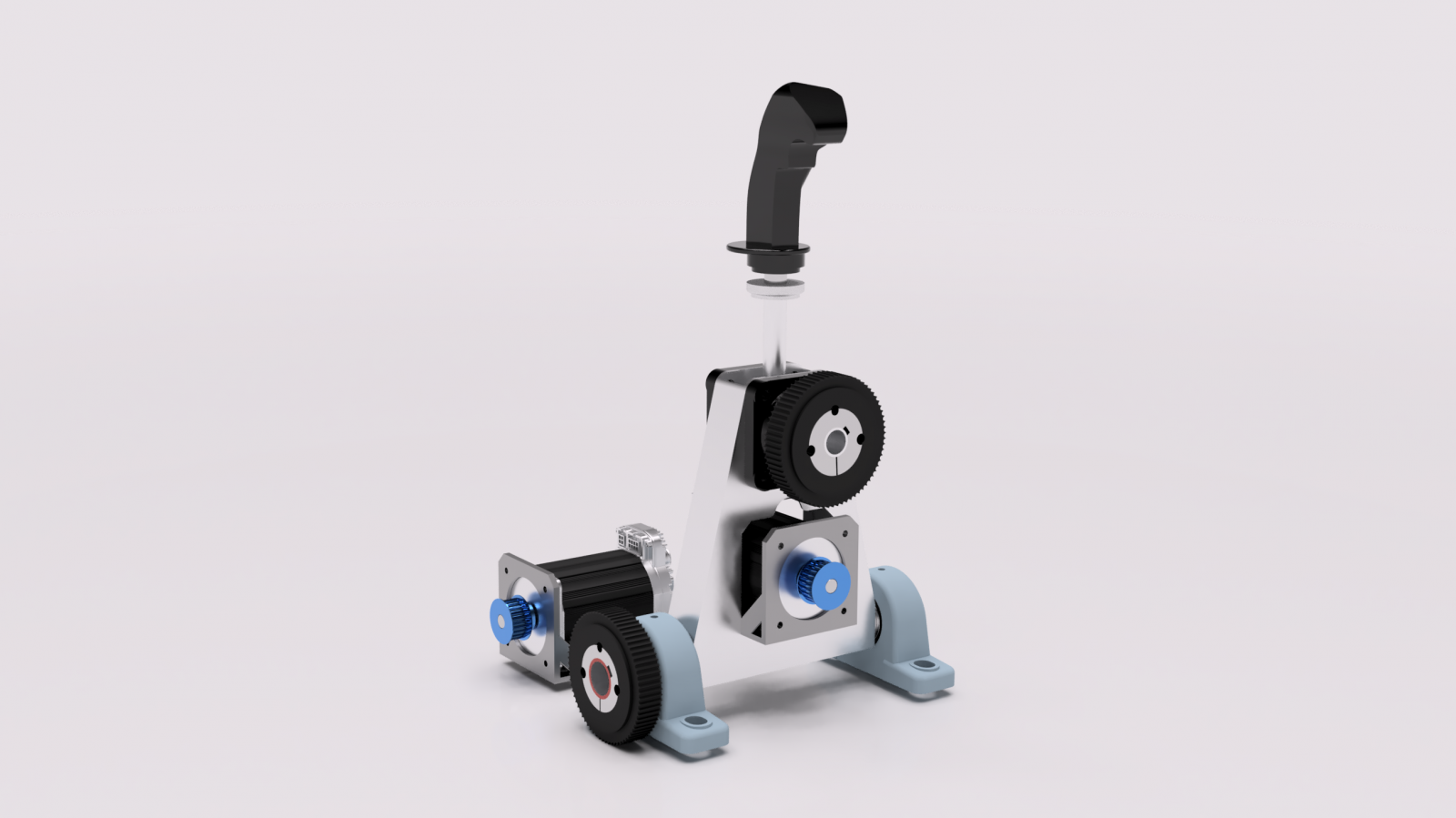

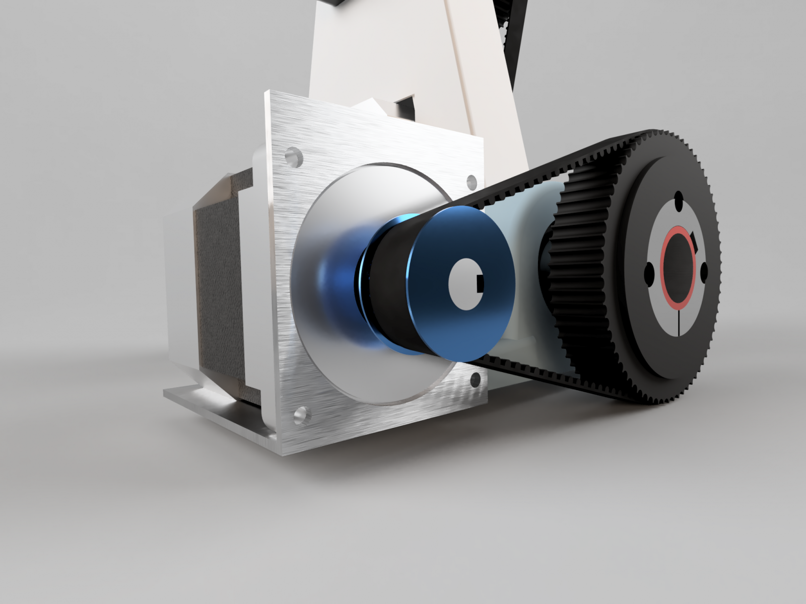

    When I designed this, I planned on using Clearpath Integrated Servo Systems (MCVC-Series). You can set them into "follow digital torque command" Mode. So the internal control loop (closed loop, I think) takes care of maintaining torque for you. You just tell it what torque to produce and it will apply THAT torque to the shaft. Great motors, but not cheap.
