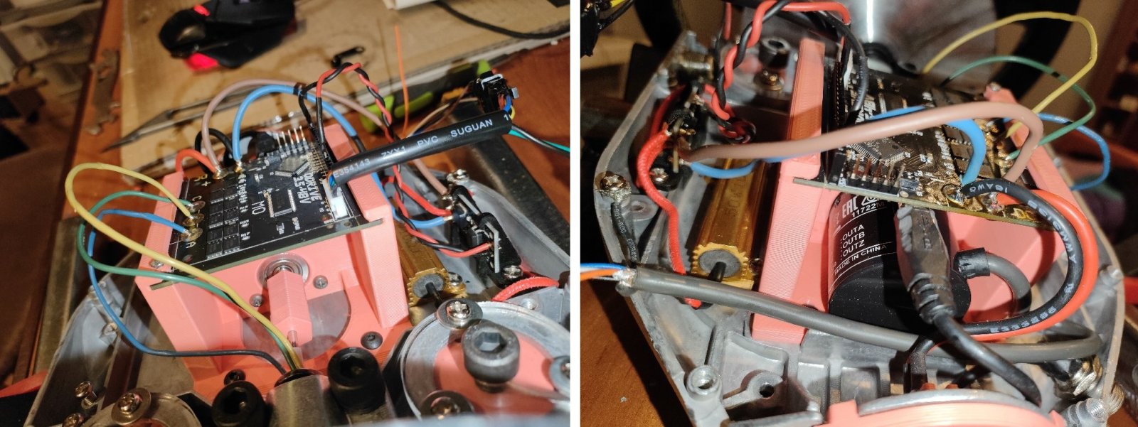

    Cool!! may i ask where you placed the encoder?

    Encoder is mounted under the board. I drilled motor shaft and added 3mm rod. Rod is riding in teflon tubing to prevent rubbing on wires. One end of the rod is fixed to motor outer shell, other end is connected to encoder.

    Oh thanks what is that little breakout board between the Odrive and braking resistor? I assume the 6 pin connector is for his Thrustmaster steering wheel and pedals?
  8. ZaQ_1
    ZaQ_1 New Member
    Jan 22, 2021
    6
    51Coins
    Its Mosfet board that control power delivered to breaking resistor. It cost ~3$ with shipping

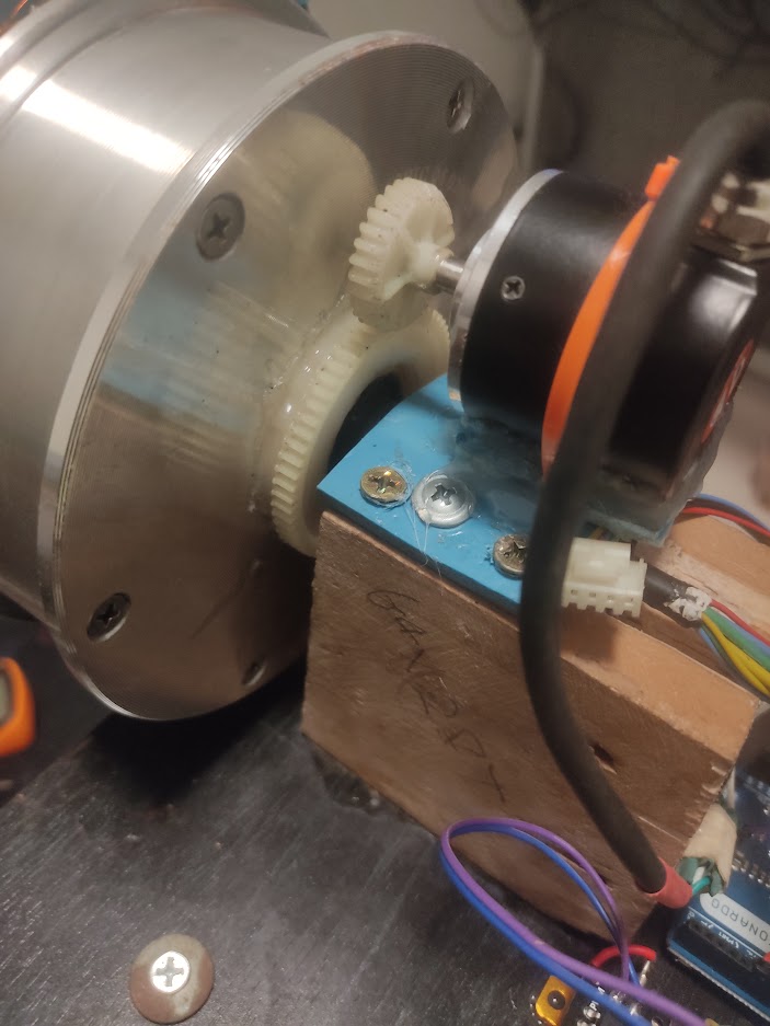

    I got myself some hoverboards but I'm struggling with where to place the rotary encoder. I saw a picture from Roman Smoliakov using an AS5048A or AS5047D but it is not in the supported list on Github.[​IMG]
  19. felixnelsonsr
    felixnelsonsr New Member
    Jul 21, 2022
    13
    73Coins
    Well it's kinda depend on how much you care about aesthetic for me i dont really care so I just hot glue the encoder on the motor mount It's look crappy i know But hey it's work and that's the point right? LOL
  20. Moti
    Moti New Member
    Oct 28, 2022
    14
    84Coins
    Yeah I do kinda care about the looks but I think I found a solution just using some pulleys and a belt. I ordered the parts just need to wait for them to arrive.
