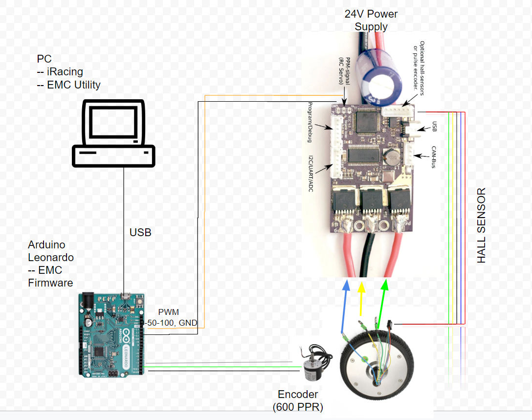

    Hi, I would like to know if I still have the project in hand, since I am building one, but I have an STM32 f401c but they tell me that I need a can bus and I see that you are not using a can bus, so I would like to know if I can do it with what I have make the vesc mini 4.12 work .. I hope you help me.

    I got the VESC to work with EMC software configured to output the PWM signal matching what a hobby type servo motor expects. You will need some firmware like EMC to run on your STM32 f401c. I would contact EMC Developer https://www.facebook.com/EMCDeveloper/
    Good luck

    I have everything, before I used my f401 with a bts7960 and the EMC utility, but I don't know how to make my DD-HB work with the vesc Mini in conjunction with the stm32f401. Could it be that you share your finding of how you manage to make it work? I would be very grateful.

    The PWM signal that controls the bts7960 is different than the PWM signal the VESC requires.
    VESC needs a PWM signal that replicates the pulse width and duty cycle that drives a "hobby style" servo. Very convenient if you want to control your VESC with a hobby style remote control. Good explination on wikipedia
    https://en.wikipedia.org/wiki/Servo_control.
    EMC, running on the f401 outputs an "Industrial" PWM signal on a different frequency/ duty cycle either over two signal lines. (One forward and one reverse), or one signal line with a second signal indicating forward or reverse. You can change frequencies and signal type in EMC configuration, but no combination will match the hobby style servo PWM signal.
    However, it is a very easy change for the EMC developer to add the hobby style servo PWM signal as an option. He did it for me on a trial basis on his Arduino firmware. I have no idea if he can add it to the F401 firmware. You should contact him directly.
    If not, your choices are limited:
    A) You would have to find a BLDC motor controller that accepts an industrial PWM signal. These can be expensive and not well suited to controlling hub motors.
    B) You could build a PWM converter. It should be pretty easy to program an Arduino to input an industrial PWM signal, and output a corresponding "hobby" style signal. I am sure there are existing libraries to help. Should be fast enough to not effect the FFB effects.
    C) Purchase an ODrive, or ODESC motor controller and use firmware from Roman Smoliakov See post #562 on this thread. I find this the most reliable, and best FFB response of any solution i have tried using a HB wheel.
    That is all the help I can provide. Good Luck!

    really thank you very much, it has given me a lot of knowledge, I learned some important things, god bless your wisdom and I really appreciate your support, but I contacted EMC, he recommends me to use the F407vet6 and provided all the diagram, I have already bought it and I hope Upon arrival, I have also acquired an Odrive 3.5-48v to have more options, I will be trying both options and I will follow the thread you have told me about.
