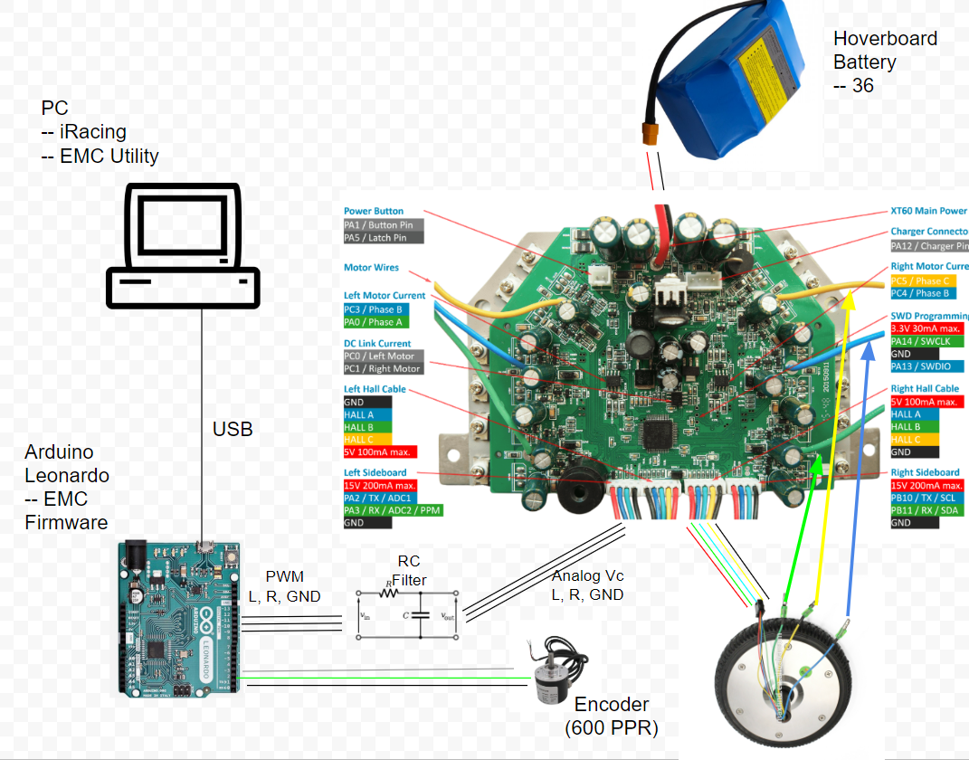

    just a quick question, i bought a used hoverboard that came with 2 motors and one motor controller, i've seen some videos of people flashing it with stlink v2 and installing new firmware like (hoverboard firmware hack FOC which has a torque mode)
    Im planning in doing that and then control it with a arduino leonardo. Is it even viable?

    Hi
    I struggled with the hoverboard main board, I did manage to get the FOC firmware to flash onto the board, however I didn't get it to work. I chose to use the Chinese clone O drive instead which is literally plug and play compared to the hoverboard main board. I would suggest you follow this route as it is so much easier and cost effective in the long run

    The processor on the hoverboard is the same brand but not the same model. The hoverboard one is a Stm32f1 series and the odrive f4 series, so much more power.
    Here you can find info on the hoverboard hack:
    https://github.com/EFeru/hoverboard-firmware-hack-FOC
    I'm not sure it has been completely written off as an alternative, let us know if you get results!

    welp, i finally got my hands on my used hoverboard, it seems that its a splitboard so it will be imposible to reuse it. As i cannot get any decent BLDC Driver in my country i was thinking of using 2x IBT_2 (BTS 7960) and control it through a leonardo using pwm (around 5-8khz) what do you guys think about it

    There is firmware for the split version too right? You can’t use the ibt’s. You’ll need a proper FOC driver.

    ye i know there are a few firmware that are suitable for these boards but they dont seem to explain a lot of its possible uses or i just dont understand that much lol. Also around page 10 and forward you can see that there were people who were able to run this motor with bts7960 and a leonardo or esp32. i dont know what to do lol
    https://github.com/flo199213/Hoverboard-Firmware-Hack-Gen2
    https://github.com/RoboDurden/Split_Hoverboard_SimpleFOC
    https://github.com/RoboDurden/Hoverboard-Firmware-Hack-Gen2.x

    Probably not. The stall torque will most likely not be very good at all and you will have put a lot of work into something that simply doesn't do the jobb.
    How much is a makerbase Odrive where you are?

    Referring to the post by marccohn about the FFB wheel project using the hoverboard motor, I'm keen to understand some specifics. Can anyone provide details on the resistor and capacitor values used for the RC filter mentioned? Additionally, I'm curious about how the hoverboard firmware was configured from this repository: https://github.com/EFeru/hoverboard-firmware-hack-FOC.
    Any insights or guidance would be greatly appreciated.
