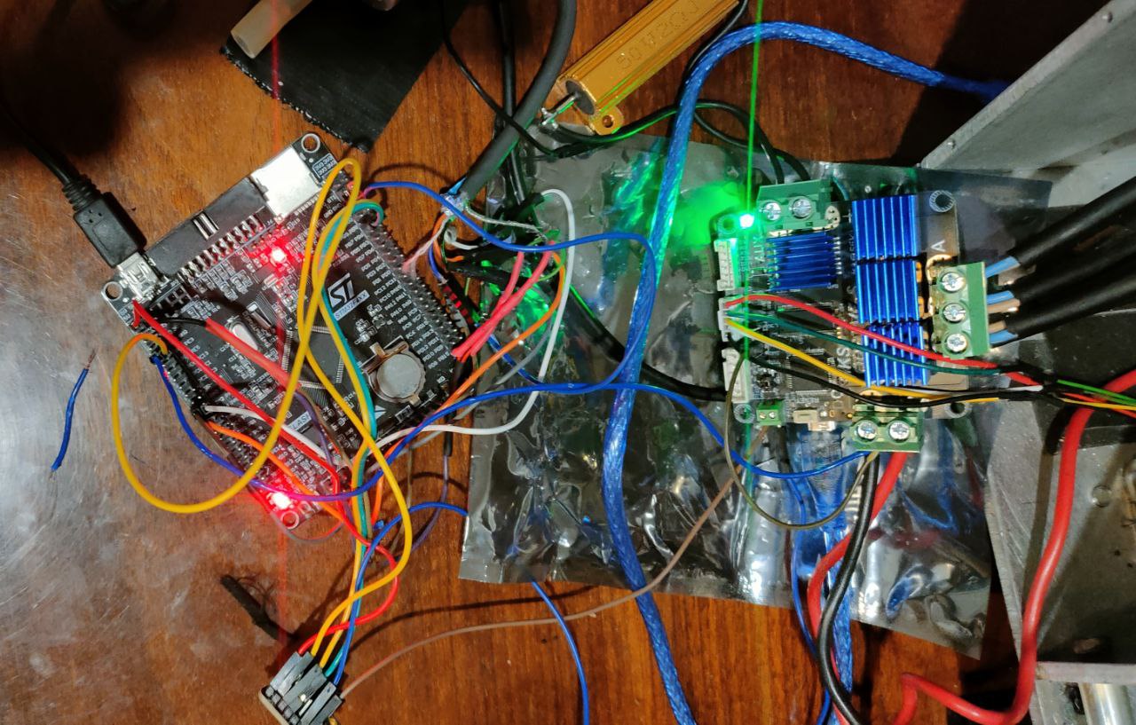

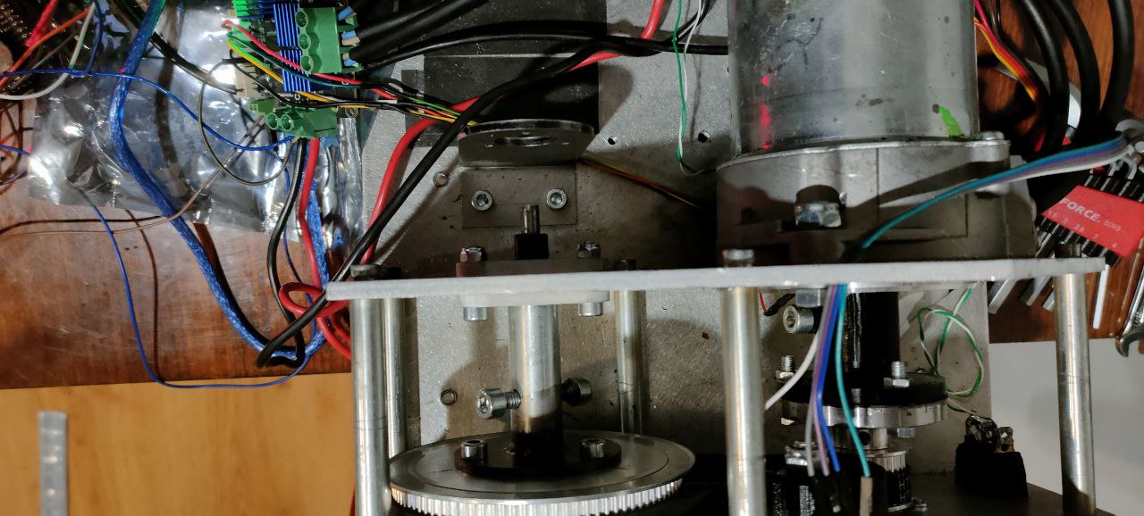

    Hello. I have encountered some problems, and I don't understand how to find a solution. I have an STM32F4, and I used it to control a steering wheel with a regular motor from a car electric fan. Now I bought an ODrive-S MKS and I'm trying to run a BLDC motor (a motor from a power steering unit). This motor had a resolver as an encoder. An inverter for the resolver is too expensive, so I made a DIY encoder using Hall sensors. I calibrated the sensors using an Arduino-based oscilloscope. I think I configured the ODrive itself. All calibrations passed. The motor works, spins, and returns to its position, but I feel that the brake resistor is too weak for such a motor. In the kit, there was a 50W 2-ohm resistor. Now I'm trying to run EMC and ODrive together via the CAN bus. I can't get anything to work ((( I grounded it correctly (STM ground, TJA1051, ODrive, PSU are all connected together). The resistance between H and L = 60 ohms. But when I run the EMC program and set CAN-Odrive, can speed, and other parameters, nothing happens. FFB doesn't work. The project uses a 1:3 belt transmission. The steering wheel encoder is separate on the steering axis. The PSU is 12V 120A. It seems like there is no communication on the CAN bus, and I can't figure out what I did wrong ((((.
