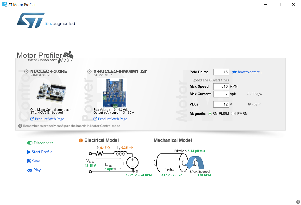

    Yes, I ran the motor profiler a couple of times on the hoverboard motor. Some parameters were quite stable (Rs, Ls, Max.Application Speed) between runs, others had some variance (B-Emf constant, Inertia, Friction).
    The parameters Pole Pairs, Nominal Current and Nominal DC-Voltage were provided by me.
    I changed Nominal Current to such a high value to get some headroom before over current protection kicks in. This is definitely not a value you should run the motor at.
    These are the parameters I am using right now:
    Oskar at the oDrive community made a tear down of a hoverboard motor. He measured the parameters with some proper tools. His results were not too far off the parameters above. You find his tear down here.
    You can order the IHM08M1 directly from ST. They sell their evaluation boards on their web site. According to their site the board is still Active ("Product is in volume production"). But I have no idea what they charge for shipping. I got mine from Mouser about a year ago.
