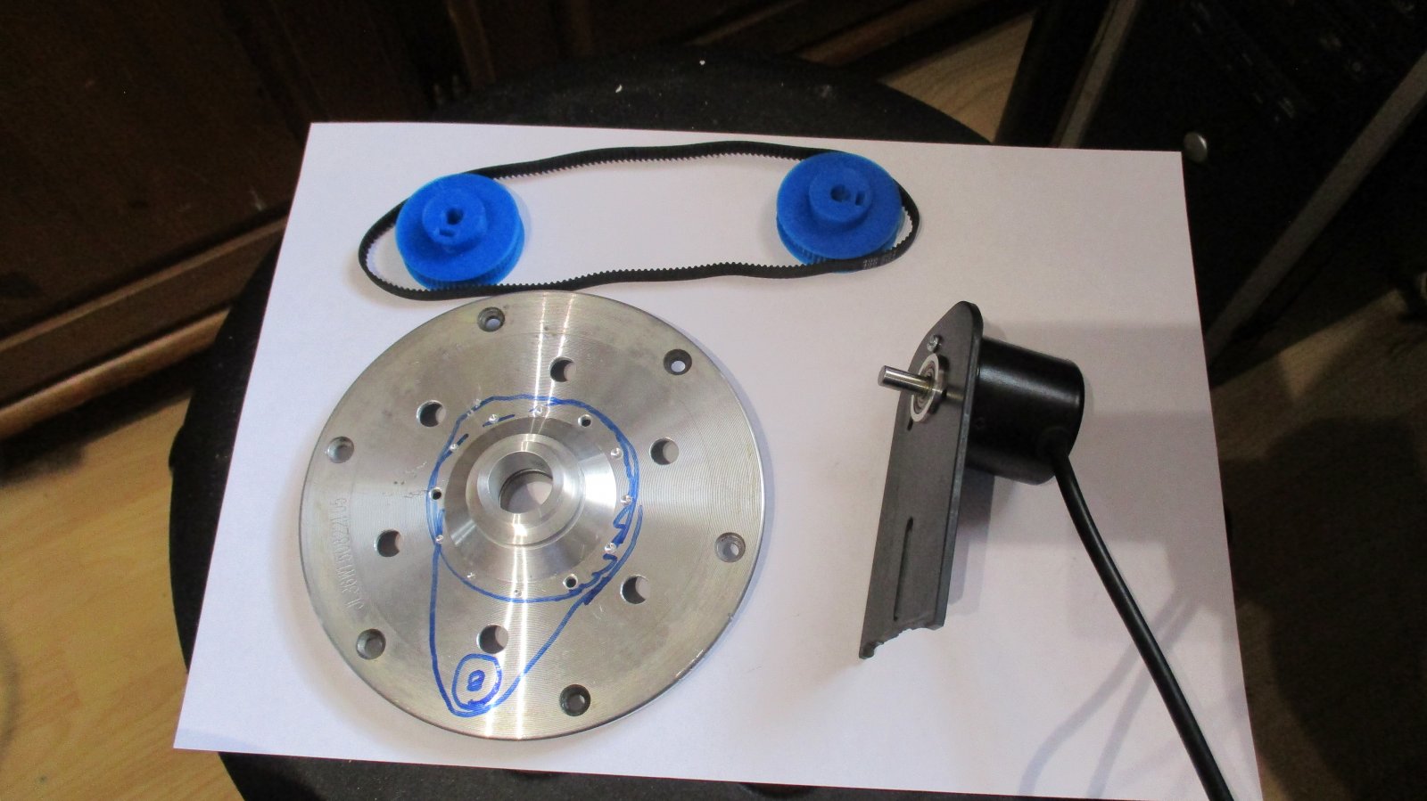

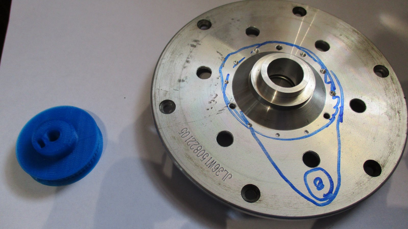

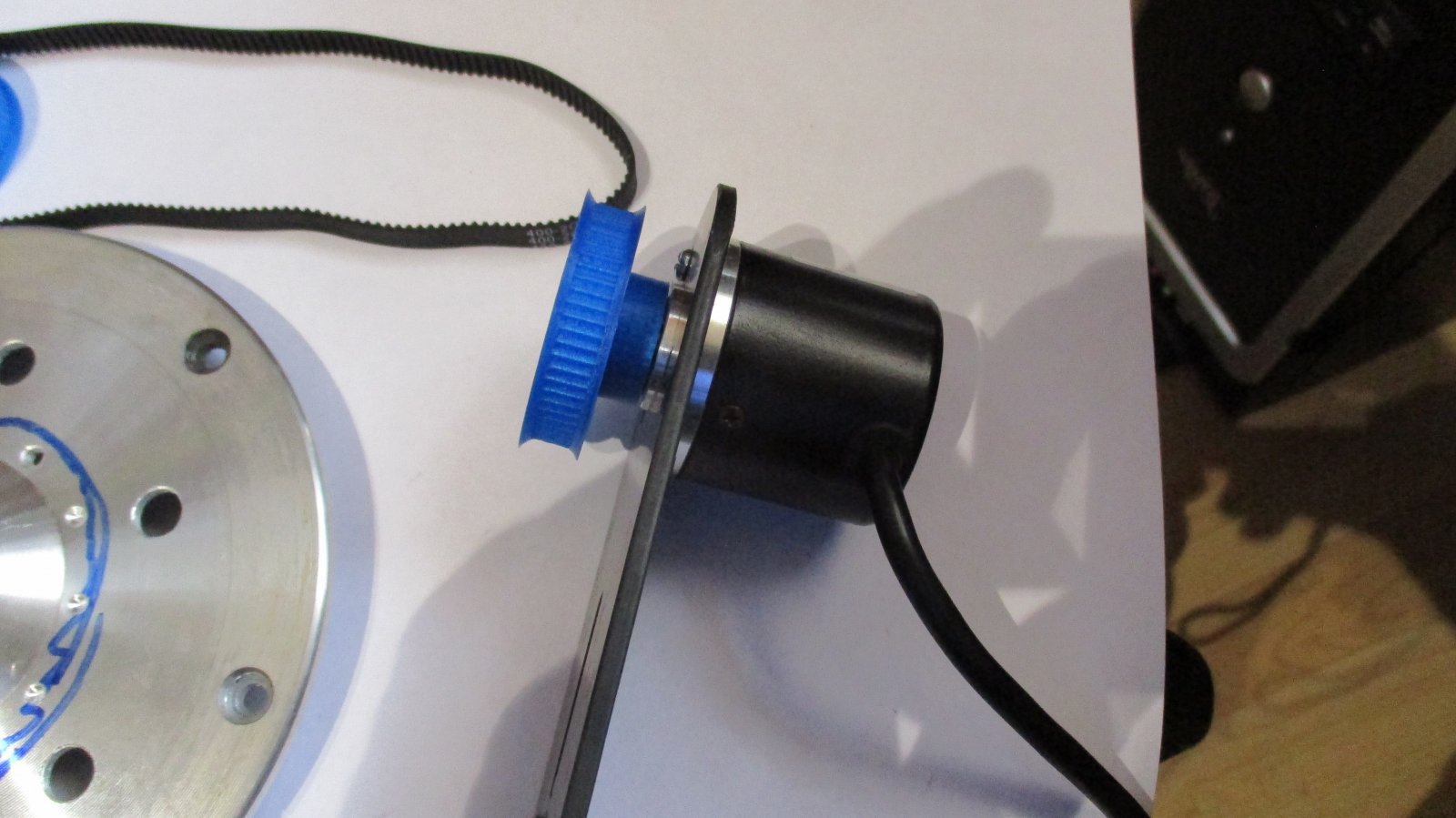

    Hi Guys just a mad idea regarding Encoder feedback position when using Hoverboard motors , Im collecting all the parts to copy this project and just made a quick mock up assembly of the encoder feedback setup , have a look see please guys and critique the arrangement .
    The plan is to use My 3d Printer to make a Gt2 60t Pulley which will be Bonded to the Hub Motor as shown and this ten belt drive the encoder Pulley roughly as shown in the mock up .
    Im thinking this arrangement will allow different types of encoders to be fitted and leaves the front of the Clear for any Quick release adapters ..
    Once I finish printing the Drive Pulley it can be bonded on or screw fitted for easier replacement , well that's the plan LOL . i'll start my own thread with loads of picture if it will help anyone else or trigger the next improvement to the use of Hoverboard Motors ..

    That should work. Although there might be some loss in accuracy due to the belt. On the other hand you will gain resolution with different sized pulleys.
    Maybe you could use something like the "starfish pulley" in this thread. It would help others rebuilding your design. Not everybody will be keen on drilling additional holes in the motor.
    You also might check if the load on the encoder shaft isn't too high. You don't want to wear out the bearing. Maybe support the encoder shaft on the other side of the pulley.

    Hi @Benu that a brilliant find , my fave saying that theres many ways to skin a proverbial cat rings true. i like this option , to be honest i tend to use equipment i have available so lathes and cnc machines are my work tools , but the goal of making something easily repeated by others is the Target.
    the encoder shaft in my design does not take any load as this is done bt a dummy shaft resting between 2 bearings and the encoder is connected by a flexi coupler . left the cad drawings on my PC at work so will post them next time :)
    now got all the electrical/mechanical bits barring a decent BLDC controller to drive the Hoverboard motor, as the 11m08mi's are proving hard to come by . but this starfish option can easily updated to get me a working development unit , Thanks again for the heads up will get it designed tomorrow and post an similar adapted version based on that design .. Cheers
    doh forgot to ask .. how much of a hit would it be resolution wise using GT2 belt drive and 1:1 ratio .. 3d Printing will allow me to try this test quickly but did not think of the impact of the belt as i could tension it to get best setting before locking things in place ( that was the initial Plan anyways using aluminium gears 60t )
