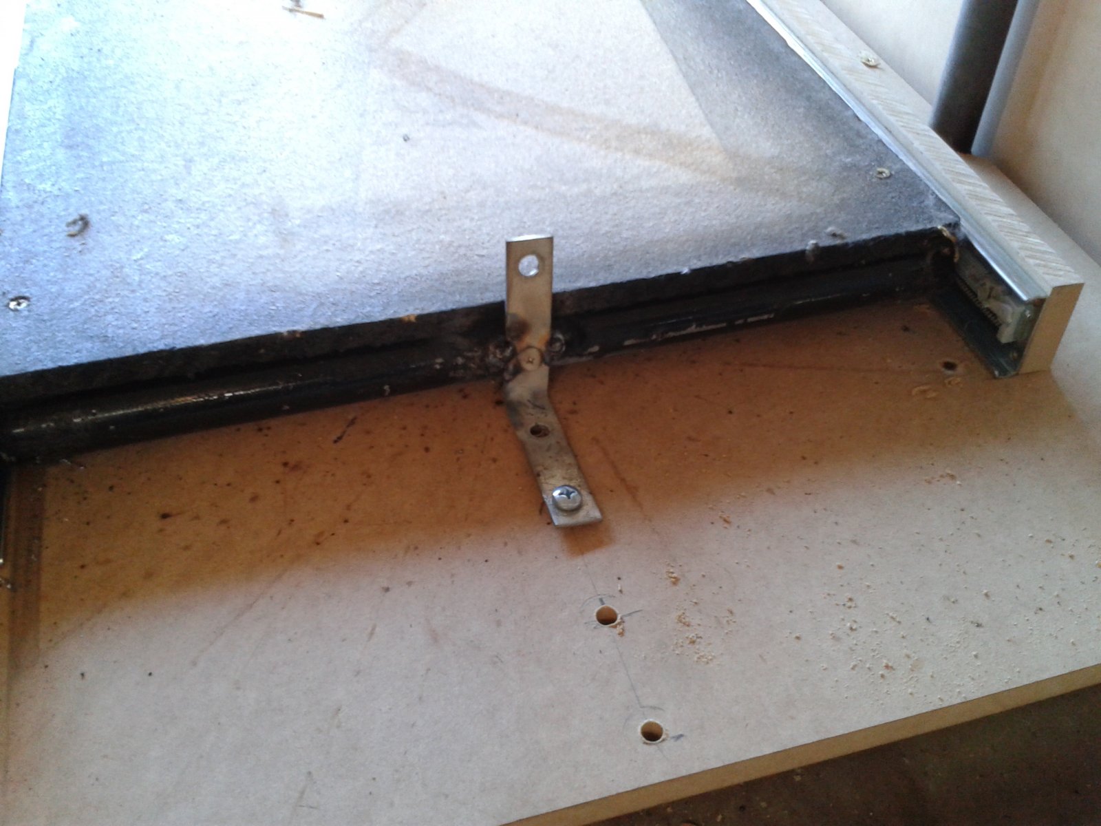

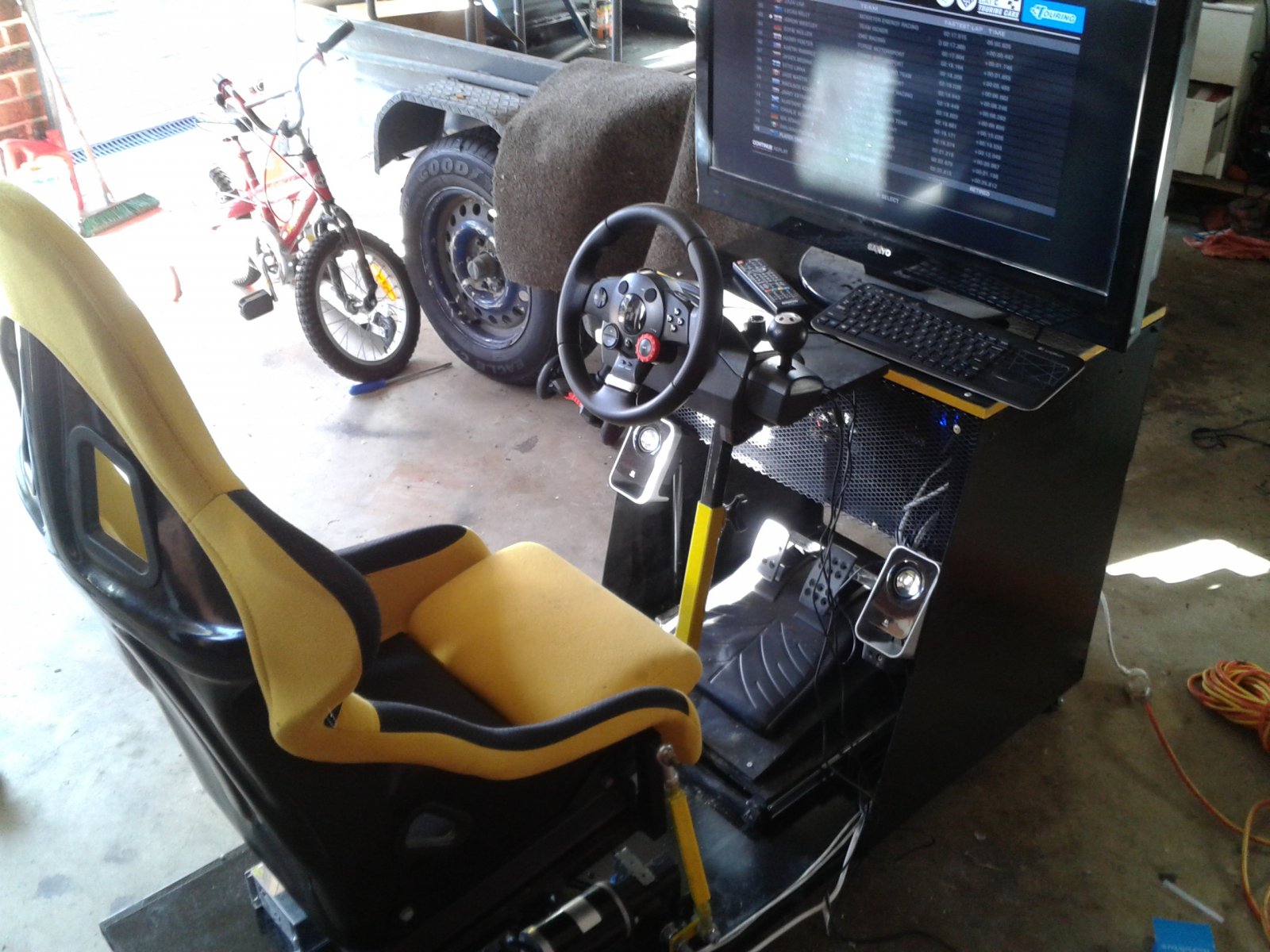

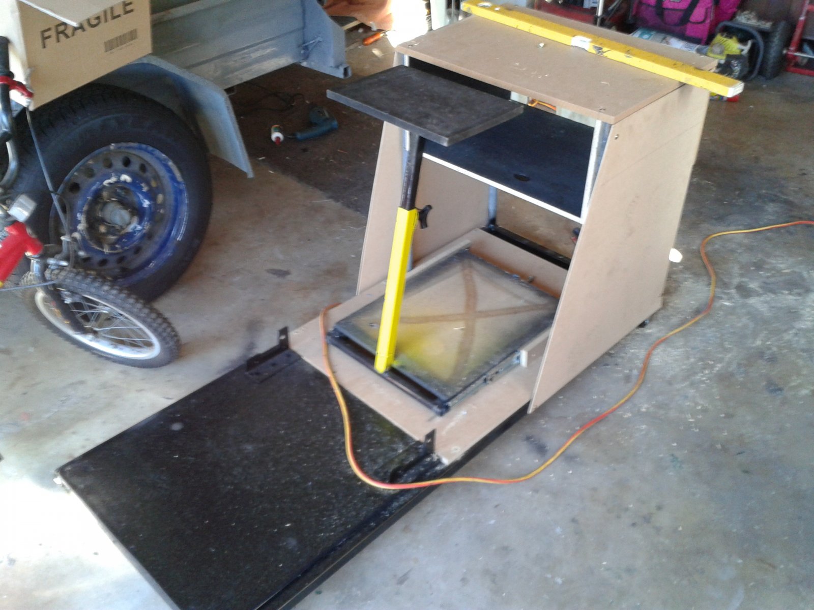

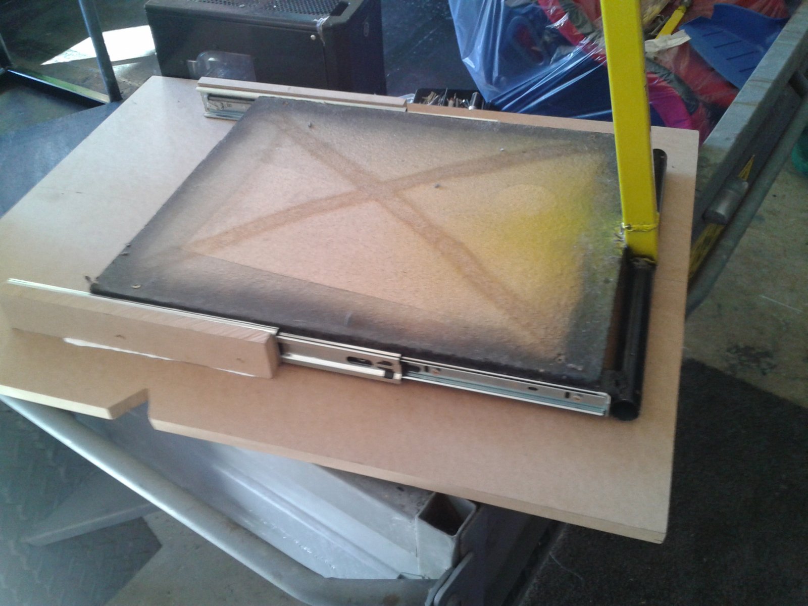

    Moving wheel and pedals back towards driver , especially if they are lighter doesnt affect a full frame 2DOF balance much. I know this from my foot motor mount sim. Even though the pedals simply were dragged back towards the shorter driver.
    As suggested by @eaorobbie , I did that with 2 of my current sims, they adjust from driver 1.9m to driver 1.4 m. A wheel stand with a set of draw rails.
    Wheel mount is height adjustable
    I move the bolt hole alignment to the shorter driver. Simple, but it works.

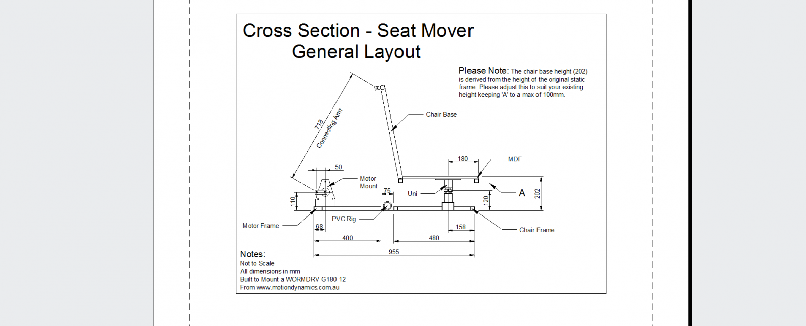

    Not to flood your post, this is my example and you can see the base of the chair is only 202mm (8") off the ground. Now that can be raised , noted on the drawing as long as you keep 'A' (distance from the centre of the uni to the base of the chair) under 100mm , closer to the base of the chair the better. What happens as you increase 'A' it exponentially increases the mass once in motion. So to help the DC motors achieve their fastest speeds for real good road vibrations and ultra quick changes of direction keep the centre of the uni as close to the base of the chair, meaning if your height to the chair base is 19" make sure the uni's centre is no further than 100mm (4") away from the chair base. And I can not see an issue.
    Plus it needs to be under the cg of the whole mass not the actual measured centre, so that the weight is spread evenly over the pivot.
    Hope that helps.

    @eaorobbie - Your drawing is one of the items I have been referring to. So, as long as "A" stays under 100mm, the only change would be the needed length of the rods connecting the seat back and levers. As long as they are beefy enough, the length is not a concern?

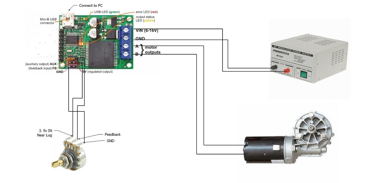

    1. Make sure there is no body ground within the wipers or big worm gears, sorry forgot which you are using.
    2. Wire the power correctly on the Jrk , A big must (about the only way to smoke one)
    Vin is +ve 12v GND is the earth, Motor can be wired either way on A & B you can always invert the signal
    In the jrks configure if need to reverse the direction on the motor.
    3. Wire the pot correctly , Jrk 5v to positive side of pot, Jrk GND to negative side of pot, Jrk FB to the wiper
    on the pot (in most cases the middle pin.
    Setup the motors in the Jrk Config Utility first then they will be ready for SimTools without giving you any problems.
    Have fun and enjoy.

    @eaorobbie - I looked on the pot data sheet and I could not see a specific + and ground assignment, but the middle pin is def. the FB.
    I thought I read on a thread that the 2 outside pins could be set up as either + or ground, as long as the FB pin is correct. Is that correct?
  11. bsft
    does this assist?

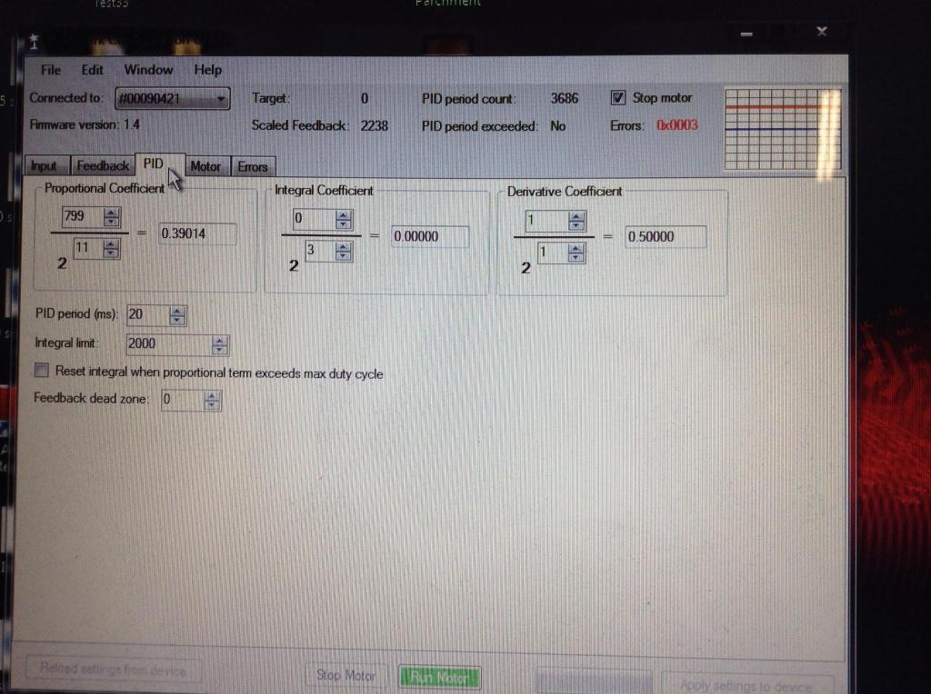

    I lost a day of progress because someone gave me a seat that was MUCH better than what I had. It was worth the extra time to get it ready to use.

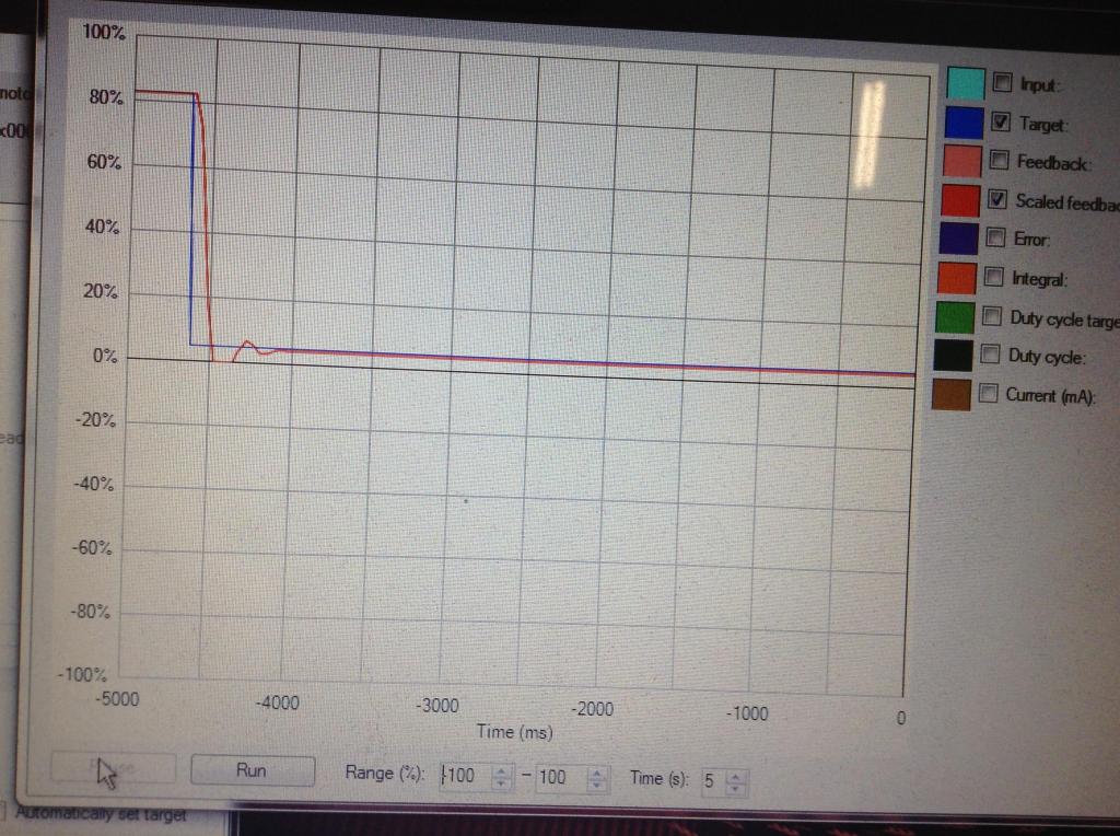

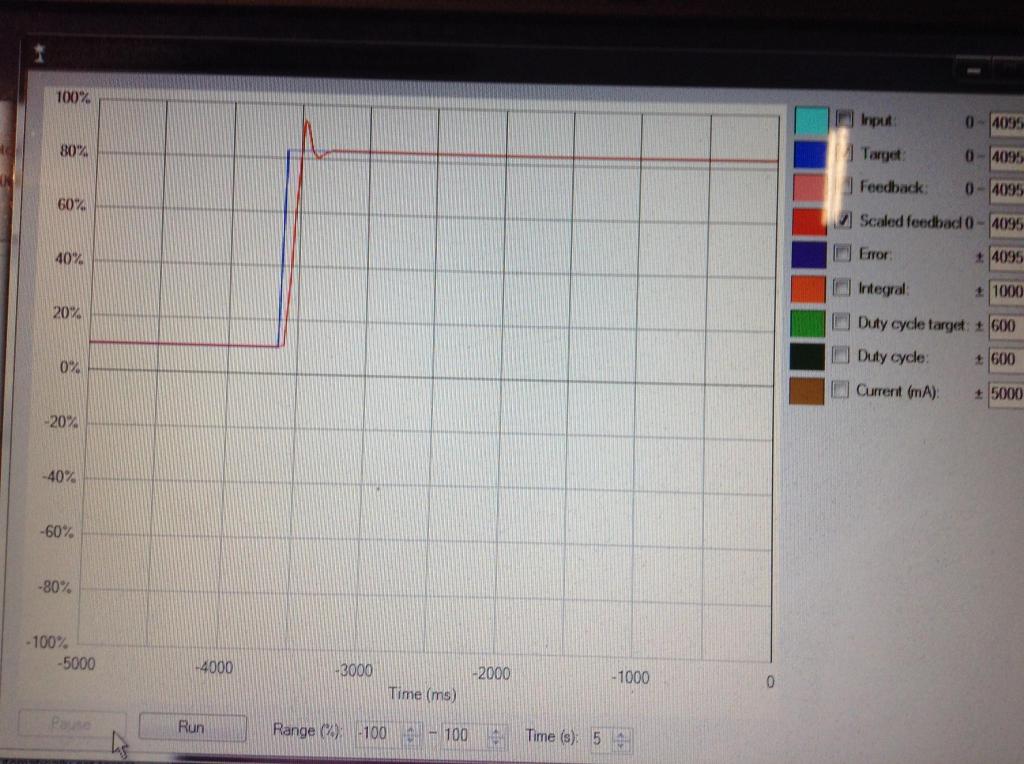

    I have set up both Jrks with the Jrk utility. I followed @eaorobbie 's instruction exactly. The first Jrk seems really good. The second Jrk seems to be overshooting the target by quite a bit, but it looks like only when it travels a large distance. I can use the slider function to move small increments either direction with no issue, but the bigger movements have the overshooting problem. But, the lever does eventually end up at the correct spot.
    My design has a hard stop on the downward travel and my current "learned" position for the minimum position is very close to the hard stop. So, any over travel causes the lever to crash into the hard stop.
    Suggestions?

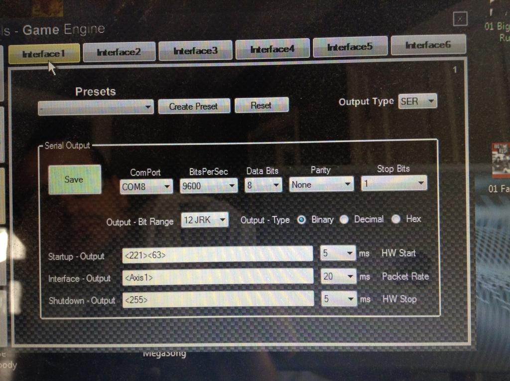

  13. bsft
    screen shots of PID and motor tab please
  14. CoachKalk
    CoachKalk Member
    Jul 29, 2014
    92
    970Coins
    +16 / 0 / -0
    @bsft - I am not sure how to do screen shots. I will try to take a pic with my iPad and see if it turns out.
    Also, if I just open both tabs and get pics will that work? Or do I need to send a certain command first for you to see what your looking for?
    Thanks for your quick response.
  15. bsft
    yep, that should do as long as I can see the tabs on the screen

    Hopefully these pic work. The tab pics are from the "left" Jrk. After I took the pics, I was planning to use the slider to reposition the lever so I could get a few plots as well. The lever went bonkers and started pounding on the hard stop. Before I could power down the motor, I managed to relieve the pot of its magic smoke. Luckily I ordered several extra.
    I then went to the "right" Jrk to have another look. The 2 plots are from the right side and show the same over shoot I had noticed on the left. I guess I didn't cycle it as much the first time so I didn't notice it.
    So, I am wondering/thinking that my settings(same for both sides) may be causing the over shoot issue AND my left pot may have been a bit whacked from the start (pounding hard over and over on hard stop/frame.

  17. bsft
    set max current at 0 , unlimited , try bringing D up from 0.5 in steps to 0.9
    Drop max accell down to 450.
    Max duty to 350
    if motors are slow, speed them up in steps on 25.
    Give that a run.
    sometimes it requires individual PID and motor settings. I found that recently with my red "desk racer" . I have to do individual settings.
  18. bsft
    @CoachKalk , you also need to test the motors under weight to see if they still overshoot.
    Even Ard sims overshoot without weight on them.
