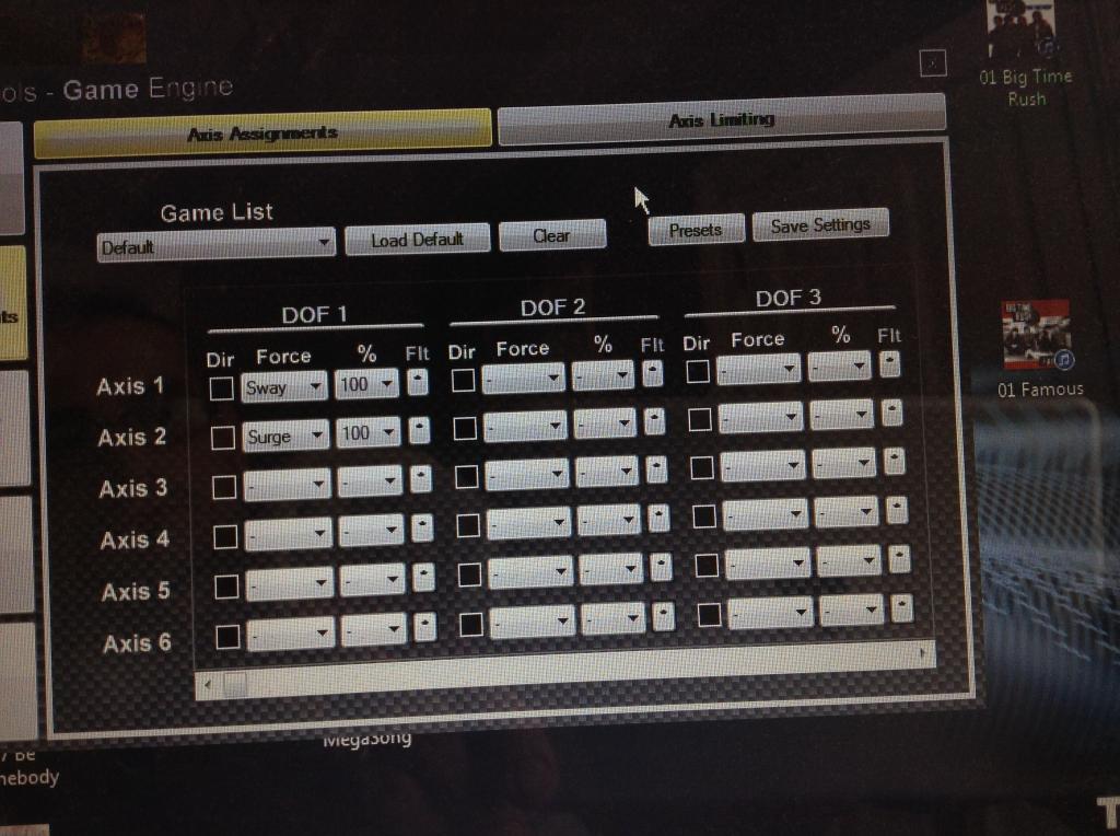

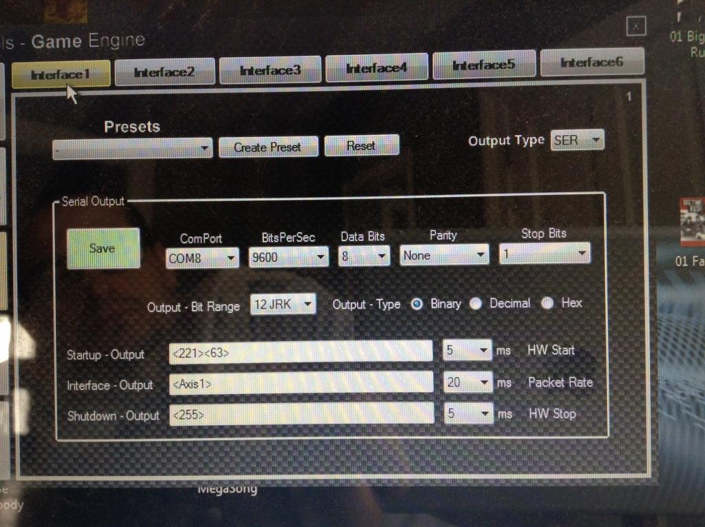

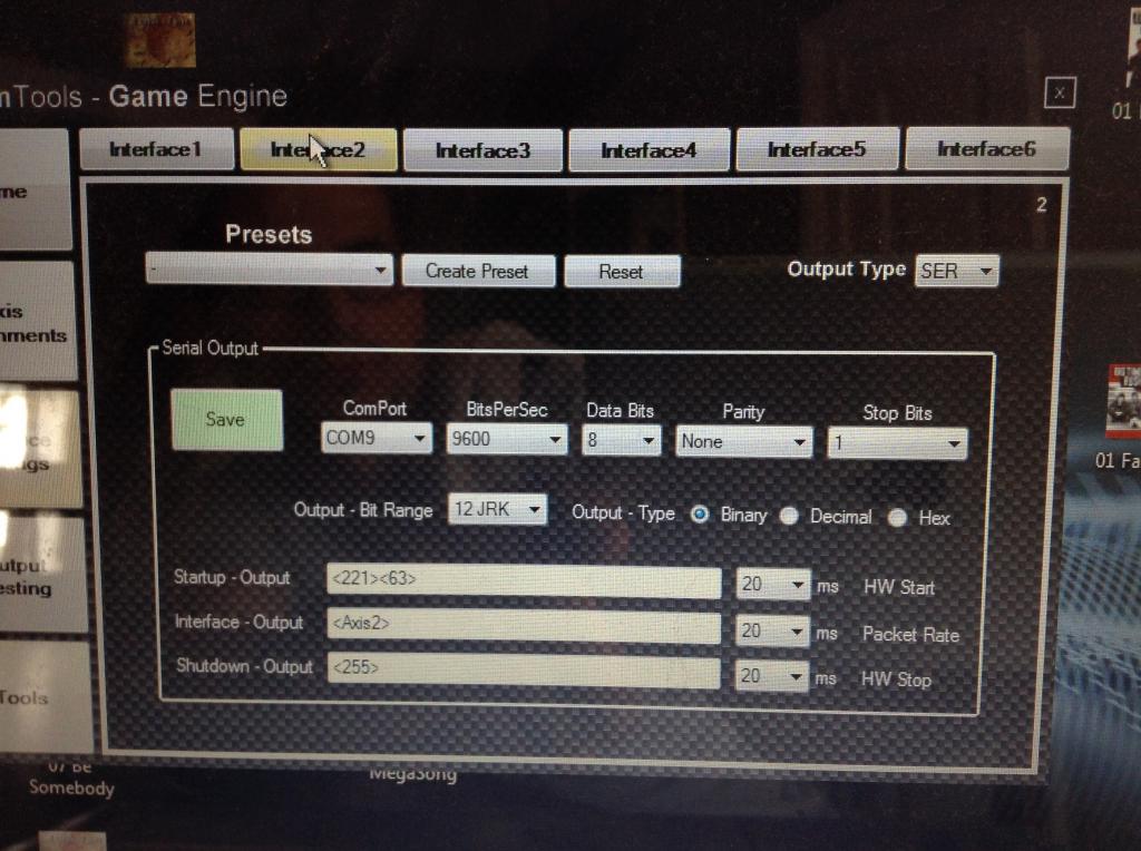

    @eaorobbie - thank you again for your help. I have attached pics of my SimTools screens. Let me know if you want to see something else.

    Ok a base Axis Assignment for 2DOF is -
    DOF1 DOF2
    Axis 1 Roll 50% Pitch 50%
    Axis 2 INV Roll 50% Pitch 50%
    This can be expanded further to include 5DOF movements, but we simulate the three forces not reproduce as we do with Roll and Pitch.
    So a 5DOF includes Roll,Pitch,Surge,Sway,Heave on Axis 1 with 20% in each actual movement then on Axis 2 is the same except you roll and sway will be inverted.
    Save that and that will be the first picture correct.
    Now Interface settings are nearly correct , think the version you are using the 12 bit preset had an error in it, anyway just change the Interface Output to <221><Axis1> on Interface 1 and <221><Axis2> to Interface 2. Also if you have set the PID period in the Jrks to 20 then all the rates need to be the same too.
    Confirm in the Windows device manager that the comports you have selected are the Command Ports of the Jrks and Save
    Now all should be good and testing via the Output Testing should be correct.

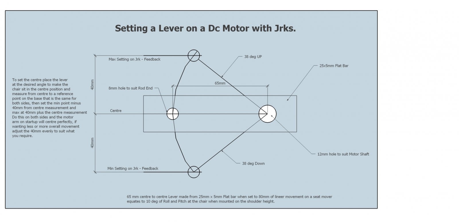

    Yes levers are too long , drill a couple of holes - 65mm and 85mm from the centre. This is heaps of movement for a seat mover. There is another little trick I do for running the rollercoaster , etc.
    Now on 65mm C/C lever I set 80mm of motion. IE 40mm above and below centre. That will be the Min and Max I set in the Jrks as per this picture.
    This will provide nice solid and sharp feel to the motion.
    Plus you have a fairly heavy seat on board.
    Now later when you want to use the roller coaster you have a different Jrk setting profile saved in the Jrk Utility that has 120mm of throw for the coaster as its moves are slower and need more angle to make the ride more fun. And you can easily upload and change them when needed.
    Once happy with the Jrk settings , I do recommend saving them to file.
