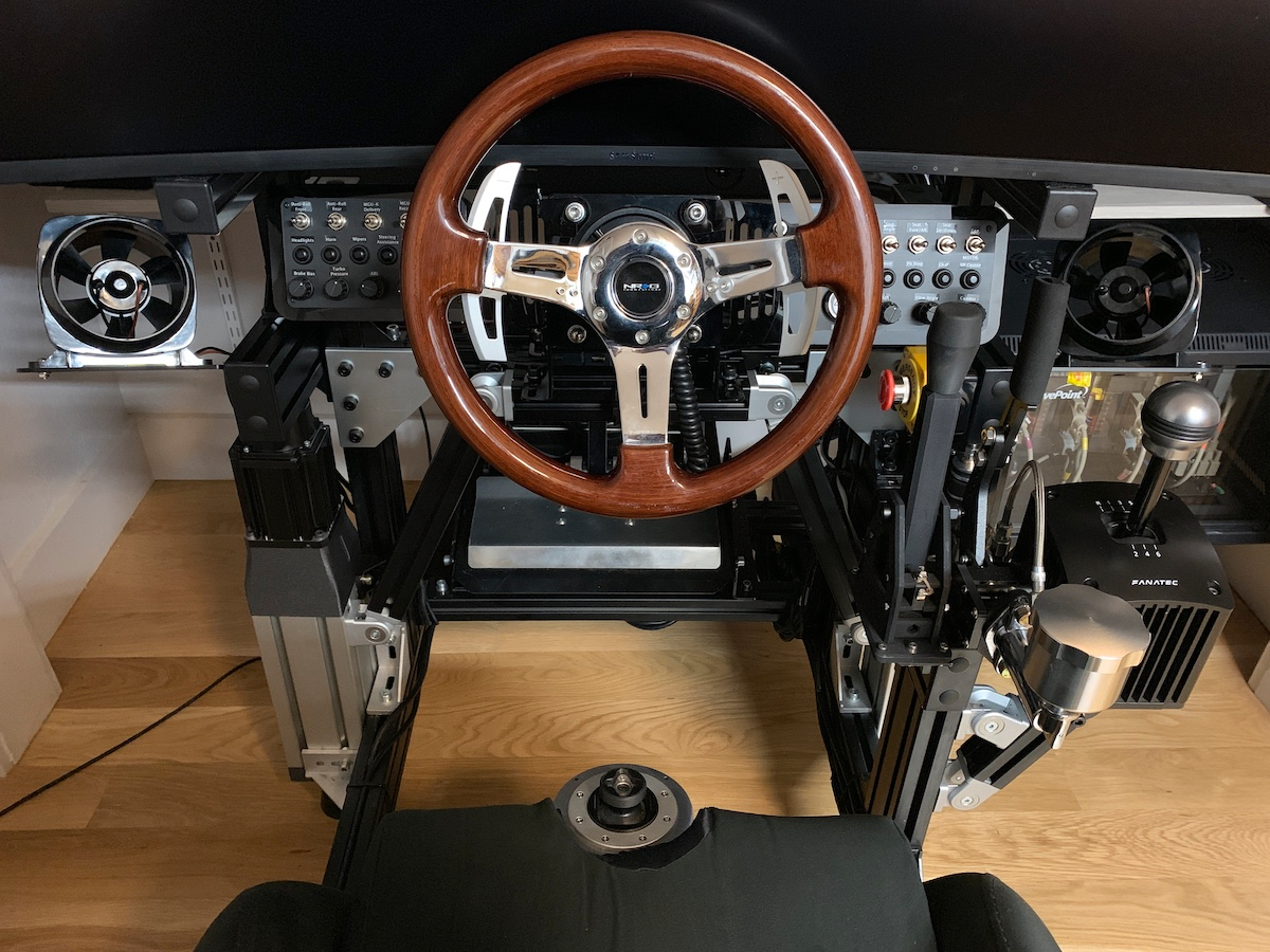

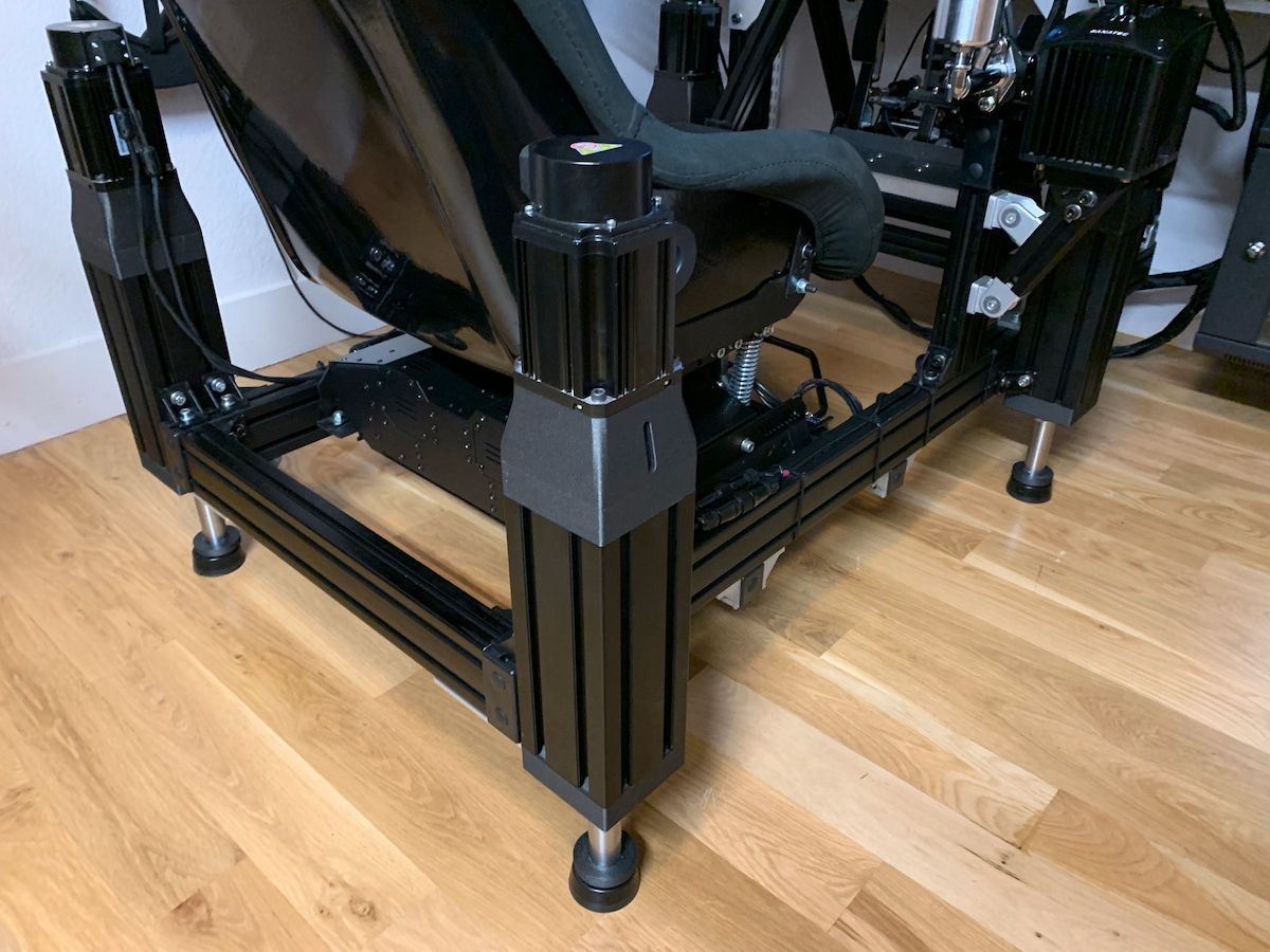

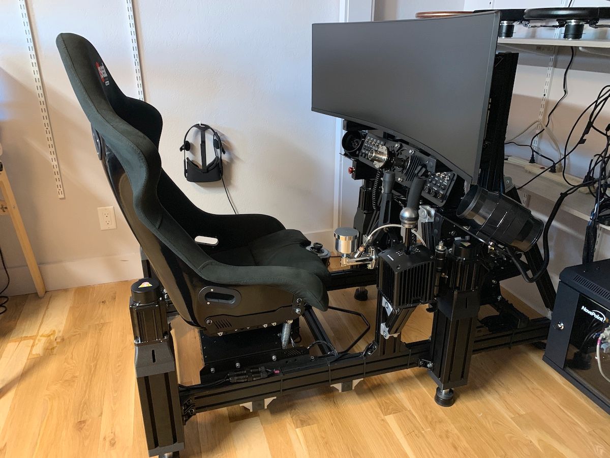

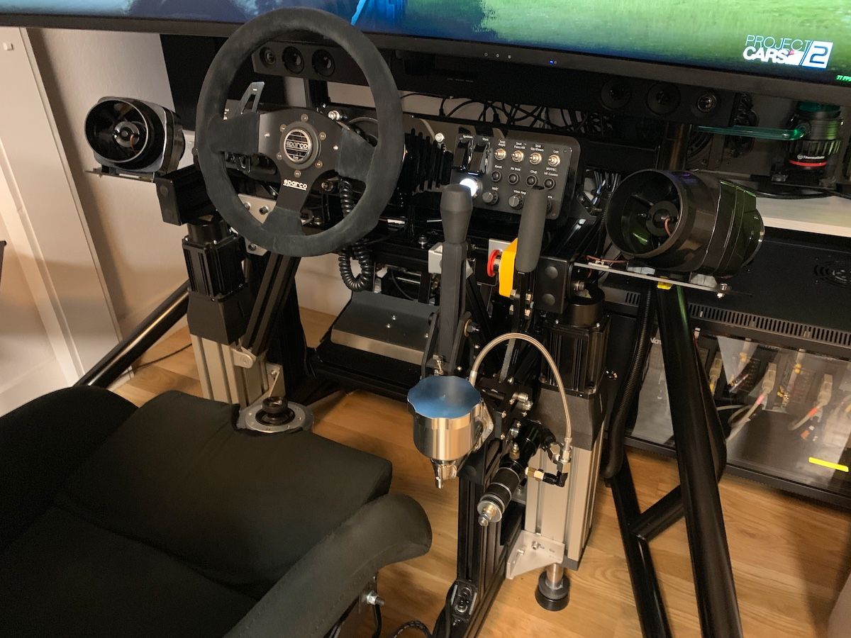

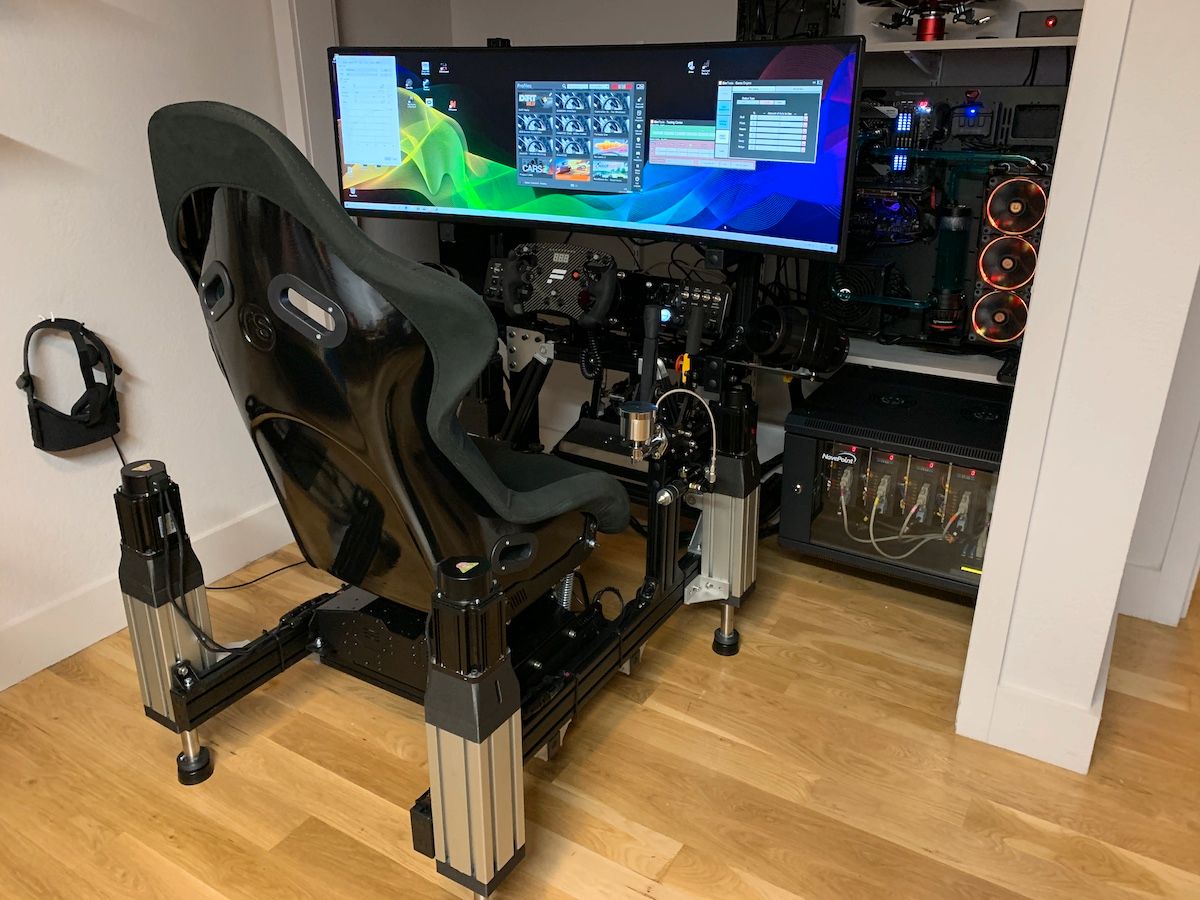

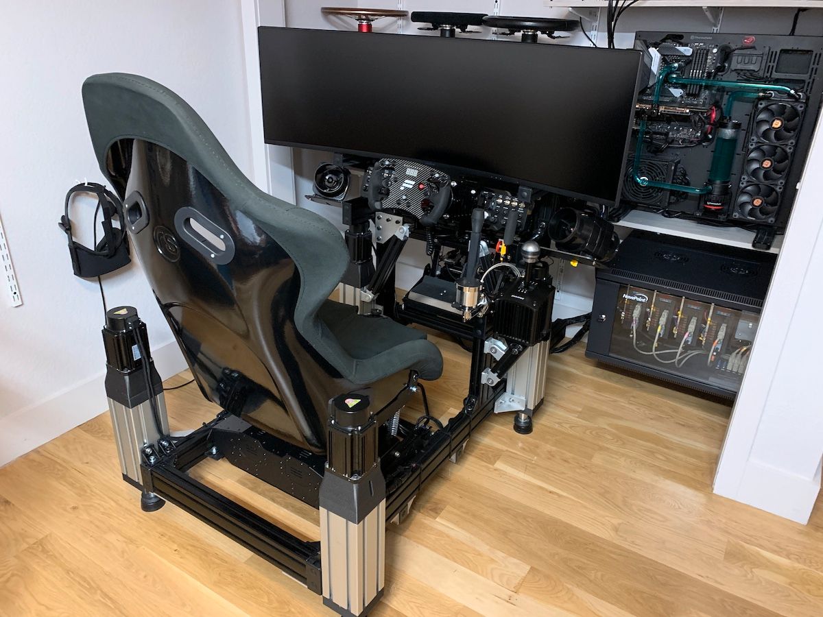

    A good 20 hours of work, and one sharp mitre saw blade, and the cockpit is complete. I've had a few hours testing out the SFX-100 system, and in a word, it's stunning! Really, really impressive system. The fine details and texture it provides are uncanny. I've run this with my NLR v3 seat mover, with the seat at *very* subdued settings for surge and sway, and this combo is just fantastic.
    There's lots to say about this system, and I'll provide more indepth comments in a few days. For now, here's a few pics. My goal in the 80:20 rig was 1) compact, 2) ultra-stiff, and 3) decent looking. I aimed to eliminate ANY flex what-so-ever in the wheel deck. Even a few of the commercial 80:20 riges I've tried had the ever-so-slightest amount of flex in their wheel decks. Not this one.
    I probably over-engineered the deck on this rig. Stiff connector plates, + dynamic joints to triangulate the deck into the frame and remove ANY flex. As hard as you can try to move the wheel, the only thing that flexes at all is the wheel rim. Far-and-away the stiffest setup I've ever personally seen. A bonus of the system (see below) is that the actuators are very closely mechanically coupled to both the pedal plate and the wheel deck. As such, you get tons of tactile and fine feedback through both your feet and the rim. Astonishing, actually. The auxillary control mount (sequential shifter + custom made hydraulic handbrake) is equally stiff, not a bit or flex of movement.
    Another element: Thano's controller has worked flawlessly. Thanos + simtools gives tons of options. I'll post my settings in a bit, but they're working very, very well. Lots of fine road detail + good overall track position data, but not overwhelming (unless you go off course or hit something, then the rig jumps pretty good).
    Had tons of fun with this project. It has gone as smooth as anything like this I've done, and considerably smoother than the DIY OSW I did 3 years ago. I can whole-heartily recommend the SFX-100 to anyone with even modest DIY skills. (BTW, I'm almost finished printing a second complete set of SFX 3D parts. Let me know if you're interested in these).
    Here's plenty of pics to show the finished rig. Enjoy.

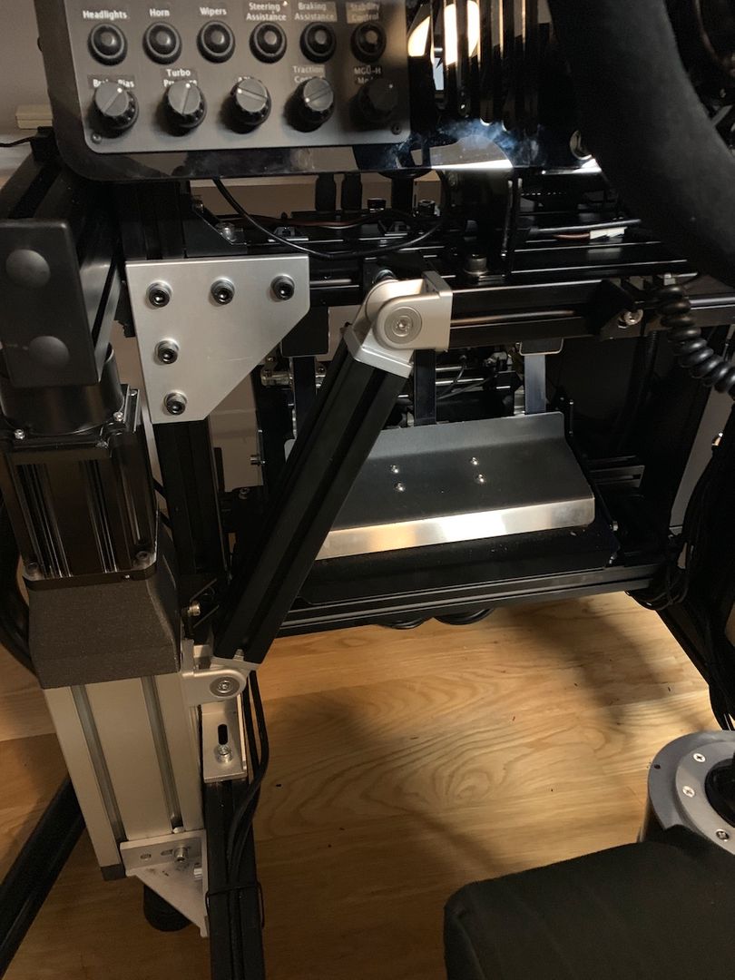

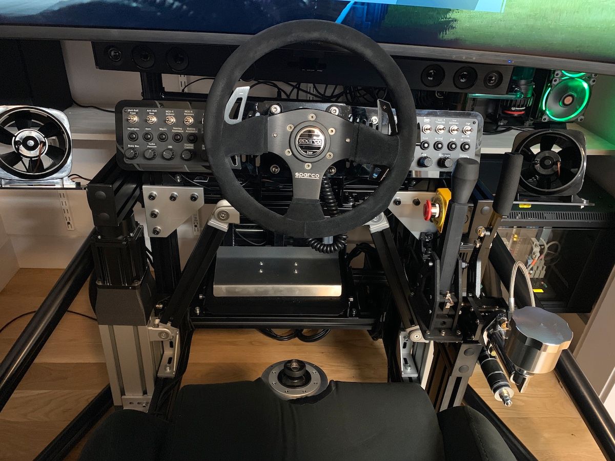

    Details of the ultra-rigid wheel deck mount:

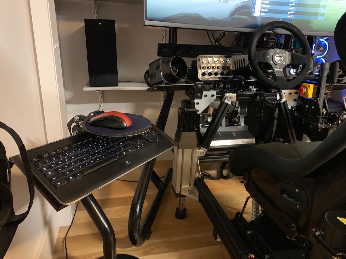

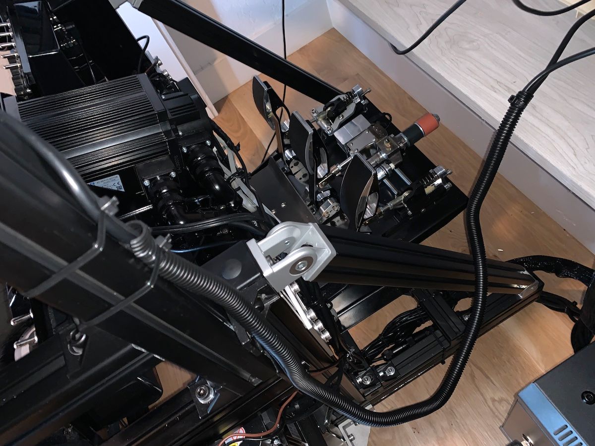

    The last bit to complete my build was the R-Seat free-standing keyboard and mouse stand. Really didn't think a keyboard tray connected to this rig was a great idea. The little stand from R-Seat is wonderful. The layout is ideal, quite compact and super easy to run the mouse. I find I put the keyboard in my lap, and use the mouse on the stand. When done, I just return the keyboard to the stand, very simple.

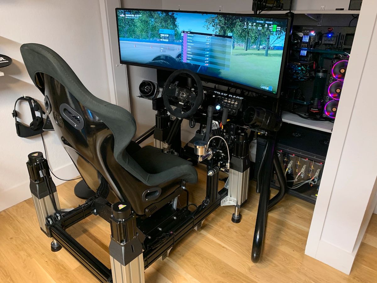

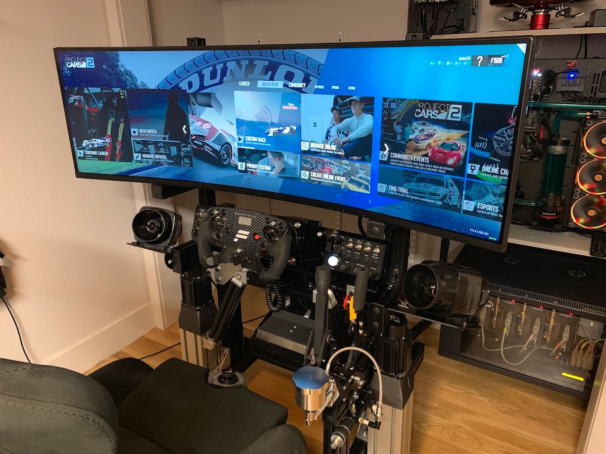

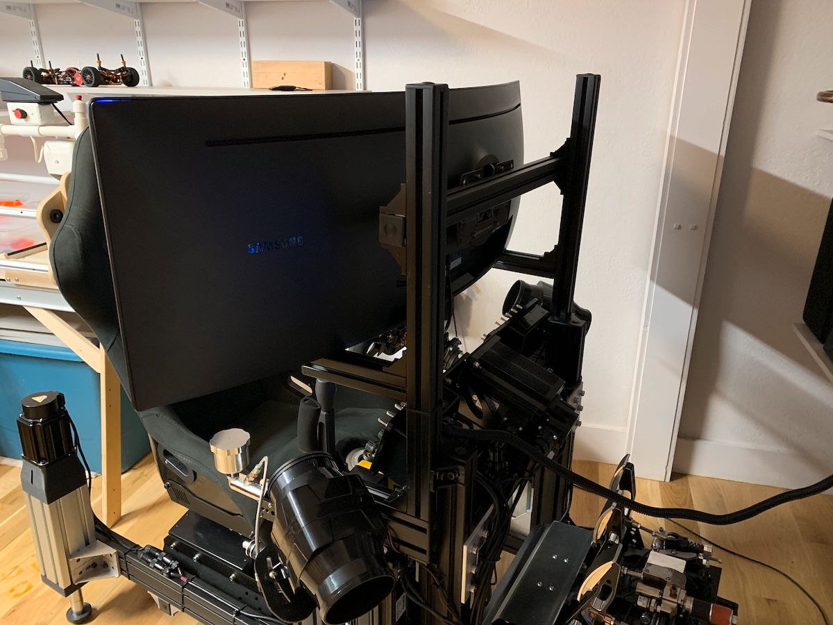

    Got rid of the huge monitor stand, and mounted the ultrawide on the rig. It's solid, doesnt' shake at all. We'll see how it holds up to the motion. So far, so good, and so much more neat and compact. Wife approved.

    Thanks. My priority has been a compact rig for the small space we have. Mounting this on the motion platform certainly helps. Triples would be difficult/impossible to securely mount, so the ultrawide is a really nice option for this application. It's perfectly placed here, close to me, just enough clearance for my wheel/hands. Looks great when seated. It's not a triple screen, but its close enough to get decent immersion.

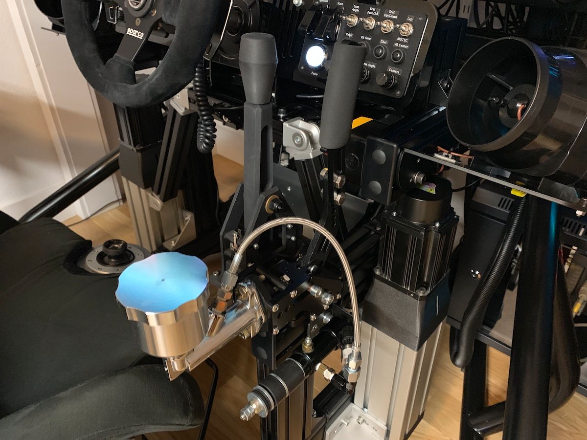

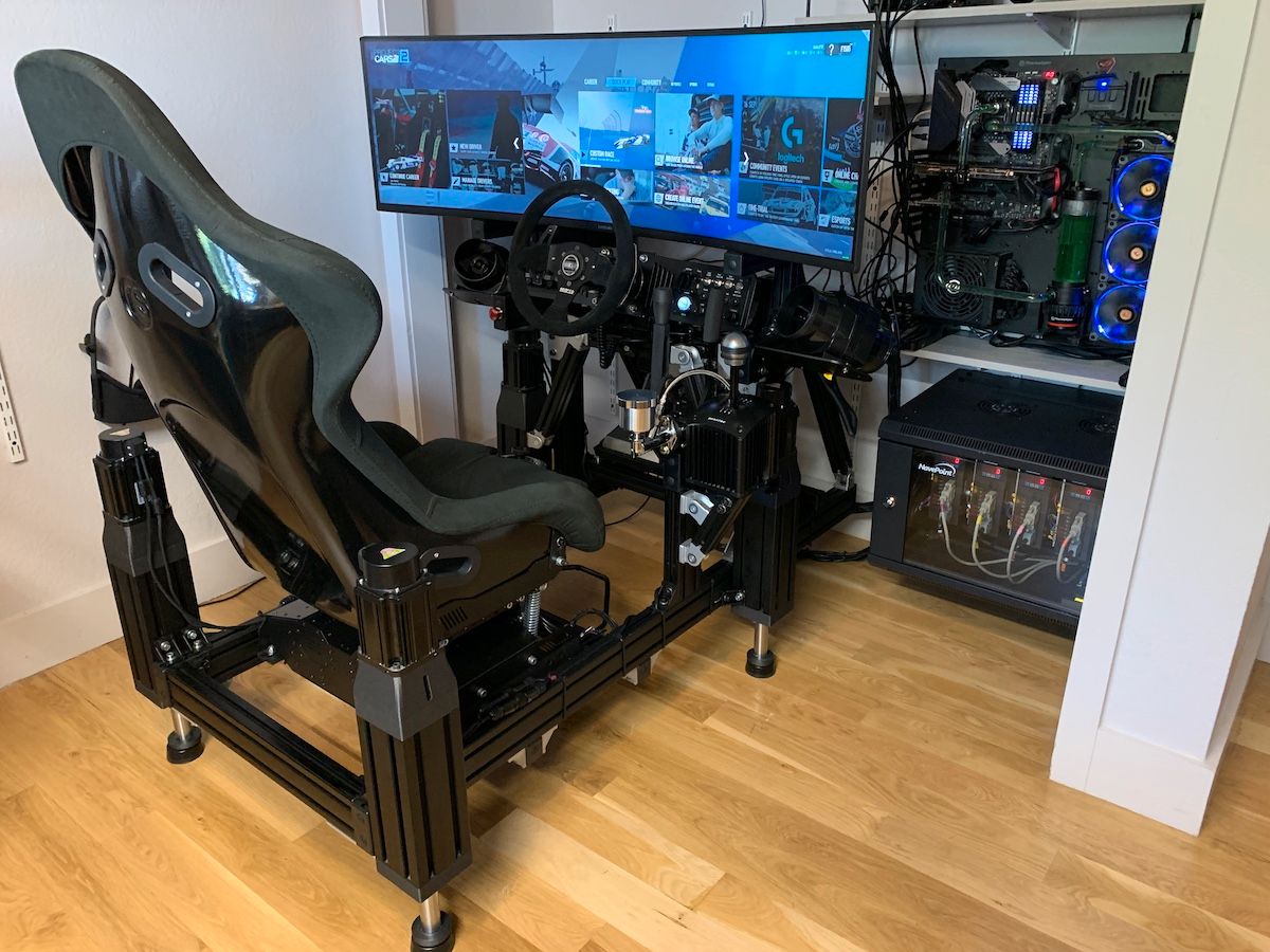

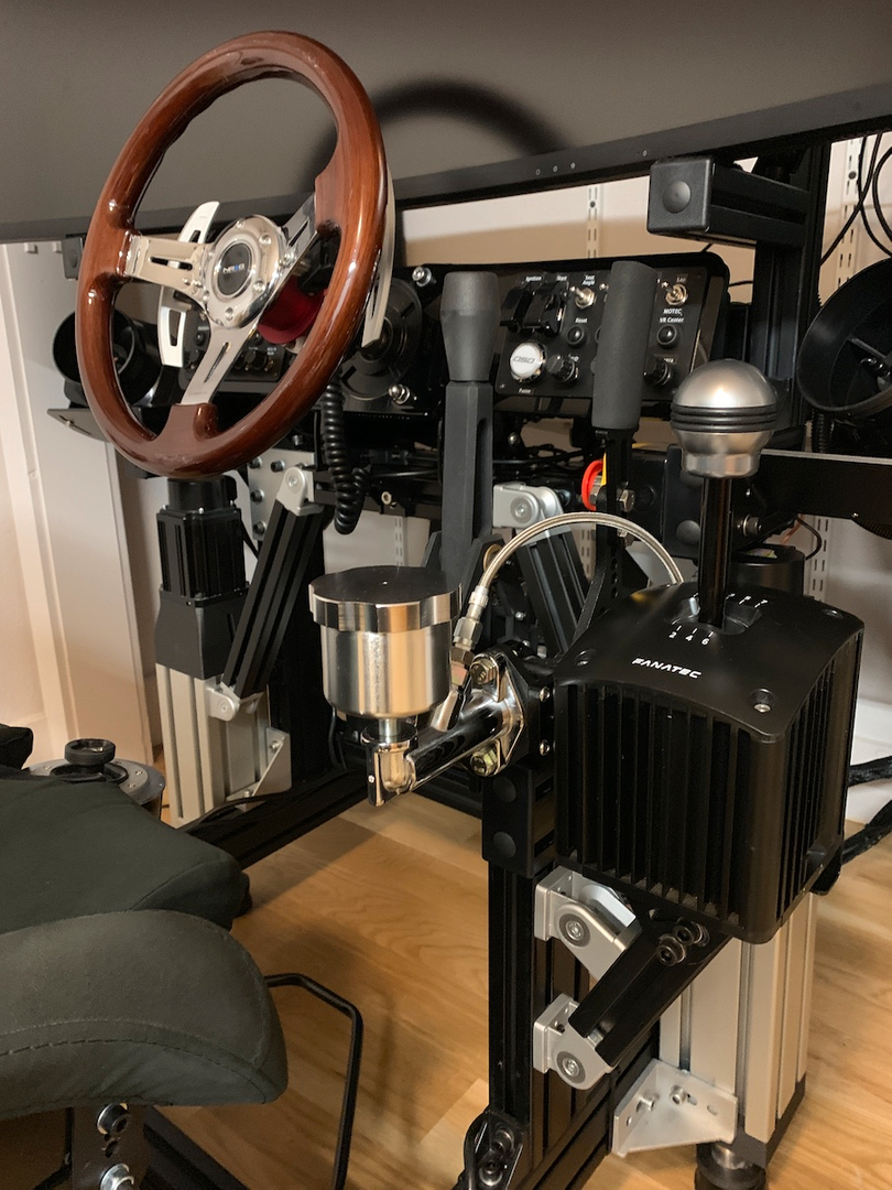

    A bit of cleanup work and organizing the right-hand controls. Relocated the slave cylinder for the handbrake, and found a compact way to mount the Fanatec Shifter. Everything is rock-solid, no movement at all in any of the controls.
    I've also spent some time tuning settings, mainly for Project Cars 2 and Assetto Corsa. If anyone wants me to post axis and games settings for use with the SFX-100 actuators and Simtools, just let me know.

    Another pic, showing the triangulated bracing I used. The wheel deck is absolutely rock solid here, like a heavy steel anvil. Not a budge.

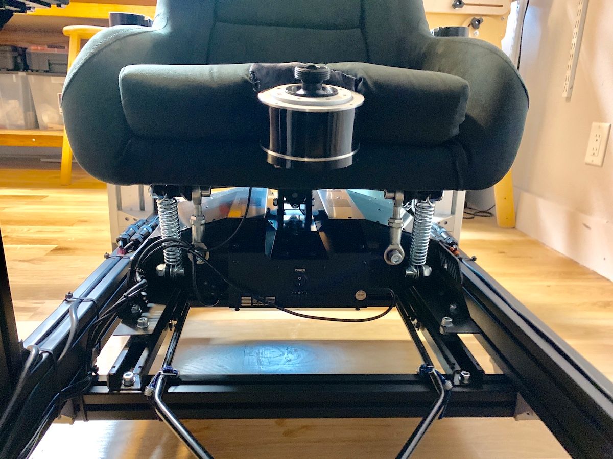

    Also of possible interest. My v3 is on a slider system, with the entire v3 motion platform on the sliders. These keeps the proper center of gravity over the v3 as you move the chair. Super simple to get this installed (low) on my 8020 homebuilt profile.

    I arranged to have the extrusions for the actuator housings black anodized. Here you go:
