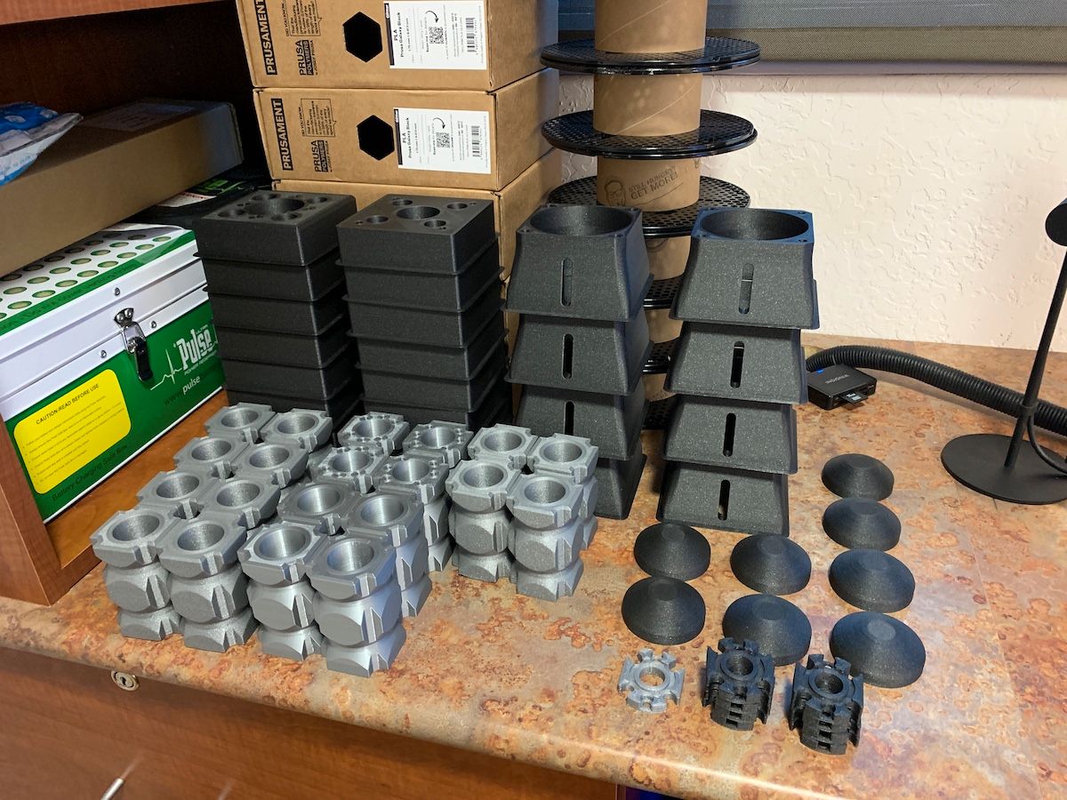

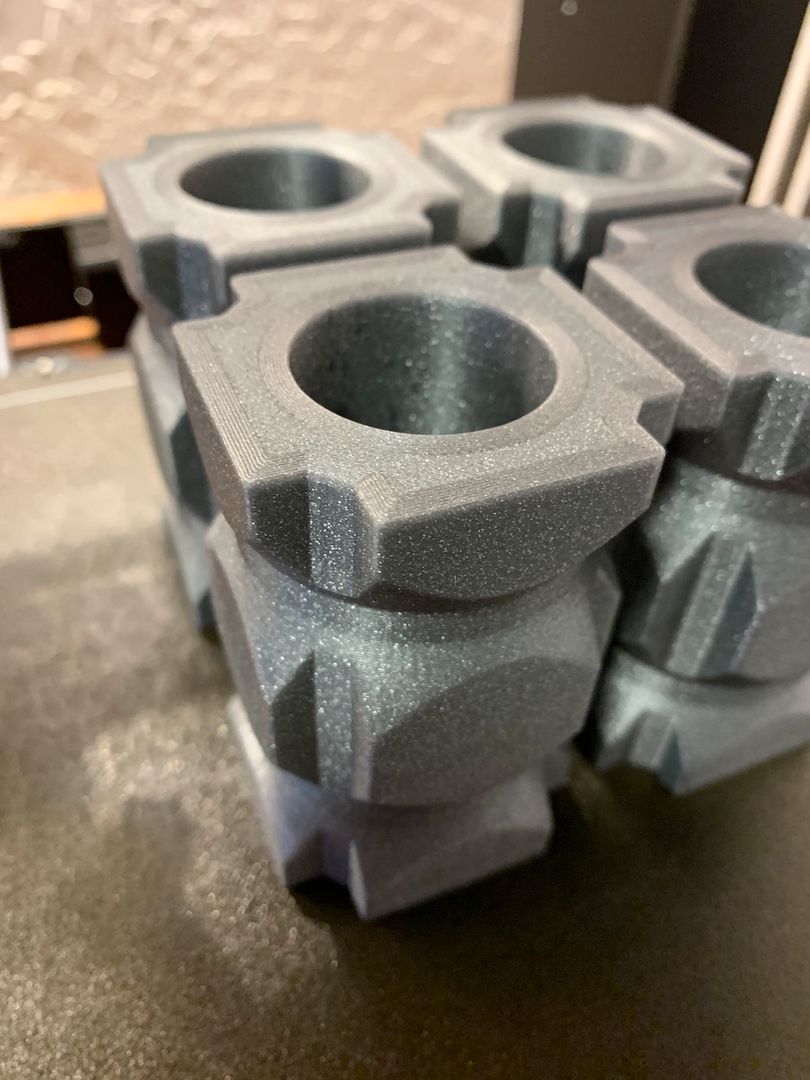

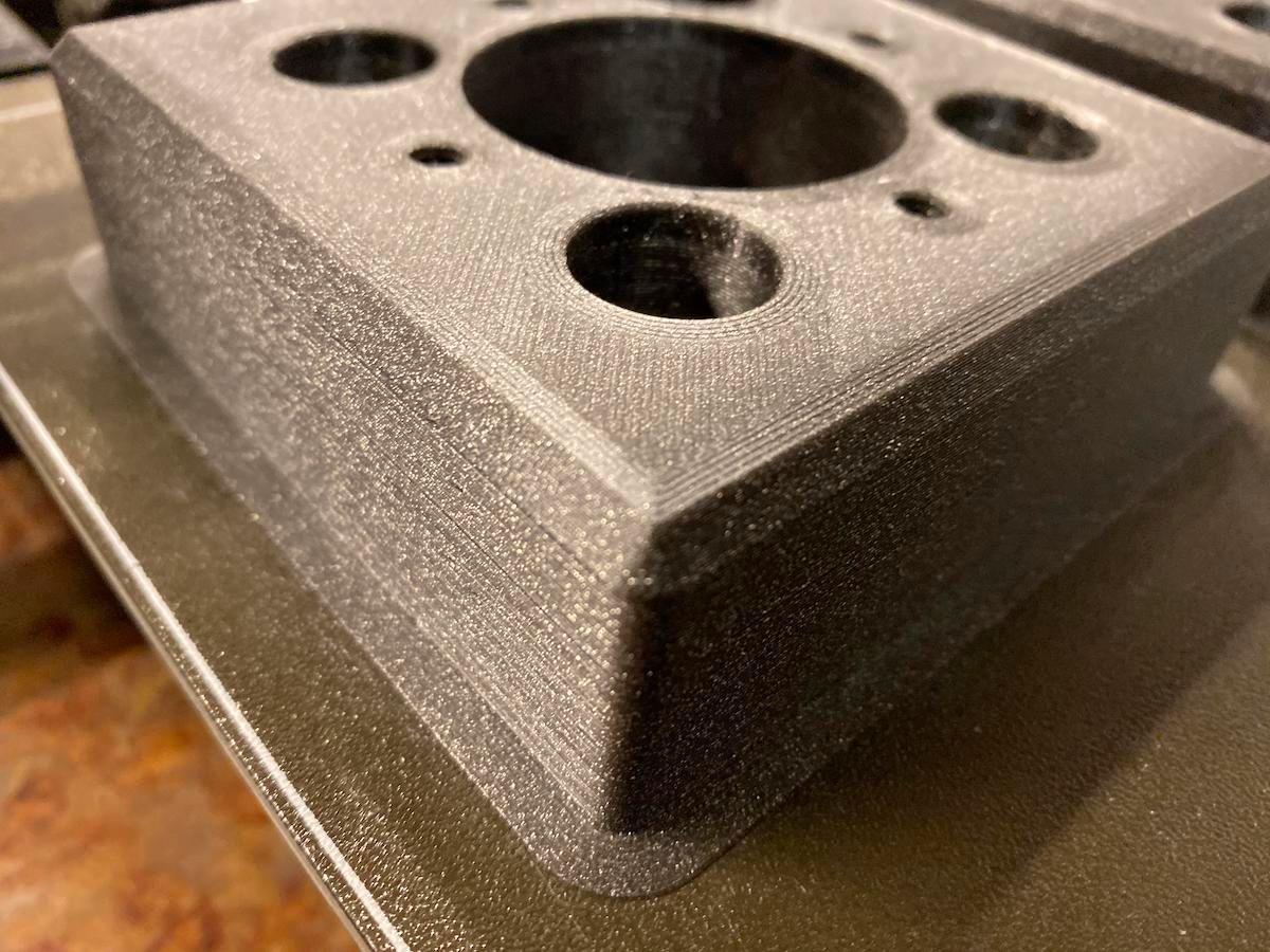

    How to print SFX parts in under 100 hours
    I've been experimenting with settings to reduce the print time for SFX parts. [For those unaware, I've been printing many of these sets as I've been doing this as a free service for the community].
    Anyway, after literally thousands of hours of printing, I've found a way to use a 0.6mm nozzle to get gorgeous prints that are stronger than the original, and take half the time to print. Here's the final result. This piece normally takes about 11 hours to print with normal settings (0.4mm nozzle, 8 perimeters, 12 top/bottom layers, 20% infill). I printed this in less than 5 hours:
    This part is stronger than the stock parts, a natural consequence of a thicker extrusion, larger layer height, and use of 25% (compared to 20%) infill. To achieve this you really have to know your printer and slicer. Here's details on how to get this result.
    First, you need a well-calibrated printer. You want it square (no skew), a level bed, and a very well calibrated extruder. All of these things are outside the scope of this note; you can google to get all of these things tuned on your particular printer.
    For the SFX parts, you have a few considerations. A big issue is warping. To prevent this, I print with a 5mm, single layer height brim. Also, I've found printing the first layer at half the height of subsequent layers dramatically improves bed adhesion, reduces warpage, and gives a nice, cosmetic result. Plus, the brim will be fairly thin and easy to remove at this setting.
    Here's the basic settings for a 0.6mm nozzle. You'll have to find the places in your slicer program to update these:
    0.6mm nozzle profile (be sure to change to the whole profile, not just the nozzle diameter)
    0.4 mm layer height
    0.2 mm minimum layer height (for variable layers, see below)
    0.2 mm first layer height
    5 perimeters
    8 top/bottom layers
    25% infill, grid pattern
    solid infill every 20 layers
    perimeter start point: random
    5 mm brim, single layer high
    variable layer height for the top 3mm of the print down to 0.2mm
    The last requirement here is optional. Your slicer may not support this. You want the ability to have variable layer height, and set the last (top) 3mm of your print back to a 0.2mm layer. This wil print a very nice edge on the linear bearing (see picture, above) as well as give a very smooth, cosmetic infill on the top that you can see in the pic as well. If you do use variable layer height, you may want to set the number of "top" layers to 12, to compensate for the thinner layers this will print. Variable layer height is an advanced feature, and you'll have to read your slicer manual for specifics. Once you have all these settings, slice your STL file, and print away.
    A couple of other comments. I printed all my bumpstops and sliders with the 0.4mm nozzle. I've not tried these 0.6mm nozzles with the sliders; this is the most sensitive part to variation in dimensions, and once I dialed one of my printers for sliders, I've used that ever since. You can try a 0.6mm nozzle on the slider, but be prepared to have to tune things to get a good, tight fit in the extrusion.
    These changes will reduce the printing time for a full set of parts from 220 to about 100 hours. Good luck, and let me know if you have any further questions.

    Thanks! The key to getting those parts is really 2-fold. First - and most important - is a really well calibrated printer. This entails several subparts: square axis (no skew), a level print bed, properly tensioned belts and greased linear bearings, and a well-calibrated extruder. Each of these is beyond the scope of this reply; you'll have to research how to achieve this for your particular printer. The other key is picking the right filament. I use premium filaments, and I prefer glitter/glint to help hide build lines. I've successfully used Prusament Galaxy Black and Filament One Glint Grey (both shown above).
    With that, my 0.4mm settings are the stock settings recommended by the SFX project:
    0.4mm nozzle
    0.25mm layer height
    8 perimeters
    215/60 temps
    NO brim on the sliders, feet, and bump stops. 5mm single layer brim on the other parts
    I believe my slowest speeds are 30mm/s (for perimeters and first layer); whatever the stock "draft" settings are for other speeds
    I slice my parts with the Prusaslicer (Sli3er?) v2.0.
    I also upgraded my Prusa Mk3S to use a Bondtech geared extruder head. This helps as well, as its more accurate and provides much more consistent (and stronger) pushing force for the filament through the hot end. The other key mod on the Mk3S is the "NyLock" bed leveling mod. This later mod is easier than it sounds, and cheap. I recommend both of these if you're looking to improve your results to achieve what I've shown here.

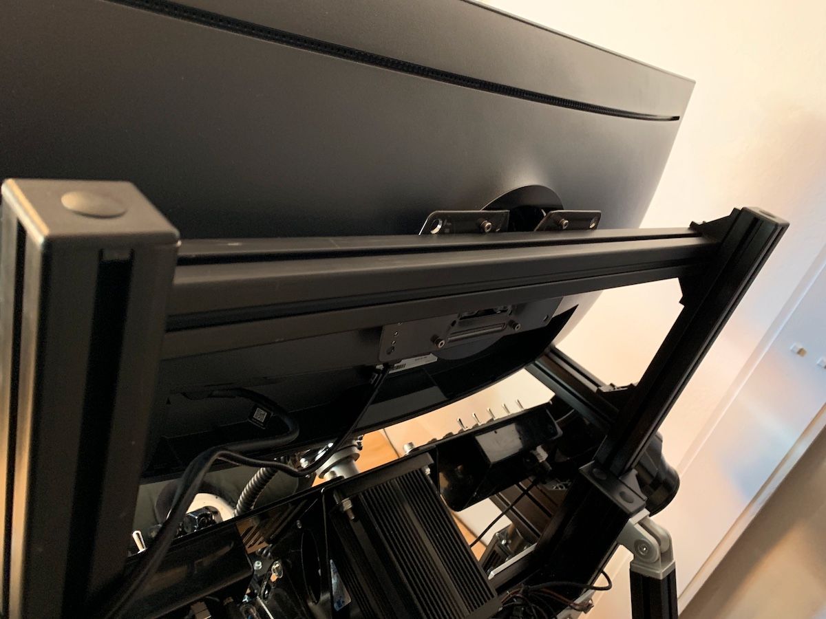

    I have asked you a question on Reddit but you probably missed it, what is the exact model of your Monitor / TV and how did you mounted it?

    My monitor is the Samsung CRG90, and it comes with a VESA mounting plate. I used the 100mm holes, screwed into a spare wall mount I had, and I drilled the wall mount and secured that to 40mm square profile with slot nuts. In addition, I braced the bottom of the monitor with 2 additional pieces of 40mm profile. These pieces aren't hard-attached to the monitor, but serve as a shelf to support the ends. Here's a few pics.
