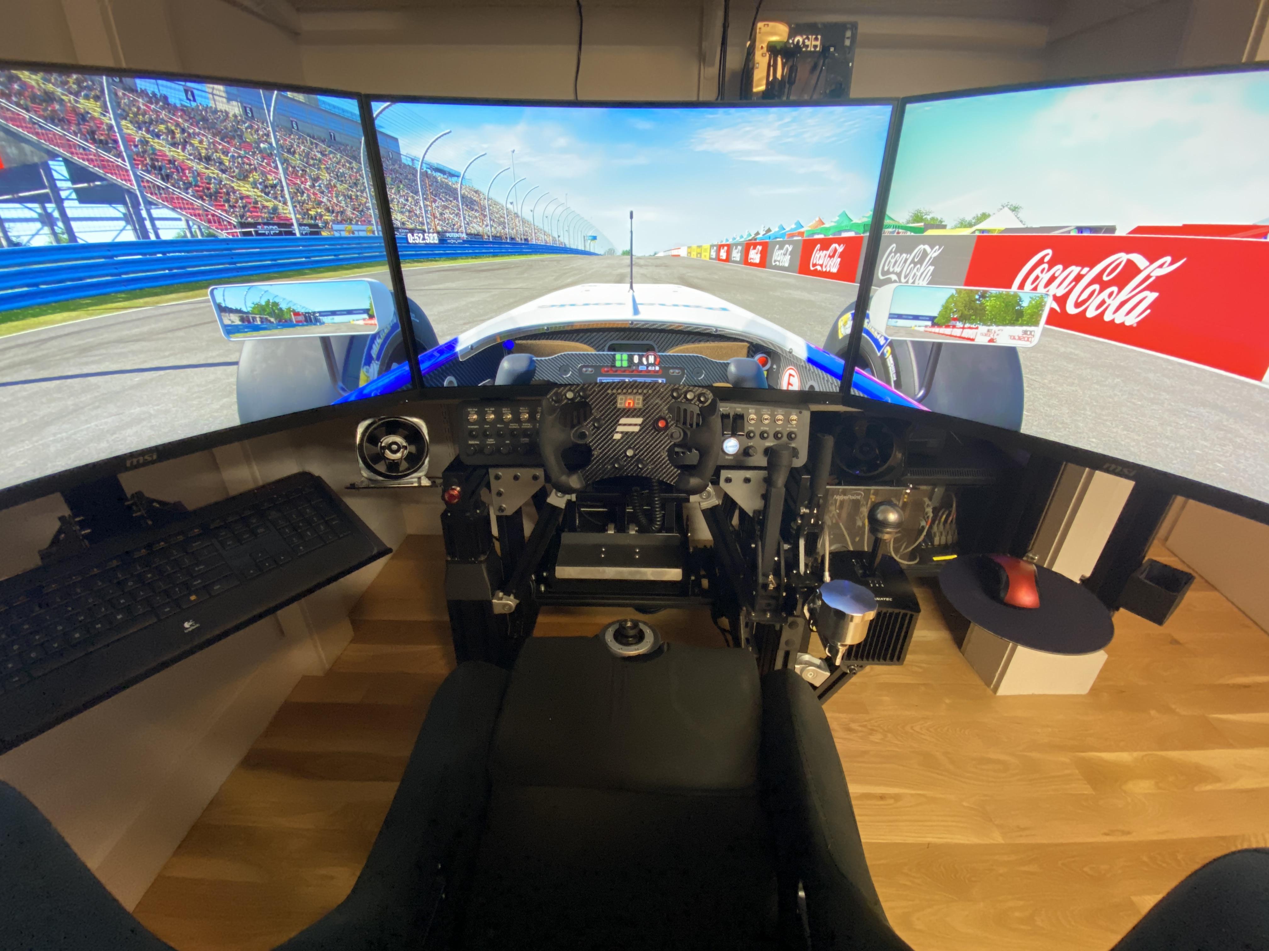

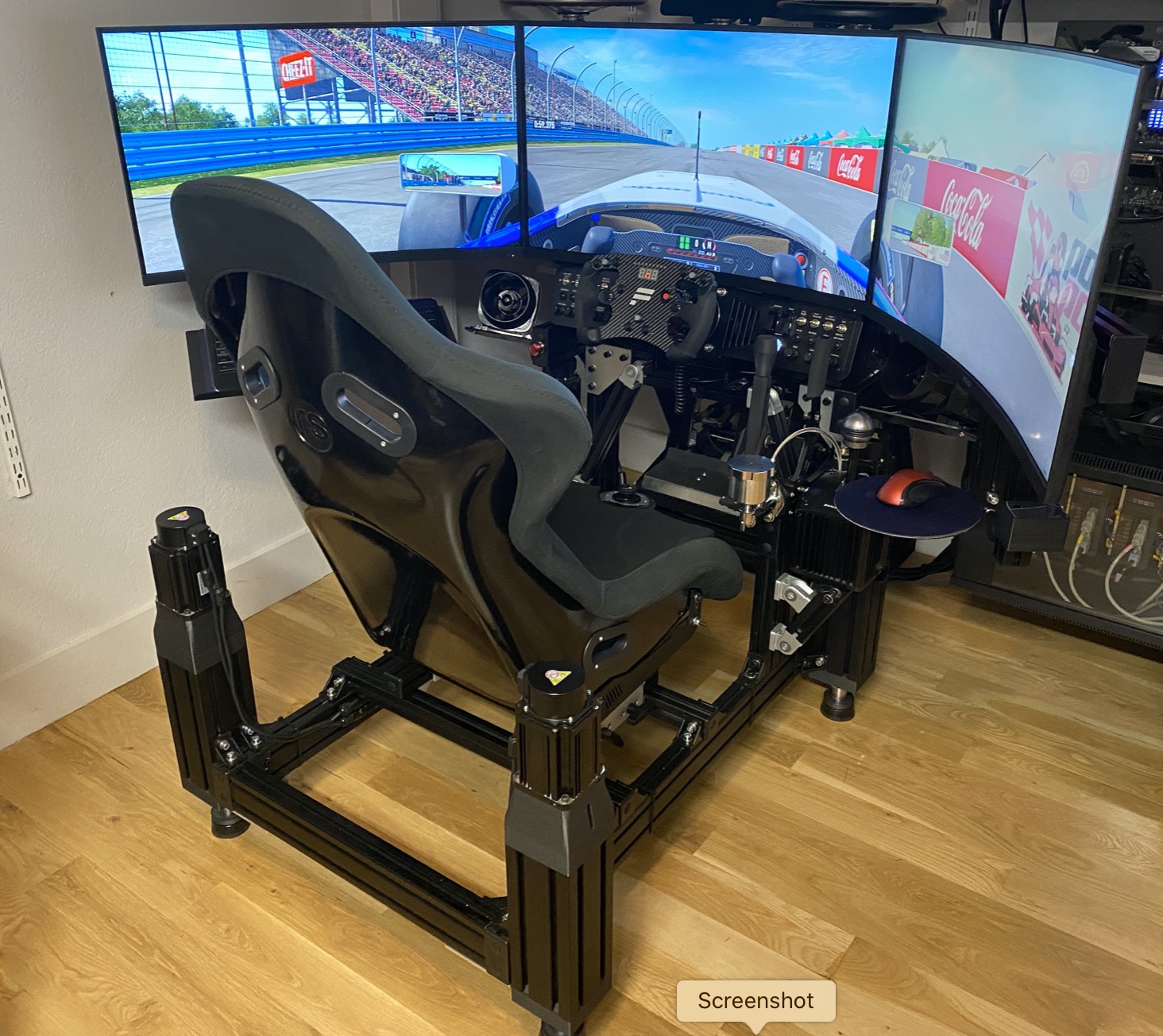

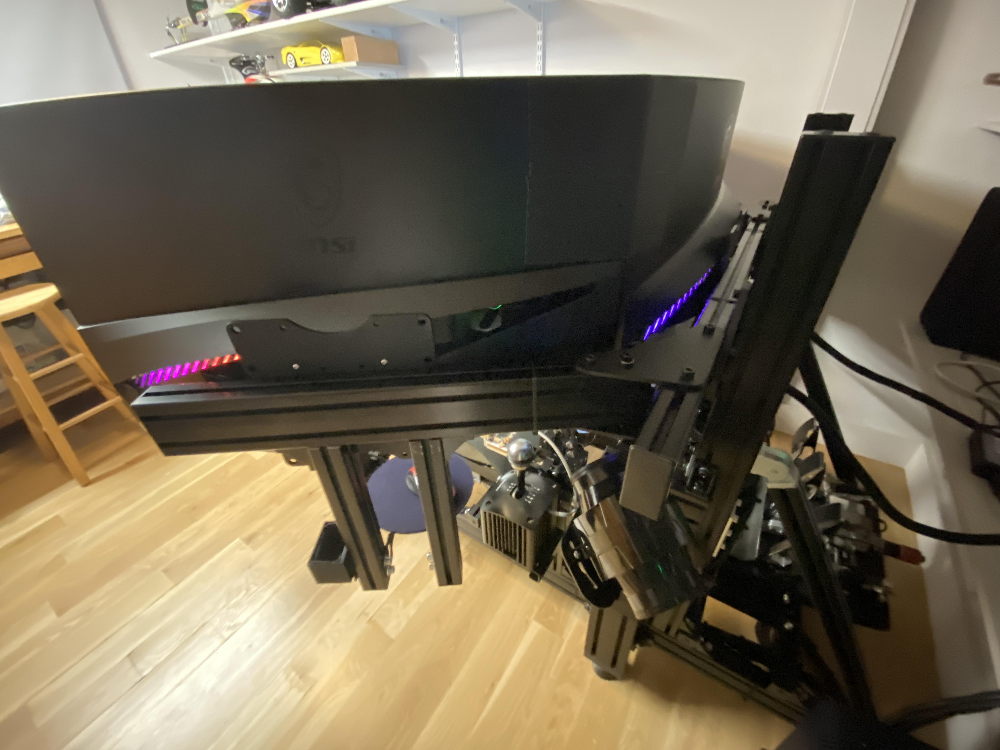

  17. diablo2112
    diablo2112 Member
    Apr 12, 2017
    58
    USA
    662Coins
    +143 / 0 / -0
    2DOF, Motion platform, 4DOF
    I've gone back to triple screens. Here's a few pics and a short video.
    • Winner Winner x 3
  18. Sebj
    Sebj Active Member
    Nov 13, 2014
    287
    Canada
    492Coins
    +165 / 1 / -0
    Why did you go back? What VR headset did you run?
