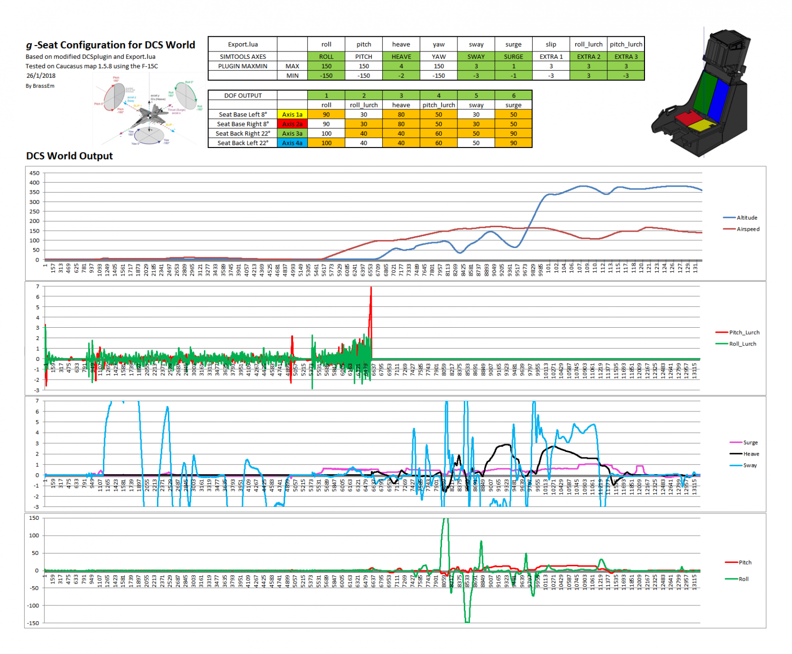

    Yes, Roll translates to sway movement in the seat. However using roll rate output as a separate input to sway does translate well expecially doing snap rolls.
    I have rewritten the DCS plugin and Export.lua for g-Seats to use the Extra 1, Extra 2, and Extra 3 channels as Slip, roll_lurch and Pitch_lurch. Roll and Pitch Lurch are only for ground effects using LoGetAngularVelocity() and works extremely well. The F-15C is good on ground but the Su-25 really rocks and rolls as it should. Slip has not been utilised and have tested with fast movers only. (Sorry helo pilots.)
    The Roll and Yaw are angular rates converted to degrees and used as Roll and Sway. Pitch is not used in my case as it translates to Heave for a g-Seat. The MinMax configuration file has been adjusted to give best response values while limiting the motor travel.
    I have modified things for g-Seat outputs and will publish it soon but if value1's plugin is good for 2DOF's then I will also post a 2DOF's version as well. However I've got no way of testing that.
    EDIT: I've looked further into the 2DOF's and don't think it will work. Can angular rates be used rather than angles?

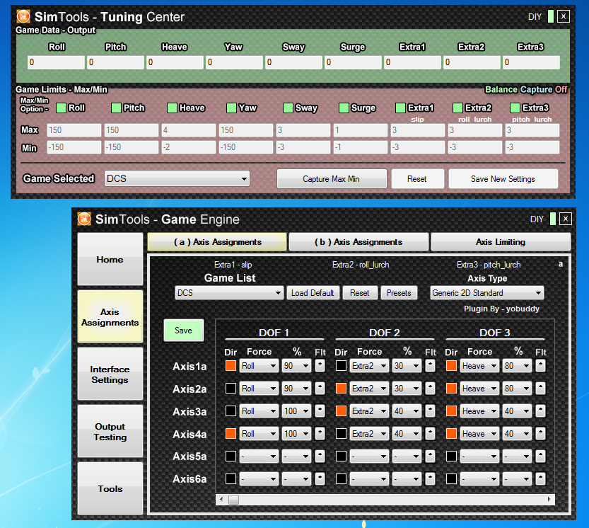

    This is my export.lua but I have modified the plugin to output to extra 1, extra 2, extra 3. I have axis limited my motors to 75% but recommend very low % so you dont crash them to start with. The min max setting gets good dynamic range from the values. I hope this gives you something to work with. Please note that my plugin ports the DCS output to the appropriate SimTools channel raw. (I will be posting my plugin on the weekend but it is for gseats though.)
    Min/Max config
    Code:
    <?xml version="1.0" encoding="utf-8"?>
    <GameMaxMin xmlns:xsi="http://www.w3.org/2001/XMLSchema-instance" xmlns:xsd="http://www.w3.org/2001/XMLSchema">
      <_GameName>DCS</_GameName>
      <_RollMax>150</_RollMax>
      <_RollMin>-150</_RollMin>
      <_PitchMax>150</_PitchMax>
      <_PitchMin>-150</_PitchMin>
      <_HeaveMax>4</_HeaveMax>
      <_HeaveMin>-2</_HeaveMin>
      <_YawMax>150</_YawMax>
      <_YawMin>-150</_YawMin>
      <_SwayMax>3</_SwayMax>
      <_SwayMin>-3</_SwayMin>
      <_SurgeMax>1</_SurgeMax>
      <_SurgeMin>-1</_SurgeMin>
      <_Extra1Max>3</_Extra1Max>
      <_Extra1Min>-3</_Extra1Min>
      <_Extra2Max>3</_Extra2Max>
      <_Extra2Min>-3</_Extra2Min>
      <_Extra3Max>3</_Extra3Max>
      <_Extra3Min>-3</_Extra3Min>
    </GameMaxMin>

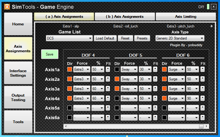

    And the axis assignments in the pics attached;
    Cheers,
