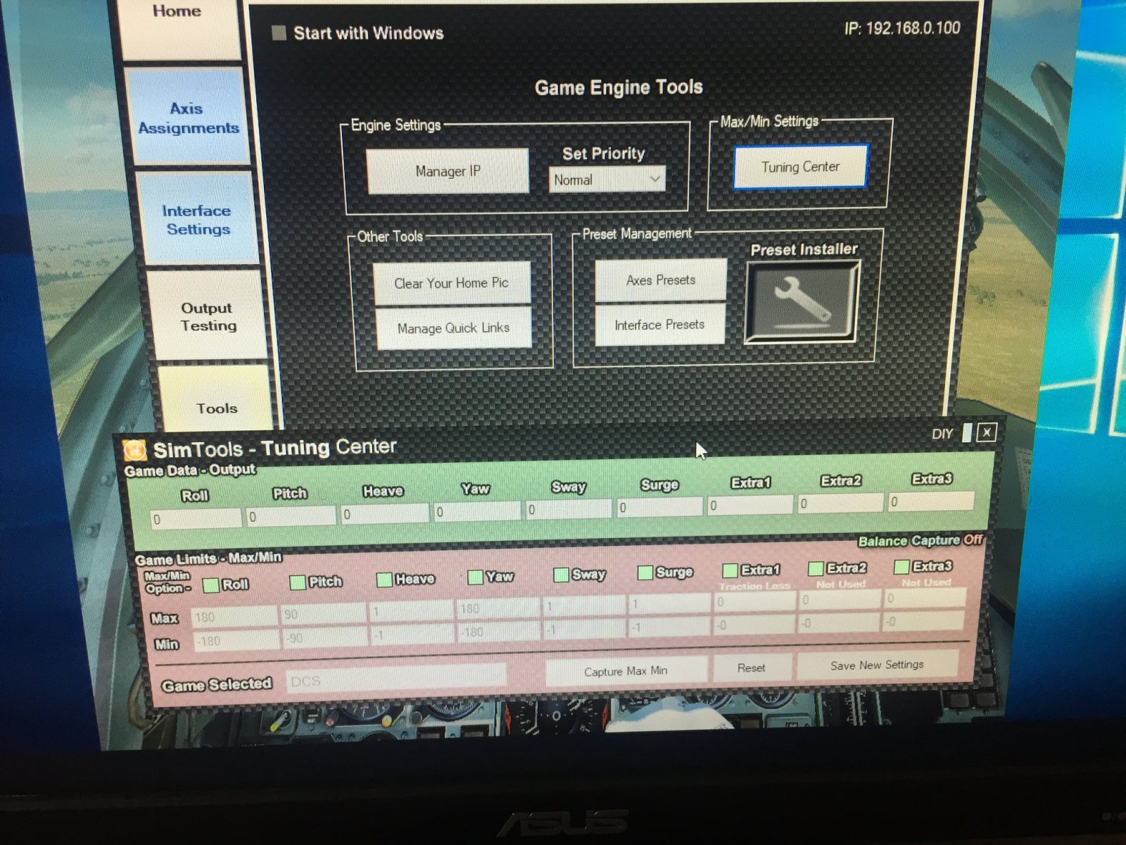

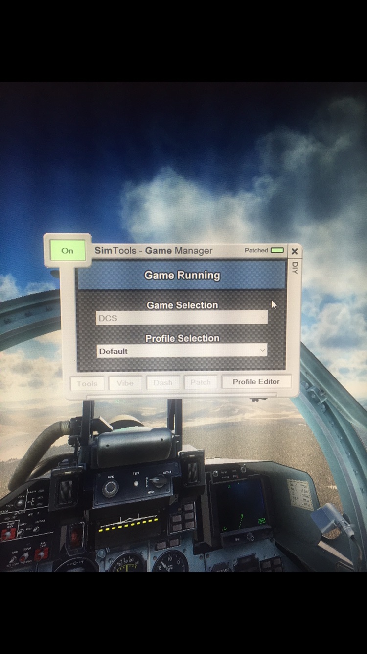

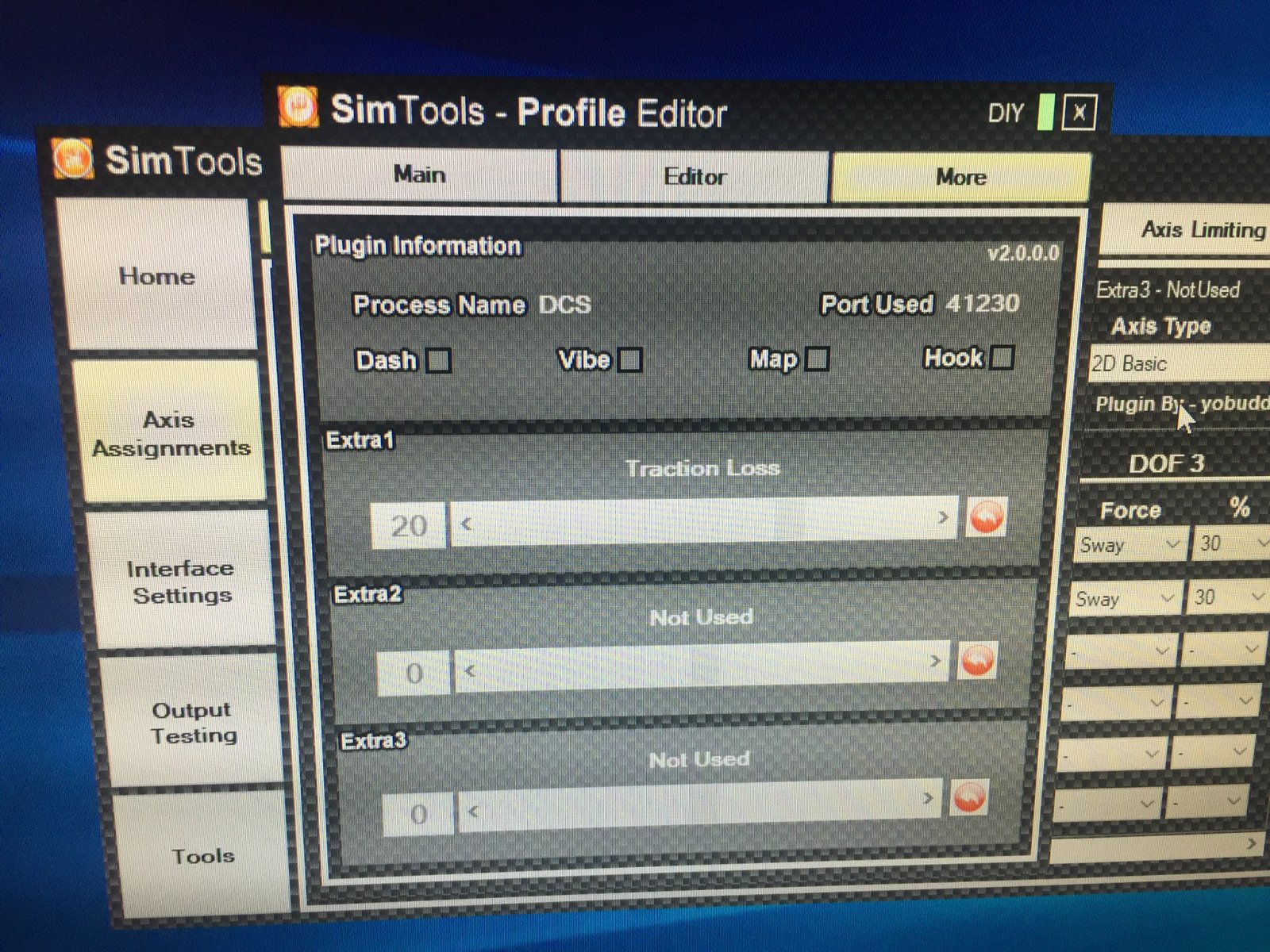

    Hi everyone. I have a problem with the DCS. Game patching and running, but my 2dof motion not move. what's the problem?
    22,230
    154,849Coins
    +11,229 / 57 / -2
    You will need to post pictures of all of your settings to assist troubleshooting advice.

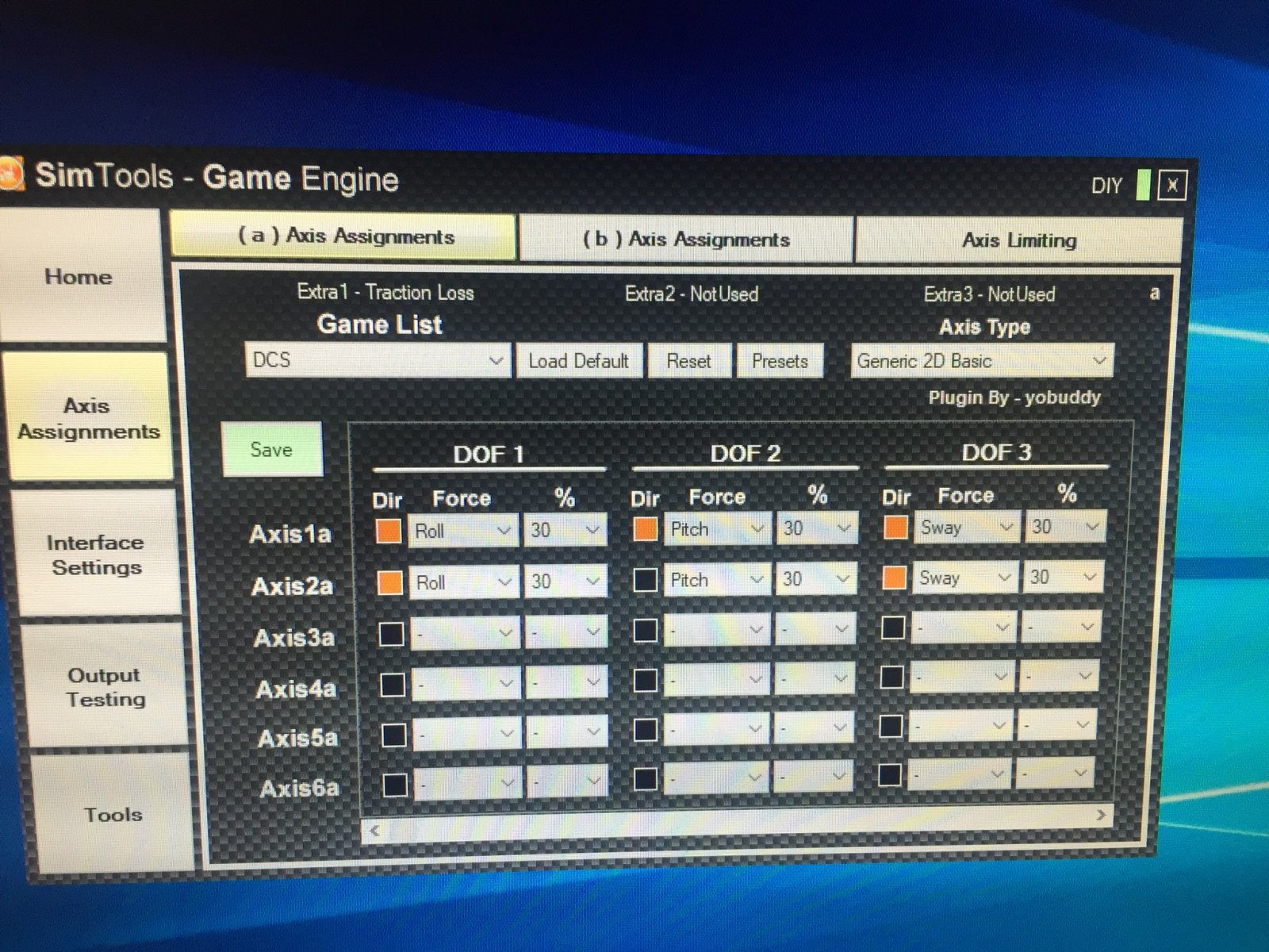

    My setting
    22,230
    154,849Coins
    +11,229 / 57 / -2
    Hard to help if you don't provide all of the requested information, such as a picture of Interface Settings.
    From your Axis Assignments it is likely your settings are not correctly configured to what SimTools expects, as per the link I provided, and what can be checked in Output Testing, as roll and sway would normally be the opposite of each other.

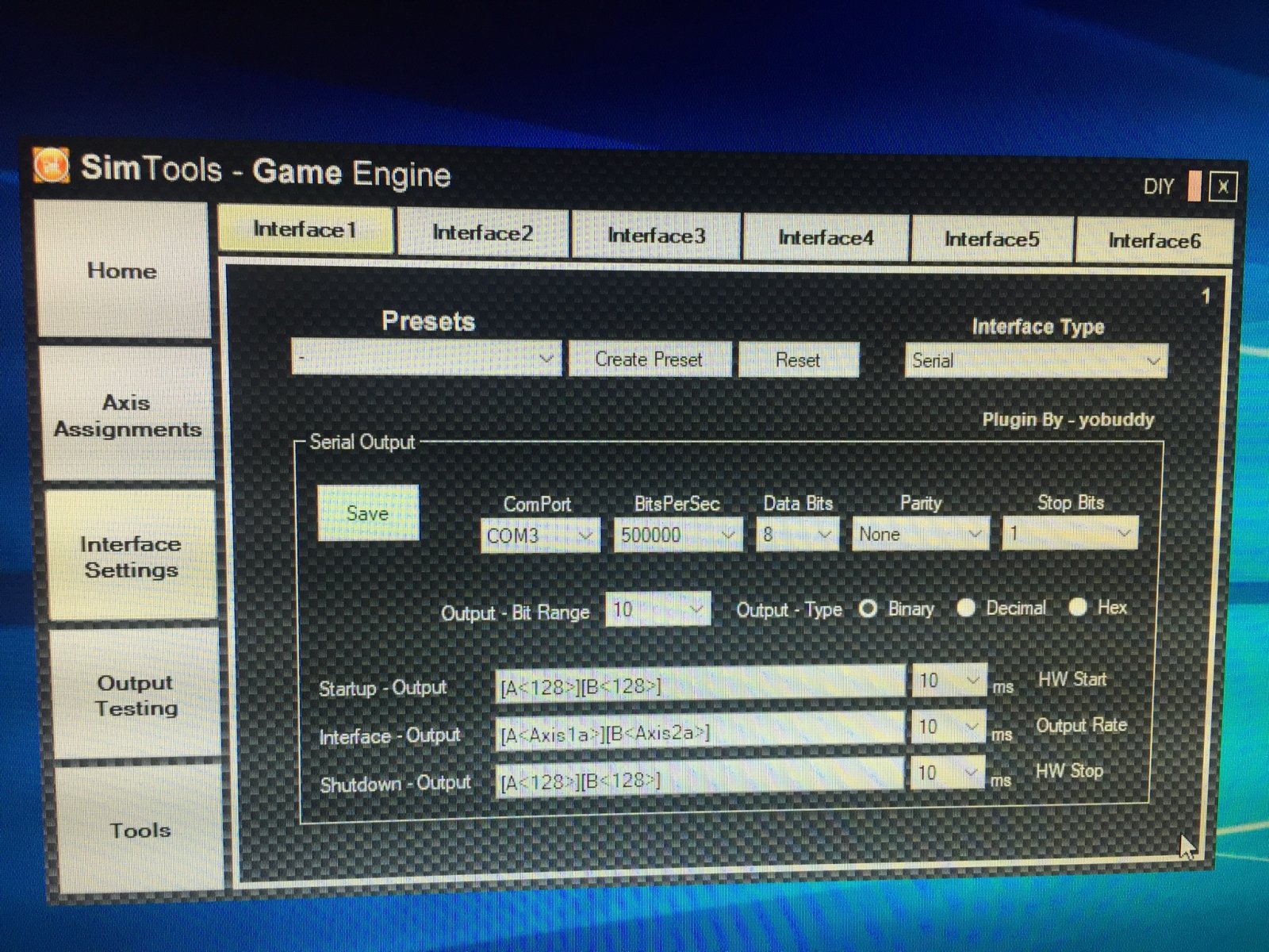

    I'm change roll and sway, it didn't work, motion not move. My interface setting:
  13. noorbeast
    22,230
    154,849Coins
    +11,229 / 57 / -2
    I am guessing you are utilising the SMC3 code, if so please confirm if everything moves as expected in the SMC3 utilility.
    If that is the case remove the start up and shutdown sections in the Interface Settings and tell us of Output Testing works.

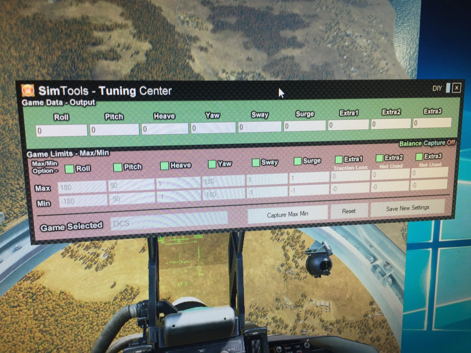

    I can feel the motors tapping in game, but the game is not transmitting data to simtools
  15. noorbeast
    22,230
    154,849Coins
    +11,229 / 57 / -2
    The Tuning Center does not show data is being received.
    Is your rig moving as expected first in the SMC3 utility, then in SimTools Output Testing after shutting down the SMC3 utility?

    thanks for the replies. the problem was the decimal separator in my windows for my region.
  17. noorbeast
    22,230
    154,849Coins
    +11,229 / 57 / -2
    That has been a real pesky one and likely related to Windows itself rather than SimTools, as it only affects some computer language settings, even within language groups.
    The SimTools dev @yobuddy and a bunch of members have been trying to pin the language settings issue down further, without a lot of luck. So it would be helpful if you PM @yobuddy and give details about your system and what is running on it.
  18. yobuddy
    51,780Coins
    +5,206 / 19 / -0
    I believe the problem here is that the DCS plugin installs a file that is hard coded with periods as the decimal separator.
    So i don't think this one is an example of the underline problem Noorbeast was referring to.
    We may be able to fix this one with 2x copies of the file it installs, one with comas and one with periods for the delimiter.
    Then it just needs to install the correct one depending on the systems default separator.
