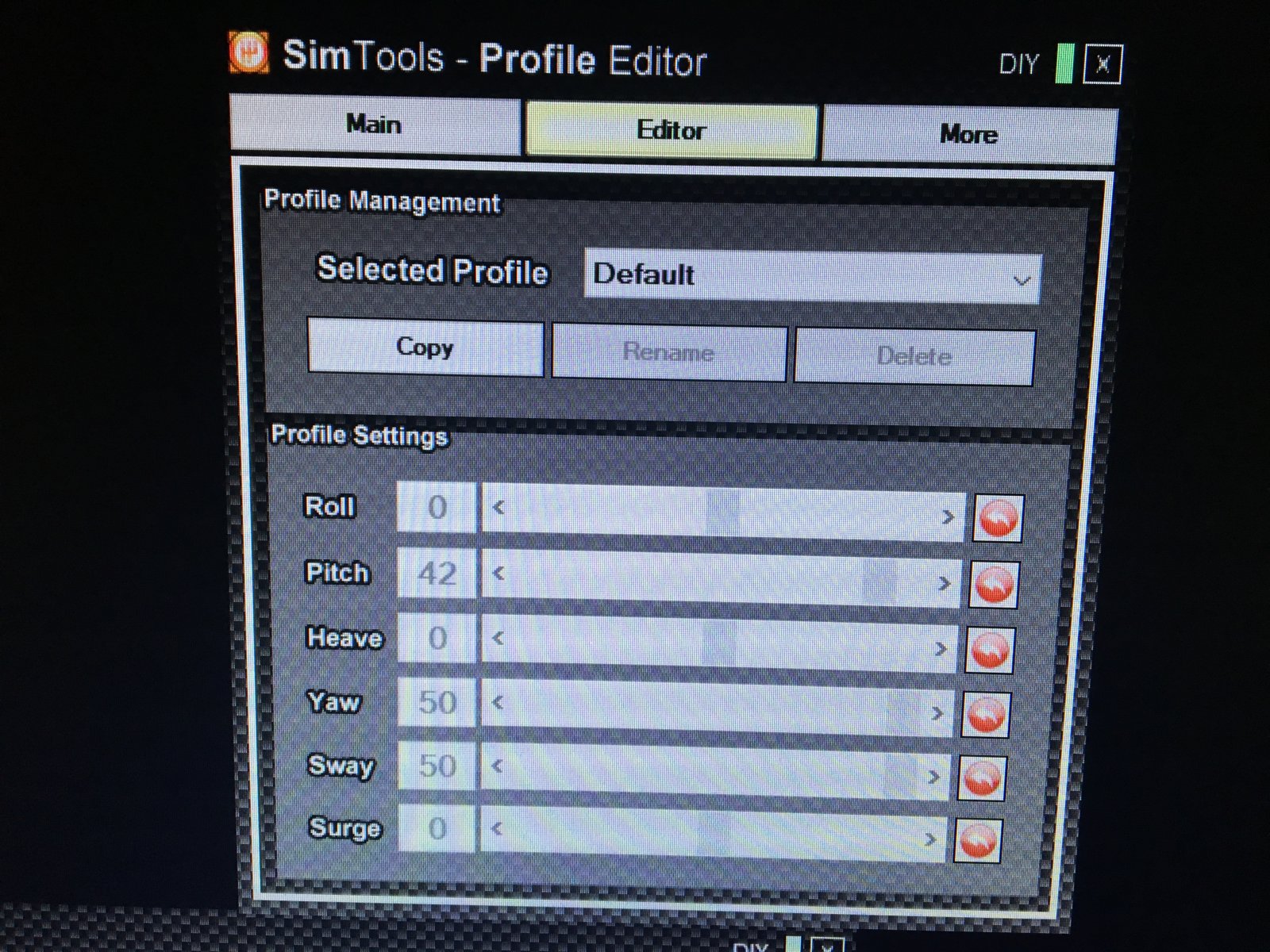

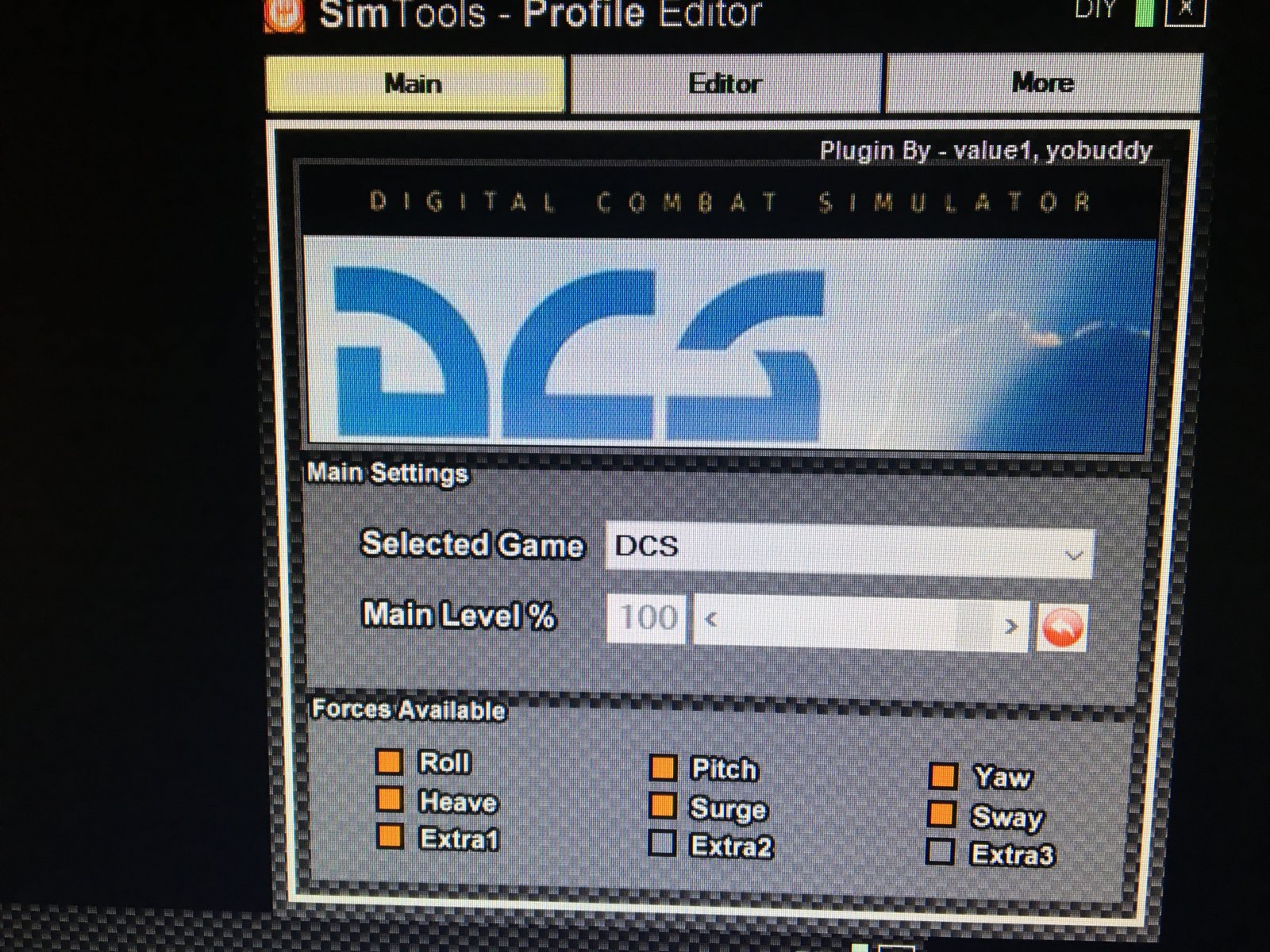

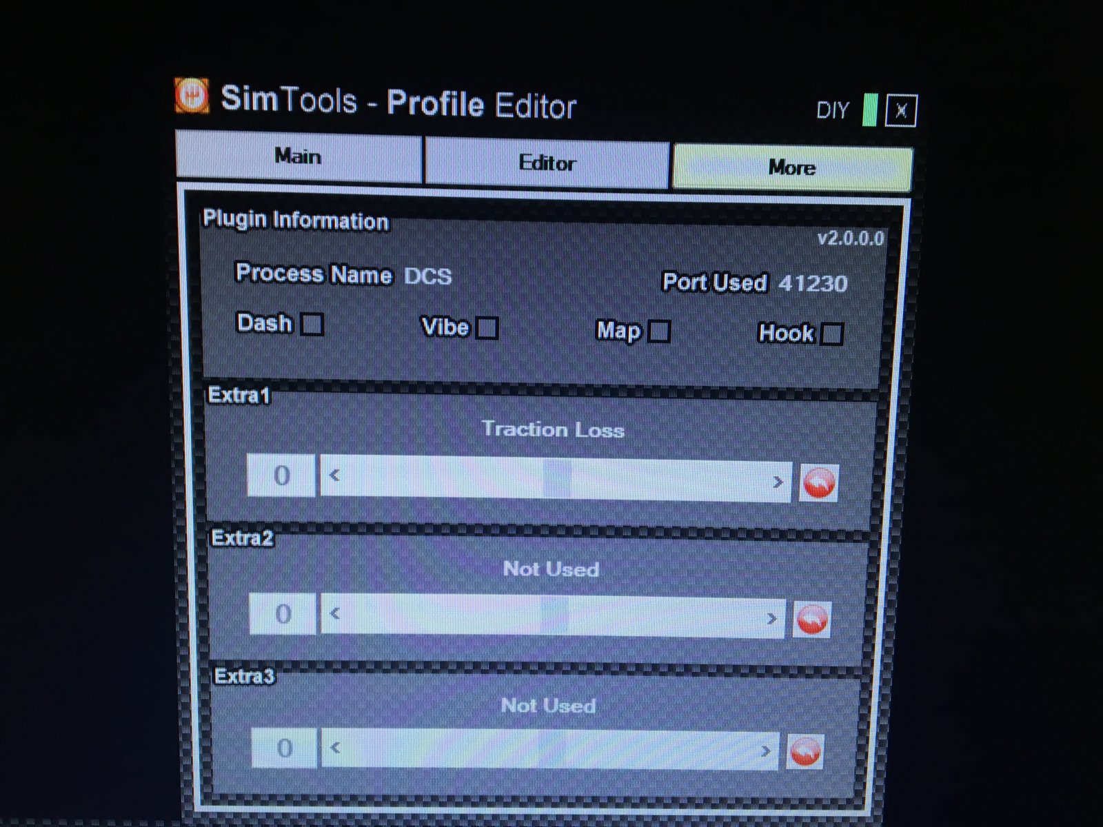

    0C02B9AC-0BC5-49F0-A595-41F818F2DD90.jpeg D3B3B34E-0BCE-44D2-889C-4119F7D5D713.jpeg FE59D20C-ABF9-48A9-8100-1D8956142D68.jpeg E2E2CD19-DCF0-4060-9539-EE8960856017.jpeg 3A3D7038-91EF-42AC-B107-C87DC6FCEF0F.jpeg 6281929D-5DC0-4038-83A5-6FE5A705726F.jpeg 75F2737E-C712-444E-B399-4153AD95333E.jpeg

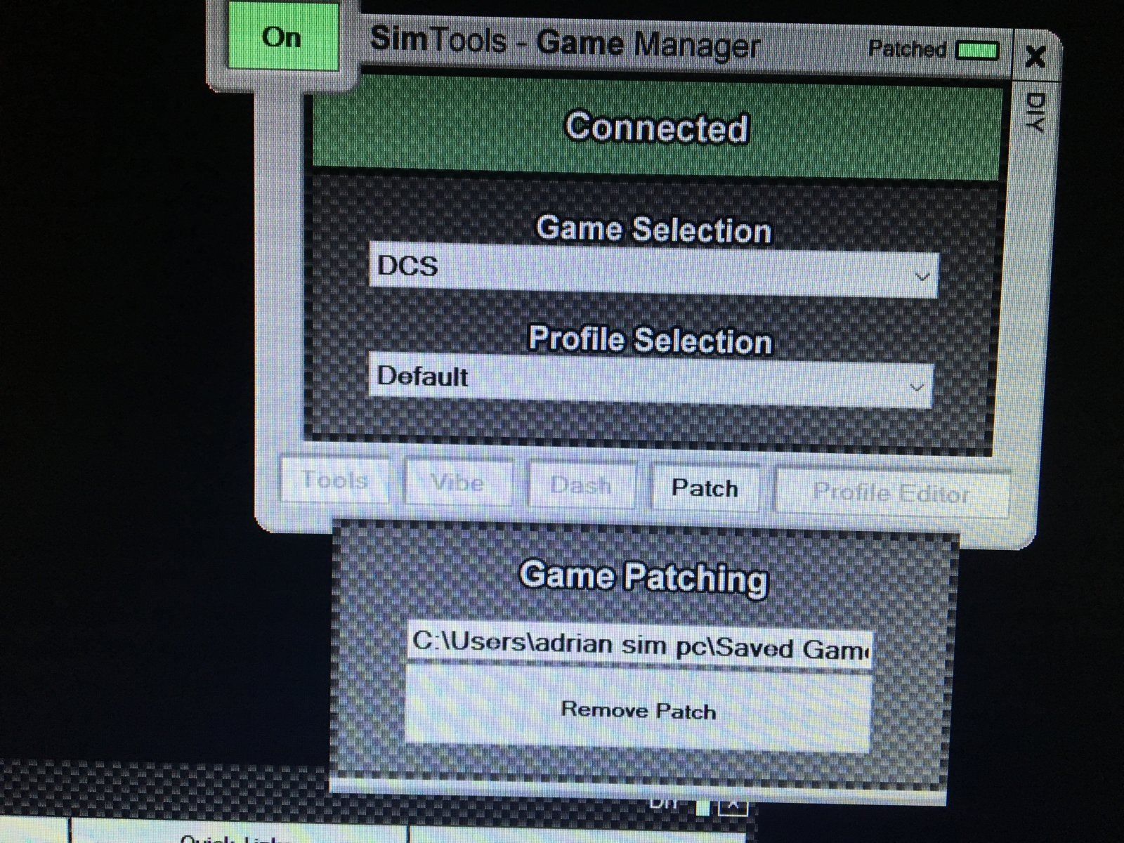

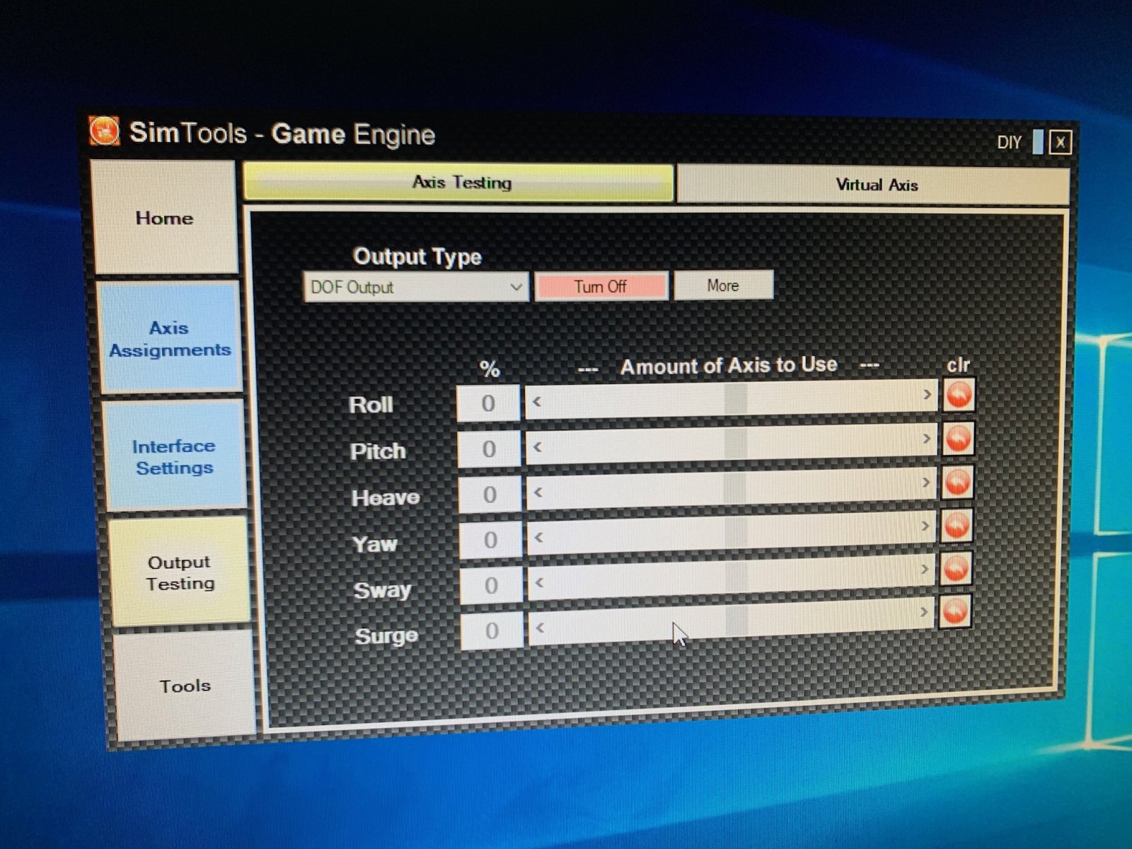

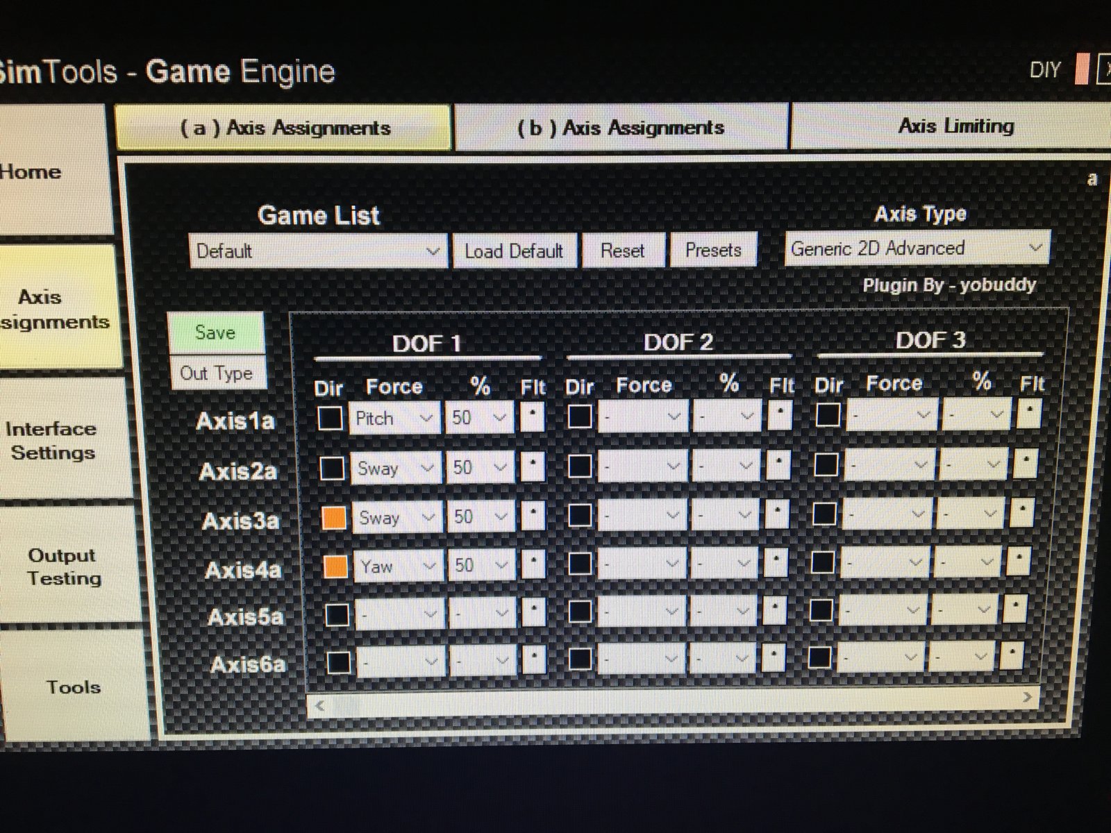

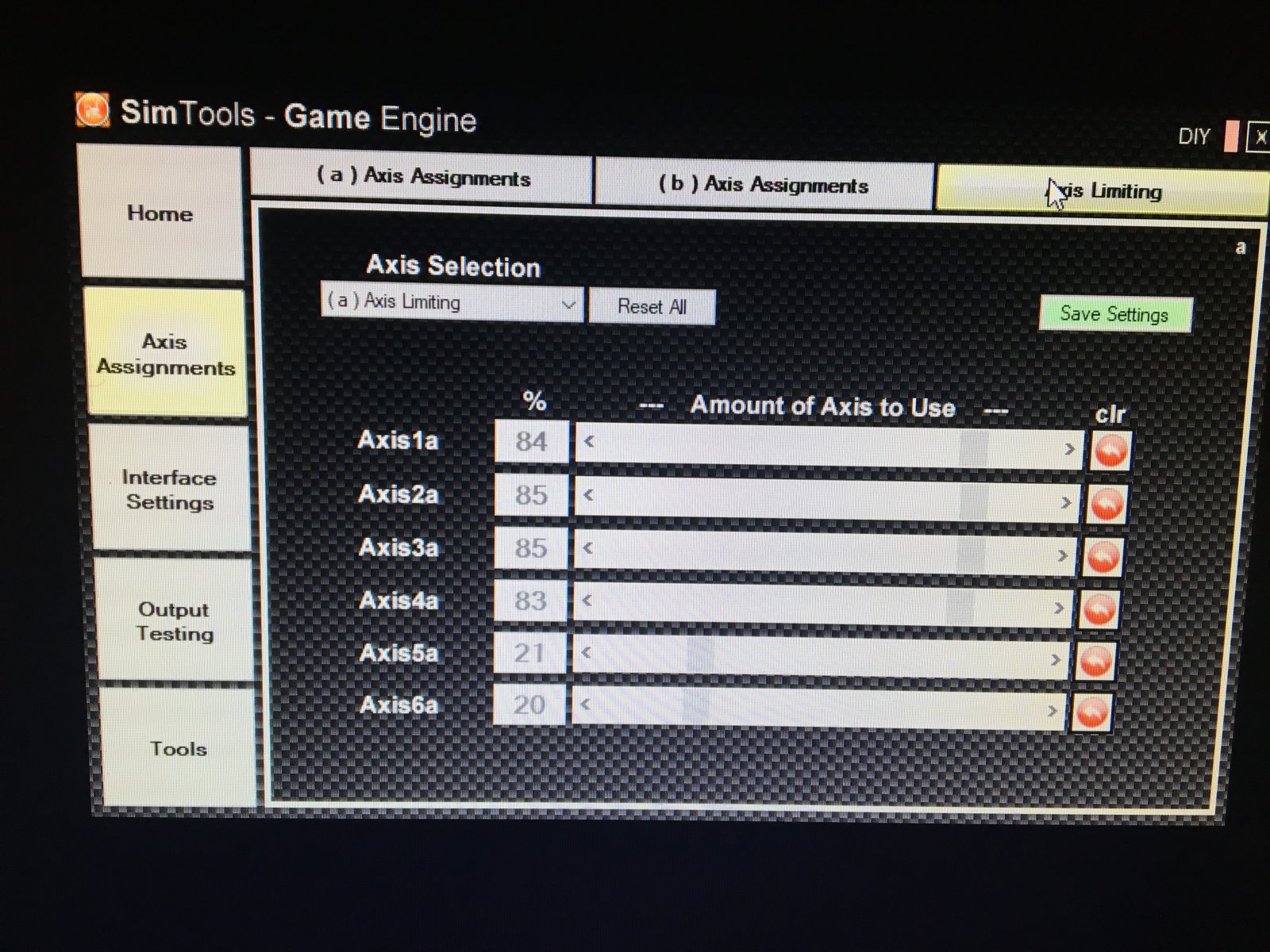

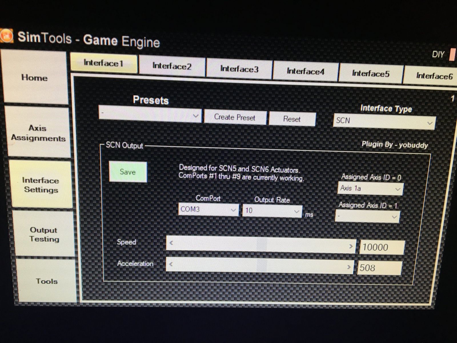

    No idea why it isn’t just working
    Screen shots attached of all settings
    Frustrating
    I use x4 standard SCN6 actuators
    All seems normal at start up , but just a minor odd sound of movement only during DCS running in plane

    Need a screen shot of tools/ tuning center while running...

    I’ll post tuning centre pic when I get a moment if that helps
    Not used my setup/DCS for a while due to this )-:

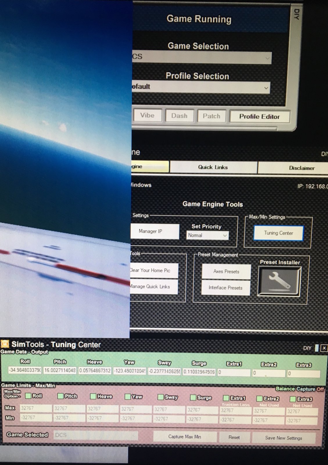

    B65EF1AE-8AD3-4E2A-A80A-4671FDADCBC5.jpeg Here’s my pic
    Not really messed with this tuning centre before
    The Min - Max figures are the same but I’m not sure how to change them —EDIT I notice bottom box has a minus next to it ,
    “capture max min” doesnt do anything ,
    data is coming nicely from the sim as lots of digit changes in top boxes
  12. noorbeast
    22,230
    154,849Coins
    +11,228 / 57 / -2
    You need to Capture Max Min, fly for a bit including doing loop and roll, Save New Settings and then tweak from there: https://www.xsimulator.net/community/faq/steps-to-create-a-motion-profile.228/

    Sorry about that.. It only appears if you select
    Axis Type:
    Generic 2d Advanced
    And that is in the Axis Assignment menu...
