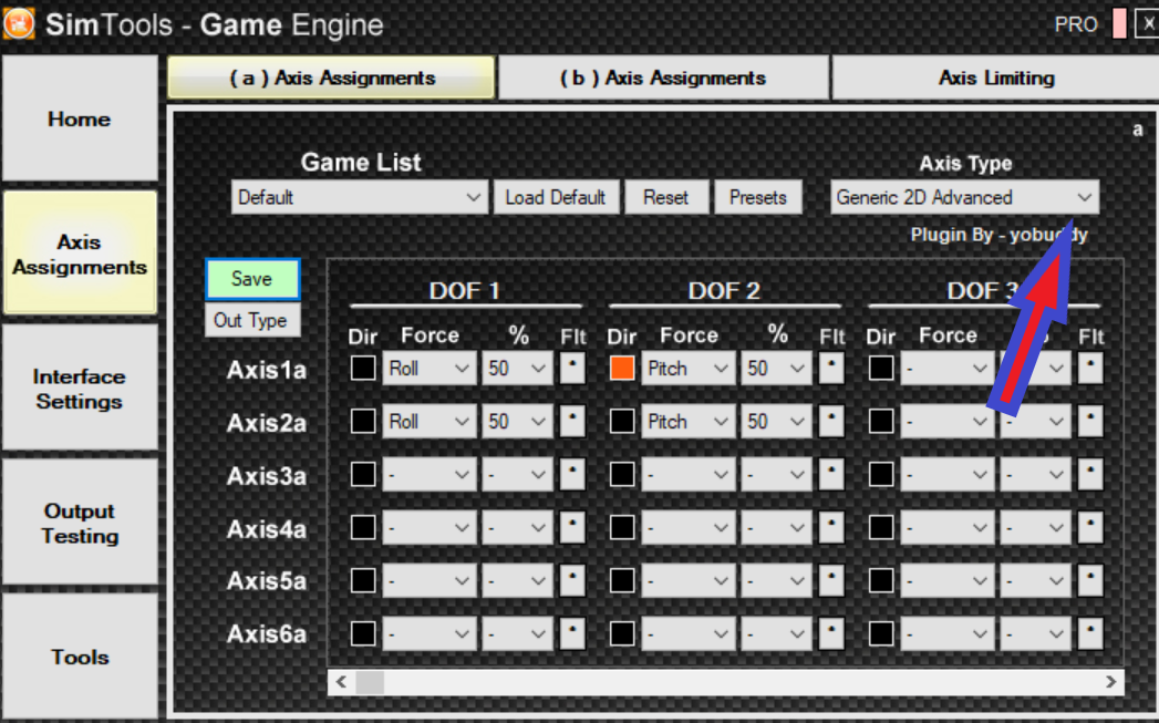

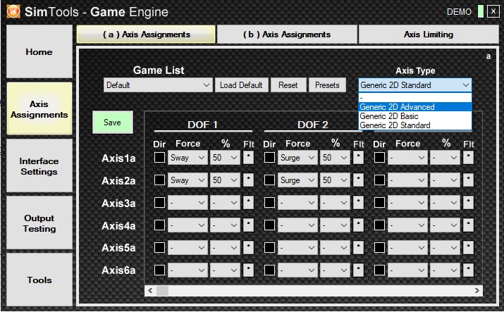

    Getting access to the addition settings options is via a drop down box in Axis Assignments, accessed by the Axis Type button, with the selection being called Generic 2D Advanced:

    Can somebody using the anti rollover function help?
    I tried this function but what I get is not what it is described in simtools 2.3 manual.
    Difficult to describe the actual movement I get with this function on...
    I turn off every other axis leaving only roll axis activated.
    Lest's say I roll left, for a barrel roll, the platform starts to roll left, then at a certain point it pitches up a bit (pitch axis non active) then on the other side it pitches down a bit and then it continues the roll to bring the wings level.
    I know I haven't described it properly but the problem is that I don't understand either what is doing.
    As I said when I'm testing this antirollover function I turn off all the Dof other then roll.
    I turn off all the filters as well so no smoothing or gain or return active.
    Any Idea?

    I would suggest posting pictures of all of your settings and a video that shows the movement of your rig and the game screen at the same time, as that will aid others in assisting with troubleshooting.

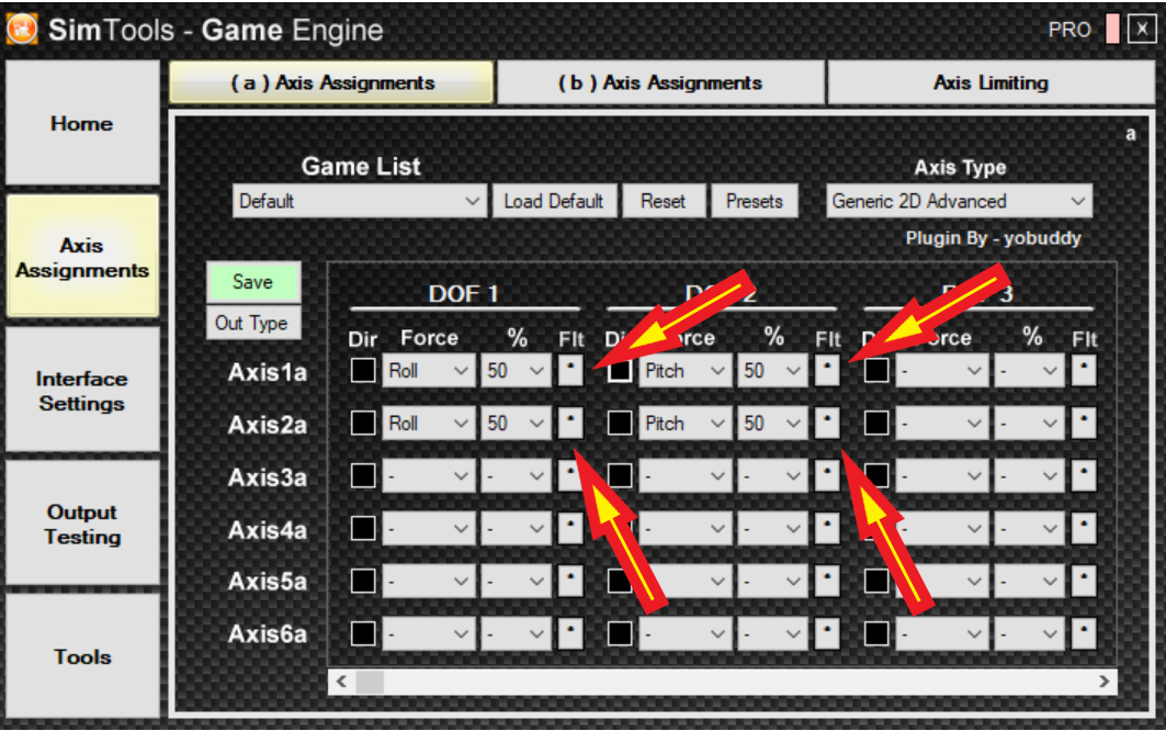

    Thanks for trying to help. But still i dont see where is this option " anti roll" on your screen shot ? I have already tried with errors for few days and thats just enough for me. So can you take next screenshot in wich i can see where is that so called "anti roll" option ? =) Thanks in advance.

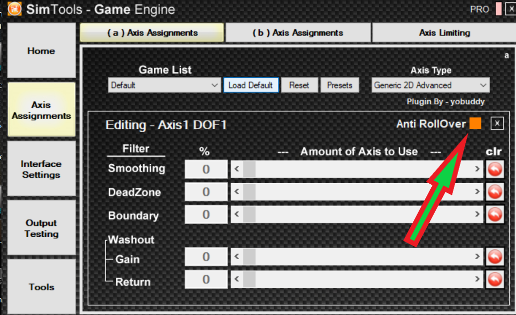

    Once Generic 2D Advance has been selected the use the Flt button on the Roll axis and the Anti Rollover checkbox is at the top right if the Flt panel.

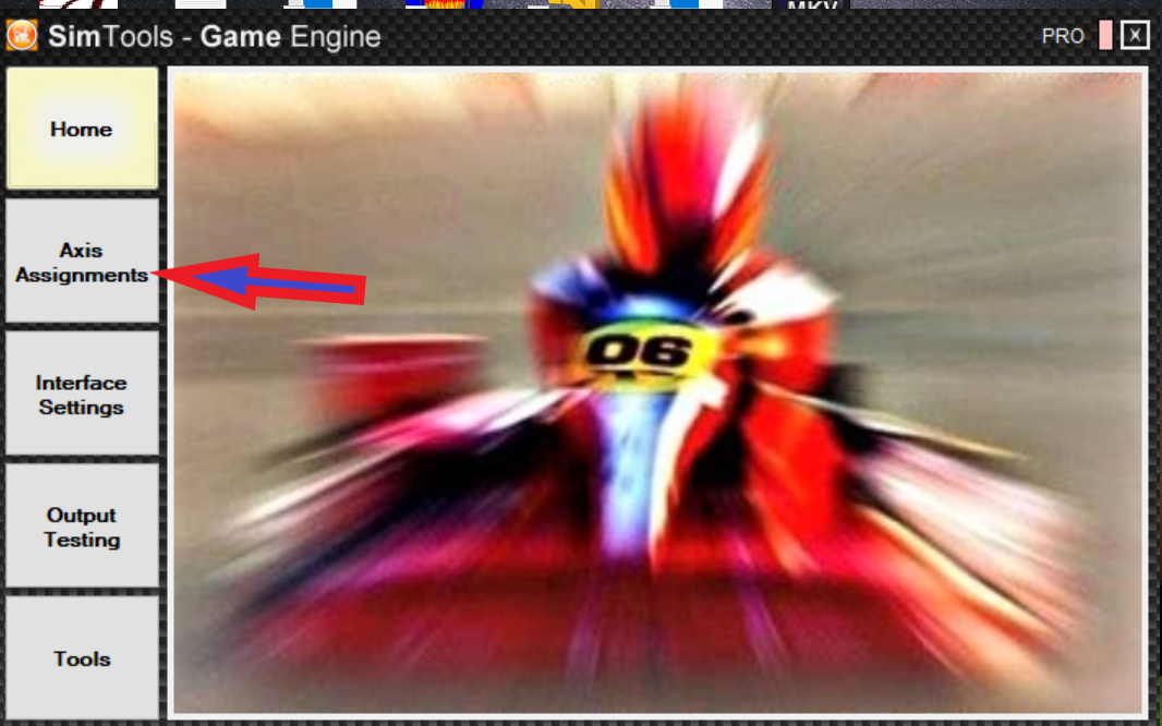

    No problem Elii..
    In the Game Engine select Axis assignment (picture 1)
    Then select Axis Type.. Generic 2D Advanced (picture 2)
    You get a new box called Flt.
    Click on this box for each Axis you want to add Anti roll over to. (picture 2a)
    Check the Anti-roll over box.. Then "X" out of that screen. (picture 3)
    When done be sure and and hit the SAVE button.
    This will save it to DEFAULT . You then need to copy it over to your game selected...
    (woops.. I did not see the Noorbeast post) :)
