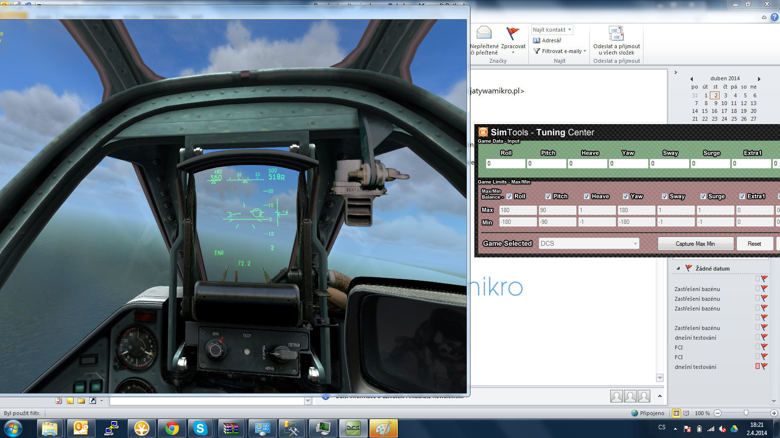

    maybe I am complete idiot, but I spent half od day with this plugin and best results what I have is error in dcs.log
    00209.696 ERROR Trigger: can't execute trigger, err:"[string "?"]:1: bad argument #1 to 'loadstring' (string expected, got function)"
    Iwas trying original plugin and this plugin in thread.
    Please, can someone help me?

    Thank you, I am awaing any news, right now I am trying to debug LUA, I think that data are not sending over socket

    OK today I sniffed UPD packets and DCS is sending data, that is good.
    Bad is that plugin in Simtools is not recieving UDP data even if try to send it manully.
    Any chance to check, change plugin?

    Thank you, but still not working:(
    1. Other games like DIRT and Rfactor are working
    2. Your Export.lua is same as is in plugin
    2. When I use UDP packet sniffer I see that script is sending data, thats good, so I think that problem is in plugin DLL only
    btw I a running on Windows 7 64bit Czech localisation.
    In attachement you can see running DCS and dead Simtool

    I solved this problem, by make plugin yourself.
    Problem seems to be in decimal separator, becouse I am in CZ using comma.
    I attached export.lua and dll with plugin(temeletry is working, installation isnt implemented.)

    Problem is very simple, original plugin working! but only on systems where is decimal separator "."
    we use "," so plugin doesnt work.
    Best way how to definitly solve this issue is to rebuild plugin, that will respect local decimal separator
