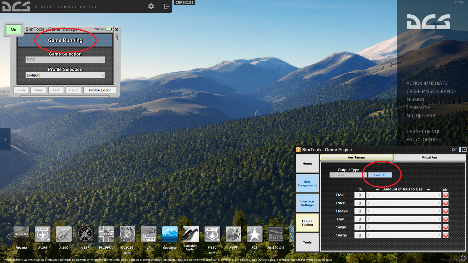

    looking for some help. I just downloaded DCS, patched the game. I have simtools pro and the game connects and goes blue/game running but tuning center does not get any game data input...
    Not sure why.

    Try temporarily turning off your firewall and anti-virus, test and see if they are messing with communications.

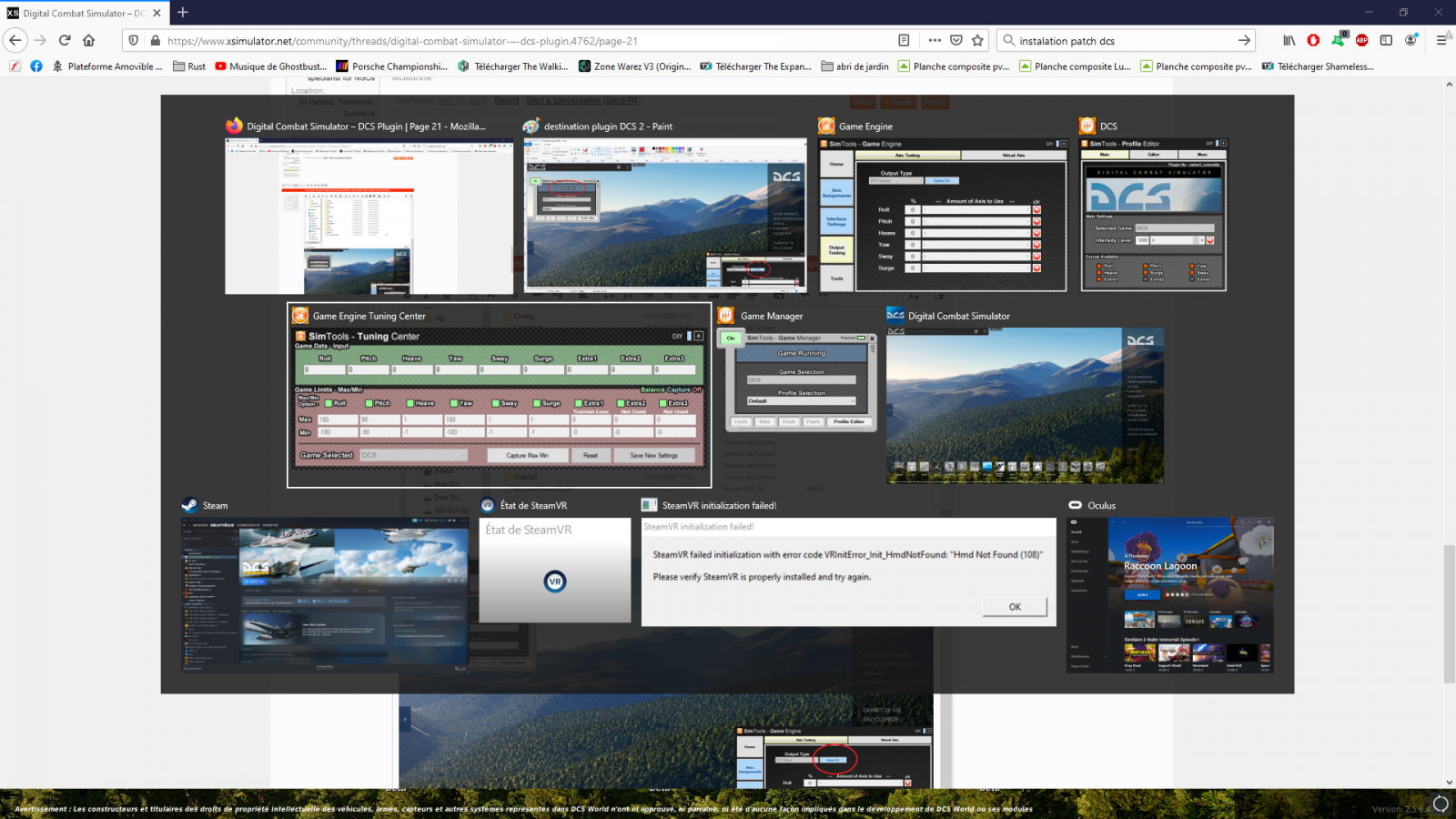

  6. margolle
    margolle Member
    Jun 27, 2019
    34
    104Coins
    +8 / 0 / -0

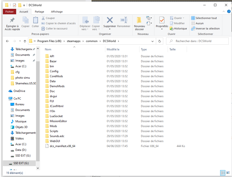

    hello .( i am french sorry for translation )
    my probleme is plug in no mouving .
    imposible to move .
    my simulator is good for many game ( project cars , IL2 BOS , raceroom etc etc )
    the patch DCS is here (picture)
    tuning center never move
    please help me destination plugin DCS.png destination plugin DCS 2.png destination plugin DCS 3.png

  8. margolle
    margolle Member
    Jun 27, 2019
    34
    104Coins
    +8 / 0 / -0
    hi . probleme is resolved .
    the probleme is bad destination patch .
    my game instaled to G: , my patche instaled to G: = no moving
    my game instaled to G: , my patche instaled to C:( saved game / DCS) = moving
    tank you all

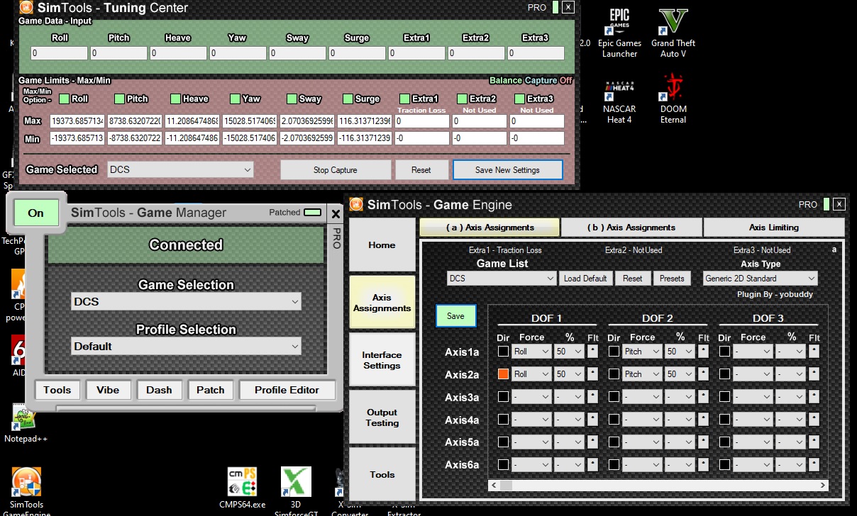

    Hello. I have installed you plugin to User/savegame/DCS
    I have regional settings in English.
    My problem is strange data from tuning center. Roll and pitch. I tried to adjust the roll and pitch, but the data is more than a thousand degrees. Trying to set up a sway - my platform is behaving quite incorrectly. IL2 works fine. What can i do wrong?

    Please post pictures of all of your settings, including the Tuning Center while DCS is running.

    DCS is not running, but this is captured min/maxes
