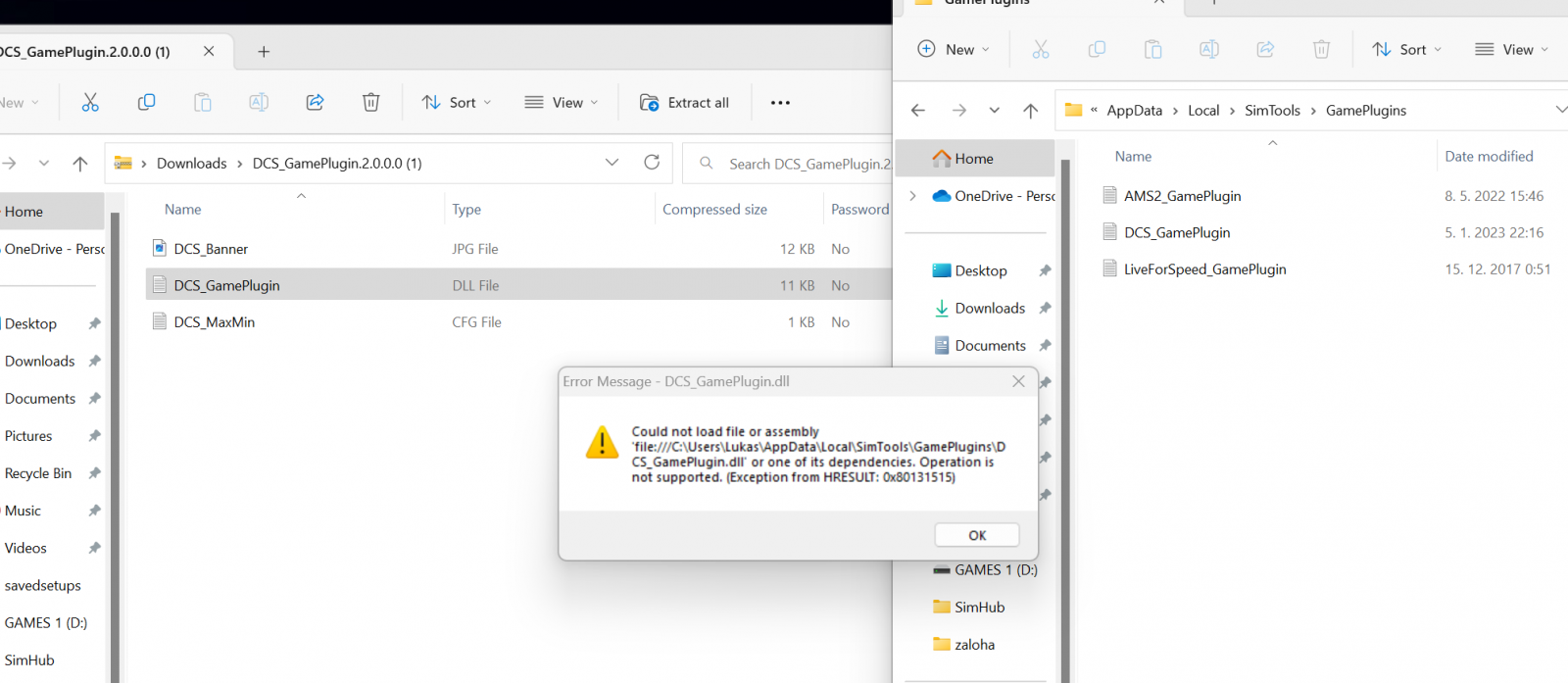

    i have problem with simtools 2.6 and DCS plugin... license is activated...
    22,230
    154,849Coins
    +11,229 / 57 / -2
    There are a number of different DCS plugins, so can you please link to the one you are using.

    Please make sure your using the plugin installer with v2, and not installing plugins by hand.

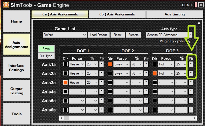

    Hi Guys
    did anyone ever get a working solution to the rollover issue in DCS,I have just completed my 1st 2 dof rig which works great other than nearly getting spat off when doing a barrel roll or vertical loop.
    Any suggestions would be gratefully received, i have tried the anti rollover function in 2d advanced ,but to no avail .
    Maybe it needs to be used in conjunction with other settings.
    I would have thought that just a max value for roll rate until reached would do it then just return to wings level rather than a violent return to center, which is also really hard on the rig

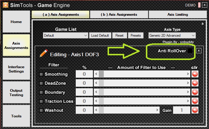

    Have you tried the Anti Rollover feature in SimTools:

    Yup for sure ,tried that in 2 advanced but in isolation does little at all,I wonder if there is anything else that can be done as it spoils the whole experience,is there anyway of just limiting the roll to a fixed point then just return to wings level when you straighten out

    That is what Anti Rollover is meant to do.
    Have your tested Anti Rollover with just pitch and roll, with all other axis turned off? That way @yobuddy and others may be able to offer further advice.
    I am presuming you are using the plugin from this tread, but just want to confirm that as there are a number of DCS plugins.
    Can you please provide pictures of all of your settings, including Tuning Center.
    I see from existing images you have what seems to be excessive allocations like sway, which may complicate things as SimTools mixes all axis on the fly.

    This is what anti-rollover does, turn it on for roll and pitch, and then set the max/min values to -90 /90 and you should be good to go buddy.

    Hey yobuddy
    the -90/90 value ,is this set in the output rotational setting or somewhere else, i am using worm drive motors ,so should the output be set to rotational.
    Many thanks in advance
