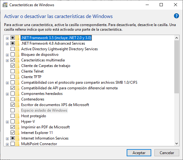

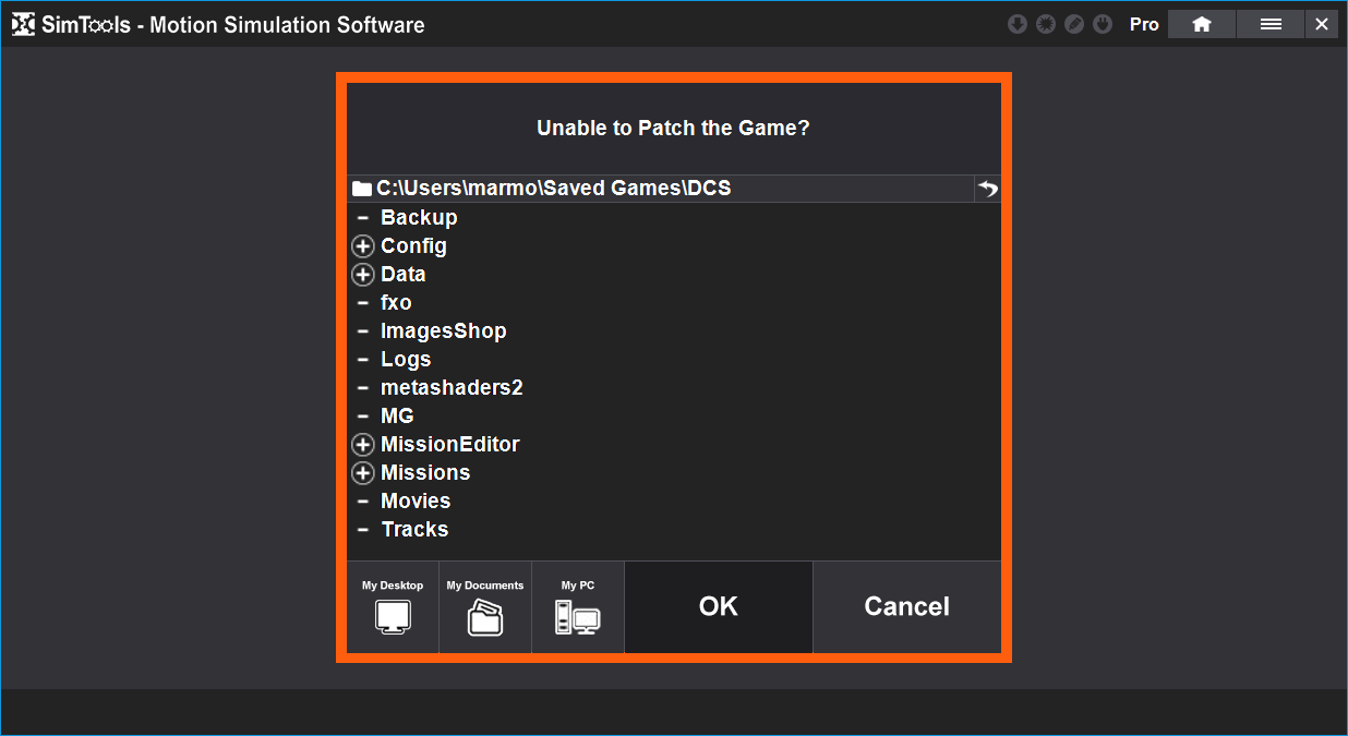

    Hello, I just installed the DCS plugin but when I have to select the game directory I have the next problem:
    Unable to Patch the Game?
    I have already tried the .net framework solutions which I read in other thread and try to repair .net with a tool with no result, I still having the same problem after that.

    I set my computer language to English Local and now I can install the patch on simtools v2 and it works fine. I can patch the game on simtools v3 (first removing the patch on V2) but there is no telemetry data from dcs to simtools v3 (no moves on virtual output).
    Antivirus and firewall are disabled.

    Go up one directory and highlight the DCS folder, and then click ok, and I think you will be good to go.

    Hi everyone,
    I tried to switch windows to English but still impossible to patch DCS on simtools v3.0
    I don't see what's wrong, does anyone have an idea of what I could test?
    thanks in advance

    Ok, the plugin has been updated.
    Please restart SimTools, and then give it another shot buddy.

    The patch worked straight away!
    Many thanks for your help
