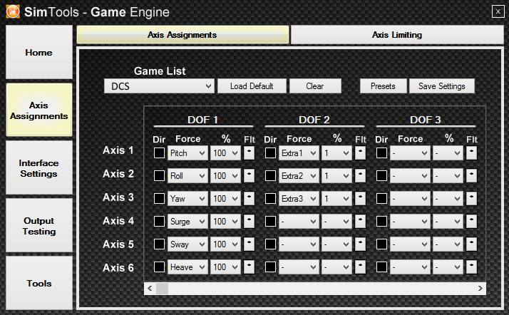

  12. value1
    Jan 9, 2011
    2,192
    Zug, Switzerland
    14,306Coins
    +3,363 / 13 / -1

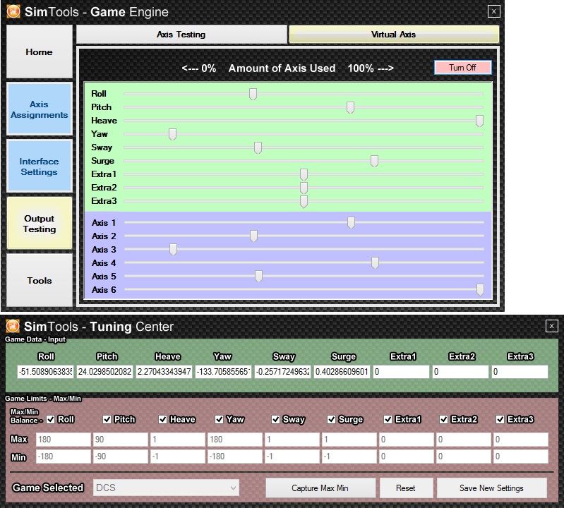

    Hi @berty
    Check your axis settings for DCS in GameEngine.
    Could it be that there is no force selected for all axis?
  13. berty
    berty Member
    Sep 10, 2014
    72
    164Coins
    +12 / 0 / -0

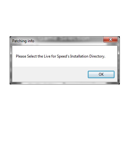

    Still nothing, but which plugin should I use? because when I use the plugin from @JanKroupa and I want to patch me and wants the installation directory of Live for Speed.

    confused-face-smiley-emoticon small.gif Did you try the official plugin? The plugin of Jan is for Czech Republic.
    This is how the patching info of the official plugin should look like:

    164Coins
    +12 / 0 / -0
    Problem solved. I used the plugin from @Jan Kroupa, because I am from Slovakia. But in tuning centre jumps numbers, but the servo does not move. Other games are going great.
