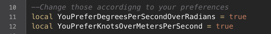

    So, I understand that you DO get motion, just not very much. Correct?
    Have you made any changes to the Export.lua file? I mean here:
    Assuming you made no changes, then you will get exported accelerations in Gs and angular rates in °/s.

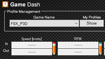

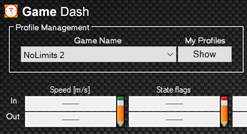

    @Dirty, thanks so much for your effort spent in the DCS plugin.
    I am using Game Dash just for controlling a fan. In NoLimits2, the fan is triggered by the "Speed" value feeded into Game Dash, and in P3D I am using the propeller's RPM value. Having these parameters available for DCS would be fantastic.
    About Game Vibe: Also here my preferred input parameter is RPM, followed by Chassis, Flaps, and Landing Gear. But having RPM available would already be a huge step.

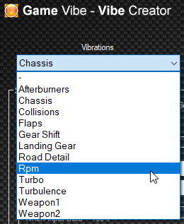

    On GV:
    If I send a variable like "rpm, 4500" it all works fine, because GV "knows" rpm. But if I get creative and model ground roll vibration depending on groundspeed and gear strut etc. and send it to GV as "Groundroll_Vibration, 210" (for example), it gives me an error: Groundroll_VibrationID.cfg file not found.
    Apparently it is looking for that .cfg file. Do I have to create my own .cfg file or am I limited to using only the ones that GV knows?

  17. yobuddy
    51,682Coins
    +5,204 / 19 / -0
    GameVibe only accepts these as inputs currently.
    (We could make a rpm2 input if needed thou.)
    • Chassis (FL, FR, RL, RR)
    • Road Detail (Heave)
    • Collision L/R (Sway)
    • Collision F/B (Surge)
    • Rpm (Rpm)
    • Turbo (Turbo)
    • Afterburners (Afterburners)
    • Gear Shift (Current Gear)
    • Turbulence (Speed)
    • Flaps (Flaps)
    • Landing Gear (Landing Gear)
    • Weapons1 (Gun, Cannon, or any fired weapon)
    • Weapons2 (Gun, Cannon, or any fired weapon)
    Game Vibe is built in a way that we can add more effects as needed.
    If there is more that we want, I can built in into v3 when i get there.
    Take care,
