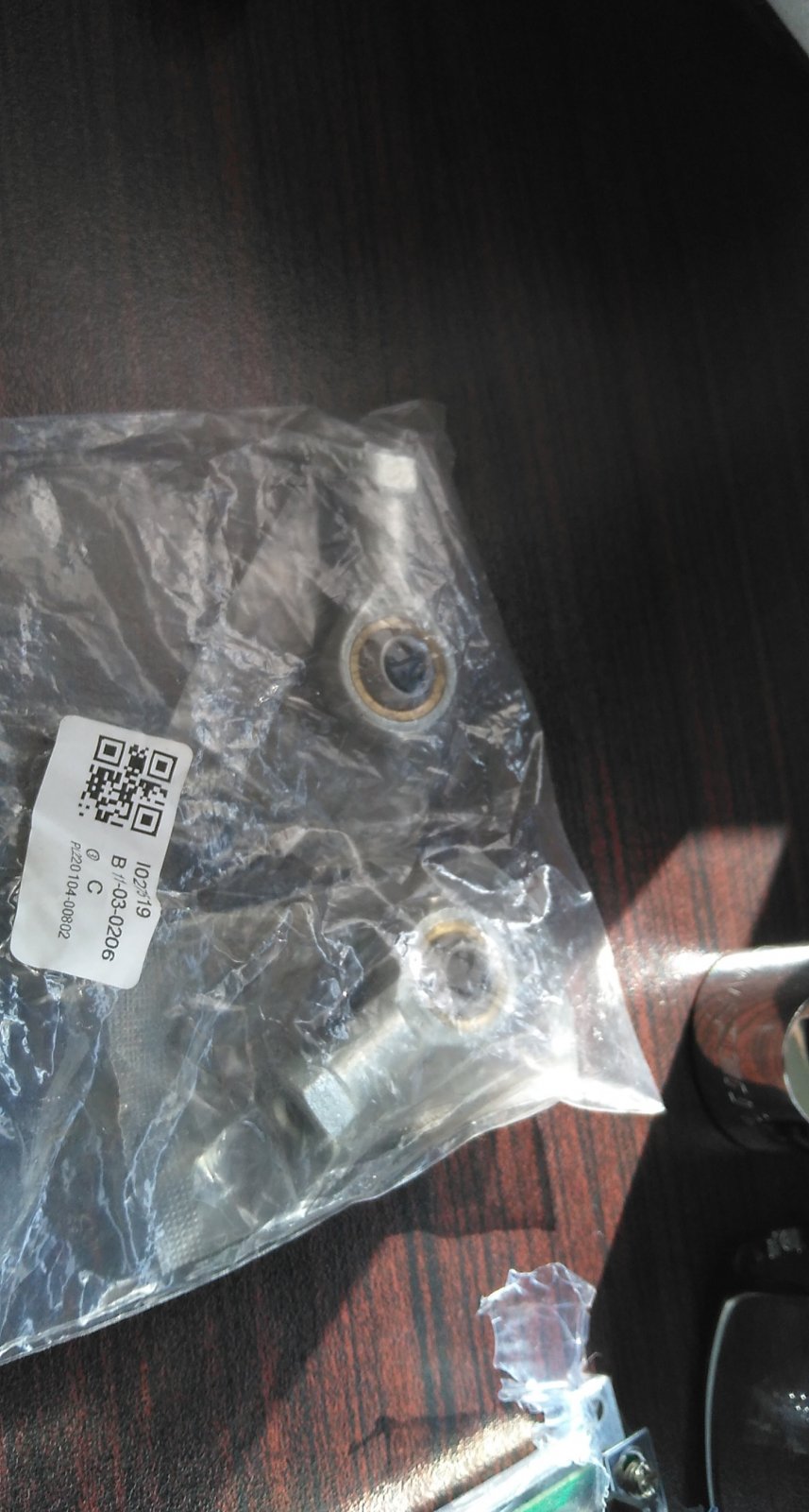

    Swivel joints

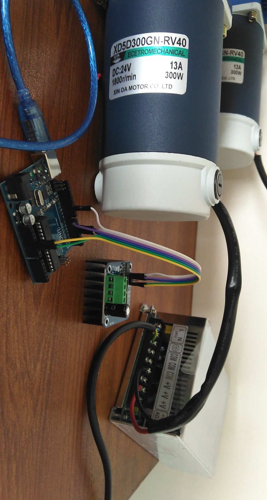

    Just wanted to ask as Im following the schematic of Smc3 with arduino given on the page of xsimulator. I just need some clarification.
    I was integrating arduino , motors and motor driver. The so far integrated setup is shown below
    I found out that there is no direct connection between motor driver and motor (also as mentioned in the schematic). Is that correct? Do we need to connect motors to motor driver ?
    I'm confused because on the IBT2 motor driver there are pins that are labeled for motor pins . As we have to connect motors to those pins. As shown in the figure.
    Do we have to connect motors with these pins. Or we should connect motors directly to the power supply?

    Hard to judge the actual size from a photo, but the uni joint needs to be robust enough to resist lateral twist.

    Follow this guide by @Halloween2go, starting at 27:00: https://www.xsimulator.net/communit...-with-wiper-motors-arduino-ibt2-and-smc3.391/

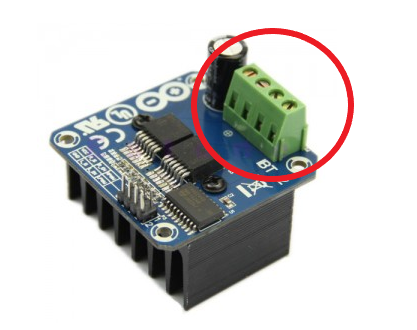

    The pot needs to be connected to the motor shaft via some form of flexible coupling, as per the video at 25.49, as it provides positional information. The pot and IBT2 are wired as explained and as per the SMC3 wiring diagram. The motor and power connects to the IBT2 via the green connector block:

    The connection of motors with motor drivers and connection of motor driver with power supply is missing in the diagram. That needs correction because its too confusing.

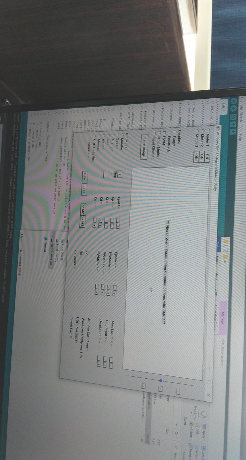

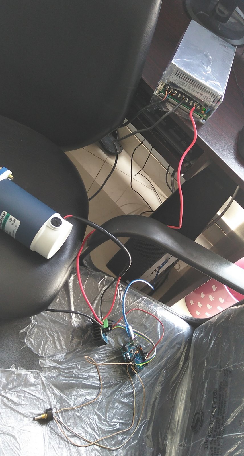

    I have connected motors power supply pot and arduino. I uploaded the code set the com port in arduino and smc3. But the status of the motors in smc3 is still off. Need advice

    The pot should be mounted and attached to the motor with some sort of flexible coupling: https://www.xsimulator.net/community/faq/how-to-connect-protect-a-potentiometer.13/
    Just to be sure can you please confirm the SMC3 code was set to Mode 2 and successfully uploaded to the Arduino.
    These are the steps to configuring SMC3, at which point does your setup not respond as expected:
    8. Set Kp to about 400
    10. Do the above for each motor

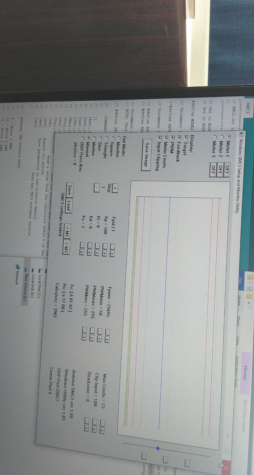

    All was setup correctly. Mode 2 was also defined on arduino. Today I re-ran it and it worked correctly.i dont know what was the problem.
    According to point 5 and point 6 the motors will not move on this setting
    1. Set the Kp, Ki, Kd, PWMmin, PWMmax, PWMrev to 0 for ALL motors (This will make sure the motors don’t move)
    2. Set Clip to 255 (you need to do this first) and Limit to 255 (This will give you plenty of margin if something goes wrong while setting up)
    I copied the same calibration but my motor is moving. :(
    I dont know whats the problem now :eek::oops:o_O
  15. noorbeast
    21,632
    151,449Coins
    +11,038 / 56 / -2
    What happens at steps 7 and 8?

    this is the motors working and smc3 setup

    I am sorry I can't get anything meaningful from that video.
    Is the pot attached and does the motor respond as expected at steps 7 and 8 of the SMC3 setup?
    Please post pictures of settings rather than video, it is much easier to understand.

    No the pot is not coupled to the motor right now.
    As I turn the power on the motor start rotating. Point 7 says that motors should not be moving.

    The pot provides positional feedback and should be attached via a suitable flexible coupling, as per previous advice.
